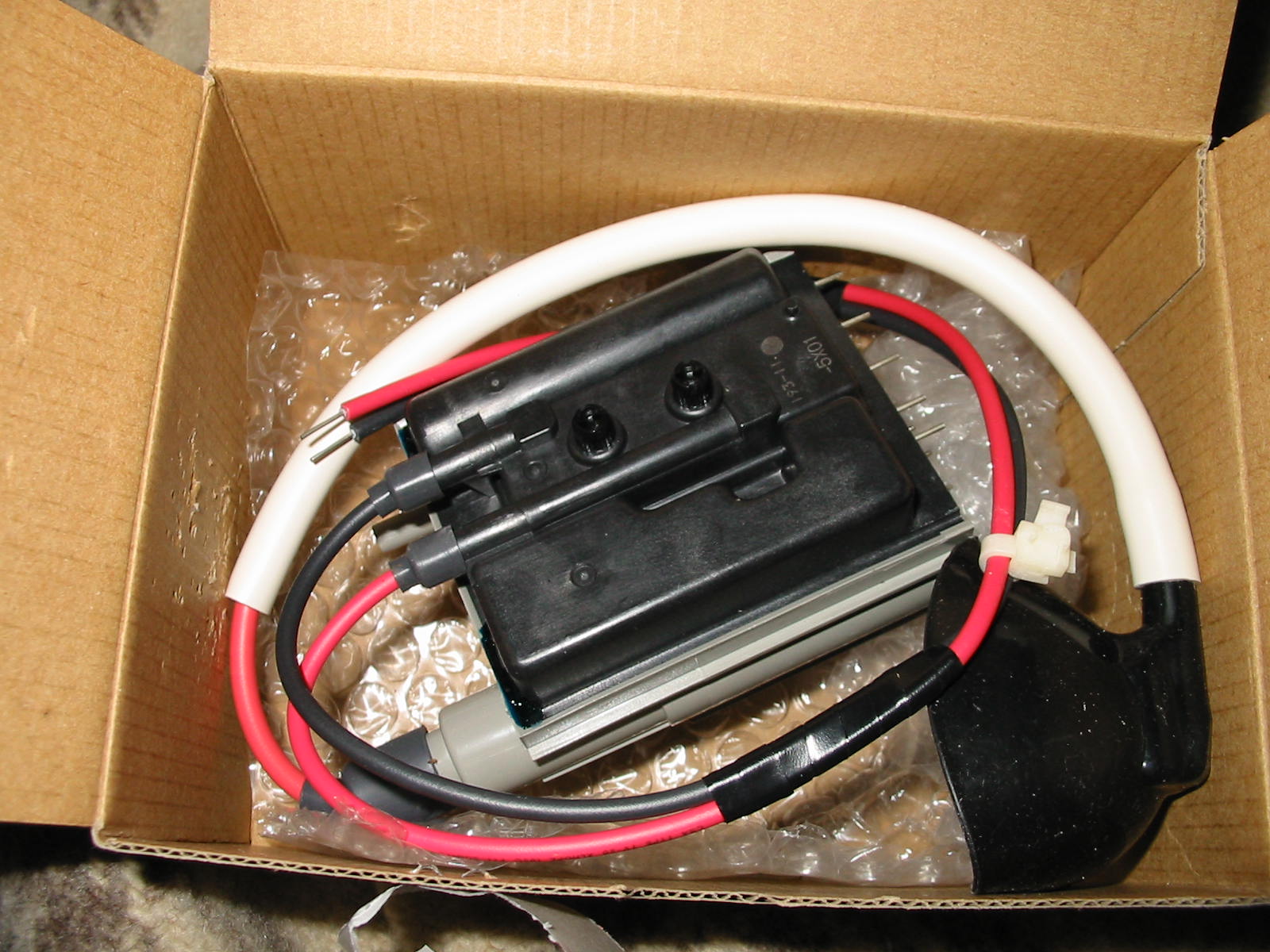

                            And look what we have here:
                            https://www.badcaps.net/forum/attach...1&d=1336629435
                            Yes, sirs - that would be a brand-spanking new flyback from Sony ^_^ .
                            In the end, I figured why not fix the monitor. After all, 22" monitors around here still cost around $100-120 - and that's for LCD technology. I want GOOD colors.
                            Now the D-board is out and ready to receive the replacement, but I have a few questions that I hope some of you gurus won't mind answering.

                            By the way, I got the flyback from PartStore.com. At first, I didn't believe that it would come since it was out of stock and I didn't get any order confirmation emails on my order at all. Was expecting to get my money returned soon and be told that it's not available. Still, I waited, though. 3 week later, the package shows up. The pins were quite bent due to somewhat inadequate packaging, but at least none are broken and the core seems okay.

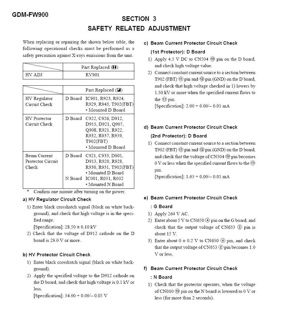

                              I am not sure if you have service manual for this monitor model or not, but you do need high voltage DC meter to correctly set the high voltage output, if is too high, you will get X-ray radiation from the CRT. So be care real careful.
                                Re: I need help fixing a Sony GDM-FW900 24” CRT
                                Thanks for the replay, budm.
                                Yes, I do have the service manual. Link is actually in post #1, I just mistakenly happened to call it a "schematic".
                                Anyways, I looked at the service manual again today and it does say that the HV tube voltage should be checked if the flyback is replaced. Unfortunately, I don't have a high-voltage DC meter, and I don't know anyone who has either.
                                The new flyback is genuine Sony part. Can there really be that much of a difference in the HV tube voltage? The HV tube voltage is adjusted with a potentiometer, but the potentiometer is covered in epoxy, so I (and no one else for that matter) has made any adjustments to it.
                                The only 2 checks I can perform to check the HV are
                                1) to measure the output voltage for the HV_DET power supply (cathode of D912) - should be 29V or more.
                                2) Put 34V on the cathode of D912 and check that the HV tube voltage is 100V or less.
                                  How does the manual tell you how to adjust the high voltage, they may have put the test point for making the adjustment without using the High voltage DC meter, you should follow the manual, X-RAY radiation is not some thing you will want to take it lightly, there should be warning in the service manual about it. I do not have the high voltage probe anymore since I have not worked on CRT in the last 8 years. I did fix a lot of old TVs that run all tubes, that was in the 73, long time ago. I still have my CRT De-gaussing coil though. if the high voltage too hing it may affect the Convergence alignment also, the CRT is the TRINITRON right, make sure to seat that high voltage cup correctly, I believe it may have dual high voltage pin on it. It will arc real bad if you do not install it right.
                                    Well, now that I read twice over the Safety Related Adjustments (see attached picture below), it says just to "check" those certain items as a safety "precaution". What I understand from this is that since I'm only replacing the flyback, no adjustments should be necessary to the HV tube voltage unless it's outside of the specification. Also, I don't see any test points for the HV tube voltage.
                                    I think I'll just perform the HV Regulator circuit and HV Protector circuit checks, minus measuring the HV tube voltage. X-rays be damned!
                                      It is right there under the High Voltage regulation
                                      Step #1 Enter blah, blah, blah, check the high voltage is in specified range, specification: 28,500V +/-100V (28.5 +/-0.1KV).
                                      They assume you do have High voltage probe to do the verification, you can also see that it is pretty precise to be within 100V of 28,000V! That is tight tolerance.

                                        Back O/T - I think I'll just "risk" it and replace the flyback without doing adjustments. The whole back of the CRT is shielded. And it's not like I'm doing some kind of a hack job - I'll be replacing a genuine Sony part with a genuine Sony part. *Should* be fine IMO. It's not like I'll spend more than a few hours in front of that monitor either.
