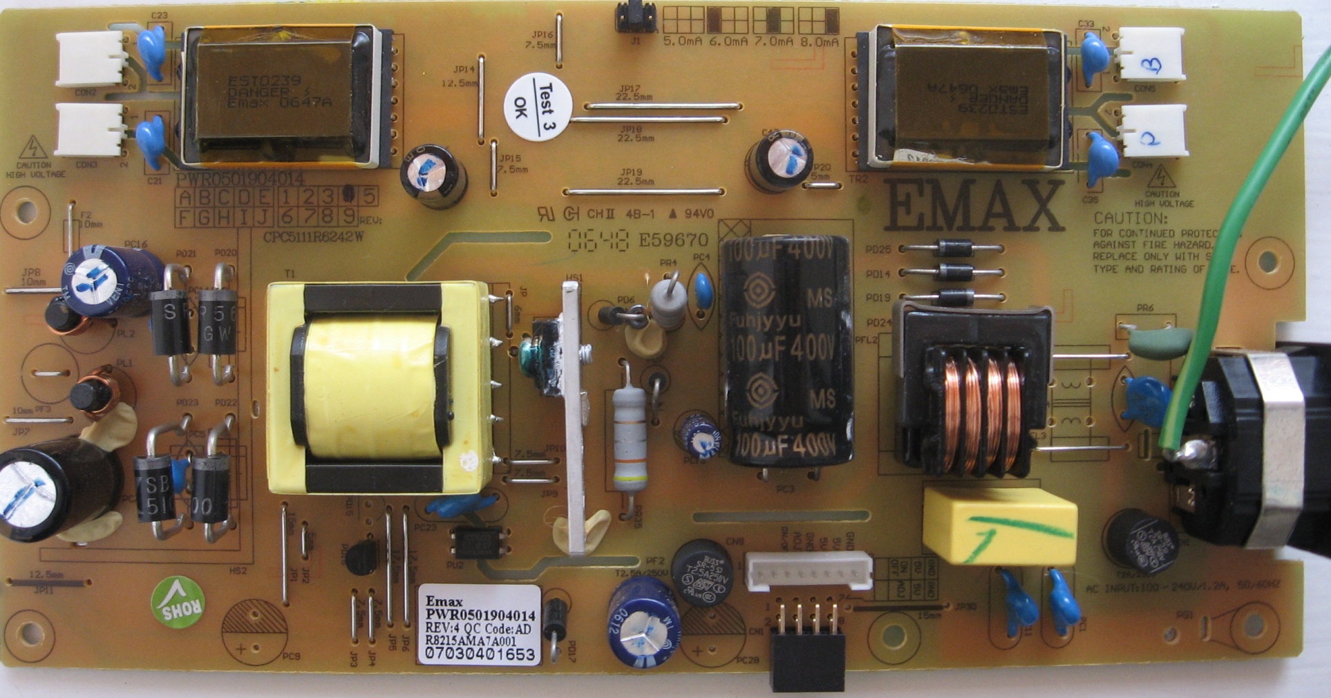

    Got this monitor today, just seeing if I can revive it.
    Have attached photos of the powerboard, both sides.
    There are 2 connections off it going to the videoboard and to the display buttons board. The expected voltages there are +5V, but I'm getting only a couple of mV.
    Working through the powerboard from the mains-in, I'm typically seeing +/-100-150V all the way to the right-hand side of T1. On the left-hand side of T1, just a couple of mV.
    Is this transformer likely to be the culprit, or do I need to check anything else?

    1) What is the DC voltage across the big cap?
    2) What is the DC voltage across the small startup cap just to the left of the big cap? Is this voltage stable?
    3) Great pics.

      1) 323V
      2) Do you mean PC4? If yes, no, it's not stable, seems to max at about 10V, then decreases to 0V, increasing again to 10V, etc.
      3) Cheers, nice day here today, the natural light makes a huge difference to getting good pics.

        This little cap plays an important role to the proper startup of the SMPS. A fluctuating voltage suggests the cap is bad even though it is not bloated. Change this cap out with a quality one like a Panasonic FC or equivalent.

          In addition to changing the little one, you may want to change the other 5 electrolytic caps. This board was made in 2006 so the caps are 5 years old and could also be bad.
          Capacitors die from age, heat, and shoddy build quality. Capacitors DO NOT have to be visibly bloated in order to bad. They can be out of tolerance uF (a 1000uF measures 20uF) and/or have high ESR (ohm). A multimeter will be insufficient to test for ESR. For that you need an ESR tester which costs between $50 and $300.
          Most members here will recommend that you replace ALL capacitors with reputable brands from reputable sellers. Brands like Rubycon, Panasonic, and United Chemicon are suggested. A list of recommended caps can be found at

            I think I measured the wrong cap, the one I measured was the light-blue ceramic one.
            The measured the dark-blue one, near the leads of the big capacitor, and it was fluctuating between 15V and 20V.
            Is it still an issue? When you say that if it's fluctuating it suggests it's bad, should the voltage be rock steady?

              The startup cap is the 47uF 50V electrolytic cap. The PCB designation is obscured by the angle of the pic. If it is fluctating between 15V and 20V DC, replace it. The voltage should be steady.

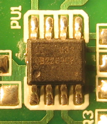

                It may help to advise the part number on the SMPS chip...this is the 8 pin one placed centrally on the bottom of the board,as referring to its datasheet may well be helpful.

                  Good point that I forgot to mention. That is PU1 on the backside.
                  The datasheet will help us understand the circuit a bit better and see what the voltage across the startup cap should be.
                  I estimate about 50% of the problems are bad startup caps and the other 50% are bad SMPS chips.

                      PU1 is "LT 633" on top line, "OB2269CP" on the bottom line, was tough to get a good pic, but under the magnifying glass, I'm fairly certain the number is correct. I initally thought the first character was a zero, but changing to an "O" turns up the datasheet. I've attached the datasheet I think is correct for the chip.
