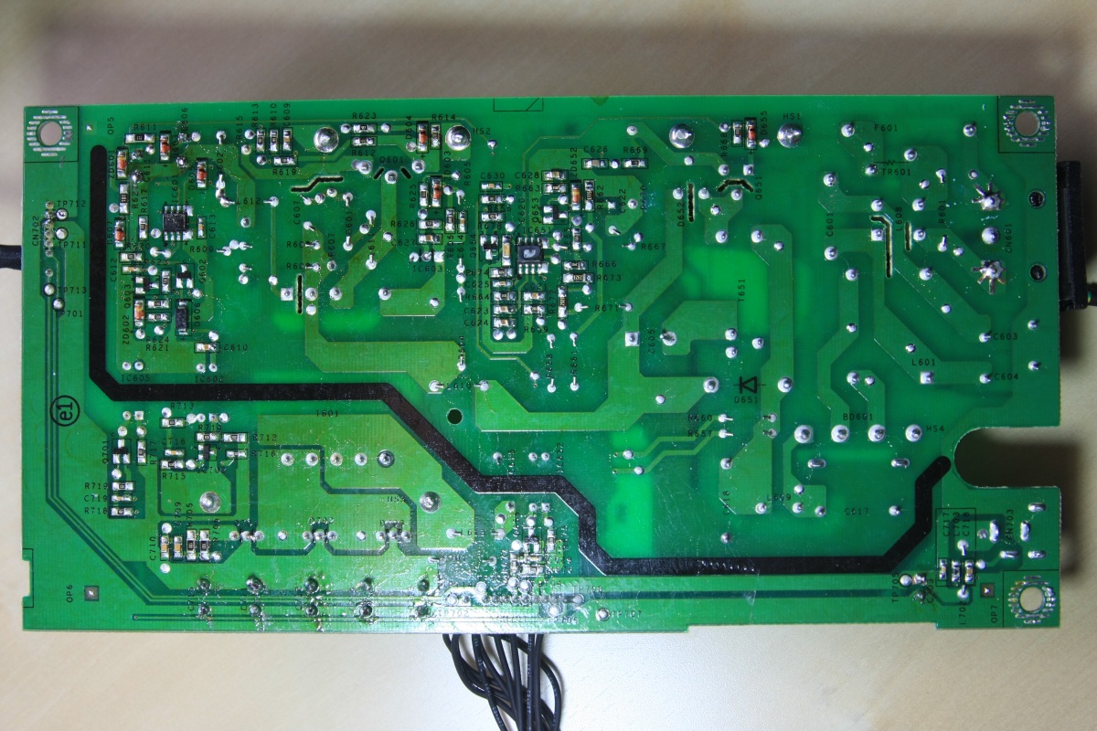

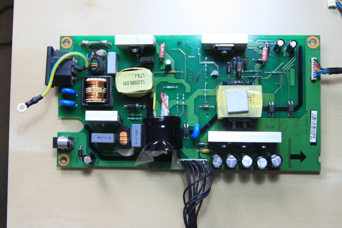

                      Re: Dell 2407WFPb Monitor - Bad Cap
                      Hi folks,
                      I thought I'd add to the many many posts on this particular monitor's issues. I was sitting around in the loungeroom, heard a pop from the study. I investigate about an hour later, and the monitor won't power on.
                      So I disassembled it and had a cursory glance at the damage. the 450v 120uF was damaged, and the fuse was also blown. I happened upon this thread, and replaced the following:
                      * 1 x 450v 120uF (C605)
                      * 5 x 35v 470uF (C711-C715)
                      * 2 x 50v 47uF (C606, C611)
                      * 1 x 25v 220uF (C703)
                      * 250V 4A fuse (F601)
                      So I thought great, it's all done. Looked away and started plugging in the power supply again, and pop! Damn. I pulled the power supply out and had a look again. On the underside of the board I found IC651's top was blown off and R670 is also burnt. I don't know if this was burnt out already. I have attached photos of how the board currently looks, with those replacements still needing to be carried out. Pardon the soldering! Also the tape is temporary, it's just there for testing. I didn't realise that the size of the replacement cap was different to the original.
                      So further to this, I have to replace R670 (0.22ohm, not sure of the wattage), IC651 (a L6561D PFC). Can anyone see any damage, or point out anything else that might be worth replacing?
                      Despite having already replaced the monitor, I'm determined to repair it!

                        #191
                        Those are nice clear photos using manage attachments. It makes remote troubleshooting easier and eliminates a lot of playing 20 questions.
                        Check your power mosfet (Q651) and bridge rectifier (BD601) for shorts. These 2 are the most likely candidates for your blown fuse.

                          #192
                          Thanks, I made sure I read the notice, and the various signature links about guidelines for posting, etc. I work in IT and didn't want to post the equivalent of a "It doesn't work" here.
                          For the pixel peepers, I've uploaded larger copies of the above pictures here and here.
                          Also, thanks retiredcaps. I'll find out how to test those components and see what happens.

                            #193
                            It is easy.
                            1) Power off and unplug your monitor. Wait 5 minutes.
                            2) There are 4 pins on your bridge rectifier. Number them 1, 2, 3, and 4. Measure the resistance between 1-2, 1-3, 1-4, 2-3, 2-4, and 3-4. Any resistance reading under 30 ohms suggests it is shorted. You will then have to desolder the component and retest out of circuit to verify.
                            3) There are 3 pins on your power mosfet. Number them 1, 2, and 3. Measure the resistance between 1-2, 1-3, and 2-3. Any resistance reading under 30 ohms suggests it is shorted. You will then have to desolder the component and retest out of circuit to verify.

                                    #197
                                    Q651: 0ohm between all combinations of legs. Toast!
                                    BD601: 600k between some legs, 1.5mil between others. So, normal?
                                    I desoldered both to test individually and make doubly sure. Is it safe to assume that I can perform the same test on the rest of the mosfets and bridge rectifiers in the hunt for dead components?
                                    Beyond visual inspections, is this basically how it's done if you guys had the board in your hands?
                                    And to cut down on the number of components I'd have to test, are there components on the board that will always leave a visual indicator of failure? Say, caps that have bulged, resistors that have burnt out, etc. Also I'll make sure I test the same components from post #77 as mentioned by newbie. Newbie, what happened with your externally modded one, did it just working, make a noise, etc? I was thinking of using that mod as my next port of call should I be unable to properly diagnose this board. I'd be interested to see what happened when you get the time to check it out.
                                    Thanks.

                                      #198
                                      Absolutely shorted.
                                      Not shorted so likely good.
                                      I always test components in circuit first. If the readings are suspicious, then I desolder to verify.
                                      You can check the rest of your mosfets (pcb designation "Q") and diodes (pcb designation "D") in circuit. Definitely check D652 and D655 as it might have sustained collateral damage from Q651. A good diode should read 0.4V to 0.7V in one direction and 0L in the other. If you get a reading in both directions, you will have to desolder one leg and retest to verify.
                                      There is only one bridge rectifier in your power supply.
                                      More about testing these components are explained starting with post #19 at
                                      https://www.badcaps.net/forum/showthread.php?t=10419
                                      After you learn a bit more, you will be able to narrow down likely culprits.
                                      Some electronics devices are infamous for having a certain problem. For example, older Benq lcd power/inverter boards have shoddy soldering which leads to certain problems. So knowing the history helps narrow down which components are likely bad.
                                      The Hanns-G 28 inch monitors run temperature hot and heat kills caps so we see a lot of people with this monitor having all sorts of problems due to bad, but not bulged, caps.

                                          #200
                                          A summary so far. The components tested in this list have either been identified by myself as failed, suggested by retiredcaps, or suggested by post #77.
                                          Diodes were tested by ensuring continuity in one direction only.
                                          Casualties:
                                          • R670
                                          • Q651
                                          • F601
                                          • C605
                                          • IC651
                                          Tested OK:
                                          • BD601
                                          • ZD601
                                          • D652
                                          • D655
                                          Checked, but not sure of the result I got:
                                          • R669 - 15k ohm, but post #77 says this should be 1k.
                                          • IC601 - Doesn't seem shorted. Varying resistances between pin pairs. I'm guessing this is OK as I suspect a failure would mean no resistance between pairs/visible damage like IC651, or no continuity at all.
                                          Any comments?
