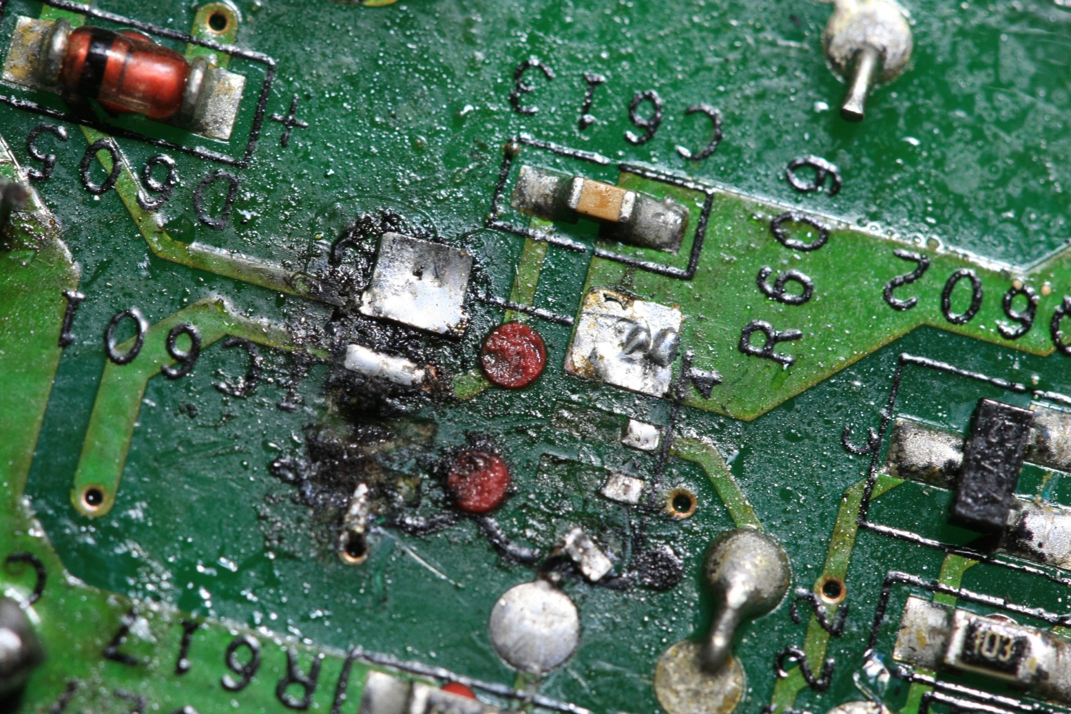

              #226
              Re: Dell 2407WFPb Monitor - Bad Cap
              Argh, well this has come to a premature end. When I was removing one of the ICs, I must have yanked out one of the lines onto which the IC solders. Damned if I can find where it comes from.
              • selldoor
                Slow Learner
                • Dec 2010
                • 7870
                #227
                If you post a good picture of the damage zone we may be able to suggest
                a fix.

                  #228
                  Hopefully this is good enough, then!
                  I've already tried scratching around to find the trace but haven't tried very hard and didn't want to push it in deeper or make fixing more difficult.
                  • selldoor
                    Slow Learner
                    • Dec 2010
                    • 7870
                    #229
                    Looks fixable - I am just going off for a week (very inconvenient!) others should be able to advise. Try and clean the area up with isopropyl alcohol on cottonbud or soft brush
                    Probably Not all the pins need attachment see if you can find a datasheet for the chip.

                    • Jasgriff
                      • Feb 2012
                      • 578
                      #230
                      I agree with selldoor... Very inconvenient that he is having a week off!
                      Do you have any isopropyl alcohol? dont scratch it anymore just get hold of some of that stuff and it will clear the majority of it up. Then get us another pic and we can help work out what goes where.

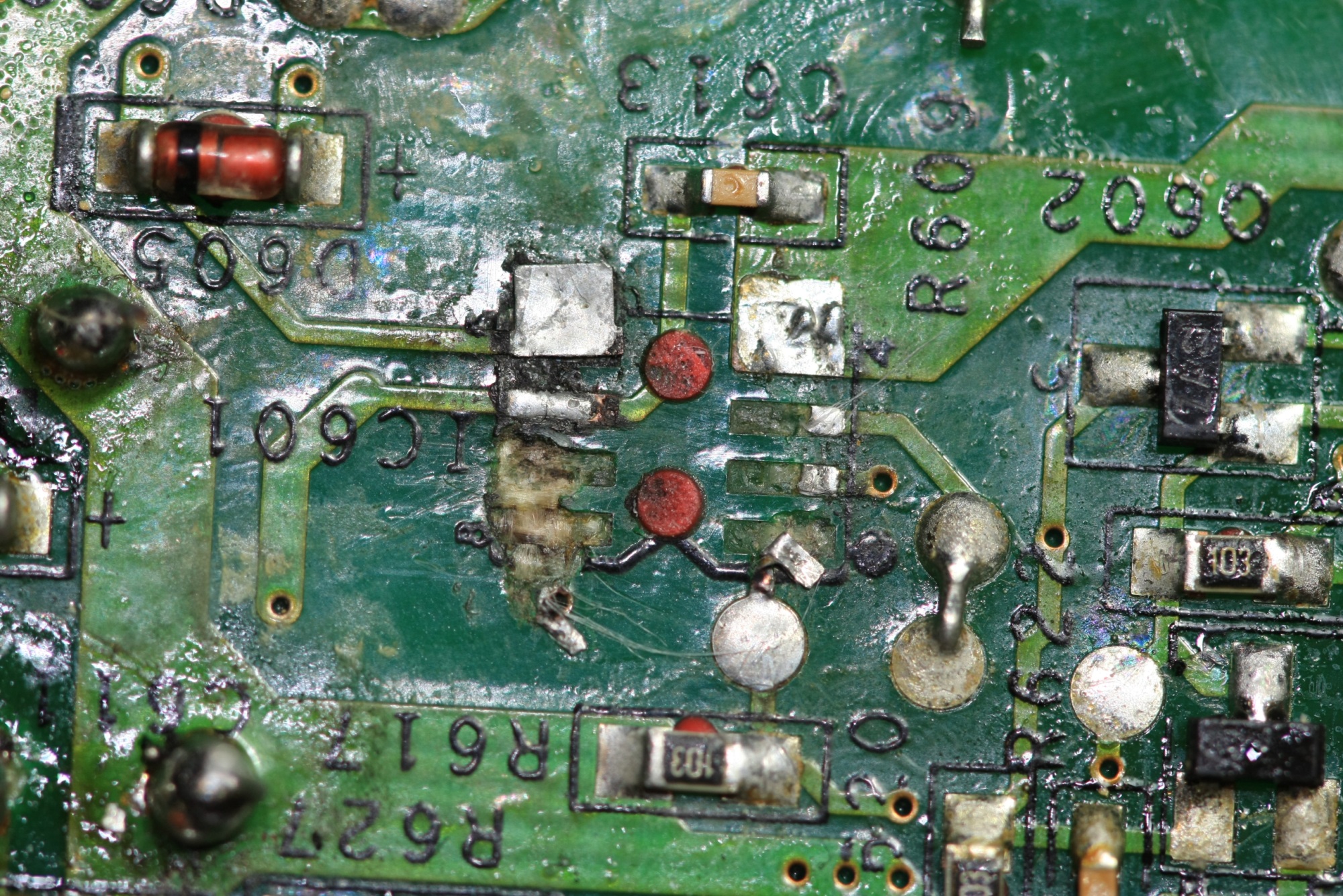

                          #232
                          Alright, busy times but got some time to clean up the circuit board and take a photo.
                          I'm pretty sure I've ruined it! See attached.

                            • selldoor
                              Slow Learner
                              • Dec 2010
                              • 7870
                              #234
                              Originally posted by WillyBobz
                              Hi Sabretooth,
                              Check out this link below, it is for a Polish forum, use google translate, it also has the Diagram for L651, hope that this may help you.
                              Good Luck!
                              http://obrazki.elektroda.pl/1950185900_1304529310.jpg
                              I am not so sure-Willtbobz, what was the main link to this.
                              The components we do know are D605 on pin5 (not on pic) A 10k resistor on pin1 (could be on pic but not labelled C613 on pin 6 (not on pic)
                              Similarly we have R617 R627 R622 R609 Q602 not mentioned on pic.
                              perhaps they only have topside components labelled.

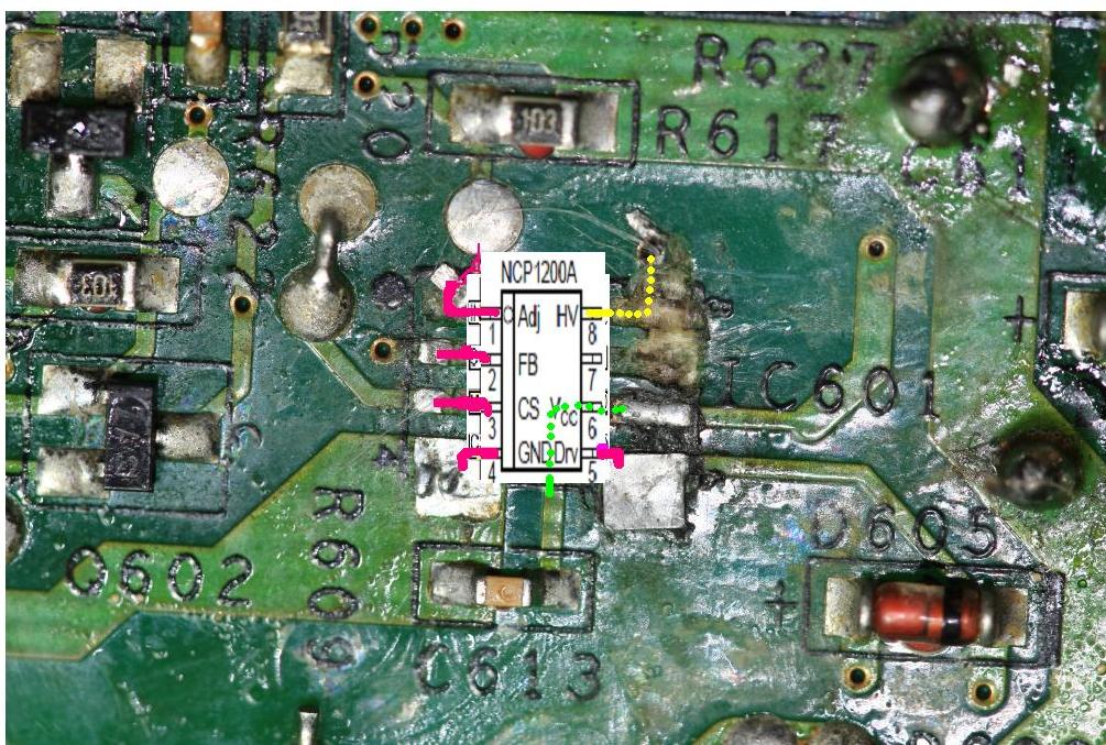

                                #235
                                Right - Help required from circuit experts - I attach a pic - I have guessed that the IC in question is a NCP1200A (got confused in the threads) Most of the connections seem obvious but struggling with where pin 8 goes. Sabretooth can you see the hole/pin I have dotted the yellow to - what is on the other side of the board at that point. Can you do a close up of the area.
                                Team -feel free to comment this is a suggestion only and we dont want to cause further damage.
                                  #236
                                  If I am correct, that HV pin is the kick start power input from the main DC supply through a bunch of resistors connected in series to drop the 325 Vdc from the main cap down to about 12~18vdc to start the SMPS, once it started, the power supply circuit inside the SMPS will switch from the HV pin to the VCC pin which is generated by the extra winding off the transformer.
                                  I have the 2407WFPB at home that I need to work on, so which board is this I need to look at?
                                        Pin 8 connects to R603 on other side of board as in the Diagram on the link in my previous response.
                                        I have checked this against a power supply board that I have on the bench.
                                        Sorry unable to take a decent picture (close up)

                                          #240
                                          Thats Great Willybobz - I forgot there is a high def pic earlier in the post.
                                          I think we just need sabretooth to test what pads he has got for continuity to the next joint then he can try and fit it. Any without continuity will have to be wired. Perhaps he can put a snipped cap leg into the "through" and a
                                          small wire from that to pin 8 rather than just a solder blob. Anyone any other ideas.
