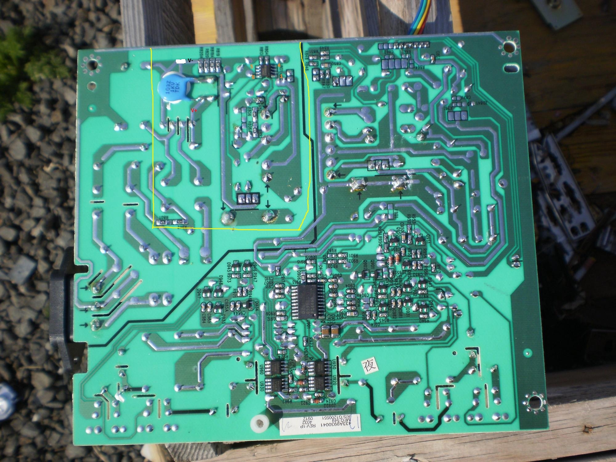

                        #51
                        Re: Neovo F-419 no power.

                          #52
                          Originally posted by BobMollie
                          Is this thread still going. I have a power issue with a Neovo F419 also. The only problem is that my board layout is different the what is being shown here.
                          So show us good clear and focused pictures of your boards to start with.

                            #53
                            Here are some pictures of the power supply board and the logic board. The unit does not turn on nor does the LED power light. I do have 167 volts across C805.

                              #54
                              I have read the articles. Does anyone have a schematic of this board, or any info on the board?
                                #55
                                What DCV do you have at the white connector that has the cable going to the Logic board (disconnect the cable to the logic board first)?

                                  #56
                                  I have 0 volts on everything except the Green had 0.017 vdc and the Blu had 0,05 vdc.

                                      #58
                                      So it is dead without the logic/main board connected.
                                      You will need to check the rectifier diode D841 mounted on the heatsink and D842 to ake sure they are not shorted. If they are OK, then we need to find out if there are shorted circuit in the inverter section.
                                      I will need good clear pictures of the bottom side of the board.

                                        #59
                                        Budm, Diodes D841 and D842 test ok. See the foil side of the two circuit boards.
