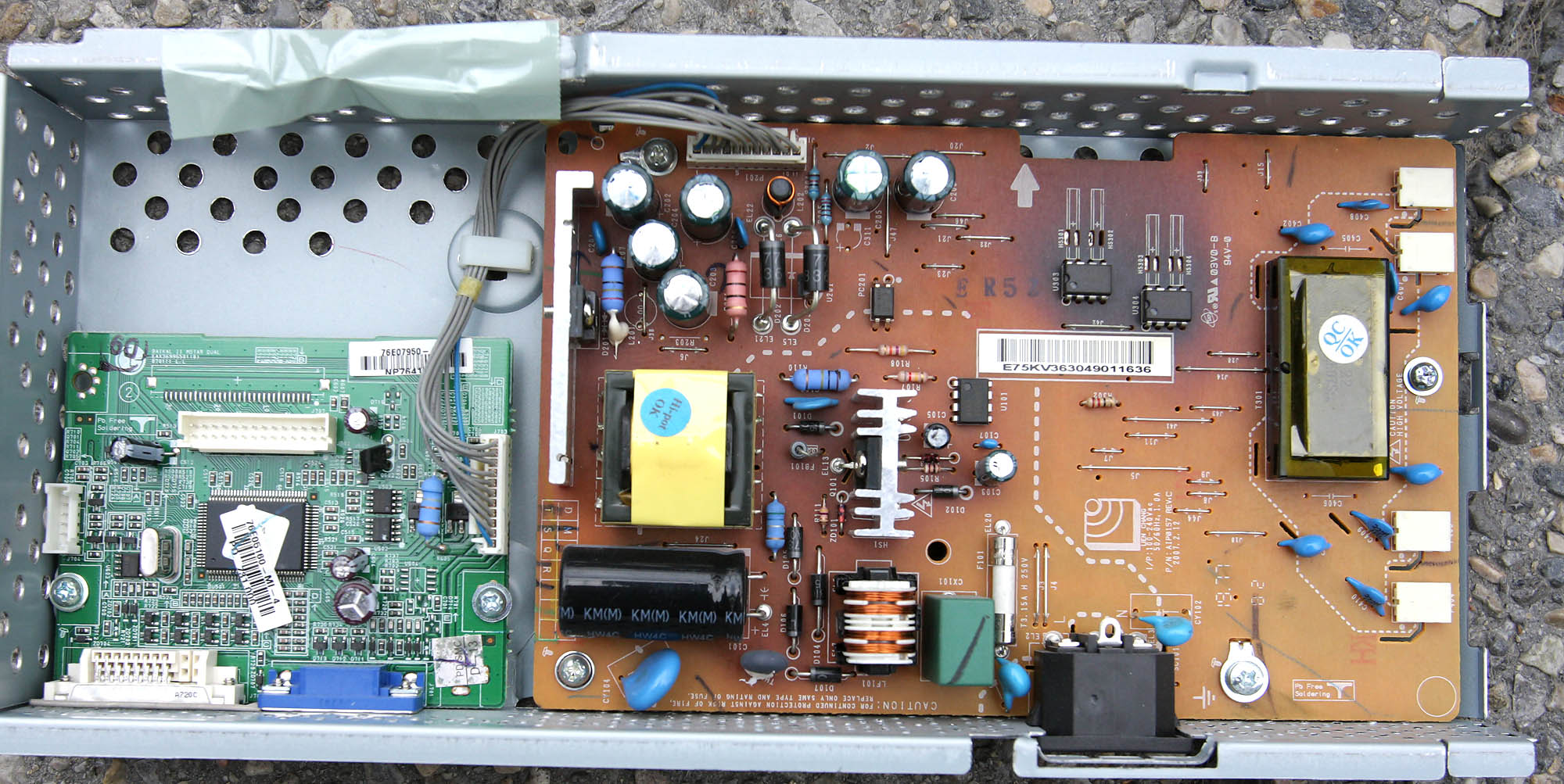

Got a nice 19" LG 1953 from work, just died one day.
I figured this would be an easy recap, but looks like it might be a challenge.
That's ok, it's the only repair on my pile other than the iMac iSight PS, and I'm due for a challenging monitor.

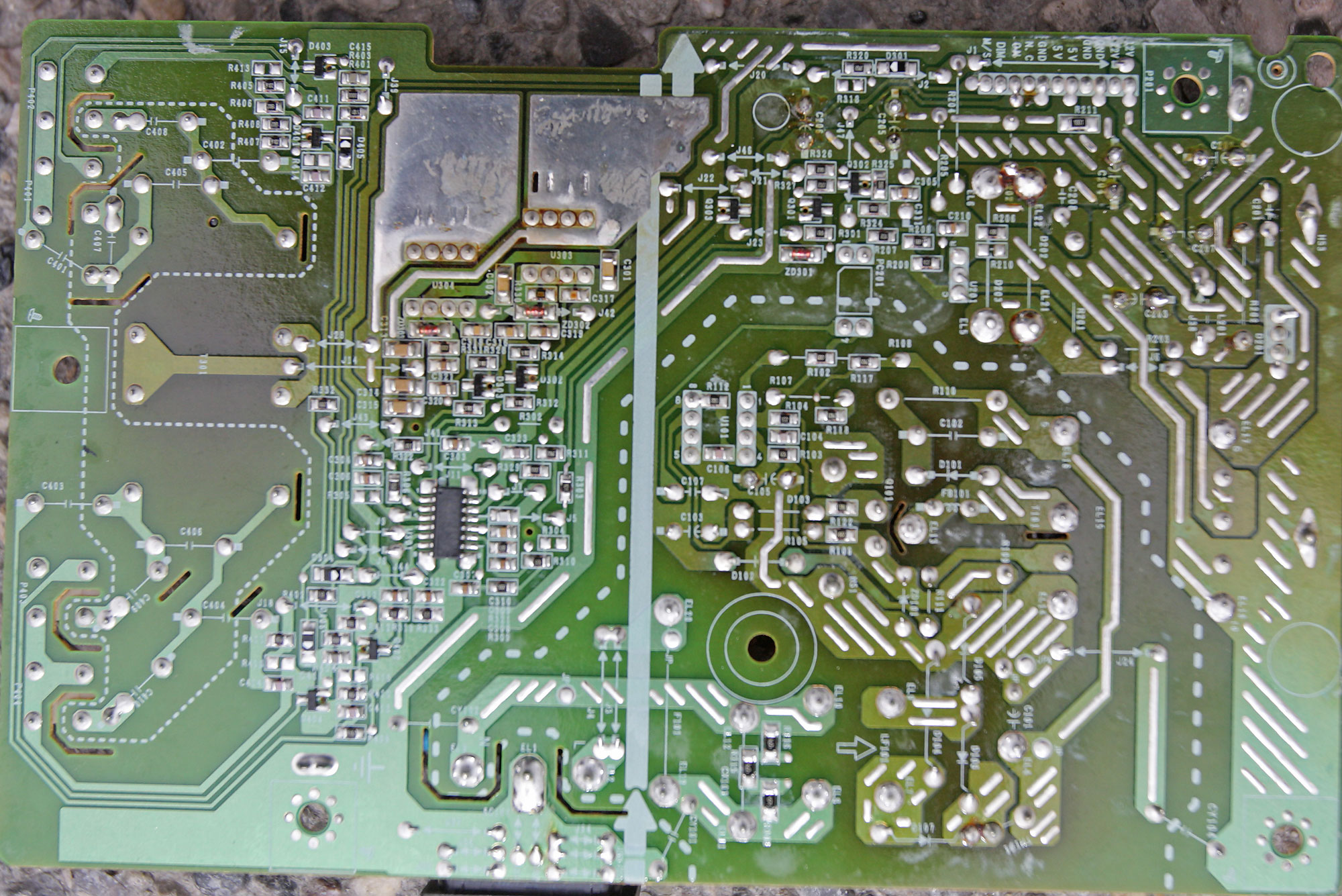

Serious bloatage on the Samxon GFs. I replace all but a 33uf 50v that I don't have stock of, but it measures ok compared to a couple of the 1000 uf 25v that were like 2uf and 50ohms ESR
I test it, still dead.
The dual mosfets 4511GD http://html.alldatasheet.com/html-pd.../AP4511GD.html look like they've been running just a tad warm. Will check them for shorts, and test some voltages tomorrow.
