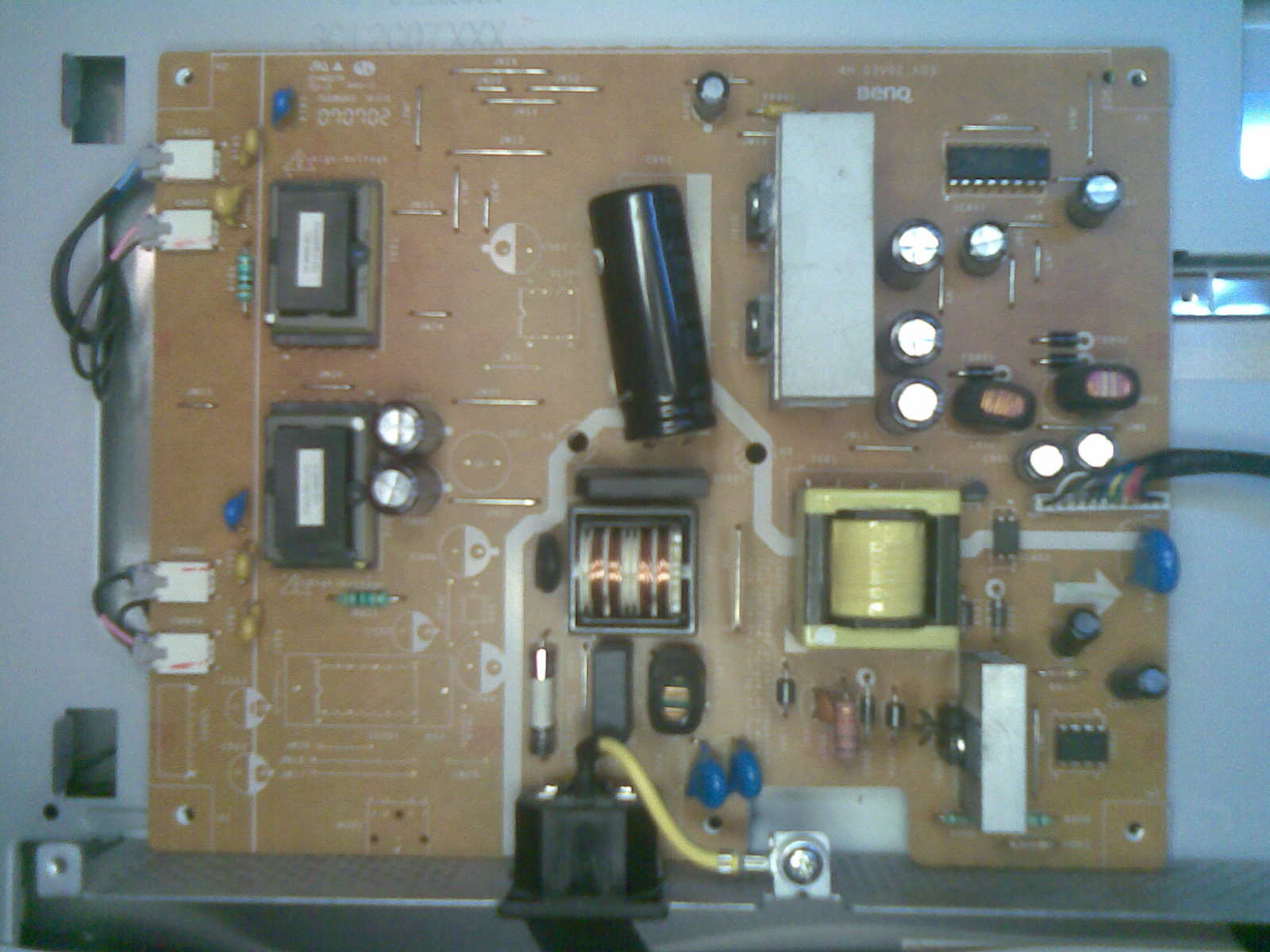

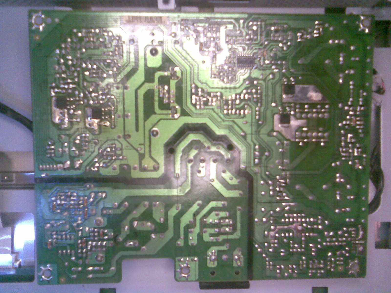

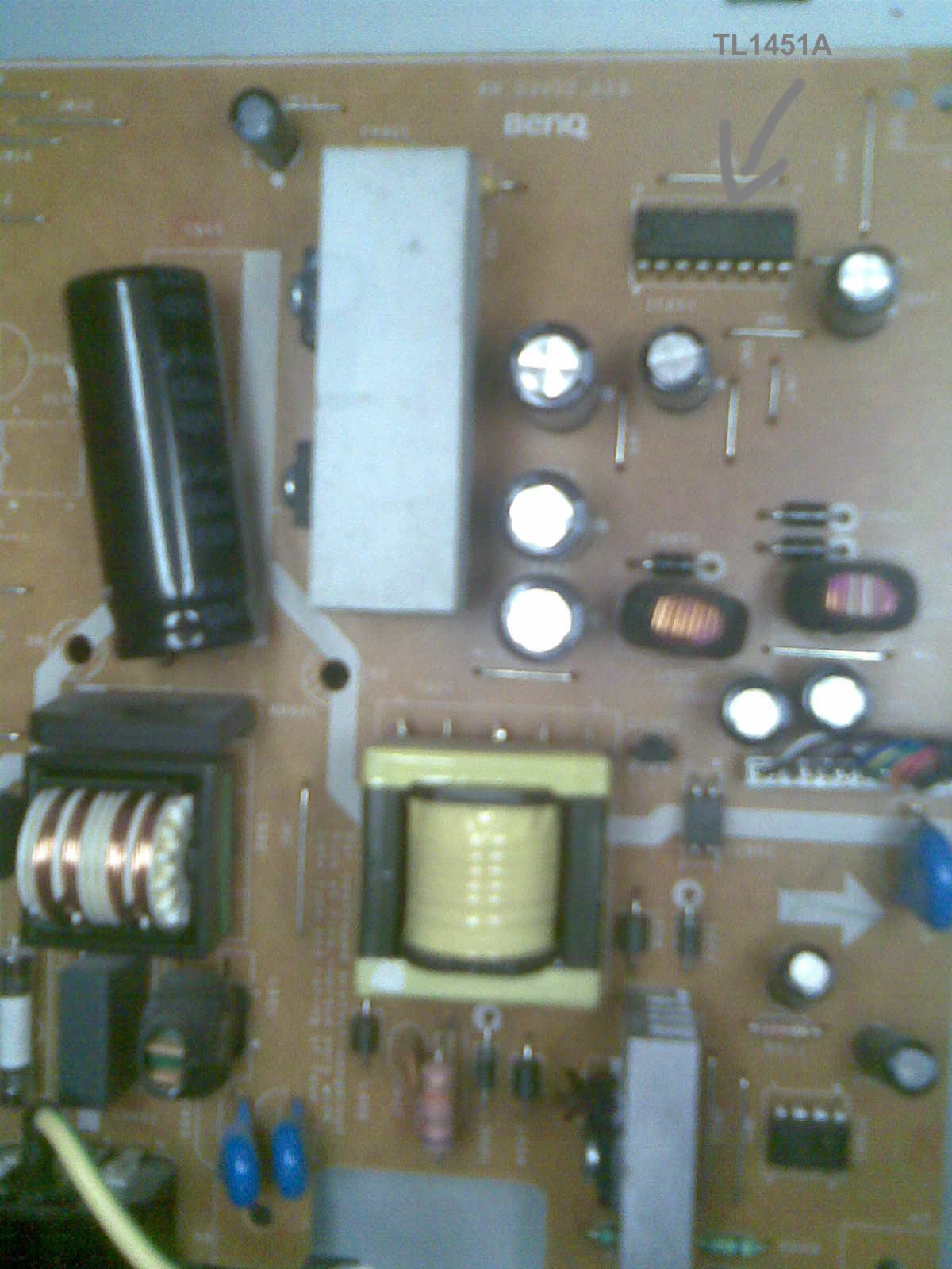

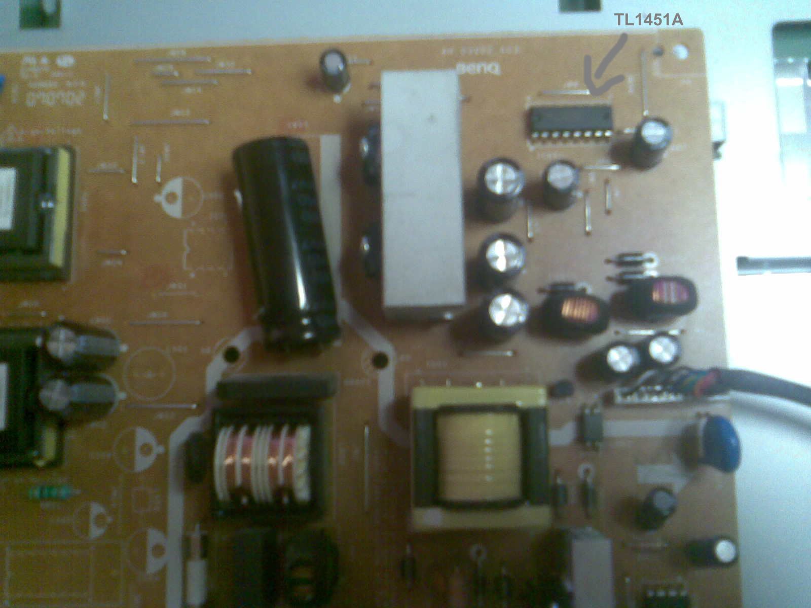

    Benq FP202WA white screen
    One day monitor dies. No led, no nothing. Resoldering, replacing capacitors, measuring semiconductors, no result. One big fuse ok. But, one picofuse opened in Vcc line of TL1451A. Replacing picofuse. Monitor woke up, but only white screen. LED functioning is back. Why only white screen?

    Re: Benq FP202WA white screen
    A few people during reassemby (or during disassembly) have accidentally loosened the connector cable between the logic card and the panel. Check yours.
      White screen often means bad fuse on the video board (the board connected to the logic board, often on the top back of LCD panel).

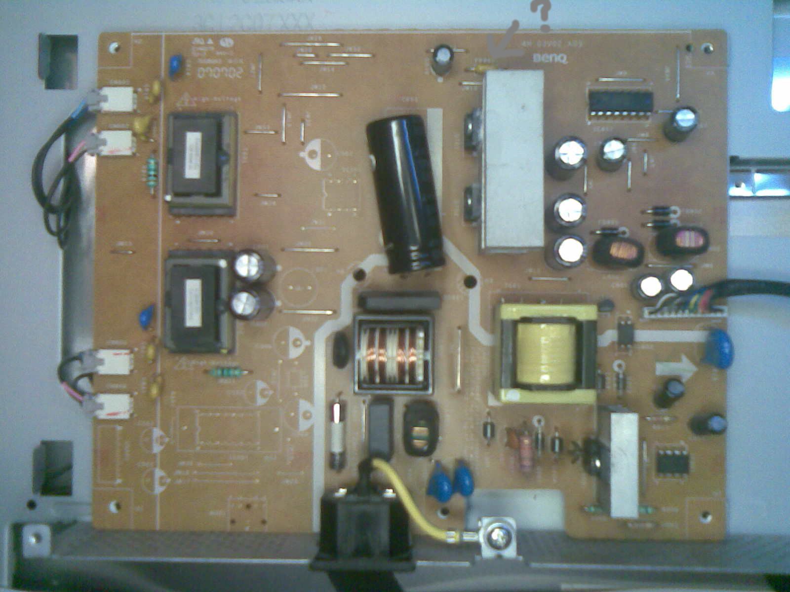

        I have the same problem. No life, no led.
        "But, one picofuse opened in Vcc line of TL1451A. Replacing picofuse."
        Where is the picofuse here?
          I cant see a pico fuse - you cannot be sure that he had the same board as you.
          Please can you delete your pictures and add them using manage attachments.
          Welcome to the forum-
          We can help a lot more if you please post good clear pictures of the whole chassis, and then pictures of each board, front and back (in the same orientation) and close up of connectors, (max resolution 2000x2000 and 2MB) using the manage attachments button, which is found by clicking "go advanced" under quick reply.

            Thanks , so , no pico fuse. Pictures are not good the one of the back is no use at all for troubleshooting.
            Do you have a multimeter and soldering equipment
            EDIT
            Whoa - sorry I think there may be a fuse - a yellow torpedo style right at the top of your picture
            just behind the heat sink - what is the board designation for that F??? perhaps
            That is one reason we ask for good clear pictures.
              Yes a have a multimeter and soldering equiment.
              You mean this? I checked it and it's good.
                Yes - does it say Fxxx near it on the board?
                Are you happy checking High (mains)voltages or do you want to start low?
                  Yeah it says F851(5A) and another one FP801(2A).

                    Well may as well start low. Connect it all up.
                    Meter on vDC 200 put black probe on a ground screw and check all the pins on the connector - right hand side middle of the board. Does it say on the board what the voltages are supposed to be? Take care not to touch any heatsinks, they may be live.
                      Ok. I replace the F851 and now i have the wite screen.
                        I am not following this - you said earlier
                        "You mean this? I checked it and it's good."
                        Now you are saying you have replaced it?
                        Which fuse have you replaced the white one or the yellow one
                        remember I cannot read the numbers so have no idea.
                          The yellow one that i mark one the picture. Thx for your help. Now i'm confused why i dont have picture.
