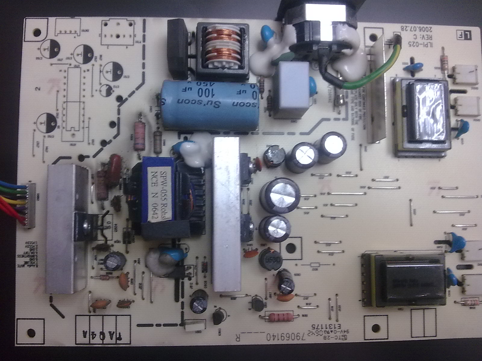

    I got Acer al1916w LCD monitor when i give supply only yellow color light up and nothing. back light off no logo is coming only yellow power light is on.

    Acer monitors are notorious for using several different power supplies.
    There is no way anyone can make suggestions without seeing yours.
    Please include some photos of top and bottom of all boards, using the managed attachments feature you will have to resize to a maximum of 2000x2000 pixels Try to get as clear and detailed photo as you can.

      I agree. Most likely a 700G(900G in this case) style PSU/Inverter board on the inside. Most of the time there are cap problems only.Follow Alexanna's suggestion (and PlainBill's instructions) and post pics of your boards.

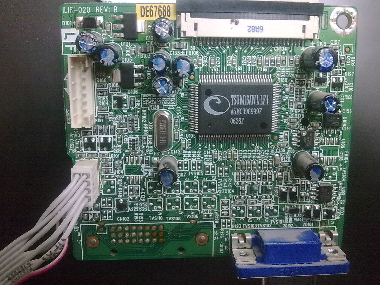

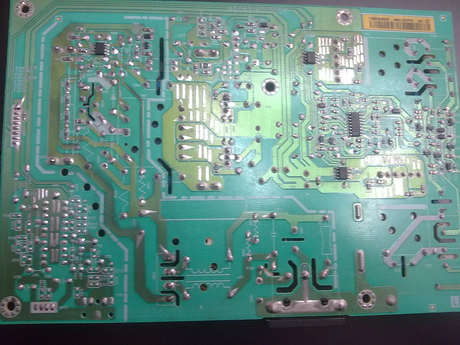

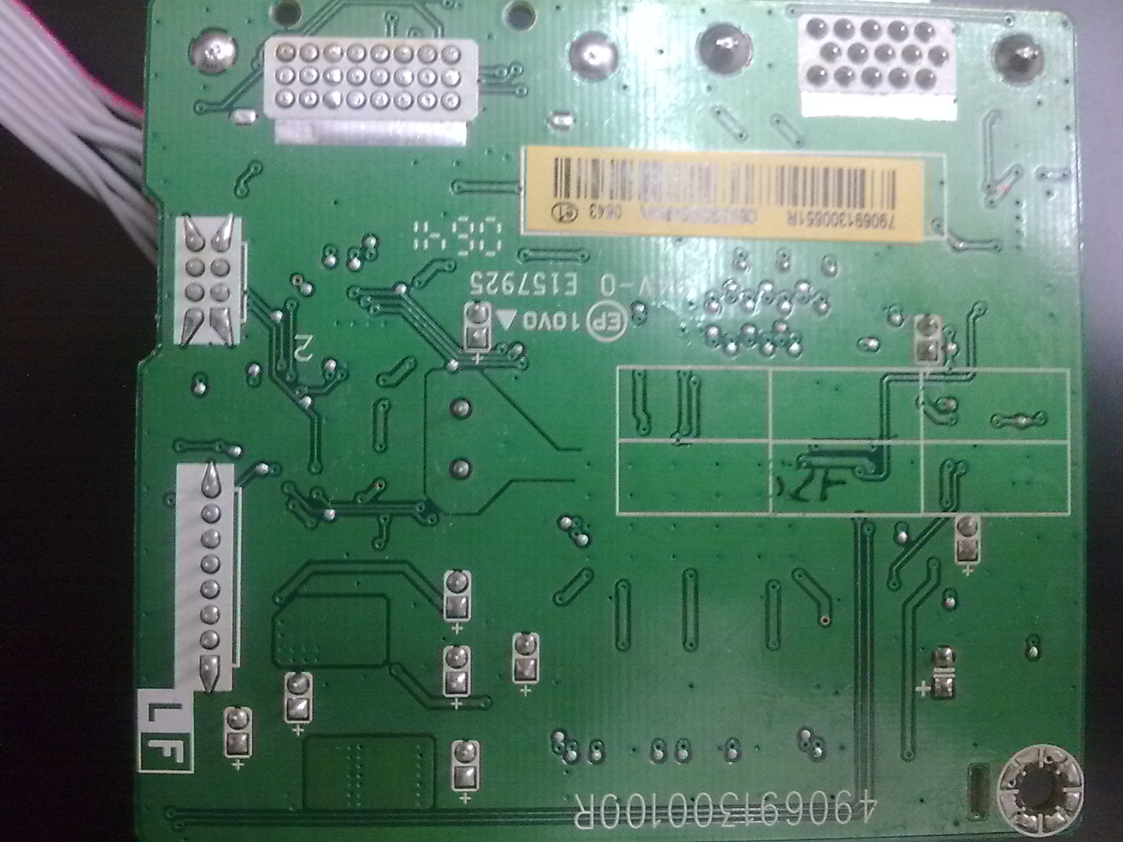

        Hi here are the pics of power and graphics card boards from back and frond side.

          Never seen this one before!

            U106 looks weird on pins 1 and 4, and there's a black blob above it.

              1) If you hookup a working computer to the Acer displaying your favourite wallpaper, can you see it if you shine a flashlight on the lcd?
              2) Check the voltage regulators on the logic board. They are U101 and U102.
              3) When you press the on/off button, what is the voltage on pin 4 on the connector between the power and logic board? Does it change when you presse the on/off button?
                Red herring. U106 contains the firmware. The mark the ICs with colored paint to identify what firmware is on them.
