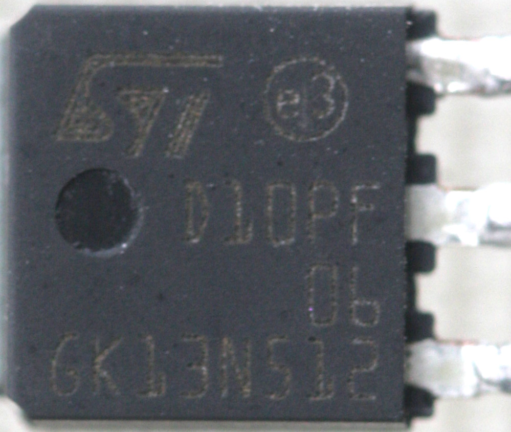

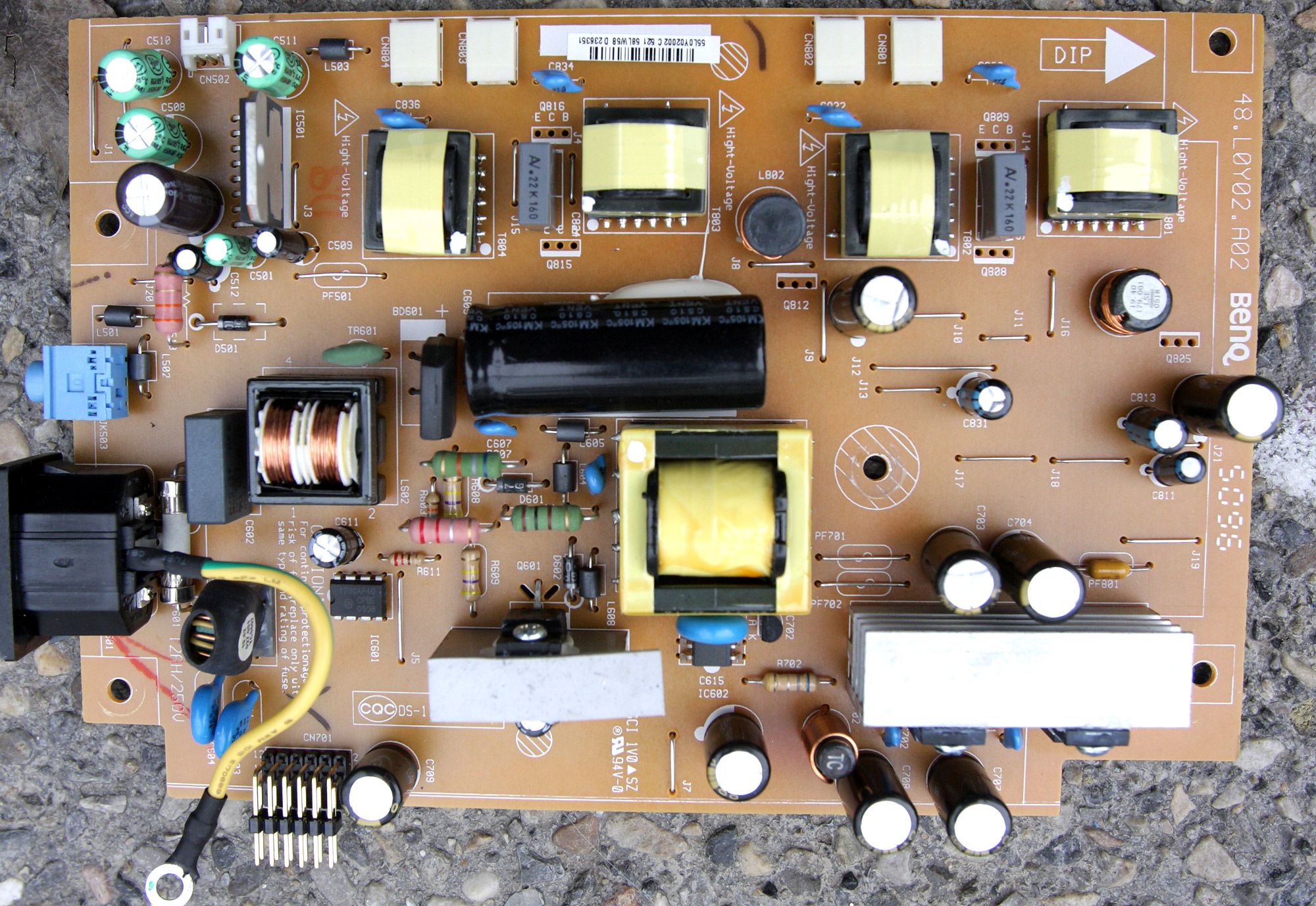

    Working on a BenQ FP71e. Recapped, but still 2 seconds to dead.
    That is, power led comes on for 2 secs, then turns off.
    I figure something is killing the power supply, then I notice its the all too familiar C5707 transistors, and sure enough a couple are shorted.
    Looks like this model uses D10PF FETs instead of the FU9024N.
    Some sellers on Ebay claim they're interchangable. The one that isn't shorted reads very similar to an FU9024N on my Peak tester.
    I have some FU9024s on-hand so am tempted to use them.
    Looking at the Datasheets I'm confused. I don't know jack about FETs so maybe I'm just being stupid..
    THe D10PF says Vds 60v Vdgr 60v Vgs +/- 20v Id 10A
    The FU902N says Vds -55v Id -11A etc. What's up there? They're both P-Channel what's with the negative voltage/current ratings?

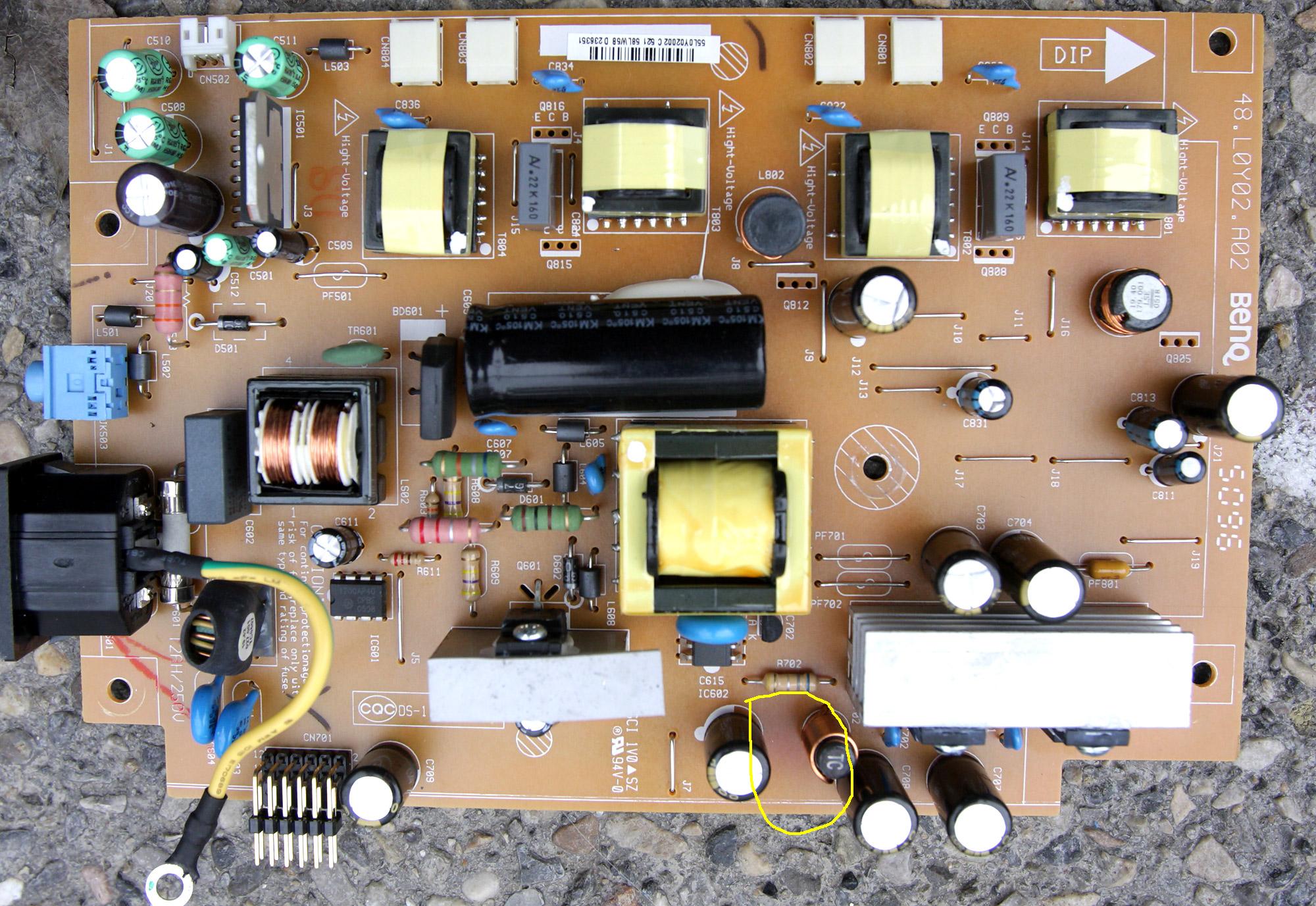

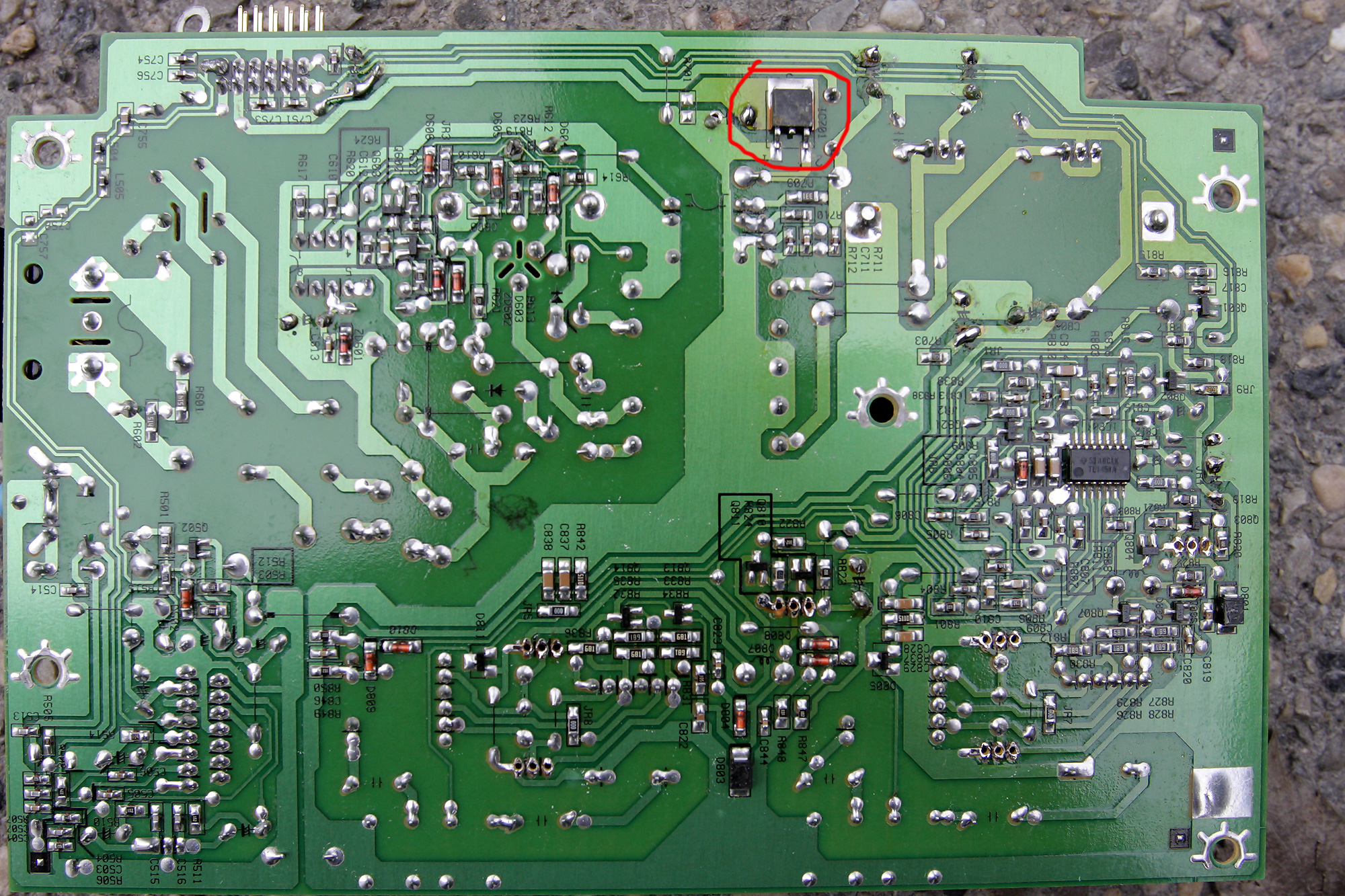

      Hi on the reverse side of the board (ringed in yellow on the pic 0
      Is there another under there FQU11P06 should be the number on that part if so that can be replaced by a FU9024
      Looks to be a burn mark worth a check not sure about the others tho

        You're right it does look like that part of the board has been hot.
        I'll check that component. It's labelled as IC701 I'll have to see if I can get a part number off of it.

          The only marking left on this component is F2 in a circle at the top of the device.
          It looks like a voltage regulator.

            Well I got impatient and used FU9024Ns and it works.
            Will re-assemble and leave on test tomorrow.
            Man that's a crappy quality PCB. I lifted one trace while desoldering (not like me)
            And after I put in one of the 5707s I went to bend it away from a cap that it was touching, and broke 2 traces. fun.

              I had the same issue with another Benq after changing caps and transistors and redoing all solder joints still had the 2 sec to black and it ended up being that component .
              I may have service manual for this one and will try to check to see what its supposed to be

                  If it is IC701 then according to the sheet i have you are right 3.3v reg
                  • smason
                    • 1652
                    Re: BenQ FP71e Q7C4 2 seconds to dead
                    Cool, thanks for the schematics!!!!
