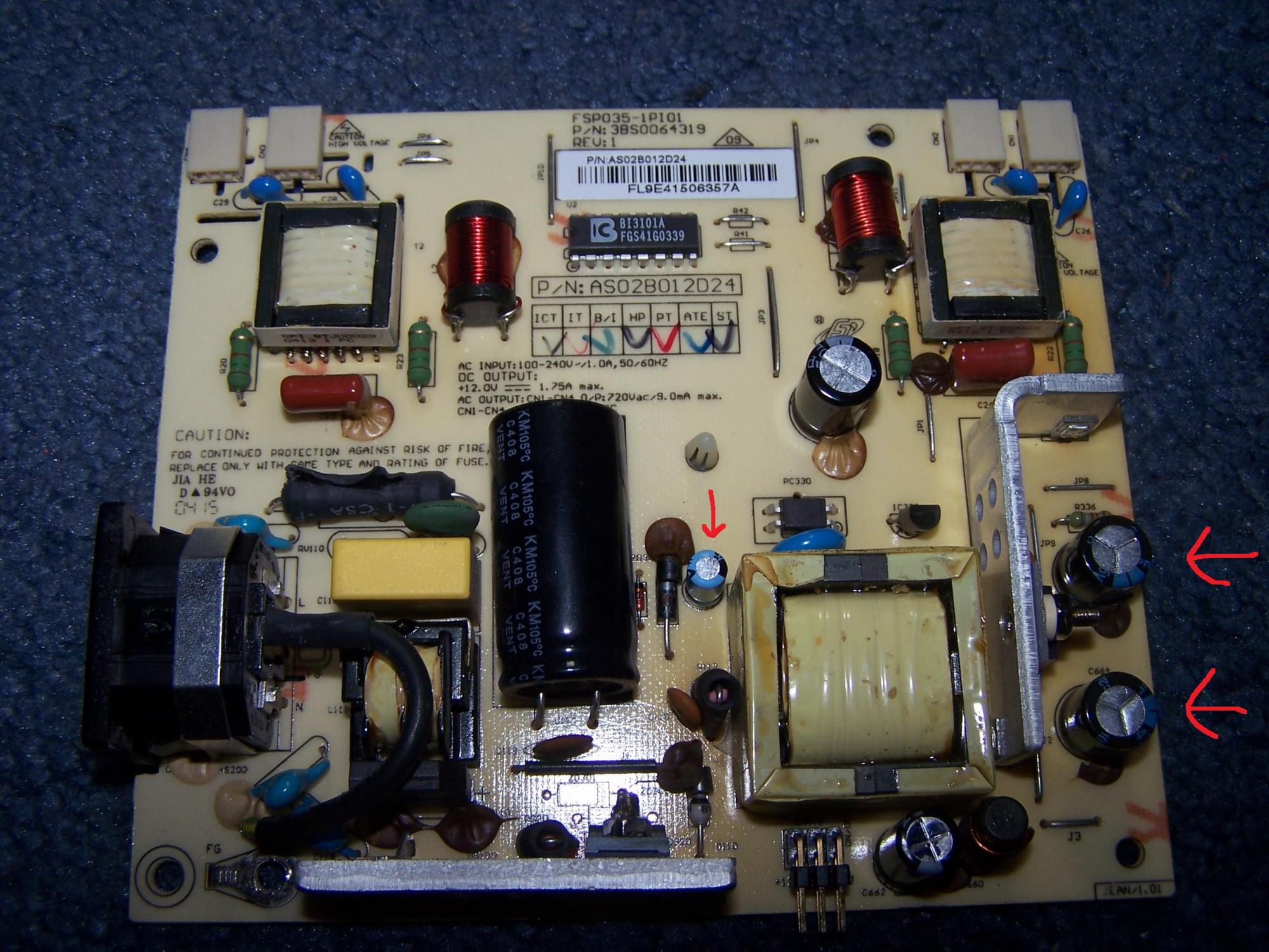

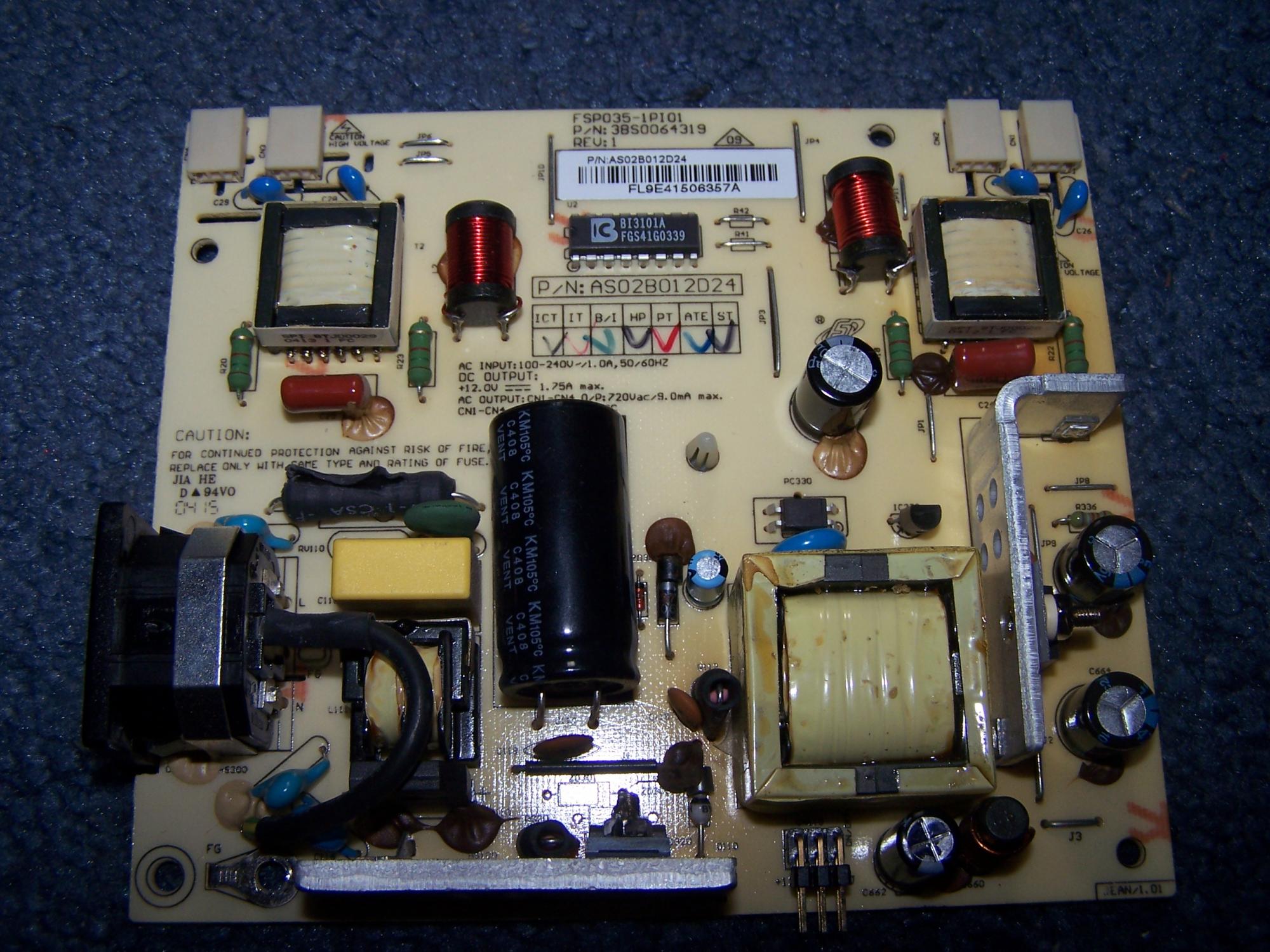

      • koopa8585
        • Feb 2011
        • 6
        Re: Viewsonic vx910 replaced bulging caps but still have blinking green light HELP !!
        The large red arrows were the bulging ones that i replaced. the small red arrow i replaced as well. i am waiting on the 2 330 caps they are in the mail.
        do i have to have the same rating caps? how much can they be off ?
        The caps i used were from radio shack
        i replaced them with the same values
        i replaced the 2 of the 470 uf 25v caps
        and 1 of the 4.7 uf cap

              • Rtech
                • Jul 2010
                • 1095
                The most common faults on this PSU/Inverter,used on a number of VX models are as follows:-
                1) Electrolytic Caps as usual
                2) Failure of T1(top right on your photo)
                3)Failure of brown cap next to it,C24

                  • PlainBill
                    • Feb 2009
                    • 7034
                    Originally posted by koopa8585
                    should i order a T1 and brown cap or could i get away with just buying a new set of electrolytic caps?
                    i have bought QUITE a few worthless parts alredy and i could have just bout a new power supply board by now i would liek to do this as cheap as possible.
                    This monitor also may suffer from shorted transistors in the inverters. You can test them with a DMM. Take a picture of the back side of the power supply / inverter board and I will point them out.
                    PlainBill

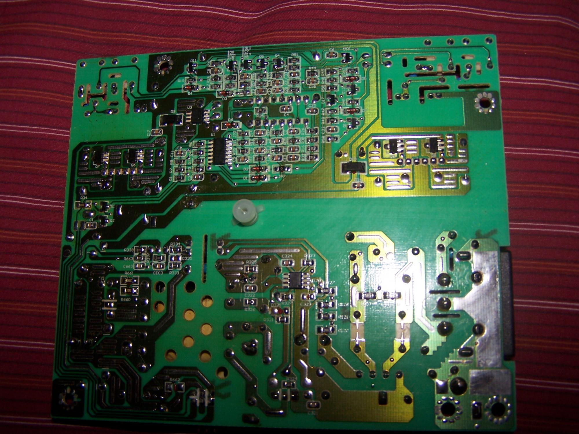

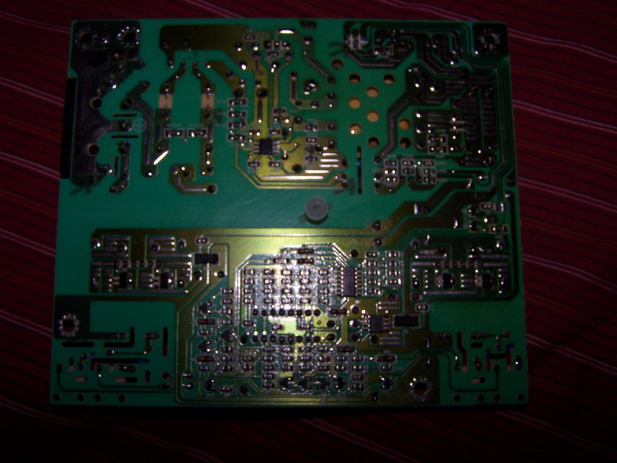

                    • koopa8585
                      • Feb 2011
                      • 6
                      thanks here are some pics
                      • PlainBill
                        • Feb 2009
                        • 7034
                        The first picture is OK, the second is useless. I'm running a little slow today, so rather than mark up the picture, I'll try to do this verbally.
                        On the left side, Q6 and Q7 are the drivers, check them for shorts. Also check the equivalent pair on the right side; sorry, I can't make out the location numbers. Also, check D9 and (I believe) D10
                        PlainBill
