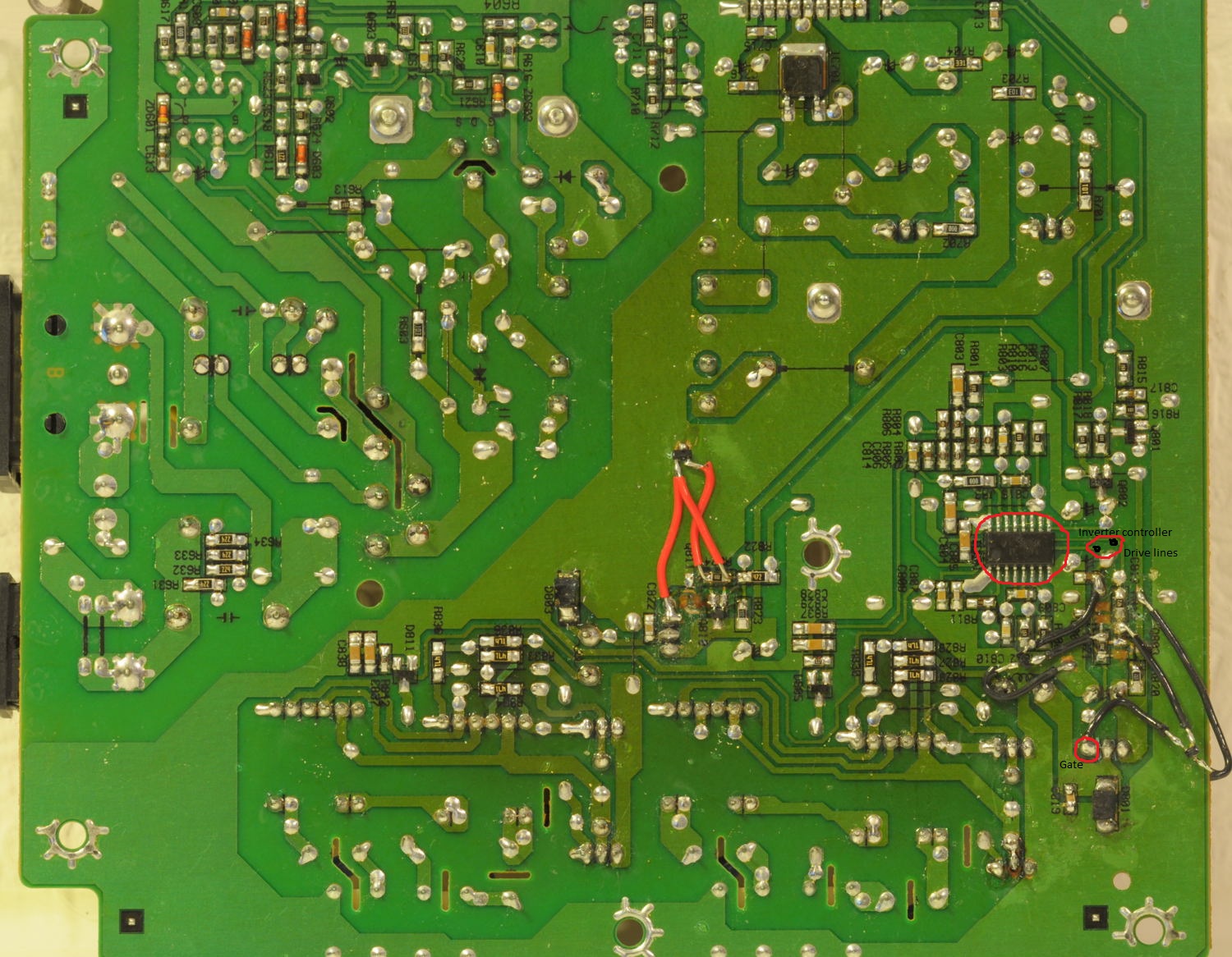

        I have still not managed to solve this problem and I'm wondering if somebody can offer any advice. To review the situation, the monitor comes on fine but when I press the front panel switch to turn it off, the backlight remains on and one half of the inverter circuitry gets hot (particularly the J598). I have only left it hot for a second or so and the parts are still fine and I have replaced them to make sure.
        I have replaced or checked everything I can think would cause a problem but it still has not been solved. I've replaced all the c5707's, both J598s, the fuse, resoldered the transformers and caps, checked the caps in the offending circuit by swapping them with equivalent ones in the other half of the inverter, and I have also replaced the small signal surface mount transistors.

          The gate of the J598 is modulated by the inverter controller. Obviously for some reason that is not turning it off when the monitor goes into standby. I believe ther are usually a couple of transistors used for a level shifter.
          Rant mode <ON> Over and over and over again, I run into the same problem. I can't see the the board, therefor it gets pretty darn hard to advise what area to check. Yes, there are other threads, maybe one of them has a good picture. But if you can't be bothered to supply pictures I'm not going to go looking for them. Rant mode <OFF>

            Apologies PlainBill, however I must assure you that it is not because I couldn't be bothered to upload images but more that I thought the circuit was quite well known to members and people may have had similar problems. I have attached a photo of the front and back although the back has a slightly shameful repair on two of the small signal transistors for which I ruined the copper tracks and had to improvise! The red and black wires have no significance other than what was lying on the table at the time.
            It is Q805 which is getting particularly hot

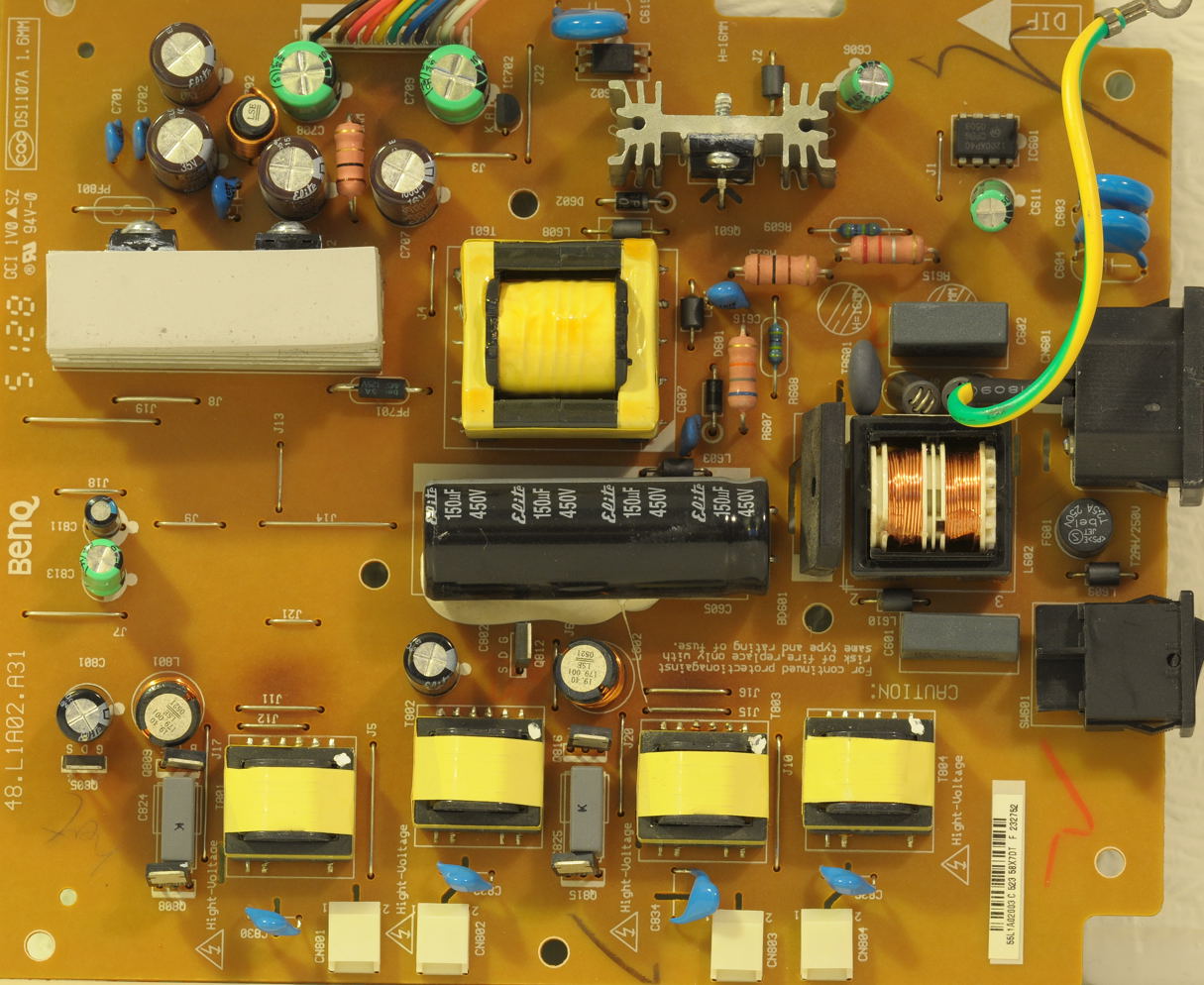

                      How the h**l did you know how I like to label pictures? I was all set to rename it to my standards and it had already been done!!! Threw me off for a minute.
                      Excellent quality pictures, and arranged as I like them. It's easy to identify where the problem is. Exactly what is wrong may be more difficult.
                      The IC circled in red is of course, the inverter controller. Just to the right of it I've identified two lines, one of these is the drive line to Q805. The last point circled in red is the gate of Q805.
                      The service manual for the Benq Q7C3 gives an excellent explanation of how this circuit works. Search for benq_q7c3_fp767_[et]

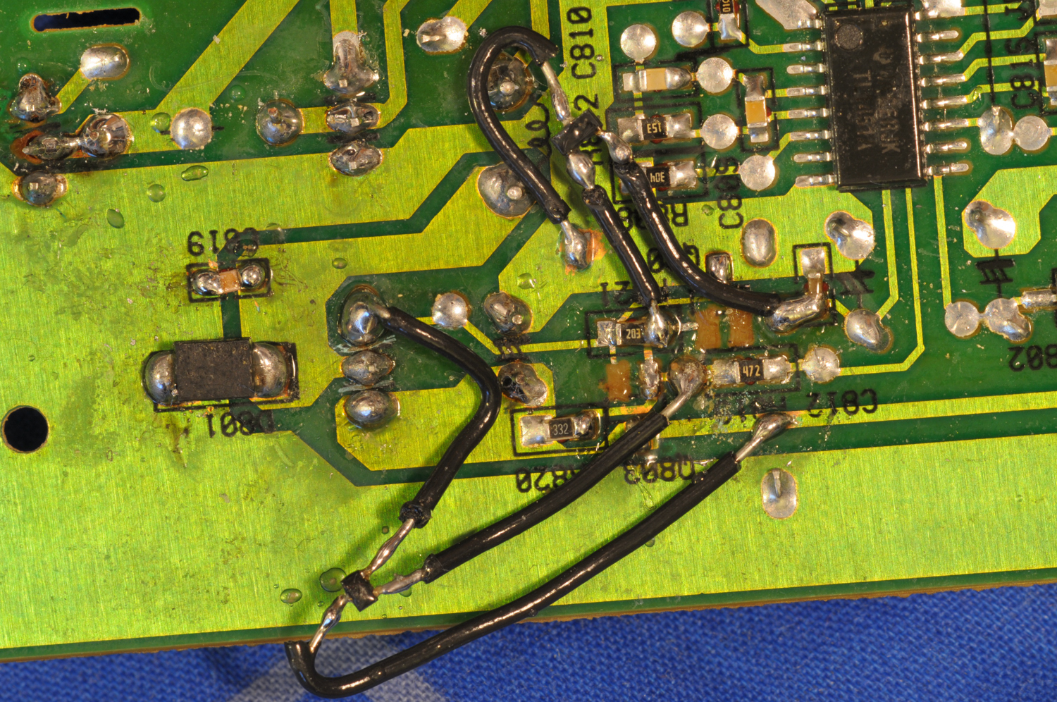

                        Are you 100% sure when you tore up the SMD traces that the jumper wires are ALL going to the proper places. That's a lot of spaghetti and a lot of places for stuff to go wrong.
                        Also recheck the jumper wired transistors with a diode check if they're fine wrap them with electrical tape if they were to tap nearby solder points when the monitor was running they can cause all kinds of havoc not to mention destroy themselves.
                        Those signaling transistors (two per side) signal the two halfs of the inverter on and off by driving the base of their respective FET. The fact that the one side won't shut off and the ON / OFF FETs are fine tells me there is a wiring issue on that sides signaling circuit.
                        I have a spare repaired 1955 inverter board in the parts bin I can take pics of but it's a later revision with SMD ON/OFF FETs so the trace routing may be different.
                        Look at these pics and see if the routing on your board is similar if so I can take better detailed pictures so you can compare your signal transistor routing:

                            PlainBill - The labelling of the photos seemed like a logical method of describing them and distinguishing one from the other. I'm glad you approve! The Service manual you suggested is an excellent resource and will come in handy tracking down the problem. It's not immediately obvious to me where the problem lies though since I have checked most components related to J598 or FU9024 in the service manual.
                            Krankshaft - I can never be 100% certain it is all correct but I rerouted the jumpers so that they went to the same points as originally and also checked the wiring against a circuit diagram and it looked correct. I also have 3 other identical monitors and it agrees with those too. The replacement of those transistors solved my intial problem of the classic couple of seconds backlight flash. Overall I am reasonably confident they are OK, but its a good idea to put some electrical tape on there.
                            The wiring issues you suggest sound plausible and it's where I have been looking for mistakes but I've rechecked on many occasions now and can't see any problems. The diode tester yields results which look ok too. Nevertheless I'll go over it all again and look for any touching joints or suspicious readings.
                            Would the transistors not shutting off properly cause the FET to heat up? I couldn't figure out why that was getting so hot.

                                I have checked the small signal transistors again with a diode tester and there are no shorts. I'm not entirely sure what unit the diode tester works in but the lowest reading I get is around 700 and the rest are completely open circuit which is consistent on all transtors in circuit. The 700 reading is when the negative lead goes to the base and the positive is on either of the other pins. Reversing the leads is gives a reading of 1 which is open circuit.
                                I've attached a close up image of the area around the suspect circuit. Not sure if it is of any use. One of the transistors looks like its touching another joint but it isn't and there is insulating tape there now to make sure.

                                        I've been checking over the circuit once again and the conclusion of wiring errors/problems seems to be becoming apparent. One track which should be short circuit has a high resistance and the transistor jumpered with the red wires appears to be wired wrong but I need to check this against the circuit diagram.
