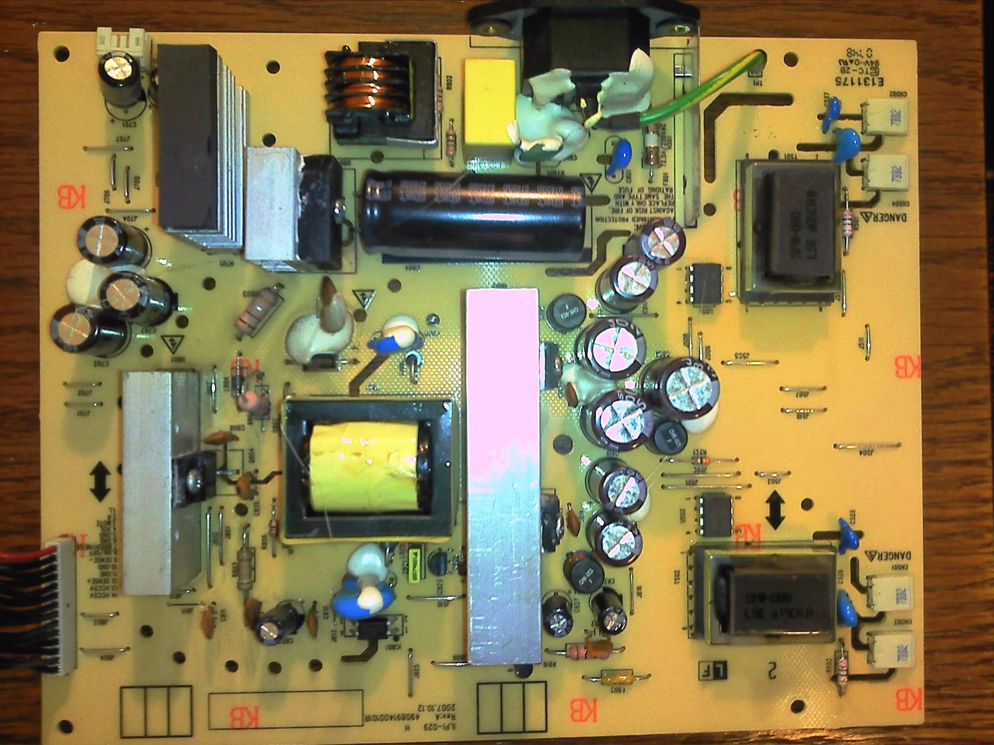

    I pulled the inverter out of an HP W2207 Monitor. Inverter id is: ILPI-029 Rev. A
    490891400101R E131175
    I suspected bad caps(Suscon) so I replaced them all. Monitor worked for 3 hrs. and went back to the same problem. (No Backlight). I checked all the caps and none had failed. I used a Fluke 16 which I find reliable for testing these caps. Any ideas on what else would fail. I suspect the Schottky Barrier Rectifier could be possible. But Ohming it out it tested O.K.

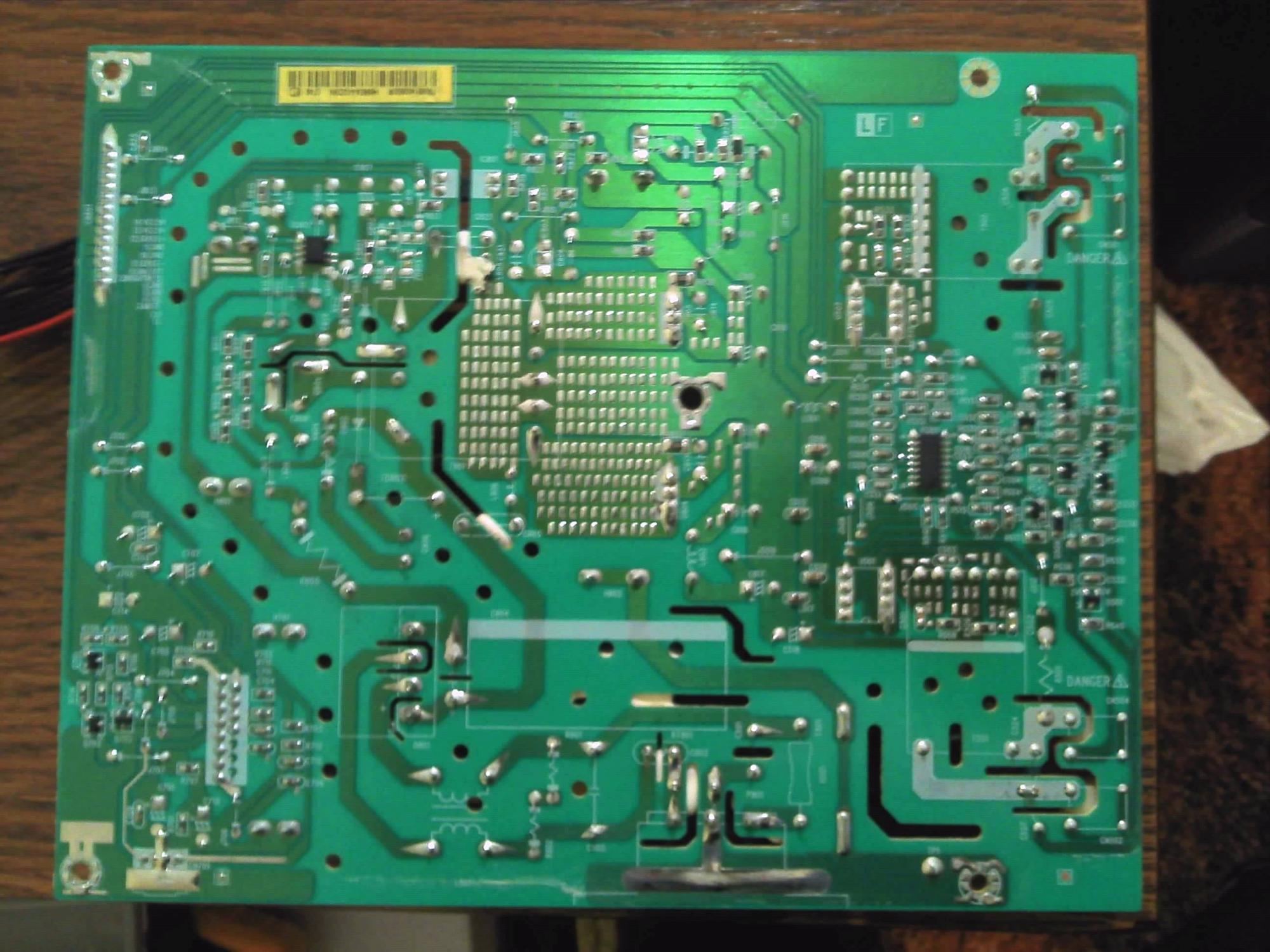

    1) Please post clear focused pictures of your all boards (top down view - both sides of the board) using the manage attachments feature. Please do not post inline or offsite.
    2) A picture of your boards may help others see a "hot spot" or somethiing that is causing the lcd to shut off. I believe there are 3 boards in this monitor: power, logic, and inverter.
    3) Check for poor soldering as well.

      I used Nichicon Caps I purchased from overseas. The board is a 4 lamp power inverter with a amplifier circuit built in for the speakers on the monitor.
      You can see an exact picture of this board here. http://mylcdboard.com/2010_11/ZD100044.html I am not familiar with uploading pictures to BadCaps Forum and I don't want to violate rules. It said to not load photos inline with posts???? I will be glad to send you pictures if you will give me an email address. I doubt the caps will fail ESR because they are brand new. However, If you suggest it; I will replace everyone of them again and see if it cures the problem. I have suspicions about the Transistor C1815GR located at Q801 & IC803. And the Schottky Barrier Rectifier (D79 SP1040C) Located at D805.
        We always want to see your board. Looking at someone's board is like a surgeon operating on you with someone else's xrays.
        The manage attachments button is right below the "post icons" section. Just scroll down.
        Posting inline pictures slows everything down. This is an example of the pics we want
        https://www.badcaps.net/forum/showpo...94&postcount=1

                    I have the same power supply. The problem is almost the same.

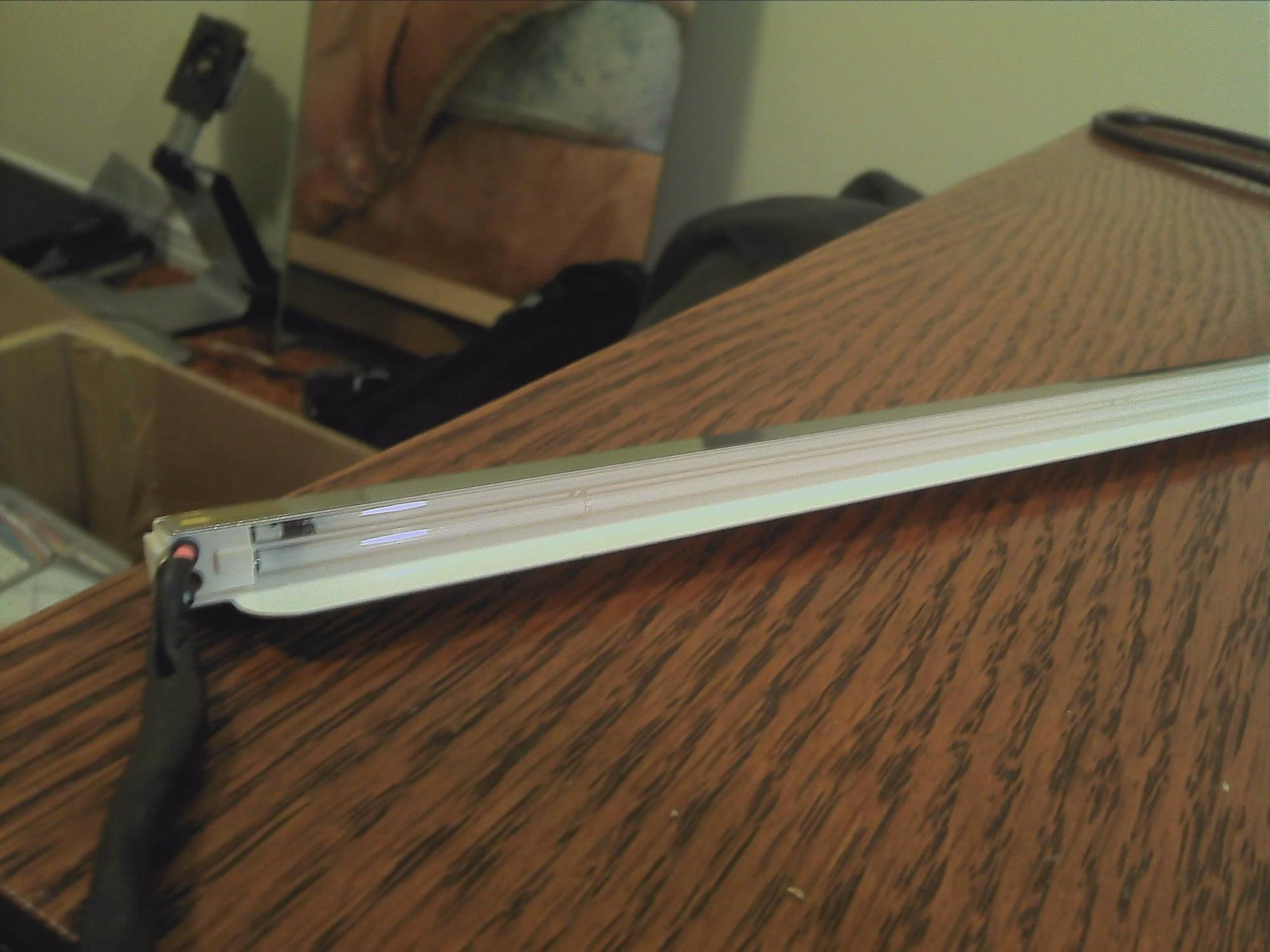

                    When turned ON the coloring is all reddish, but then in few seconds the back light shuts down. Picture is still on the screen when I look carefully at it.
                    No caps are blown.
                    Since no one attached the pictures I uploaded couple of mine.
                      You might be experiencing 2 seconds to black. A reddish or pinkish glow indicates the ccfls are dying.
                      Details and more explained in posts #19 and #20 at
                      https://www.badcaps.net/forum/showthread.php?t=10419
                      Pictures of bad ccfls (pinkish) are also in the above link.

                        Checked the bulbs by inserting one at the time and found the one that gives reddish light! After that I took my LCD panel apart. and found the bad light. Take a look at the pic.

                          I purchased some replacement ccfl's from www.CCFLwarehouse.com through e-Bay not too long ago for a 19" monitor that I fixed. I didn't have any issues with them.
                          http://www.ebay.com/itm/250474949765#ht_1047wt_1163
                          Several members on the forums have used them.
                          • retiredcaps
                            • Apr 2010
                            • 9271
                            Re: HP W2207 No Backlight
                            Replacement tutorial at
                            http://www.ccflwarehouse.com/lasotu.html
                            It is fragile work and you must go slow. If you are easily frustrated or are tempted to use a hammer, you can buy them pre harnessed/assembled from the same site. Obviously it cost more for this option.
