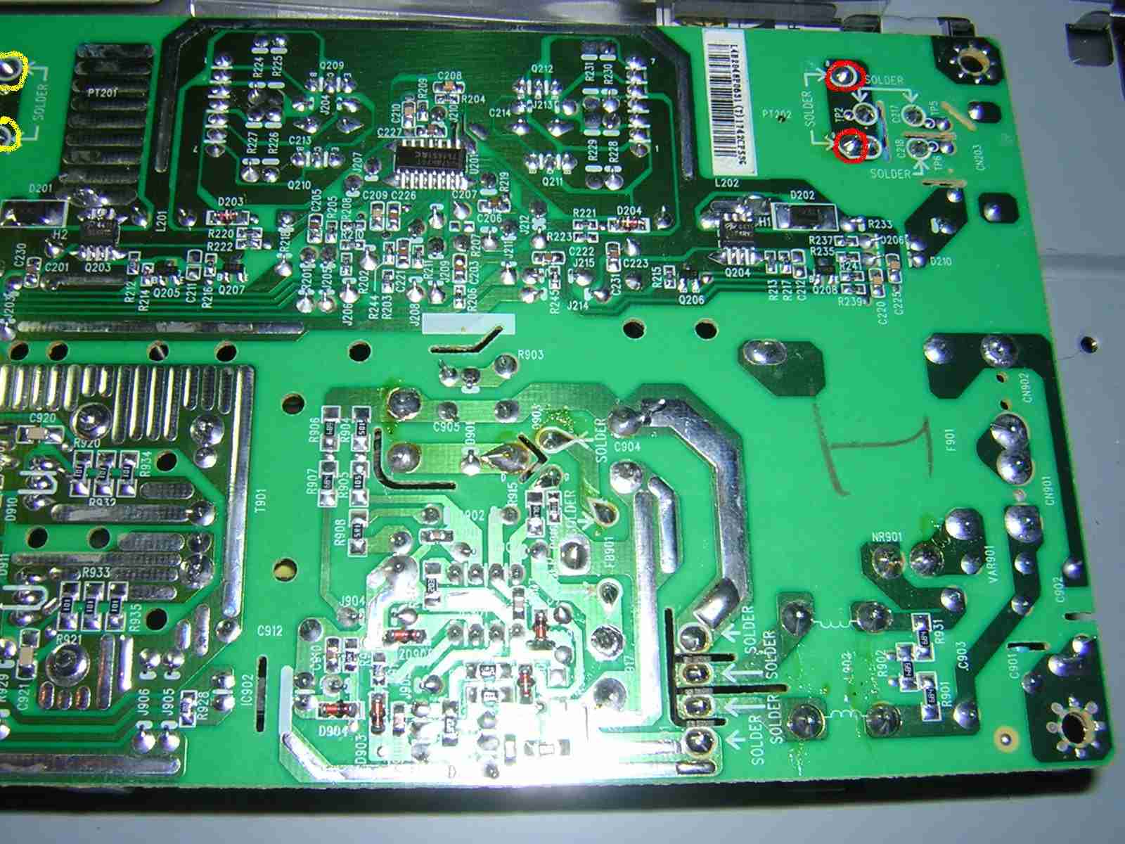

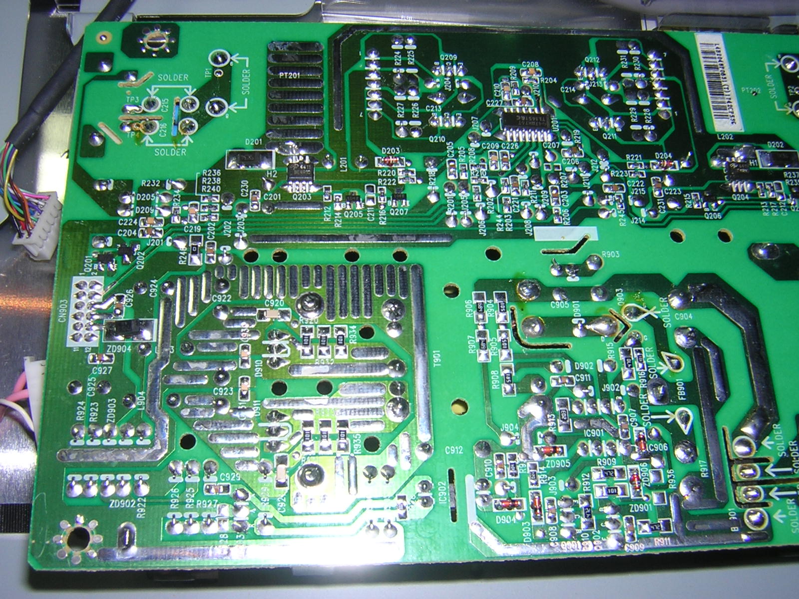

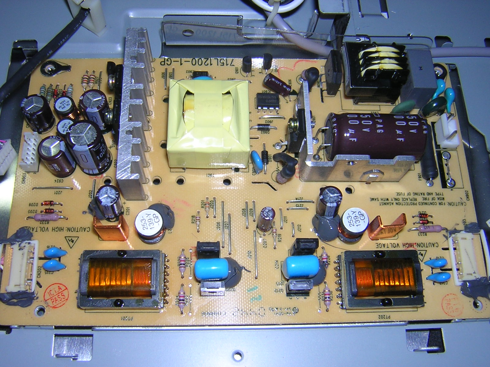

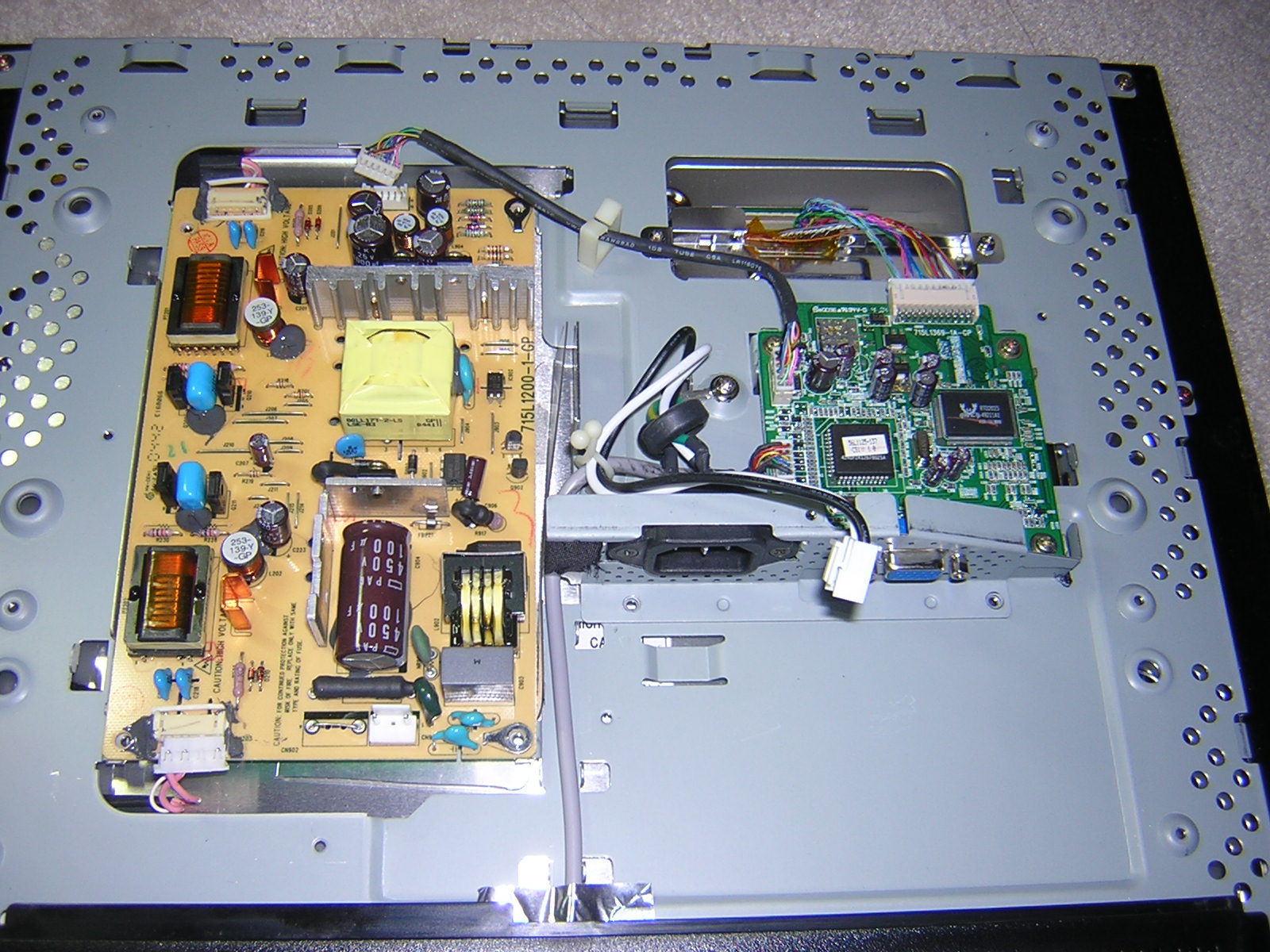

    I have a Sony Monitor that a friend brought me. Is a sony SDM-HS73. It turns on for a few seconds then turns off.
    I checked the bulbs and they seem fine.

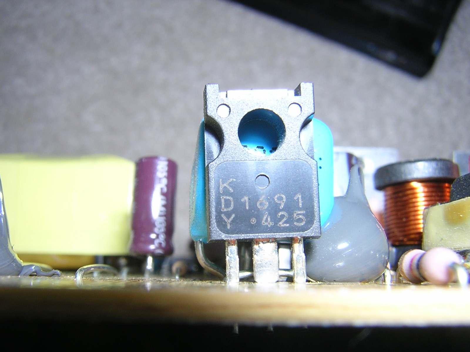

    So looking at other things i found these transistors (i think they are transistors.....see enclosed pic). I ohmed out the components but without a datasheet i am not sure if the readings i get are correct or not. Can someone find a data sheet for this part? I have enclosed a picture of the part in question.

    Re: Sony SDM-HS73 Turns on for a few seconds then black screen
    Its a 2SD1691 NPN Power transistor.
    Google it... Emitter, Collector, Base as your look at the shot.

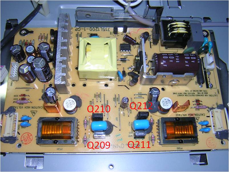

      Check inverter transformers. I circled the pins again. Measure both and report both. They should be within 3% of each other.
        I checked transformer:
        Red measurement: 0.2ohms
        Yellow measurement: 0.2ohms
        I also measured the SD1691 transistors: But i think they are ok.......arent they?
        Q209:
        Red-multimeter wire/Black-multimeter wire:
        Emitter-Collector: 6.34K
        Emitter-base: 6.76K
        Collector-base: 0.5K
        Black-multimeter wire/Red-multimeter wire:
        Emitter-Collector: 267K
        Emitter-base: 265K
        Diode-check:
        Red lead on Base, Black on collector and then emitter.
        Base-collector: 0.346V
        Base-emitter: 0.485V
        Q210:
        Emitter-Collector: 6.33K
        Emitter-base: 6.85K
        Emitter-Collector: 272K
        Emitter-base: 272K
        Diode-check:
        Base-collector: 0.344V
        Q211:
        Emitter-Collector: 5.76K
        Emitter-base: 6.24K
        Collector-base: 0.498K
        Emitter-Collector: 203K
        Emitter-base: 202K
        Diode-check:
        Base-collector: 0.342V
        Base-emitter: 0.486V
        Q212:
        Emitter-Collector: 5.9K
        Emitter-base: 6.35K
        Emitter-Collector: 200K
        Emitter-base: 194K
        Diode-check:
        Base-emitter: 0.488V
        I think these measurements are ok..........arent they?
        Any other thoughts?
          Hmm, I must of identified the secondaries wrong. Let me look again.
          The Q measurements look fine to me.
          edit: Are you measuring the inverter transformer solder joints that are marked 8 and 9?

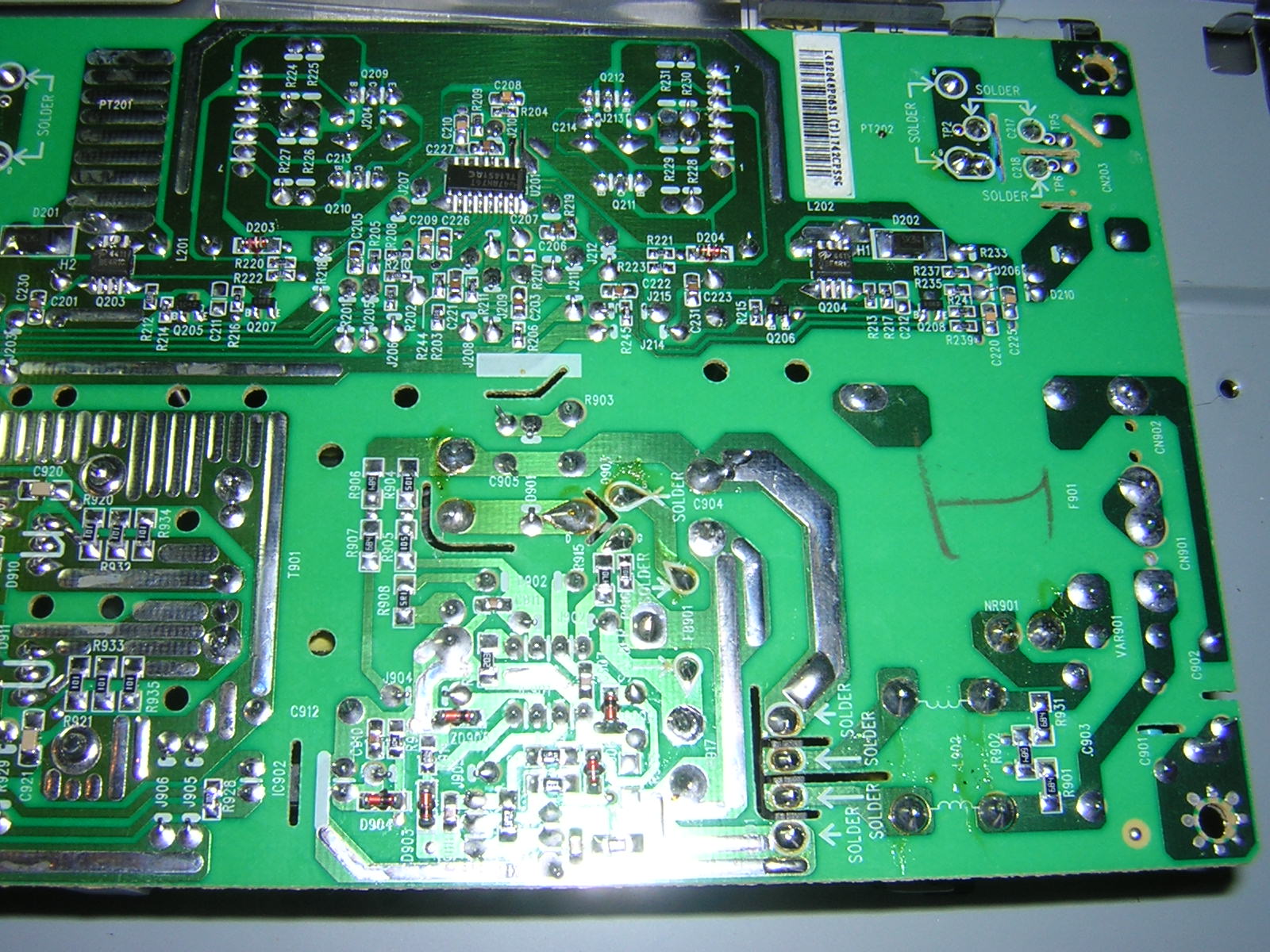

              The transformer pins on the back are numbered 1 through 9. I believe the secondaries are pins 8 and 9 (which I circled). I expected those ohms measurements to be way way higher than 0.2 ohms.
                Looks like 8 & 9 are commoned,which occurs on some boards.You need to measure the resistance from any contact on the red,to the two outside pins on the other side of the transformer,One of those readings will probably give you the secondary resistance.do the same from the yellow.
                    ok..... here are the measurements i made.
                    For the transformer you circled in red:
                    Pin8(red multimeter lead) to Pin 1(black multimeter lead): 6.67kilo-ohm
                    Pin8(black multimeter lead) to Pin 1(red multimeter lead): 236.3kilo-ohm
                    Pin8(red multimeter lead) to Pin 7(black multimeter lead): 263.2ohm
                    Pin8(black multimeter lead) to Pin 7(red multimeter lead): 236.2ohm
                    For the transformer you circled in yellow:
                    Pin8(red multimeter lead) to Pin 1(black multimeter lead): 7.36kilo-ohm
                    Pin8(black multimeter lead) to Pin 1(red multimeter lead): 288.8kilo-ohm
                    Pin8(red multimeter lead) to Pin 7(black multimeter lead): 260.3ohm
                    Pin8(black multimeter lead) to Pin 7(red multimeter lead): 260.3ohm
                    How did you know to measure on the outside pins? Just curious?
                    Do the measurements look ok to you? Kinda interesting that it matters what lead goes where.
                          AS your are SURE the lamps are good ??...AND the transformers and transistors look good,I would heat up the soldering iron and go over everything from the inverter transformers to the lamp sockets,and see if that makes a difference.If it does not then..things get tough....I hate Sony.. when things go wrong,as usually its not straight forward...which is probably why I will not buy faulty ones to repair and resell.

                              I have a fluke 79III True RMS Multimeter. Meter reads 0.2ohms when i touch the two probes together.
                              They way i tested the lamps is i used a 19" monitor to power up the lamps of the monitor in question. But it should be noted that the monitor in question has 4 lamps and for example..........the two top lamps has only one "return" but two hot leads. When i tested the lamps of the "monitor in question" my 19" tester did not "shut off".....ie...i guess it did not detect any issues.

                                  I have had better luck troubleshooting a 2 second to black problem by using known good ccfls on the suspect monitors inverter. It helps if you can have at least one bulb out of the LCD where you can see it.
                                  There is the possibility you might notice something specific to one inverter transformer or on one side of the inverter. The easiest example I can think of is a bulb a little dimmer.

                                    The way you tested the ccfls ,meant that you had an inverter capable of driving 19" lamps, driving 17" lamps, so should be able to do that, with no problem.BUT what you really need to do is test 'like for like',so you really need to use the Sony Inverter etc to try and drive KNOWN good 17" lamps,and that would confirm for certain in what area the fault lies,and as 'alexanna' says its always better to use 'loose' test lamps,then you can see brightness,and in some cases,you can get an immediate idea of whether the fault is top or bottom.
                                      ok. First let me say thanks to those helping out on this.
                                      Second, let me say...........opps! Monitor actually works.......well it stays on at least. The color is kinda off but monitor works. Apparently you need to have a computer hooked up to this monitor otherwise lamps shutoff. Now i know what your thinking.......lamps will always shut off if you dont have video connected........and this is true.......but with this monitor it happened quicker than i had seen before and so i thought it was "shutting off" as i could still see a faint image on the screen once lamps shutoff with no video connected.
                                      Anyway, monitor works in the sense that it does come one and stay on.
                                      But i would not have figured this out had I not been trying to do something to satisfy one of the posts. So thanks guys!
                                      If feel a little stupid...........
