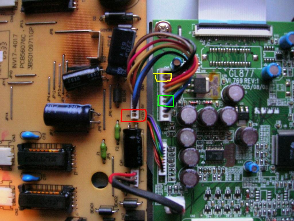

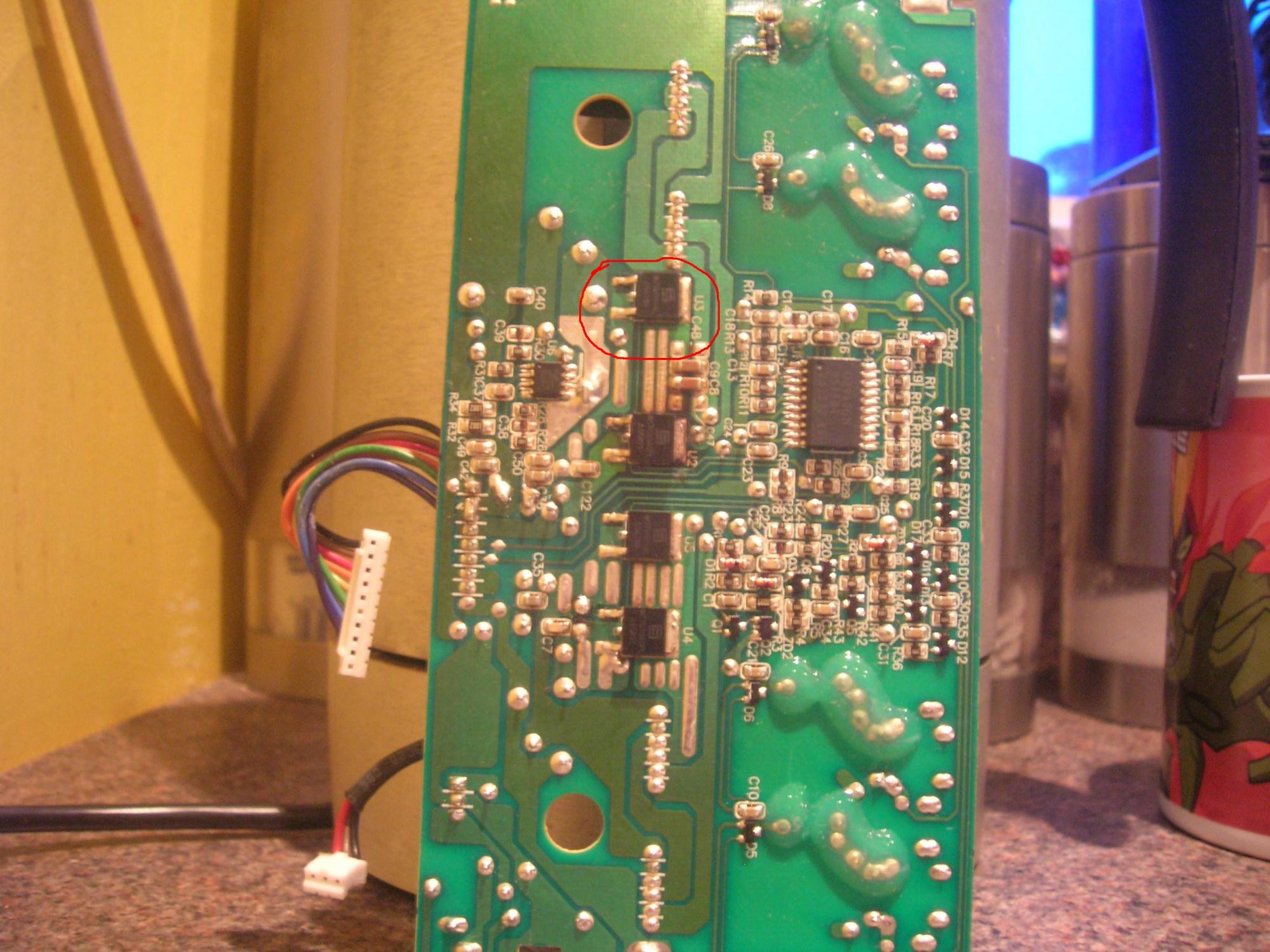

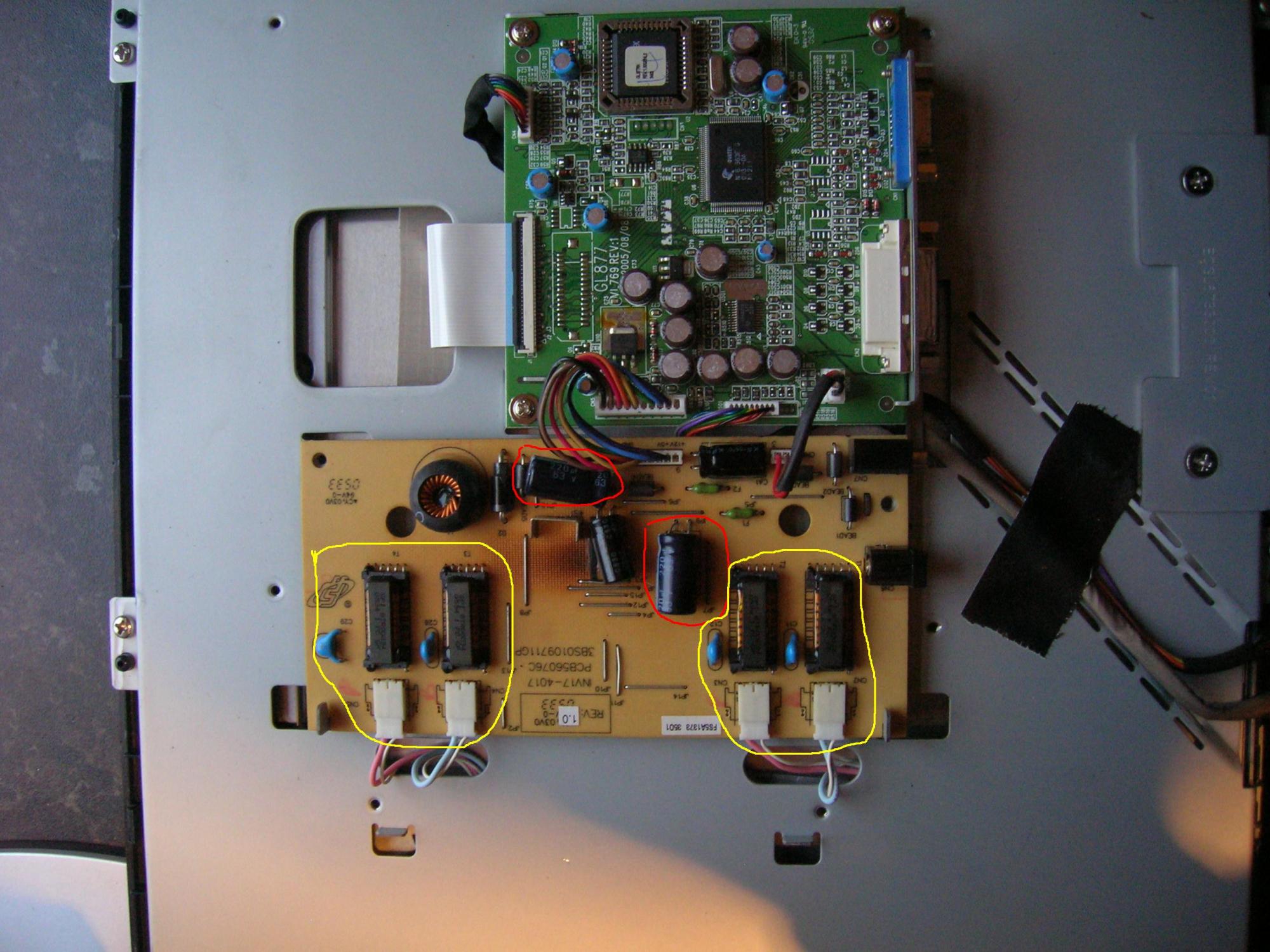

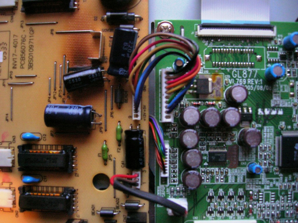

    Hi need a bit of help if possible .
    Have taken the inverter board from this AG Neovo E-17DA

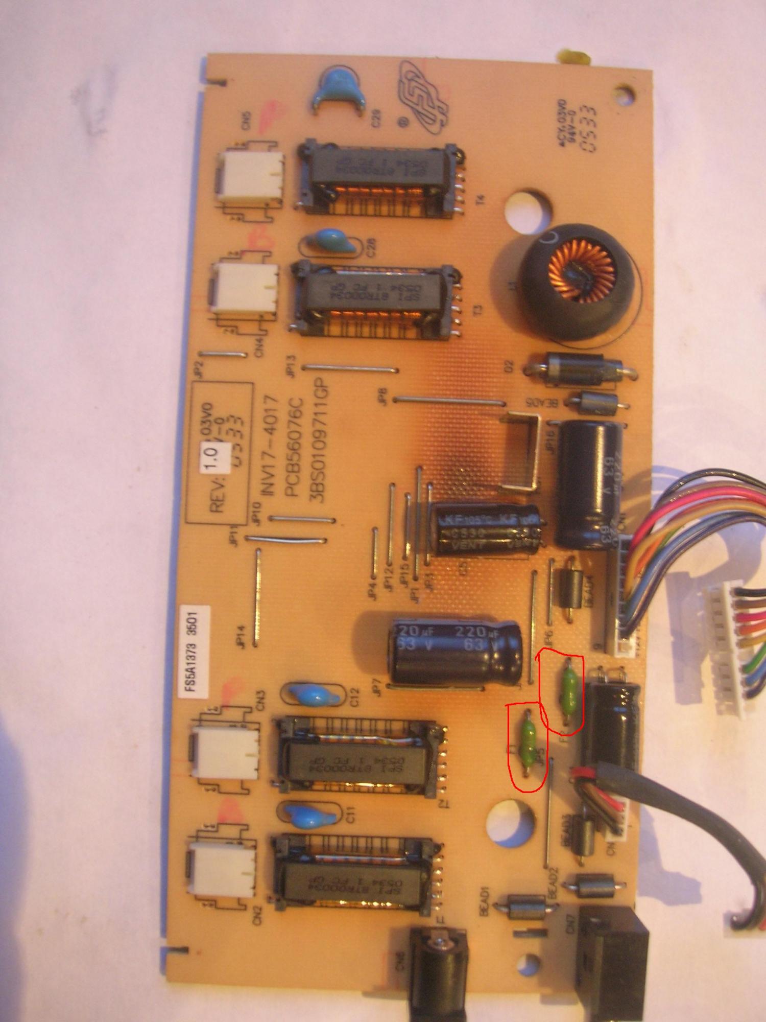

    only to find in picture one that someone has changed 2 of the caps for 63v 220uf whilst the others (still glued) are 25v 220uf Capxon.
    I assume they should all be 220uf 25v 105c.
    Also the 2 green fuses are blown so i need to change those.

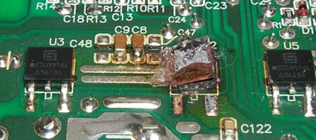

    Picture 2 is of the opposite side and this is where i need the help, one of the
    transistors has burnt out (STU2040PL i have attached a datasheet )
    I cant seem to find a match and was wondering if anyone else had dealt with one of these and knew of a match .
    I have done searchs and checked lots of data sheets but there are so many variations i must admit i am getting a bit lost and until i can sort the power board i cant move on to test the rest of the monitor.
    Any input i would be grateful

    Fairchild shows a FDD4243 as a possible substitute for the STU2040. And International Rectifier shows a IRF5305 as a sub for the FDD4243. There are differences in the current and Rds ratings, but the 20A the STU2040 is rated at is a bit of an extreme anyway.

      Thats great thankyou have ordered them now just gotta find the right fuses
      and change the caps

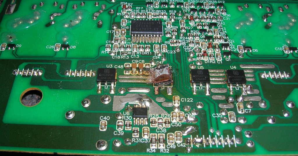

        Ah well got the parts i needed only to find when i started to change the blown part that it had taken out the track beneath .
        Now think better off trying to find another inverter board than rescue this one ,but will keep it for parts that may be useful.
        I have some universal inverters but i think wiring one of these in would be a pain as would have to get a 12v supply to it first, then sort the other wires.
        Thanks for the help

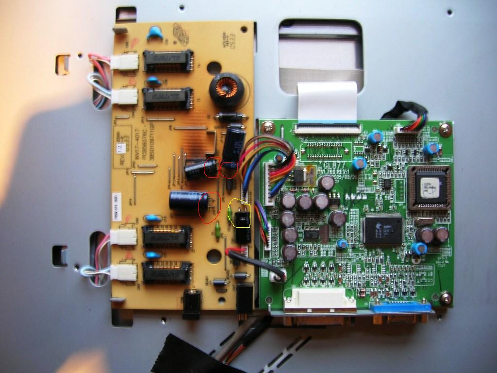

          Futher to earlier post i reassembled the unit after solering on some 4 amp fuse wire to the old fuses (not ideal i know) so i could try to measure voltages on the wiring.
          Even though the transistor is not in circuit suprisingly the screen flicked on then off so bulbs ok and vid card seems ok.
          Now my question is if i work out which wires supply the inverter power and connected them to another inverter (universal one i have) do you think the sense circuit would still shut the monitor down
          Picture shows caps with power going to them
          3 reds = 12v
          1 yellow = 5v

            Yes the sense circuit could still shut the monitor down because the ccfl tubes or the wiring could be suspect. Your observation that the screen flicked on then off could indicate a dying ccfl tube or bad wiring.

              Tested tubes with another inverter board (trusty old xerox unit)
              The screen flicked on and off again because i could not replace the
              STU2040PL P channel transistor as the pad is trashed .
              Just thought there may be a way to use another inverter to bypass the sense circuit using the wiring that is there

                If you can work out where the pad connects to, you can run a jumper wire to the next component.

                  Dont think thats going to be possible as you can see in the picture that the main pad has burnt off and its taken out some of the tracks, also another pad for one of the legs has come off too.

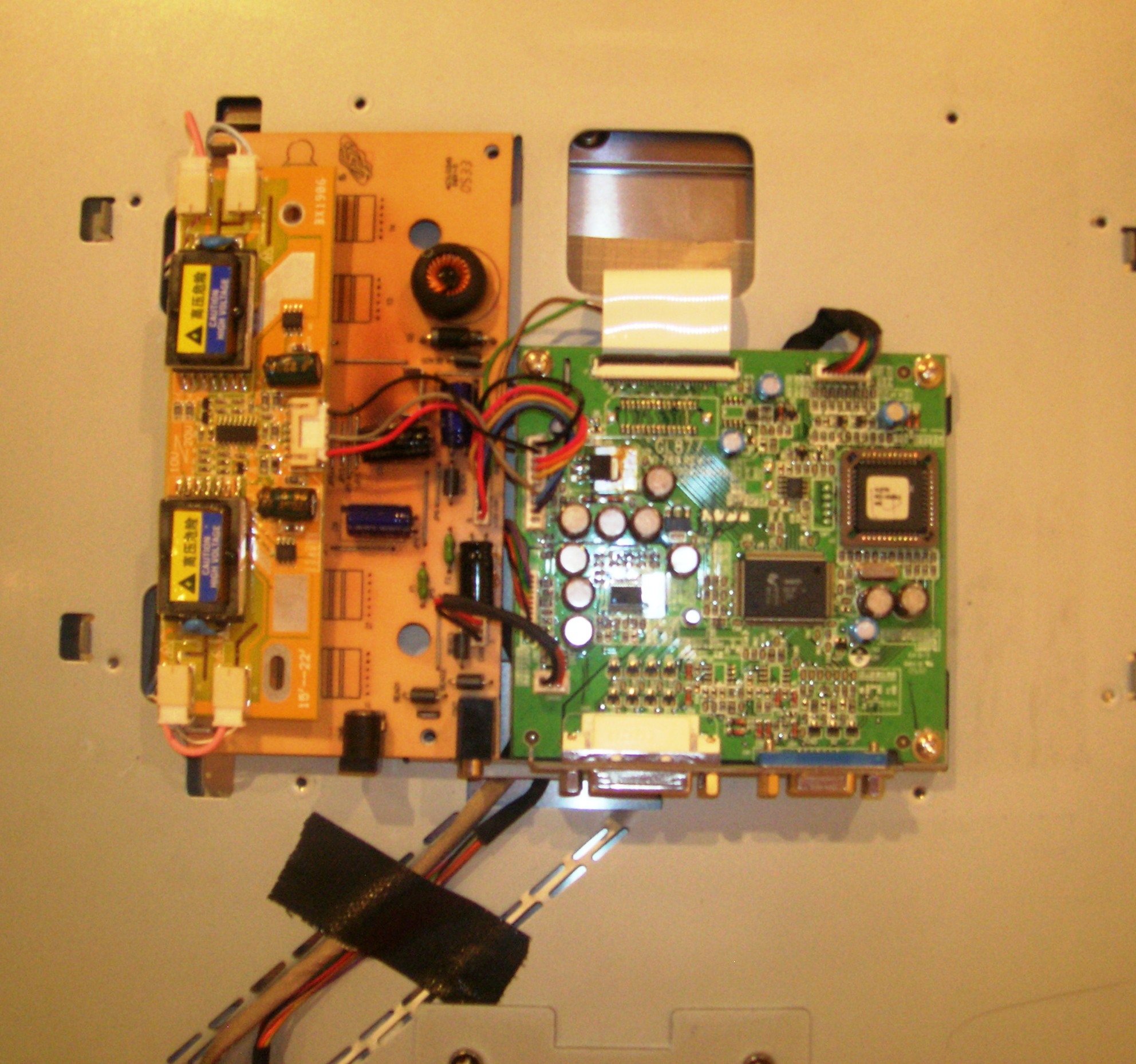

                    Just an update
                    Picture 1
                    red mark soldered in a pin giving 12v DC
                    yellow Ground (removed brown wire to place in grond for inverter)
                    Green on/off (removed green wire to place in grey for inverter on )
                    Picture 2
                    Removed all transformers ccfl plugs and ballst resistors to make a clear flat area for new inverter and replaced the 2 x 220uf 63v with 220uf 25v (kept these in as they are part of the 12v circuit.
                    Picture 3
                    The almost finished product just need 2 x sticky pads to hold the new inverter in place before final assembly.
                    Tested and working even still have all menu controls (brightness ,osd and volume)
