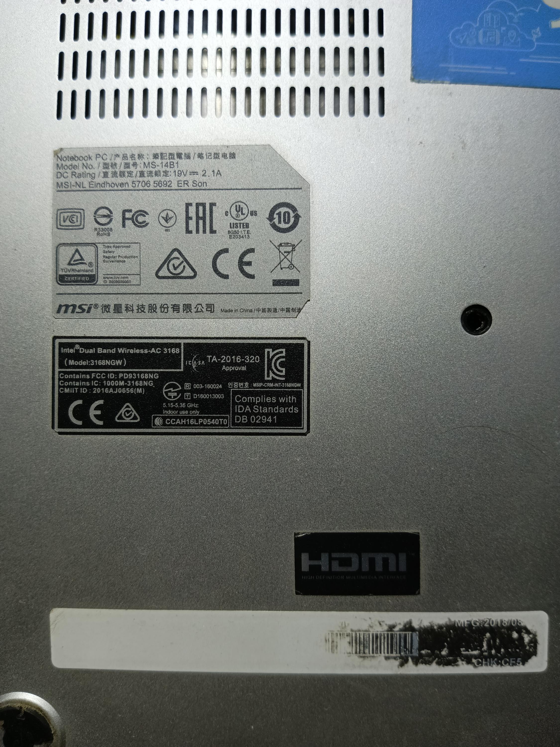

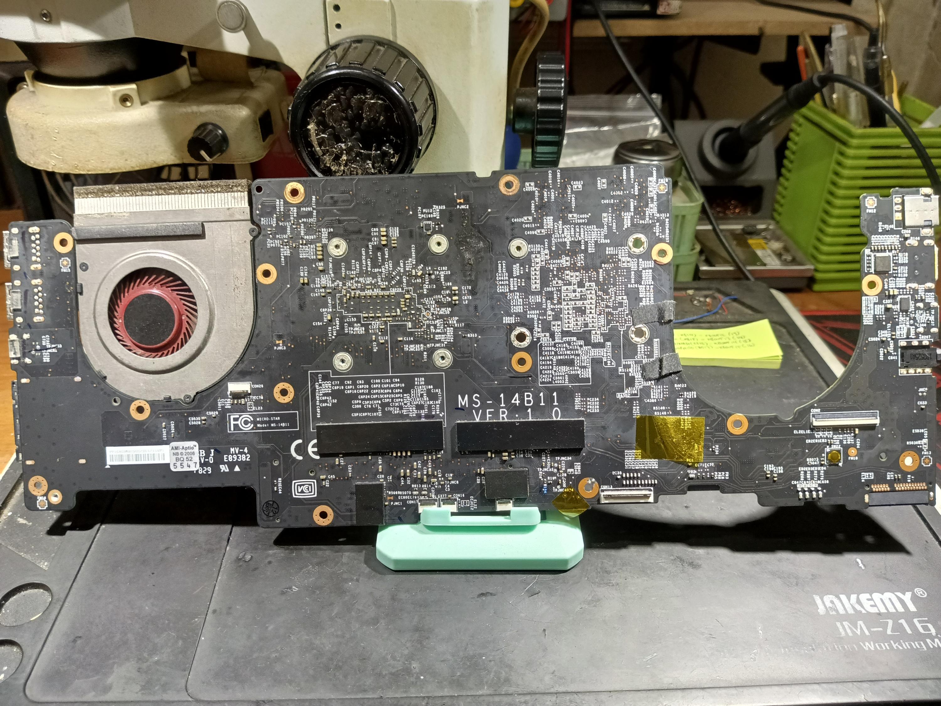

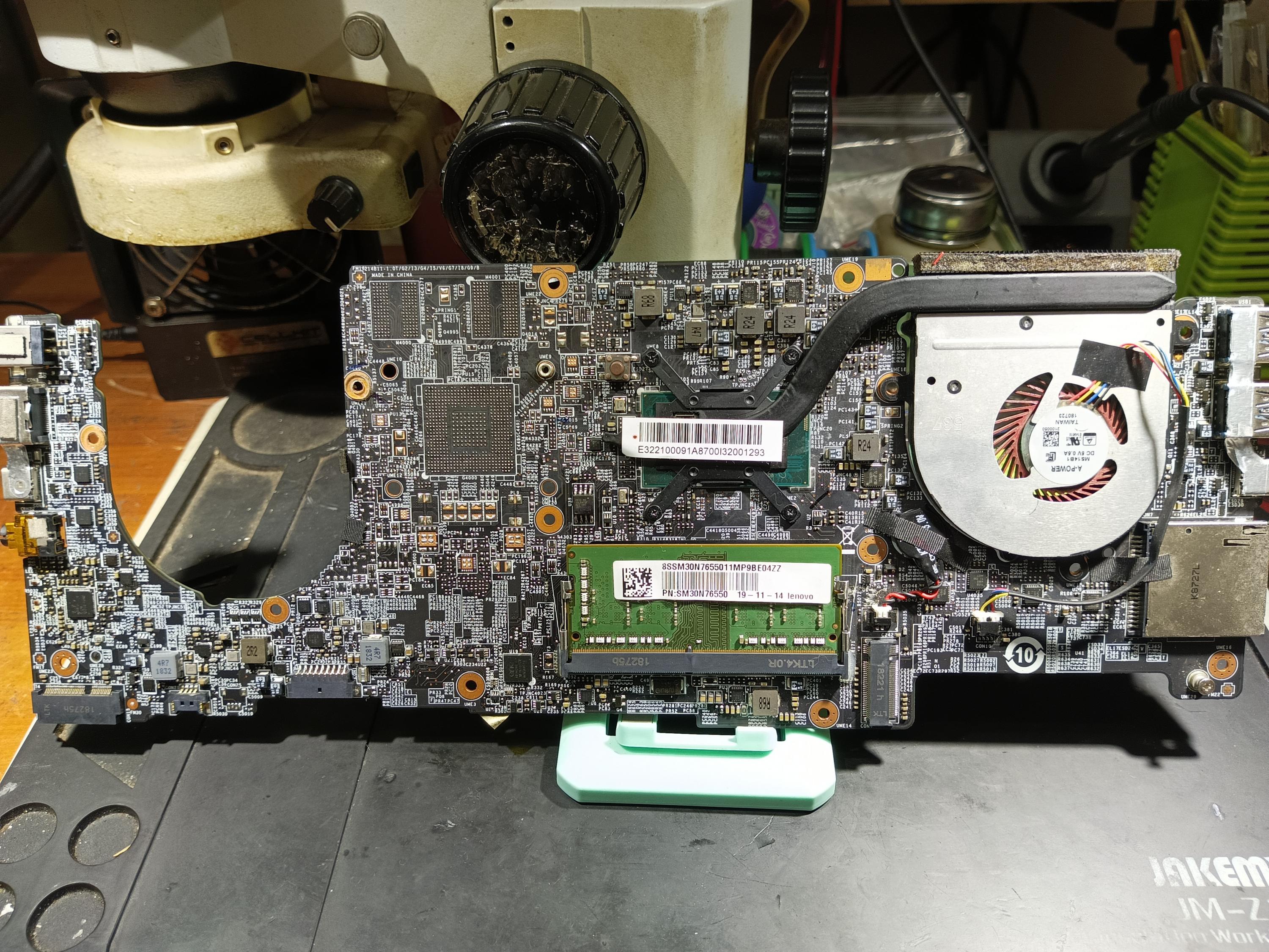

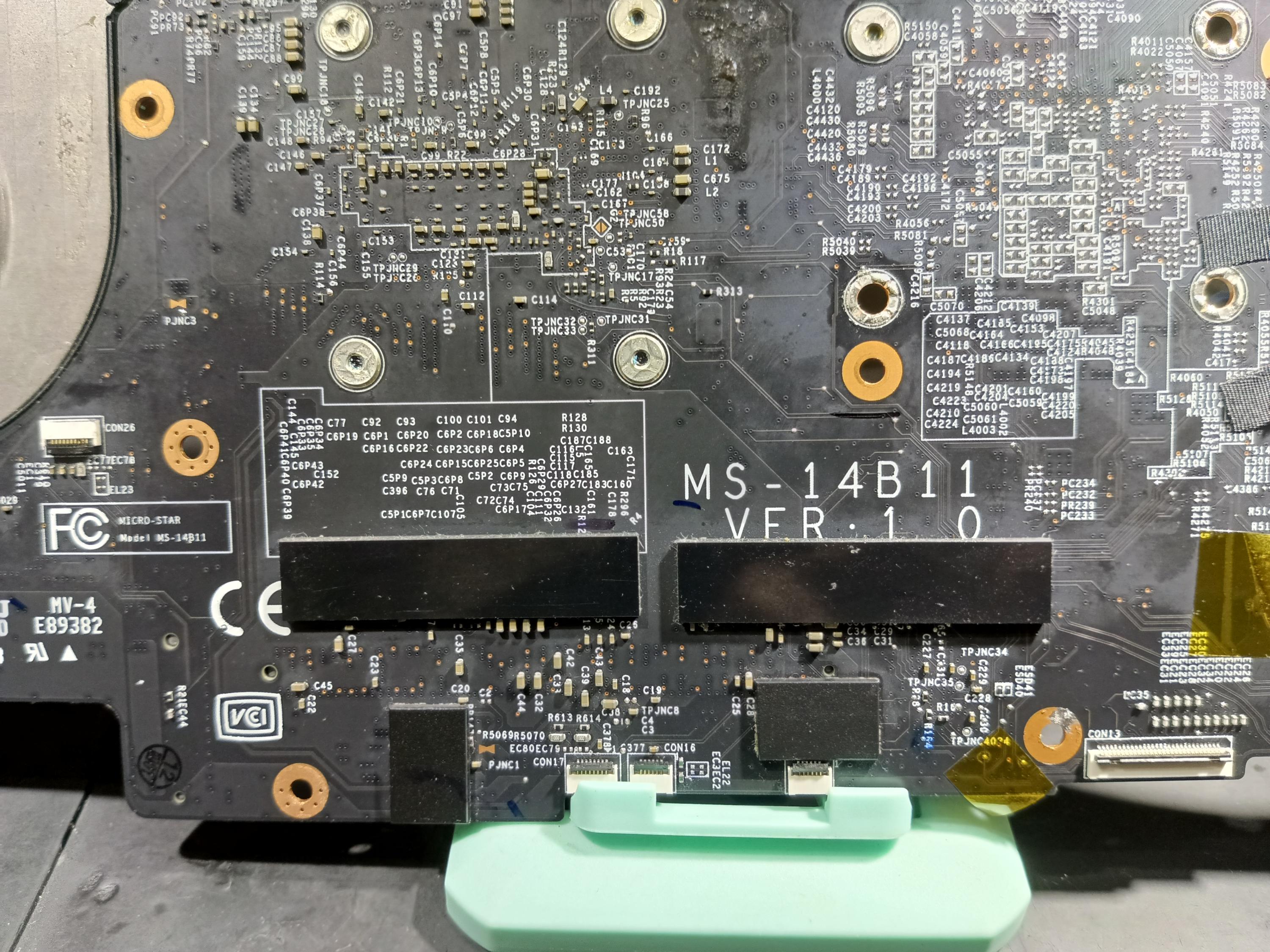

    hi guys, I have laptop MSI MS-14B1 with multiple short to ground, after replace few IC that short, I've manage to no short on board, tried to turn on board only power led light up and fan spin no display on screen, tried to flash bios and KB IC with file from this forum but still no luck, in MSI webpage there 4 version for this model and i confuse which model that i have, so can you guys please help me bios + EC file that match with board I have.
    MS-14B11 V.1.0
    I have the original backup BIOS + EC, maybe this helping.

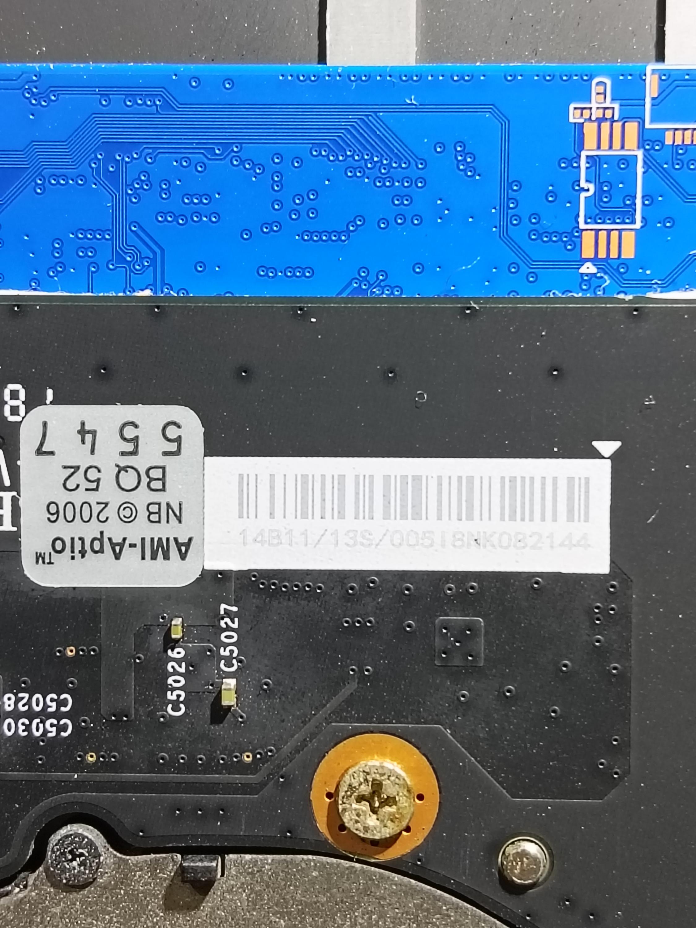

      Re: Help find BIOS MSI MS-14B1 match with my board
      for Serial Number or Service Tag i cannot figure it out because label is not readable anymore (see attachment)
      and i only find number on motherboard but not sure is the serial number or not (see attachment)
      after see spec from MSI website my model is either PS42 8M or PS42 Modern 8MO because i have 40W adapter and this board dont have nvidia graphics chip.
        Originally posted by wyde666
        for serial number or service tag i cannot figure it out because label is not readable anymore (see attachment)
        after see spec from msi website my model is either ps42 8m or ps42 modern 8mo because i have 40w adapter and this board dont have nvidia graphics chip.
        here is your new bios 128kb ec+8mb main bios
        model was ps42 8m
