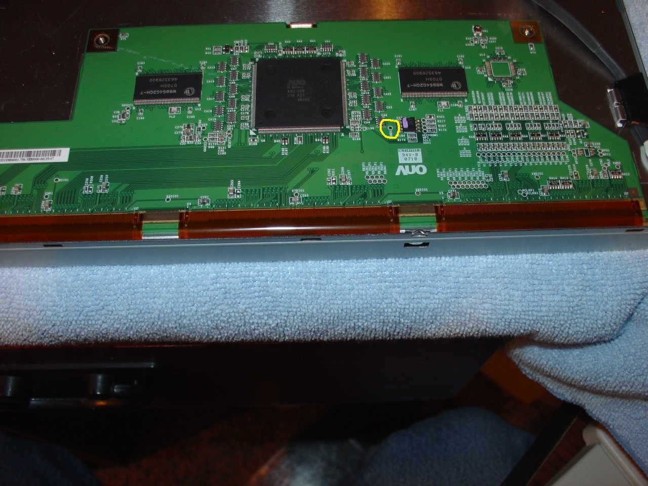

    Fuse F5 is open on the panel board.
    I tested between avdd1 and gnd1 and have zero voltage.
    I am assuming that gnd1 is a good ground for testing.
    I have attached a pic of the part of the board where gnd1 is and circled it.
    Is F5 the culprit or did something else cause it to blow?

      Not sure if gnd1 is a proper ground. However, the exposed copper areas near the screw holes definitely are, so use those instead. It should be easier too.
      Depends. Most of the time, an overload on the main boosted voltage rail ("AVDD1") will cause the fuse to blow. This usually happens when one of the filtering ceramic capacitors on it becomes shorted. I had one monitor do that.
      So with that said, check resistance between Avdd1 and ground (i.e. exposed copper area near screw holes). Use the lowest ohm setting on your multimeter if it's manual range. Post back what results you get.

        I checked between avdd1 and the closest screwpad, the initial resistance is 1 ohm and after a second or two it falls to .8 ohms.

          That means AVdd1 is indeed shorted. The most likely culprit will be one of the small ceramic SMT capacitors on that rail - i.e. C11, C12, C13, C15, and possibly C241. It could also be that diode D10 is shorted and the whole 5v rail is shorted, but this is very unlikely. Nonetheless, this should be checked - basically measure resistance between ground and one of the pads of the inductor (it doesn't matter which side of the inductor you chose). If you get more than 40 ohms (steady reading), then diode D10 and the 5v rail are fine. However, if you do get less than 40 Ohms, let me know.
          Assuming you did get more than 40 Ohms (the more likely case), then we need to find what is causing the short circuit on AVdd1. Like I mentioned above, it's probably one of the small ceramic capacitors on AVdd1.
          AVdd1 starts at the cathode of D10 (the side marked with a white stripe and the letter "K") and continues through two 0 Ohm jumper resistors, R15 and R16.
          You can start by removing R15, then measure resistance between ground and the cathode of D10.
          - If you don't get a short circuit (i.e. same reading like you did when you measured resistance between ground and AVdd1), the problem is somewhere after R15, most likely C15 or possibly C241 if C241 is connected together with C15.
          - If you do get a short circuit, remove R16, then measure resistance again between ground and cathode of D10. If short circuit is gone, remove C11 and check it - if it's not shorted, let me know. Otherwise if the short circuit is still present between ground and cathode of D10, remove C12 and C13, then check them with your multimeter.
          Let me know how it goes.
          Also, try not to damage any of the ceramic capacitors when you remove them - those that are not shorted can be put back in the circuit afterwards.

            I tested D10, the cathode to ground measures 1-.08 ohms
            the anode to ground measured a steady 1364 ohms.
            I figured I would run these readings by you first before I attempt to
            remove the resistors or capacitors.
            Thanks again for all your help with this!

              Those reading confirm that D10 and the 5v rail are fine. That means only AVdd1 is shorted, so unfortunately you will have to remove those resistors and capacitors I mentioned above.
              Don't worry, though, it's not as hard as it seems. The traces on the board are not that easy to destroy. Just make sure your soldering iron is nice and very hot.
              The ceramic capacitors may be a bit more tricky to remove, but take your time with them. Heat them up from one side and then the other multiple times and they should come off without damage.
