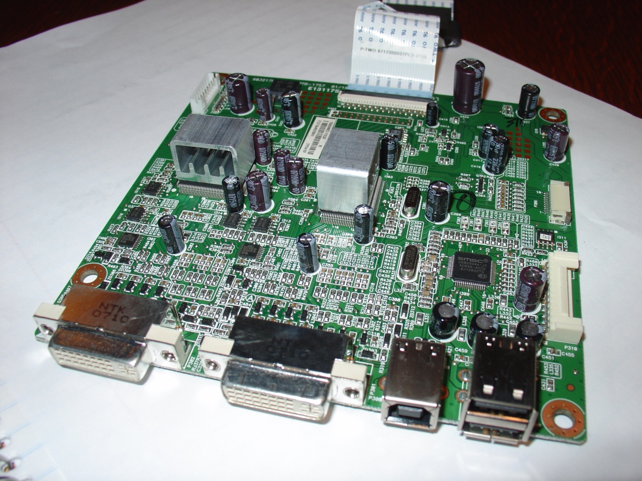

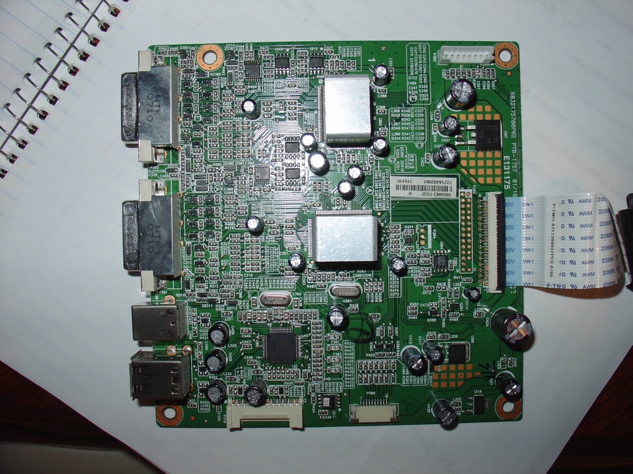

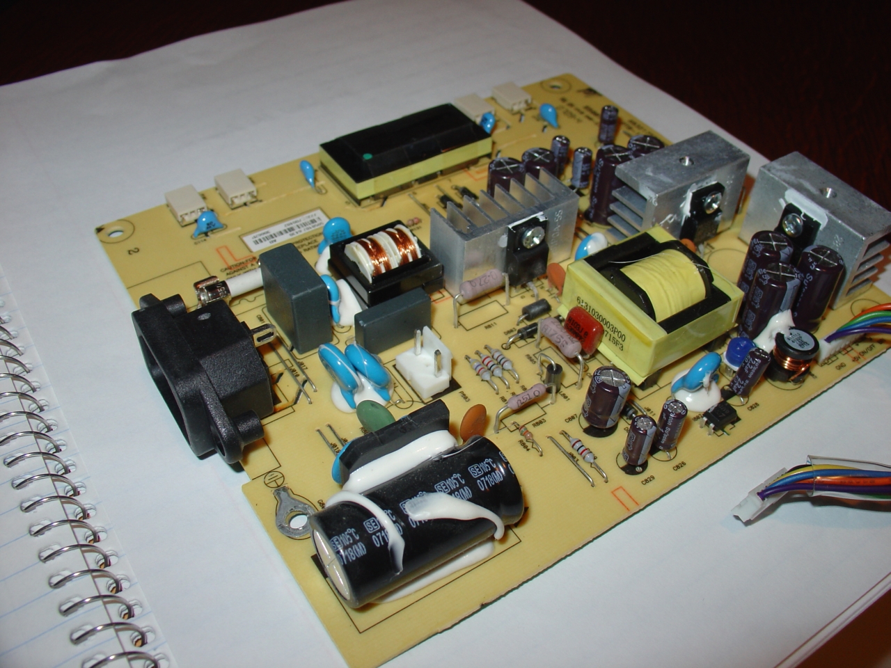

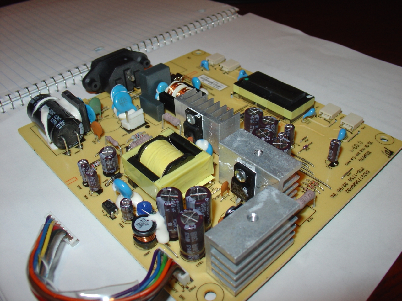

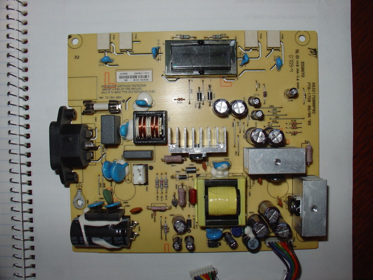

    Hello all, new to the forums here.
    I have a HP LP1965 that has no image.
    When you press the power button the green light turns on.
    The backlights turn on as well. There is no image at all.
    I have pulled the power supply and video boards and all of the
    caps look good. They are a mixture of suscon's and capxons.
    ( i know c823 on the PS looks like its bulging on the top but
    its flat)
    Should I just go ahead and replace them or is there another
    direction that I should take.
    Thanks,
    Andy
  • jetadm123
    • 2169
    Re: HP LP1965 - Power light green, no image
    Is the screen just plain white? If yes, it could be a blown fuse on the LCD control board.

            • jetadm123
              • 2169

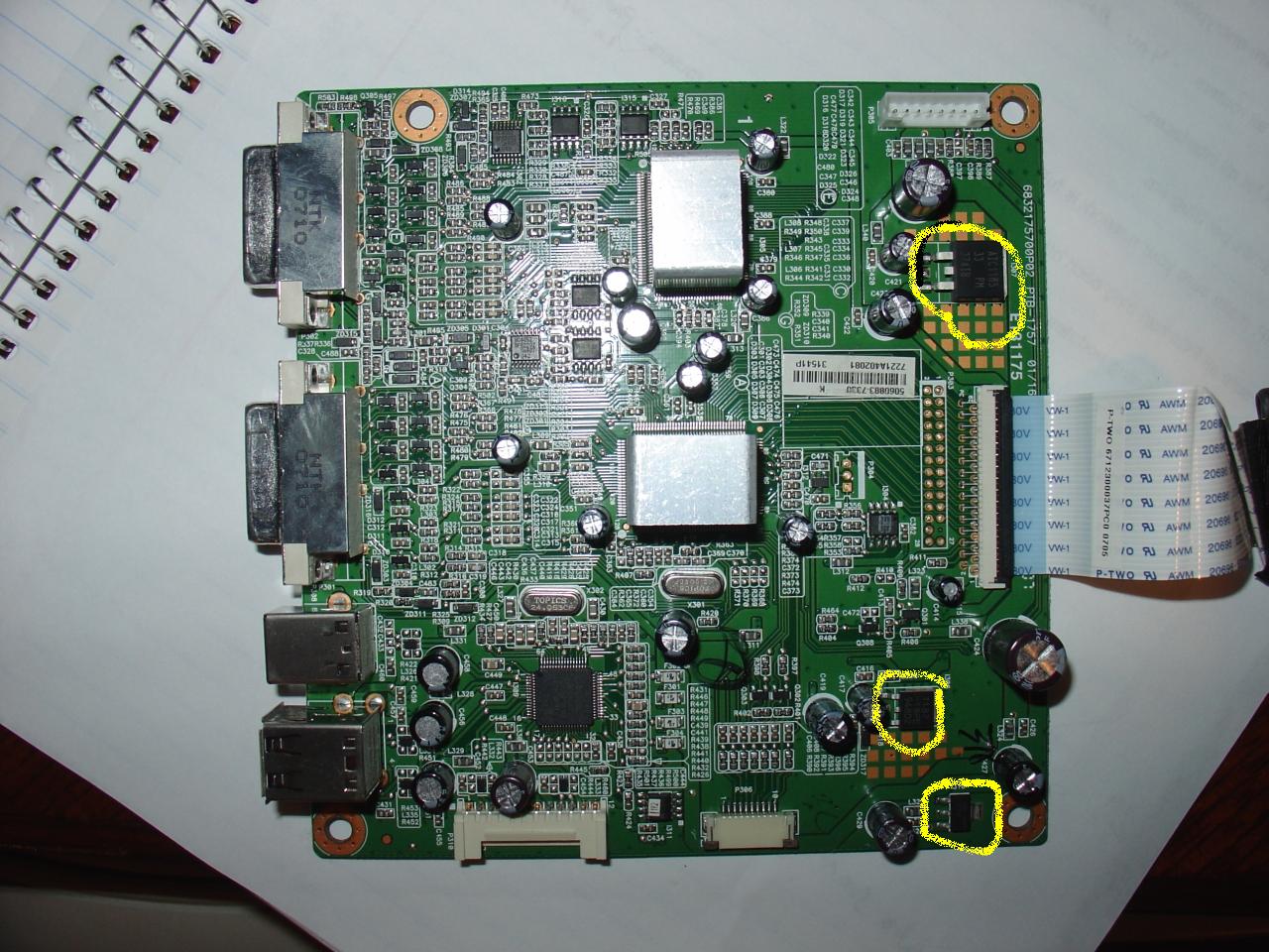

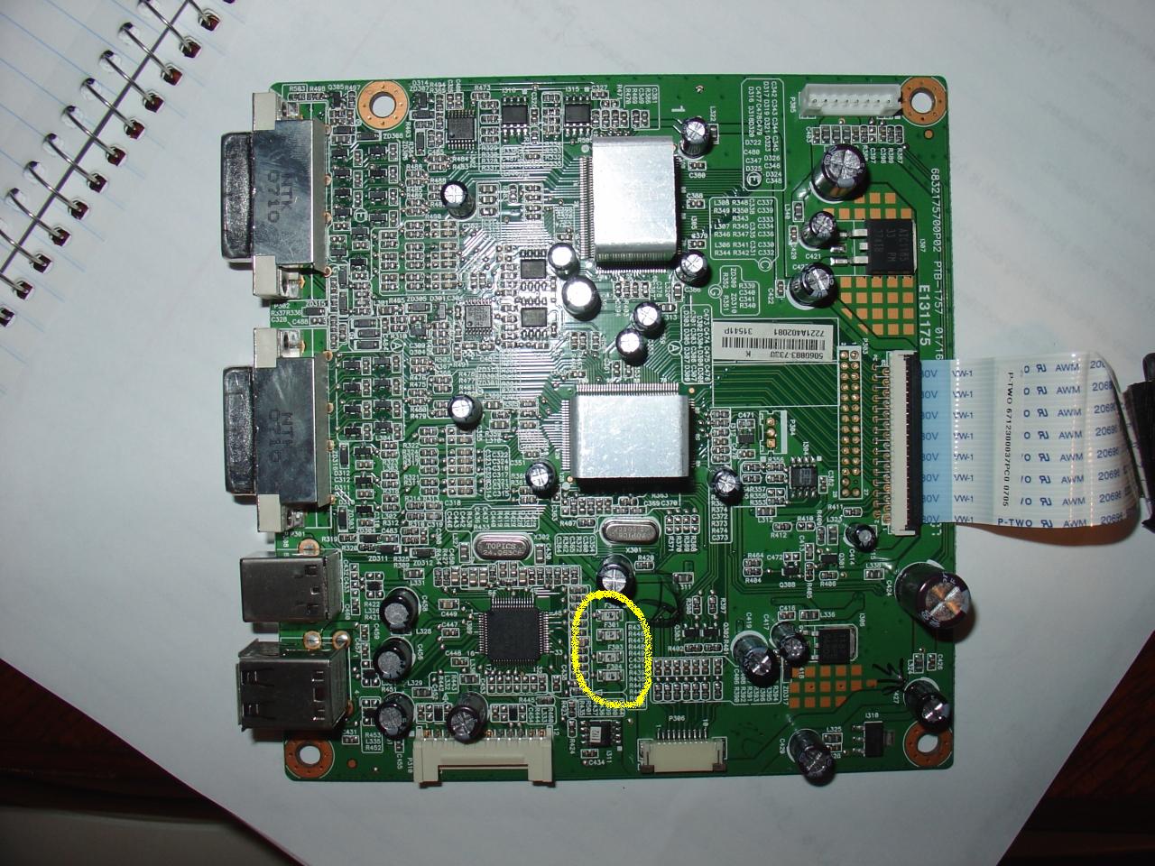

              Usually, there's a 5V and 12V output from the power supply. The 12V drives the inverter/backlight section and the 5V drives the logic card and LCD panel. Sounds like the 12V is good, since you're getting backlight.
              Looks like you'll have to piece everything back together to take voltage readings. Measure for the 5V at the wiring harness of the power supply (hopefully, the voltages are silkscreened on the board. Look on top and bottom of board).
              In your photo, I circled what I think are voltage regulators. What are the part numbers?

                • badandy
                  • Nov 2010
                  • 25
                  Originally posted by Rtech
                  ""Its completely dark, if you press the menu button nothing happens. If you press the input button, the backlights turn off for a second or two and then turn back on"".
                  I am still slightly confused !! from your statement above if the Screen is Dark, then are the Backlights really on ????.....only time the screen is dark normally is if there is NO backlights on ??/
                  I have powered it on outside the case and I can see that the backlights are on.
                  It looks like when you have your screensaver set to blank the screen but not power off the monitor.
                  • mockingbird
                    • Dec 2008
                    • 5484
                    Change the capacitors. All of them. If the primary capacitor is Capxon, keep it. If it's a Suscon, toss it and replace it too.
                    • badandy
                      • Nov 2010
                      • 25
                      Mockingbird, do you want me to change caps on both video and power supply boards?
                        Sorry for the delay getting back to you guys, XMAS has been busy.
                        I tested 3-5 volt legs for voltage, yellow-orange-red are 5v legs, they tested at 5.24 volts each.
                        the part numbers for the regulators are as follows, according to your picture top to bottom
                        AIC1185 top
                        33 PM
                        274IB
                        1187 middle
                        -18PE
                        948D2
                        1185-33PY bottom
                        775IB
                        • mockingbird
                          • Dec 2008
                          • 5484

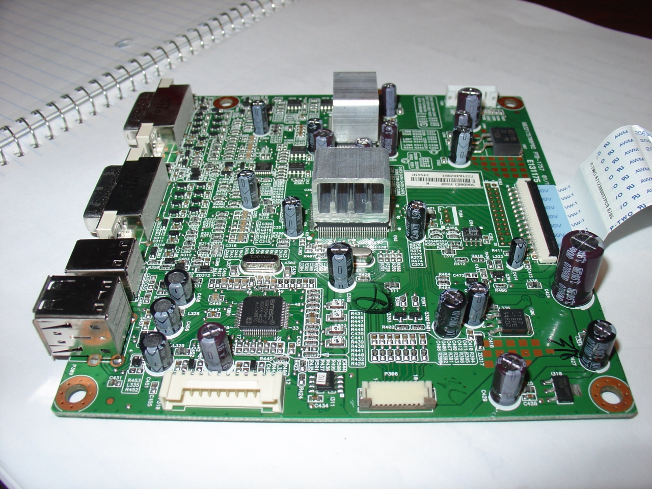

                          Yes, the video board too. Especially the larger ones. Be careful not to rip out the pads. It's somewhat difficult with the logic board and the tiny caps. If your soldering skills aren't that great, then just replace the larger ones on the logic board.
                          • jetadm123
                            • 2169
                            AIC1185 top
                            33 PM
                            274IB
                            1187
                            -18PE
                            948D2
                            1185-33PY bottom
                            775IB
                            Can you please take a voltage reading for each leg of the above devices?
                            • badandy
                              • Nov 2010
                              • 25
                              I took the following readings in circuit assuming that you are looking
                              directly at the IC with the legs facing down. Backlights were not connected lcd was not connected to video board.
                              for AIC1185 33 PM 274IB
                              left leg & center - 5.23vdc
                              right leg & center - 3.29vdc
                              for 1187 -18PE 948D2
                              left leg & center - 3.28vdc
                              right leg & center - 1.802vdc
                              for 1185-33PY 775IB
                              left leg & center - 5.22vdc
                                for 1185-33PY 775IB

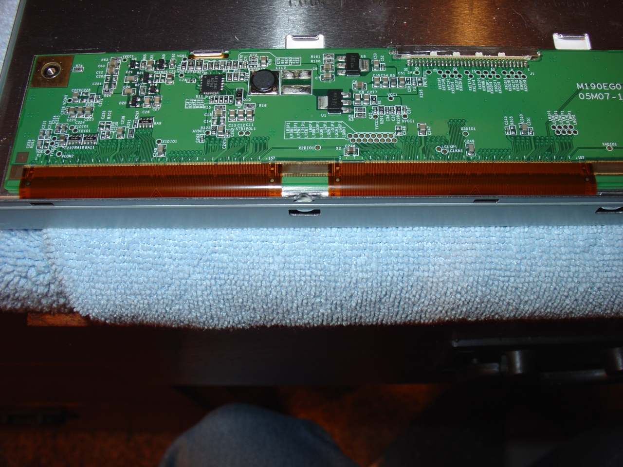

                                The first and third ICs (1185-33) are 3.3v linear regulators (as indicated by the "33" in the name). The second IC is a 1.8v regulator, so the reading you got for all 3 are good.
                                The problem could also be on the panel board (the one permanently attached to the LCD screen), most likely with one of the boosted voltage rails. If possible, post a few pictures of the panel board. The areas of particular interest are near the LVDS connector and around the inductor/coil.

                                  There appears to be 4 fuses, F301-304 on the logic board. Please check them for continuity. I've marked them on the photo.

                                    Here is a pic of the panel board.

                                      Check the 4 fuses that jetadm123 circled. If they are good, check fuse F5 on the panel board and also measure voltage between ground and the test point labeled "AVDD1". Should be around 10~13v I think. Post back what results you get.
