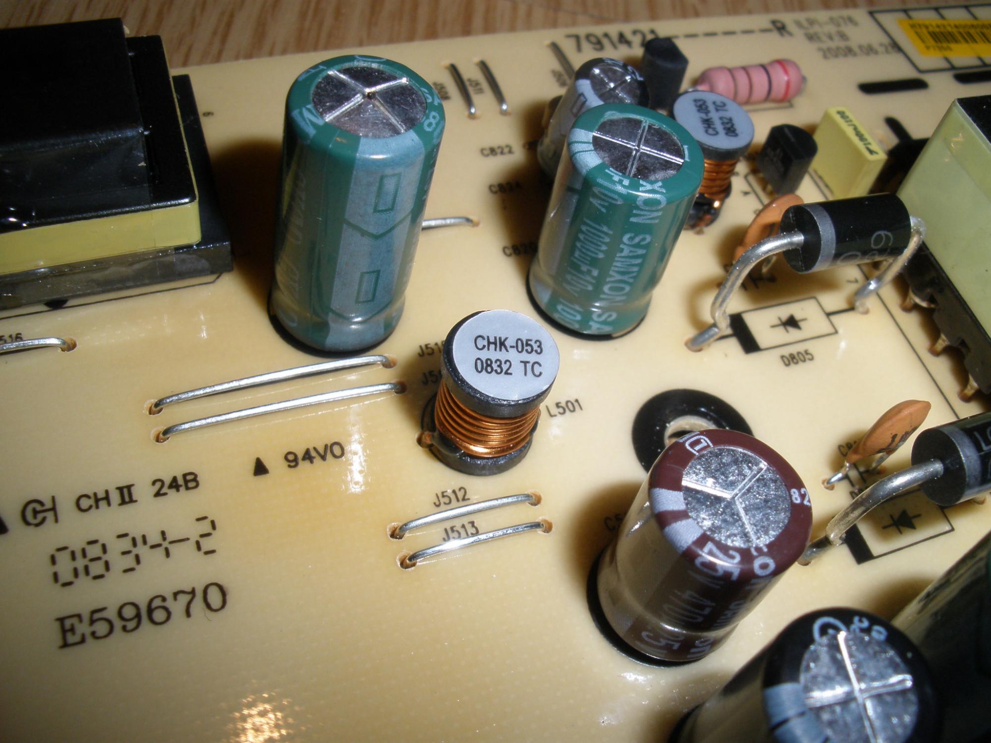

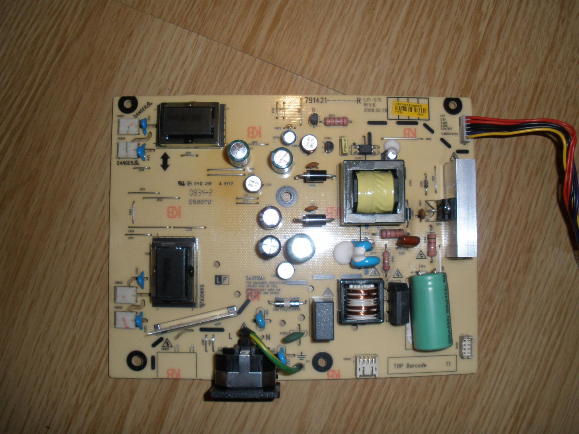

    Easy fix of Acer V173 LCD.
    Symptoms: Display turns off after 1-2min. There was a slight noise heard when powering on. After opening the cause was obvious, one of Samxon capacitor was popped.
    Board: ILPI-076 Rev:B 2008.06.28
    Fix: Replace all green Samxon caps(3) seems a bad batch. Sorry didn't write the numbers down And when connecting all together attach high voltage LCD panel leads firmly otherwise the backlight will flicker.
    Beware of BIG cap, it holds charge for a long time and doesn't discharge by itself as for other LCDs... It was a ouch on my finger with 400V :zap:

    Parts:10V 1000uF,25V 1000uF,25V 680uF

        The green ones that you changed out are Samxon GF, and yes they are known unreliable.

                      Just replace the Samxon caps before you proceed. They are crap. The bad caps are not always visible but if it is a known bad brand then they should be replaced anyway.
                        Re: Acer V173 LCD power board fix
                        Samxon is not a bad brand, but the GF series are crap. LG also likes to use them (probably to make the monitors fail just after the warranty runs out)
