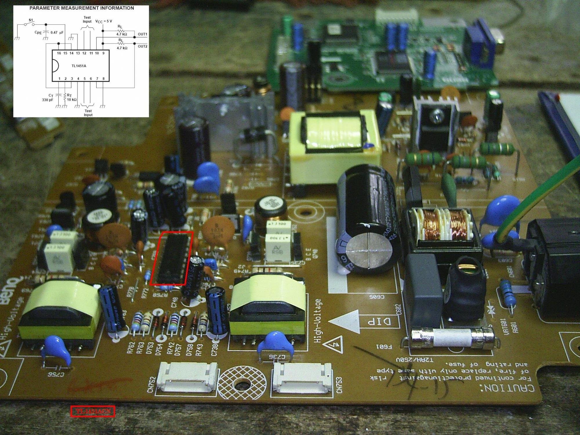

    1 .- I do not ON, nor led stanby.
    Check in tl1451acn ic751
    no voltage pin 5
    pin 10 is 14 volts ...
    any information on this
    I would appreciate each other, help

    I just got the same lcd with the same problem, I see nothing bad on the board so I expect its something with the ic chip or the fets. Please reply if you have found the problem because I dont want to throw out a nice lcd screen.

      If you search this forum you'll find some info on this model.
      It's famous for blowing the pico fuse, due to shorted transistors, usually caused by bad solder joints on the transformers.

        try change and re-program the 24c04 (not sure the same model) on the logic board.
        I have one benq fp537 with same problems, now repaired.
        you can search the "firmware" for the 24c04 on internet or any member of this forum.Or, try this:
