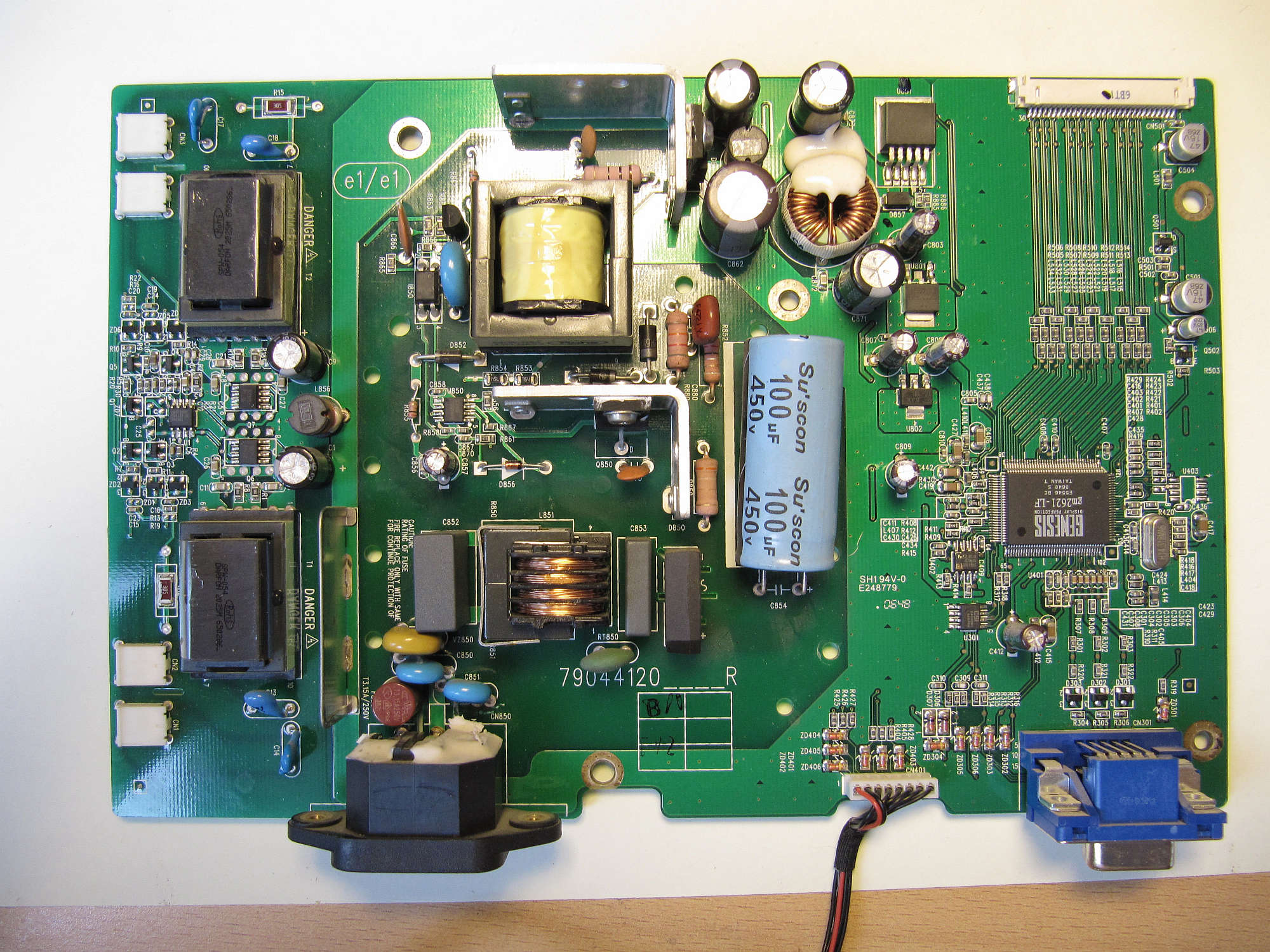

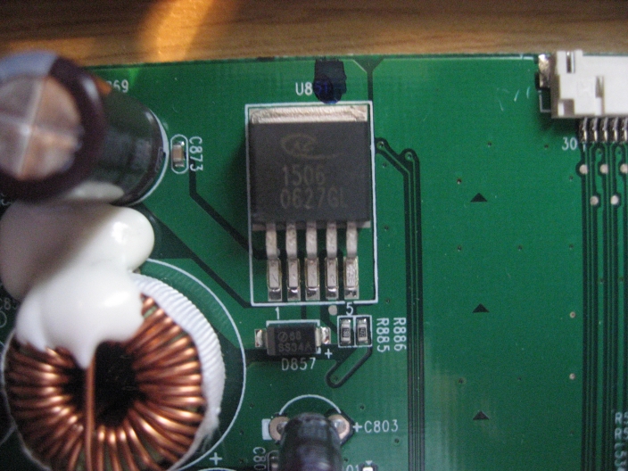

    Hi guys,
    I'm a bit stumped here.
    -Scrapheap-destined Dell 19" E197fpf monitor that wouldn't power on at all.
    -Found the 12V->5V DC-DC converter IC had failed (AP106 ).
    It was outputting 11V to the rest of the cct. The 3.3V and 1.85V regulator outputs were still fine.
    -I replaced it with a LM2575 1A Fixed-5V version. (). First time the monitor worked beautifully for about 10 minutes then died. Found the 5V regulator had died again.
    -Didn't have my ESR meter yet so I replaced most of "secondary-side" electrolytic caps with rubycon LOW-ESR equivalents. The one cap that I didn't replace has subsequently turned out to be ok anyway.
    -Then put in a new 5V LM2575 and it blew within a few seconds. Couldn't find anything obvious around the LM2575 that might cause it to blow. So I decided to remove it from the cct and inject 5V from a bench power supply.
    -Monitor powers up, but screen is completely white. No OSD visible. Plugging in a VGA signal makes no difference.
    -After reading more posts checked the fuse on the T-CON board and sure enough it was blown. Maybe by the 11V input from the blown regulator?
    -Checked the T-CON board for any obvious shorts that might cause the fuse to blow again, found none, so installed a new SMD Time-Lag 1.5A fuse.

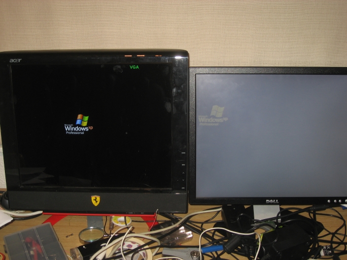

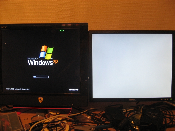

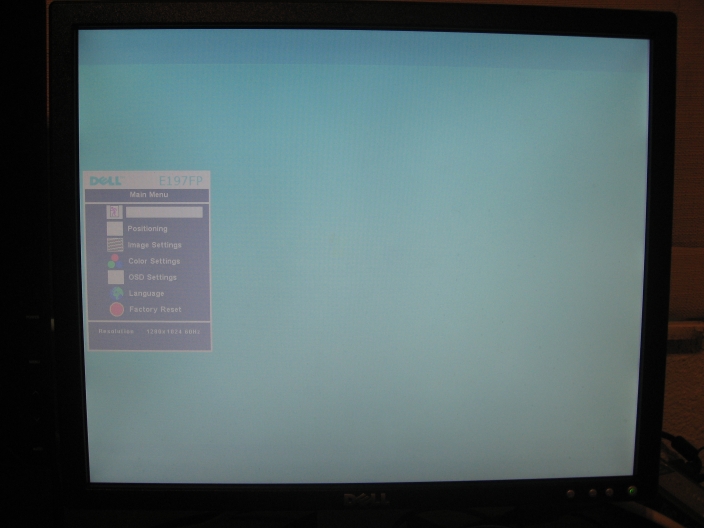

    -Powered everything on and things are looking better, except that now the display is very washed out. Almost as if the brightness is up too high. Colors are faint etc. I have attached a photo of it side-by-side with my usual rig for comparison.
    -I later picked up two mistakes I made with the regulator. First - I'm pretty sure the original component was an ADJUSTABLE version. The markings on the IC are inconclusive but there are two resistors making up a voltage divider and the feedback pin is connected to the middle of those. I thought that perhaps this was why when I installed the FIXED-5V version it kept blowing? The FIXED-5V expects it's feedback pin to be connected directly to the output (via inductor). Anyhow... another mistake was that the original IC was rated for 3A, and the one I put in is only 1A. Could this be a problem? The bench power supply never seemed to go much over about 750mA so I wasn't sure. It is capable of 3A though.
    -Not feeling like trying to source the ADJUSTABLE version I "modified" (cringe!) the PCB to use a 5V fixed regulator. Essentially by-passed the divider and plugged the feedback pin into the inductor output. At least the regulator isn't dying, and is putting out 4.95V. From what I could calculate with the original resistors on the board the adjustable version would give 5.085V so about 100mV difference there.
    -Tried factory defaults reset, even factory program mode, color adjust, rgb etc, no difference.
    Any ideas?

    I am aware your posting is nearly 5 years old but I would be interested in the results for your monitor Dell E197FPf because I have the same on my desk right now. It was also destined to local dump. The lady who gave it to me told me it ceased functioning during a storm. For the moment it is completely dead. I just checked the fuse F850 which is OK. I guess it was damaged by a voltage surge. Do you have the corresponding schematics by any chance?
    Any suggestion would be greatly appreciated!!!!

      5v standby present?
      • Teodule
        • Feb 2011
        • 34
        • France
        Re: Dell E197FPf - Colors Faint, White Washed Glare, Slight Ghosting - W/Pictures
        No nothing : AP1506 doesn't even get Vin on pin 1....Actually the switching power supply doesn't switch. The only voltage is the rectified mains voltage on C854 ( 100microF, 450V). Either the SPS driving circuit U850 (SG5841SZ) or the MOSFET Q850 is/are dead. ...or...

            Have you tried testing Q850 for a short?
            • Teodule
              • Feb 2011
              • 34
              • France
              Not yet; Thanks for the suggestion. It is going to be the next test but not before Sunday I'am afraid. Are these MOSFETs very sensitive against voltage surges or electrostatic discharges?
              • jetadm123
                • 2169
                Most semiconductors are sensitive to power surges. If that mosfet is shorted, then U850 is probably also bad.

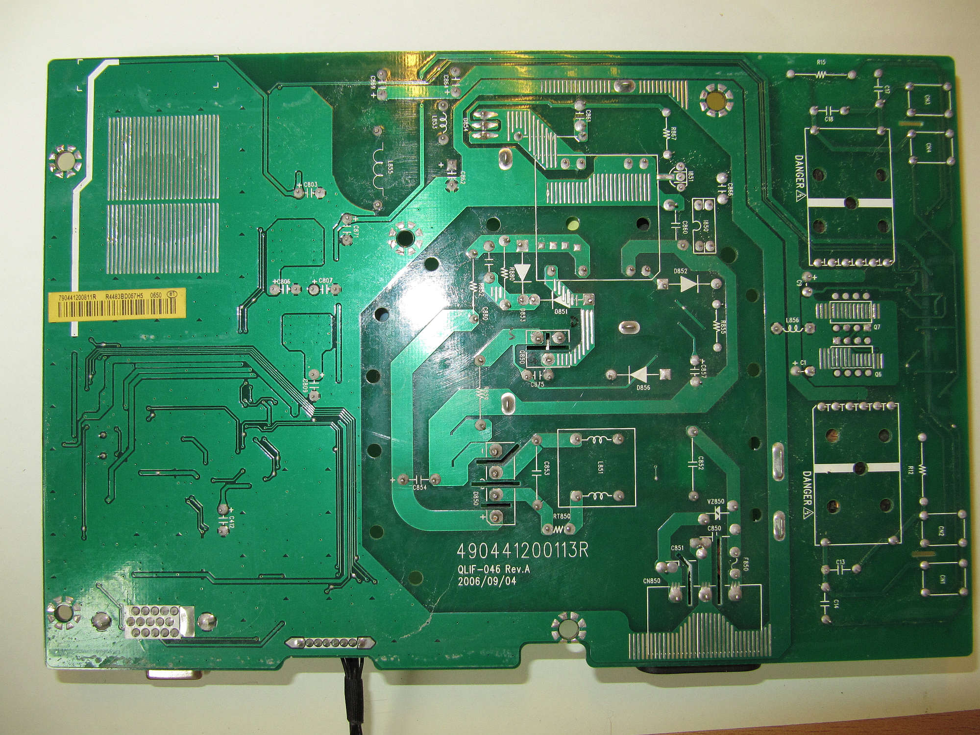

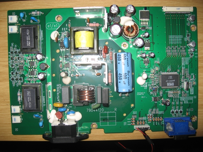

                      Teodule - Pictures of your baords might help.
                      Did you have the PS and main connected when you tested for DC voltages
                      • Teodule
                        • Feb 2011
                        • 34
                        • France
                        Yep. Here are the pictures. As you see, a clean and neat board. Of course the board was connected to the 230V AC when I measured the voltages.
                        After a summary check the MOSFET Q850 doesn't seem to be dead - no obvious short-circuit from drain to gate-.
