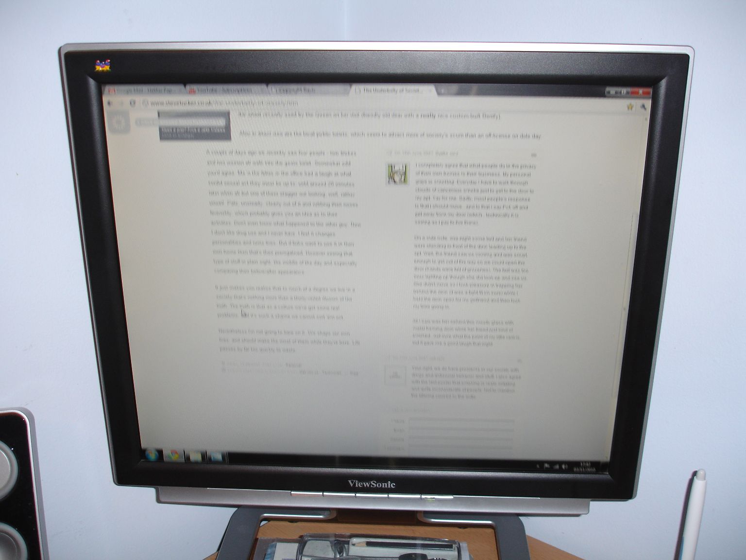

        WOO SUCCESS!
        It was the MBR10100CT schottky that was defective. Now I'm back basking in LCD goodness!
        Thank you everyone who helped me identify what was wrong with my PSU, I really appreciate it. This experience has taught me a lot and I'm getting a bit of a taste for it, so maybe you might see me around the forum a bit more often.
        Thanks again guys.
