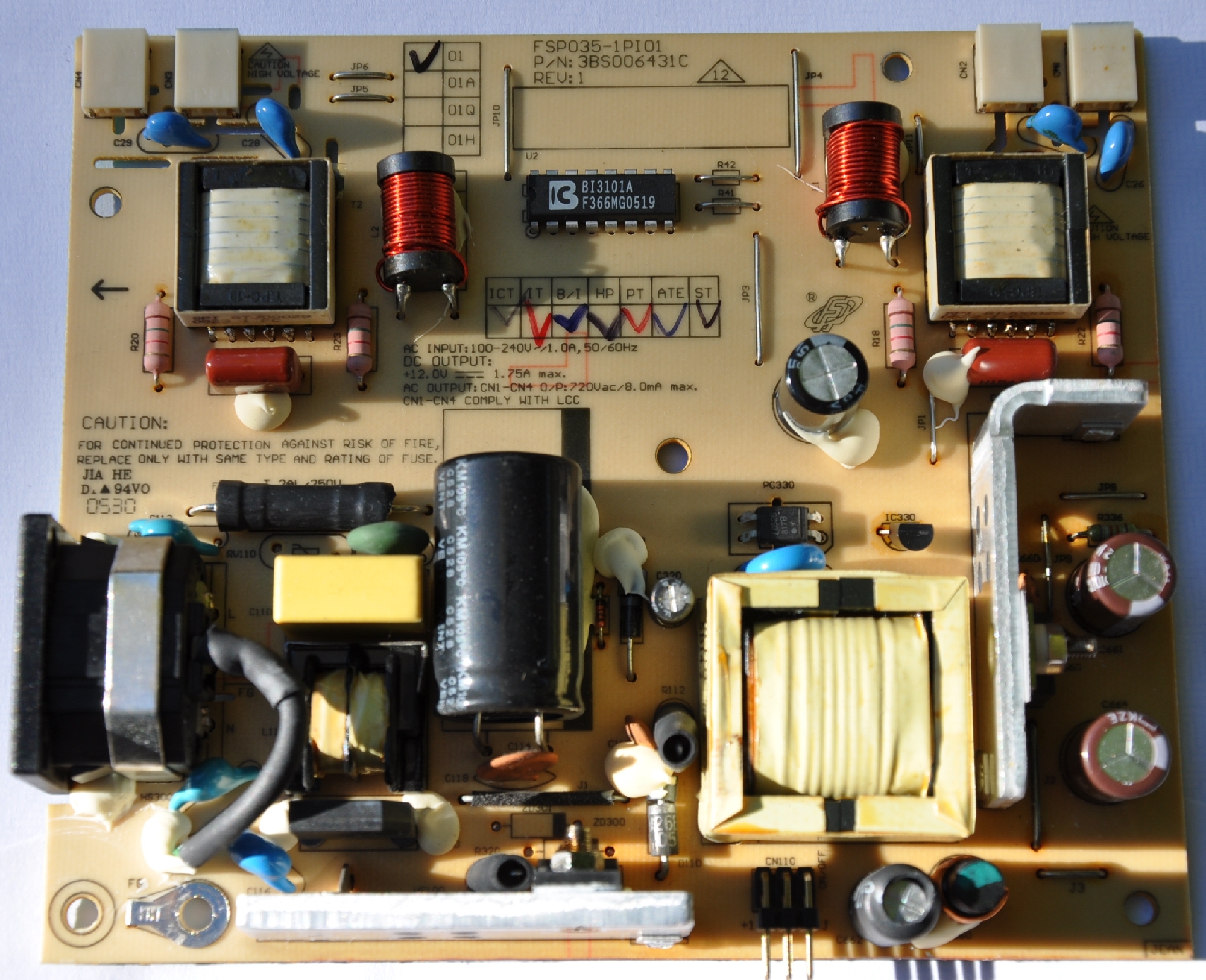

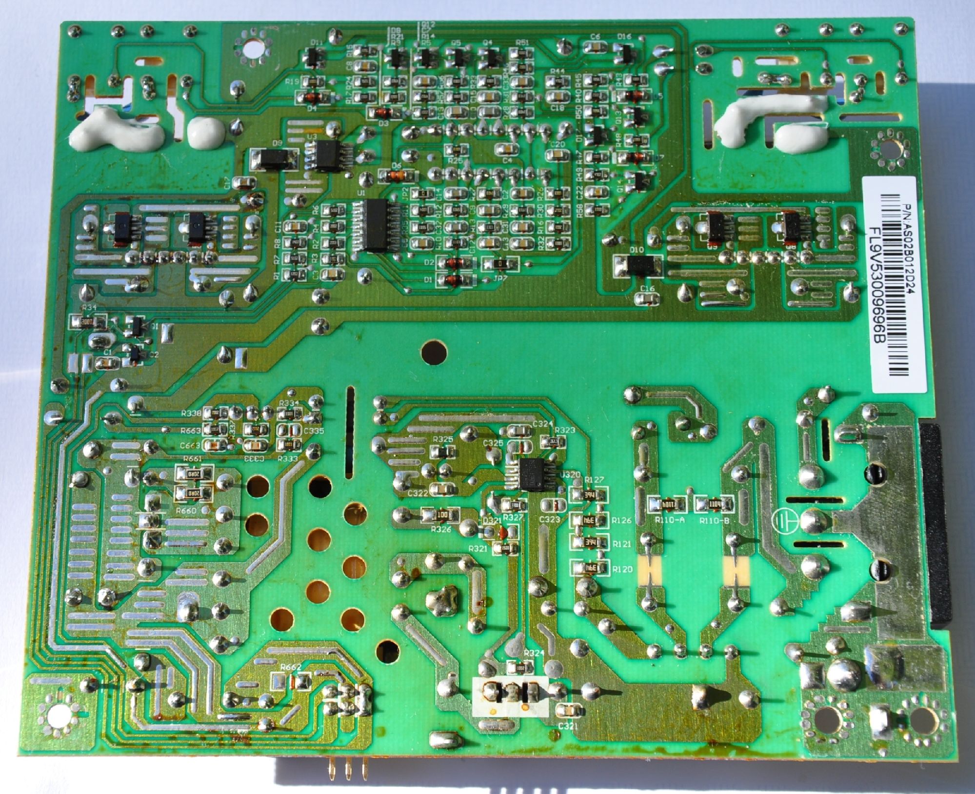

            Re: My Viewsonic VX924 monitor died!
            Here you go PlainBill. Pics, top and bottom.

              • PlainBill
                • Feb 2009
                • 7034
                Do you have a multimeter? If yes, check for 5V DC on the connector from the power board to the main/logic board.
                If that is not present, carefully check for mains * 1.4 on the main filter capacitor. This is high voltage so be careful checking.
                Note the label on the power supply. 12V output. Otherwise, an excellent starting point.
                NeiltheDruid, do you prefer to be called Neil, or Dru? Those are excellent pictures.
                Check the voltage as suggested by retiredcaps, except expect 12V.
                You may find no or very low output voltage, but input DC is present. In that case, look at the back of the board. You will find four transistors. Two, near the white label are Q8 and Q9, the other pair on the left side of the board are (I believe) Q10 and Q11. One pair are probably shorted.
                If so, you are in for an adventure.
                PlainBill

                                  • retiredcaps
                                    • Apr 2010
                                    • 9271
                                    I don't have PlainBill's 20/20 vision, so help me out and please report the part number for chip U320 (backside).
                                    I'm guessing this 8 pin IC is the SMPS or PWM controller. Once the part number is listed, we can then search for the datasheet and compare the stated voltages to what you are actually getting.
                                    Also, what is the uF and voltage rating of that startup/run cap (above R112)? And do you have a replacement handy?
