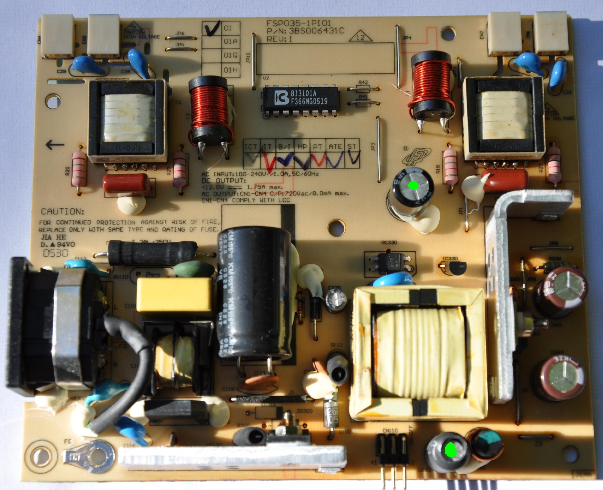

    I've attached a marked-up version of the picture you supplied.
    Here's some things to check in no particular order.
    The IC circled in yellow is the SMPS controller. I believe retiredcaps asked for the part number.
    I've labeled the +12 and Gnd pins at the output connector. Set the DMM on the 200 ohm range and measure the resistance between those points. If it more than 200 ohms it is highly unlikely the inverter drivers are shorted.
    I've numbered the pins on the transistors I suspect. Again, with the DMM on the 200 ohm range, measure the resistance between pins 1 & 2, 1 & 3, and 2 & 3 of Q8. Repeat for the other 3 transistors. If all pins of a particular transistor show a low (<10 ohms) resistance, the transistor is shorted.

        Here we go, answers!
        Retiredcaps, the cap marked C320 is a 10uF @ 50v CapXon. The SMPS controller has 2 lines of text on it. These are as follows, SG6841SZ - top line, KA2674605150 - bottom line.

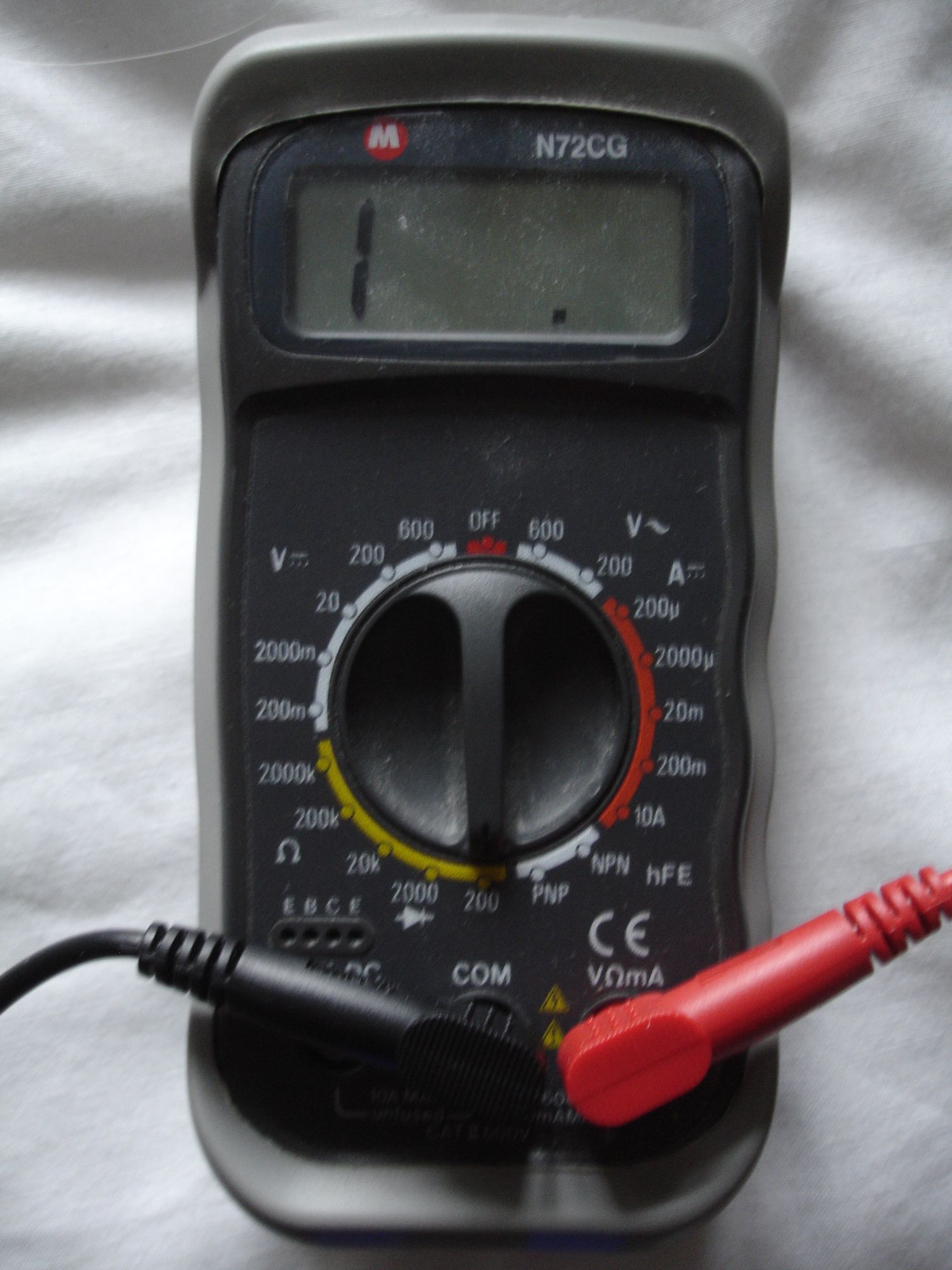

        PlainBill, the resistance on the 12v DC out on the board reads as 00.5 on my dmm. The only reading I could get from the all of the transistors on the board were between pins 2+3 of each transistor reading from 96.5 to 97.4. All the other combinations of pins on each of the transistors flashed a figure on the dmm then defaulted back to 1.
        I wasn't sure if I was measuring correctly, so I took a pic of the setting I had on the dmm.
            When it flashes a "figure", what is that figure? And does that figure correspond to anything in the user manual that would indicate a short? Do you get this same figure if you touch the tip of the negative probe to the tip of the positive probe with the DMM on the same setting?
            Also, there are tons of YouTube videos that are short and get to the point on how to use a DMM. Under search, just type in "using multimeter" and select the video that most interests you.

                You were using the DMM correctly. The voltage readings indicate the SMPS was trying to start, and failing. The most likely cause is C320. This cap is responsible for filtering the DC supply to SMPS controller.
                The SG6841SZ is notorious for failing, but in this case I don't think that is the problem here. The problem you are having is why I usually replace ALL electrolytic caps except the big one.

                  "1" when it is on the left hand side of the dmm, means "out of range" or "infinity". So if you had the dmm on 200ohm scale and saw "1", it means the resistance is greater than 200 ohm.
                  1.0 ohms, on the right hand side of the dmm display, means one point zero ohms.
                  Many autorange dmms, say 0L to indicate out of range which makes it less confusing to read.

                                    Before replacing the SMPS controller, there are three tests I would like you to perform.
                                    1. Double and triple check the orientation of the capacitors you installed.
                                    2. Try the power supply without the logic card connected
                                    3. I've circled the ends of the jumper that supplies power to the inverter. Disconnect either end of that jumper. (I believe it is obstructed by a heat sink on the top side). With the logic card connected, try the power supply again.
