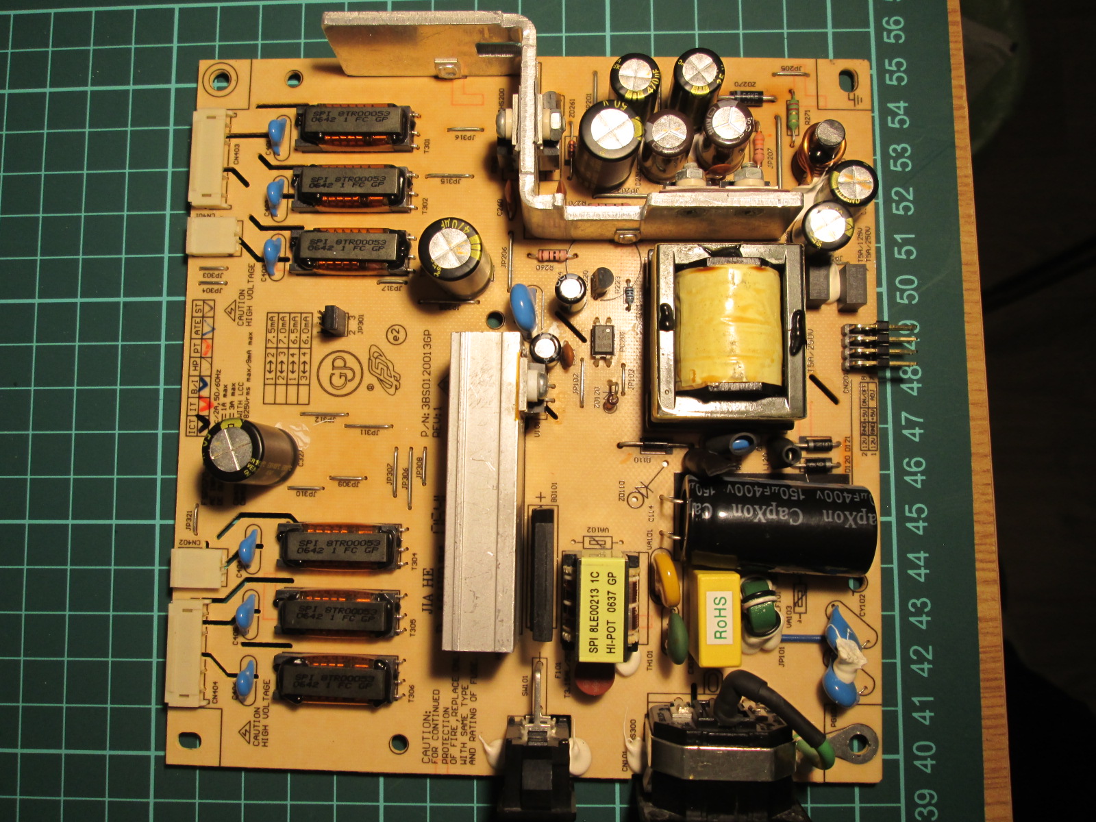

    Well, the monitor gave up the ghost last night.
    I found BADCAP searching the 'net to find a solution.
    I FINALLY got the darn thing open, and sure enough, there was a capacitor that had swelled, and is presumably bad.
    So the plan is:
    -Buy the appropriate caps (there are eight. Do I need to replace the big 120uF 450V one?
    -Remove the old, replace with the new ones
    -Rebuild the monitor
    -Save 200 dollars!
    Sound about right?
    I will check out DigiKey etc and put in an order.
    I am a ham radio operator so I have some LIMITED electronic experience...
    More to follow!!

    Depends -- what does the monitor do/not do? ("gave up the ghost" can mean a variety of things). Do you get a power light? Does it go into power save after 2-3 seconds of no signal even if there is a signal present? Does the screen flash its logo and then go out 2 seconds later? Does it work for awhile and then go off by itself? Judging from the photos, the caps is definitely a good starting point, but may want to check a few other things while you have it open (fuses, inverter transistors, etc.).
    To answer your questions -- leave the 450V one unless it is visibly bad. It doesn't look too crowded on that board so diameter may not be critical, but definitely double check the height of your replacements. Since you are ordering from Digikey, a popular choice is to get Panasonic FC or FM series as replacements. If you're unsure, post a list of the caps and someone will help double check against Digikey P/N's.

      I fix 5 Acer AL2216W LCD monitor already, most problem same you had. I just replace the bad capacitor had swelled only is will working again.
      if safe side you just replace 5 caps on inverter side only (not 120uF 450V & 2 small caps above big cap)

        Like wrog says, Panasonic FC or FM are go choices as replacements. FM has better specs and are almost the same price if purchases through digikey. Replace all 8 caps, including the smaller ones as they are part of the startup circuit. I'm including ordering instructions, since it can be a little confusing if you never order them before.
        Here's the best way to order from digikey:
        1) Go to digikey.com
        2) In the "parts search" window type: panasonic fm and select "GO" button
        3) Under the Capacitor heading select "Aluminum"
        4) The first two columns you see are capacitance and voltage. Highlight the value and voltage with your mouse and select the "Apply Filters" button
        5) You'll see several selections available. Here's what to look for:
        a) Look at the quantity available and minimum purchase. If "0" are available, then there's none to purchase. Some selections require a minimum purchase of a 1000 units, which you also don't want. I think you get the picture.
        b) height and diameter. Measure the original caps and compare to what's listed.
        6) If your value is out of stock, go back to the beginning and type in "panasonic fc" and go through the same process.
        7) During the checkout process select USPS First Class shipping, since this will give the best ship rate.

          Thanks for the replies guys. I decided to give my business to BADCAPS.The least I could do! I got Rubycons (sp?)
          The monitor was DARK. but the power light on the right corner flashed from green to yellow/brown to green etc.
          I got all the caps except the big 450V one. Might as well be safe.

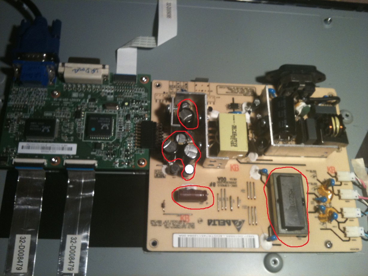

            One other thing... I've circled a component to the right of the transformer. Is that just marker on the top? Hard to tell from the photo. Another similar one exists a little farther up and to the right (but it's a little lighter).

                Hmmm. Those are ceramic capacitors right?
                I'll look into that too.

                  Yes, they are ceramic caps. Hopefully, the dark part at the top of the cap is from a marker and not a scorch mark. However, it is hard to tell from the photo.

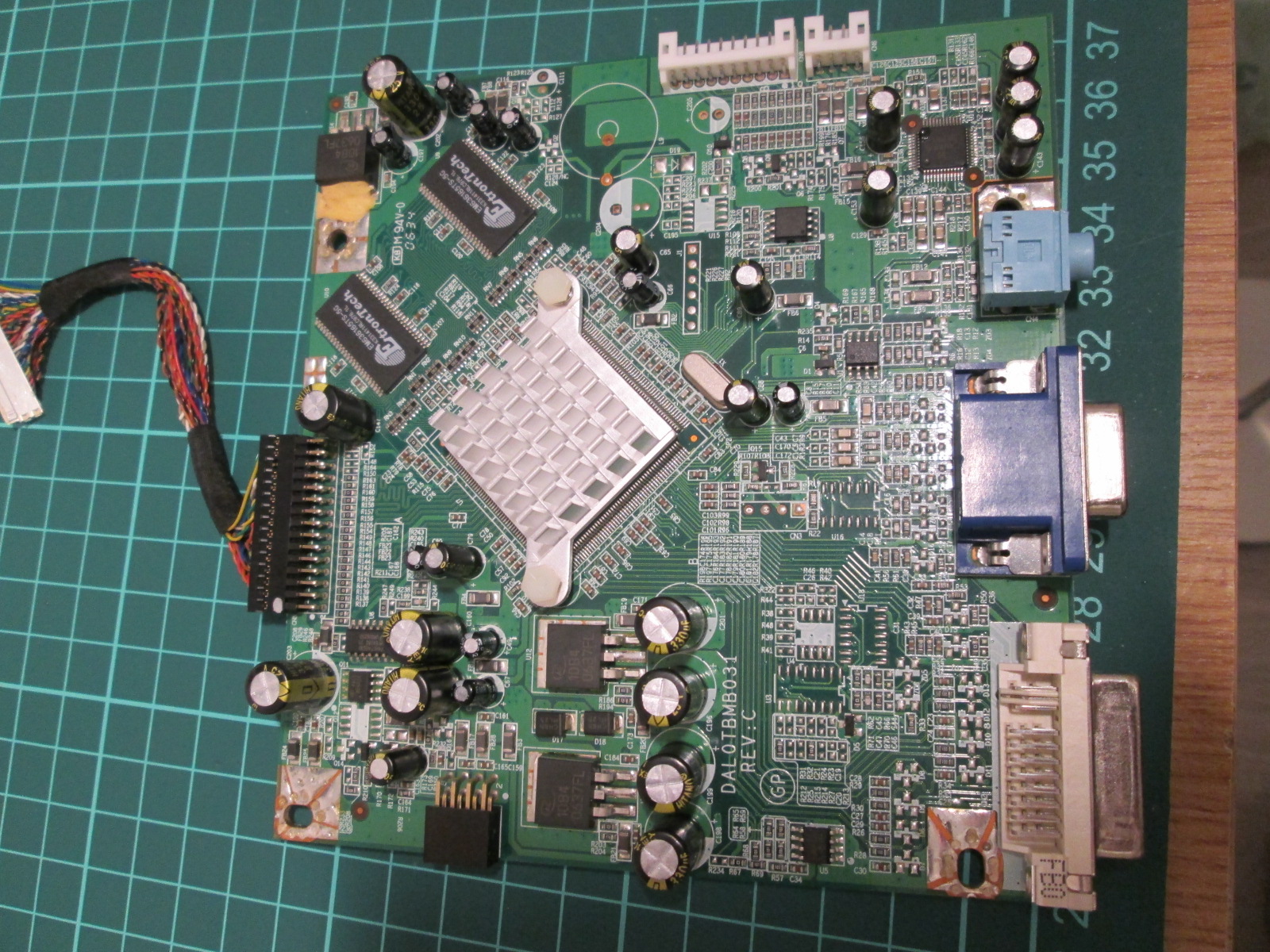

                                      I took the LCD apart and found two boards with some of the caps bulged up.
                                      So i replaced all the electrolytic ones just to be sure on both boards, because i don't have capacitance measuring tester.
                                      Measured all the black axial diodes with diode test + plus that 4 legged flat rectifier, all the axial resistors.
                                      Also tried continuity test on the fuses....if i understand it correctly they should be ok, in the sense they aren't burned.
                                      But i don't have a way to test their max turn off voltage ...or how it works.
                                      Tried replacing the "transil" ? on the last picture it looks like a diode.
                                      Which was only thing that looked like it had experienced some heating.
                                      But could not find any shop that has same type. (P5KE16A) so i tried several others: P6KE15 and P6KE18 with nojoy.
                                      also replaced yellow varistor TVR 10 471K03 with what i found most close JVR10N471K
                                      also no joy.
                                      Next i tried measuring if the pins that heading into the green board give what is written on the board when turned on. And they do.

                                      On the ground lines all over the board and the heat sinks there is AC current not too high voltage ...approximately 8 volts or so ....is that normal ?
                                      Does anyone have a clue what could be the issue?
                                      Thank you for reading and your time.
                                      Tin
                                        Re: Acer AL2216W Dead!! Here we go!!
                                        https://www.badcaps.net/forum/attach...0&d=1507811175
                                        So that little black connector with pins that goes to the main board has labels for each pin, so you need to mount all the boards back in place, black probe of the meter on the metal chassis, red probe of the meter is then used to measure the DC Voltage of each pin, report the readings to us.
                                        DO NOT TOUCH ANYTHING in the HOT side of the circuit, do not touch the heatsinks.
                                        "replaced yellow varistor TVR 10 471K03" That is MOV for surge protecion, it is not need for the circuit to operate, so put the original back in.
                                        Spec of the P5KE16A: Transient Voltage Suppressor.
                                        http://digitroncorp.com/Products/Pro...ne/TVS/P5KE16A
                                        It is the 16V rating you have that that. if it is 'A' then get the 'A', not 'C' or anything else. Read the spec sheet to match what you have. Is it really P5KE16 'A'?
