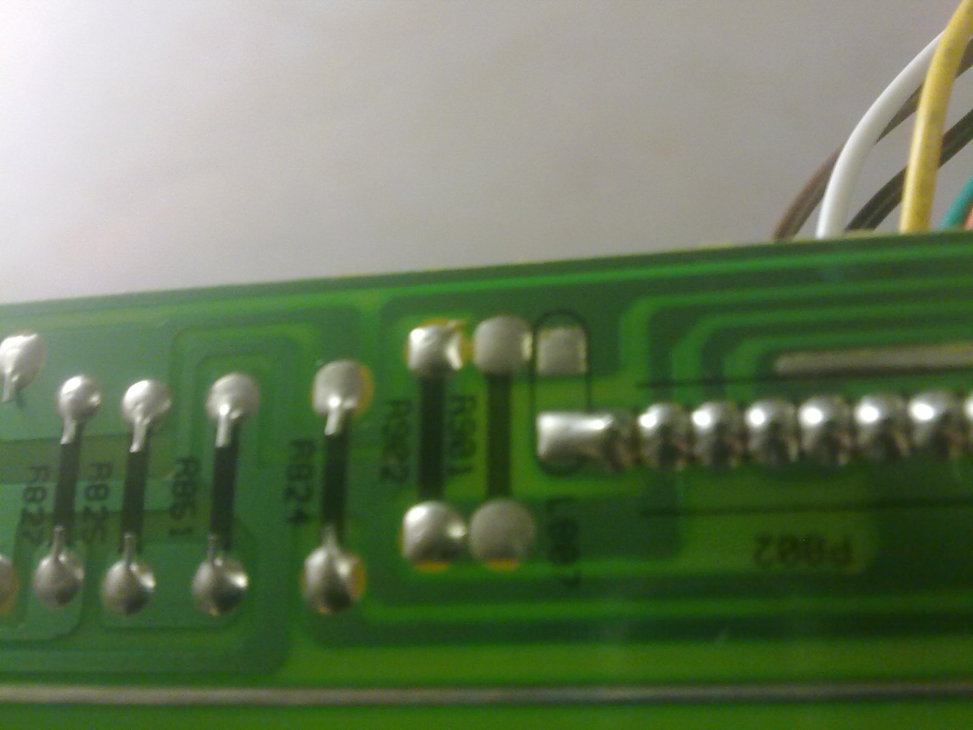

    sorry for the quality
    you should just make out pin 9 is not joined
    • jetadm123
      • 2169
      #62
      Re: Yusmart 229IP-P 22" LCD Monitor Dead
      Ah, I see. It wasn't as obvious in post #11, but your photo makes it clear. Thanks for checking. Also, in your first post, you mentioned that it was an eeprom that was was the cause of your problem. Can you share how you came to that conclusion and how you tested it? What is the part # of the eeprom and whether or not you had to program it. Thanks.

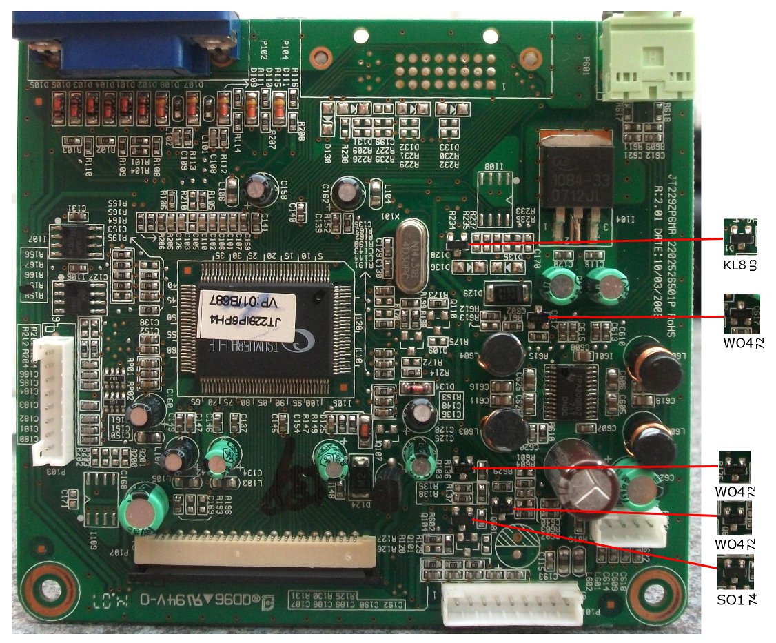

            #65
            I have sccanned the board and listed the SOT-23 package chipsets that I can see....
            I have been trying to identify them from what little info they have on the chips but haven't been very successful so far
            • PlainBill
              • Feb 2009
              • 7034
              #66
              This site has information on marking codes. You are correct, many of these codes don't appear in the references.

                #67
                I would of thought MMBT3906 or PMBS3906
                • jetadm123
                  • 2169
                  #68
                  Hmmm, I can't see them using three WO4 as a reset controller. KL8 seems to be a diode assembly. That leaves SO1, marked Q104 on the circuit board. I would think that the reset controller would be marked UXXX?

                    #69
                    The main board in this service manual uses TSUMU58WJ
                    • PlainBill
                      • Feb 2009
                      • 7034
                      #70
                      That shows a simple R/C reset circuit, although the board has provision for a reset controller.

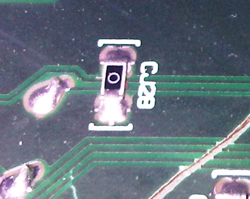

                            Completely unrelated I know but just on the off hand...... can anybody identify the component in the image below for me?
                            It only has a marking of 0, is it a smd capacitor?
                            • Th3_uN1Qu3
                              Believe in
                              • Jul 2010
                              • 6031
                              • Romania
                              #74
                              It's a zero ohm resistor. Basically a wire link, but making it in this shape enables the same machine that places resistors and caps to place the wire links as well.

                                #75
                                Thanks for that, I assume I could replace them with a jumper wire without any issues?
                                • Th3_uN1Qu3
                                  Believe in
                                  • Jul 2010
                                  • 6031
                                  • Romania
                                  #76
                                  Umm, why, it isn't showing continuity?
                                  A working TV? How boring!
                                  • fusionmax
                                    • Sep 2010
                                    • 42
                                    #77
                                    No, it is a damaged board. A few of them have been smashed off so I was planning on just replacing them with a jumper.
                                    It is only a control panel so hopefully there should be no RF issues
