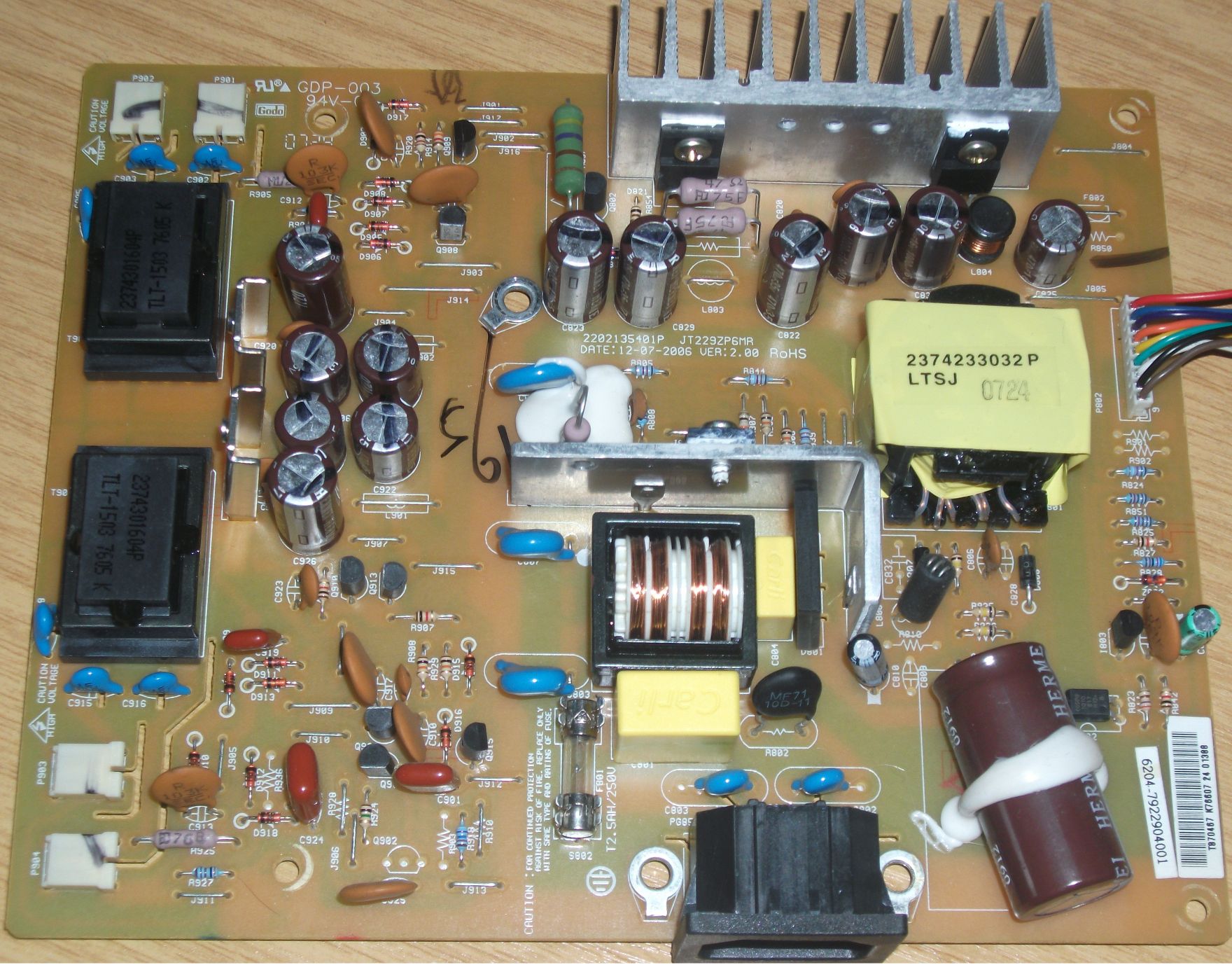

    I have aquired a Yusmart 229IP-P 22" LCD monitor that has no power. When pressing the power button nothing happens at all.
    I have stripped the monitor down and done some research and the power board appears to also be used in Viewsonic VS11446, I have included some links below.....
    http://www.shopjimmy.com/power-suppl...ic-vs11446.htm
    http://item.taobao.com/item.htm?id=6880290874
    I have done a visual inspection of the board and all of the capacitors look good with no bulges or leaks, they are 'Hermei' brand.
    I also managed to find a service manual for the Viewsonic monitor with the same power supply, this can be found at this link
    Please can somebody advise me on my next move?

    Is there a reason why you removed the main fuse located to the left of the power plug?
    With the fuse in place, your next step would be to check the voltage across the large brown cap (lower right corner). BE CAREFUL as this is HIGH VOLTAGE! If you're in the USA the voltage should be approx 165VDC.

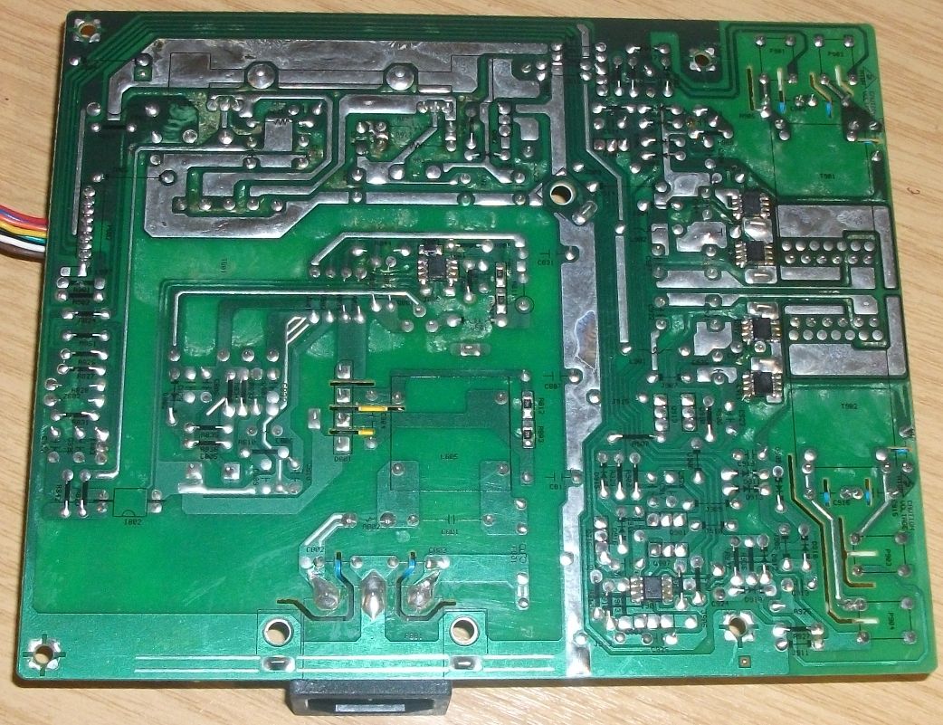

              If you see none of those voltages, we will need a clear focused picture of the backside. On the backside, there is likely to be a 8, 12, or 16 pin IC. We will need the part number for that chip.

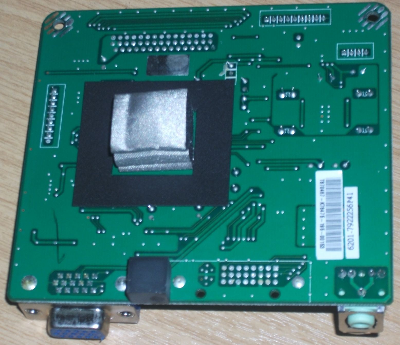

              • fusionmax
                • Sep 2010
                • 42
                Re: Yusmart 229IP-P 22" LCD Monitor Dead
                I have tested the voltages using my multimeter and included them below, I seem to be getting 5v from 3 points.
                • retiredcaps
                  • Apr 2010
                  • 9271
                  Okay, voltage should be getting to the logic board if you see 5V DC.
                  Does the power LED turn green or any other color when power is applied?

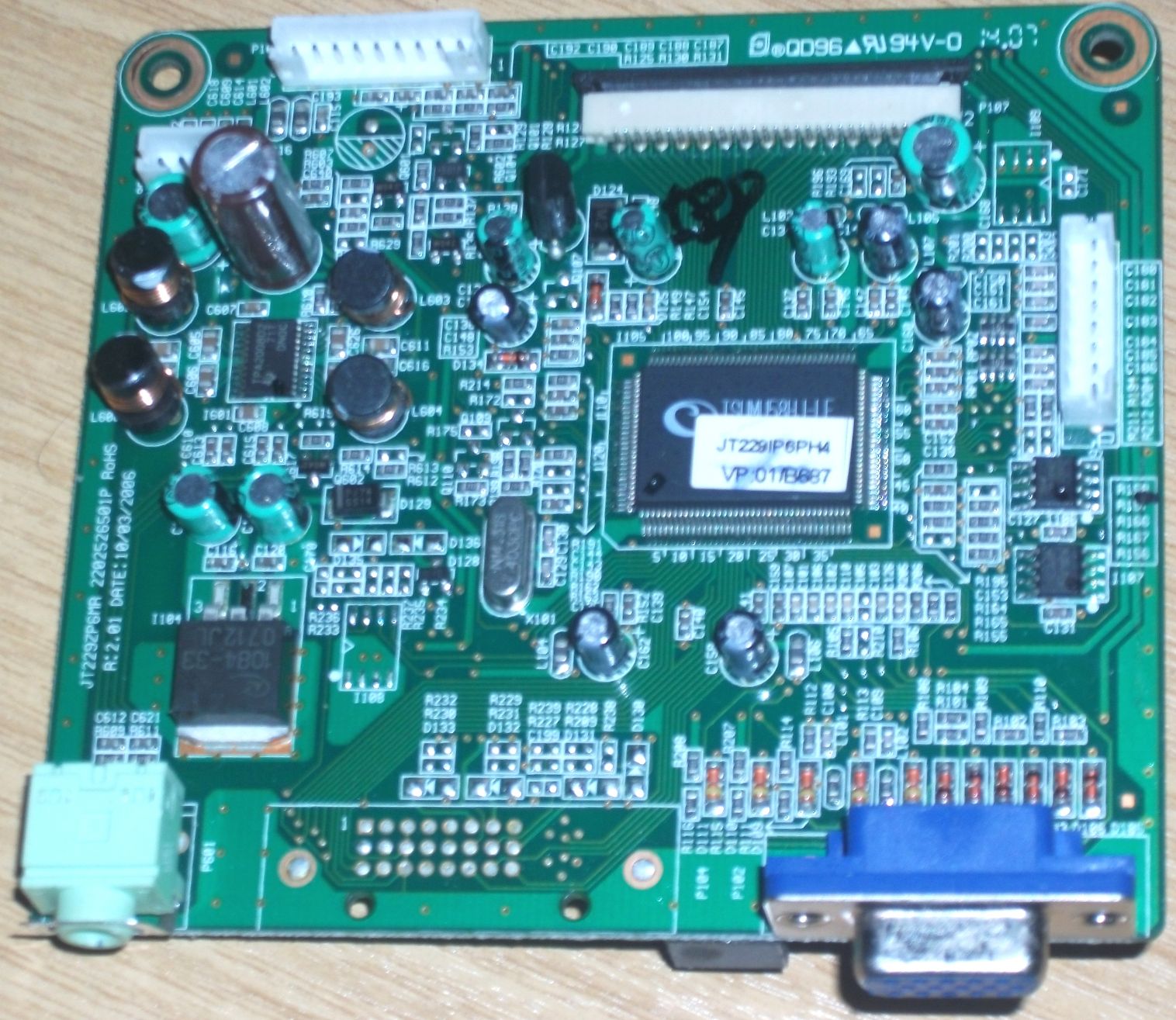

                  Also, please post a picture of the logic board (top down view) both sides.

                    • fusionmax
                      • Sep 2010
                      • 42
                      The power LED does nothing when it is pressed or the power lead is plugged in.
                      How would I go about checking the diode at D821? Would I need to remove it from the board to test it with my multimeter?

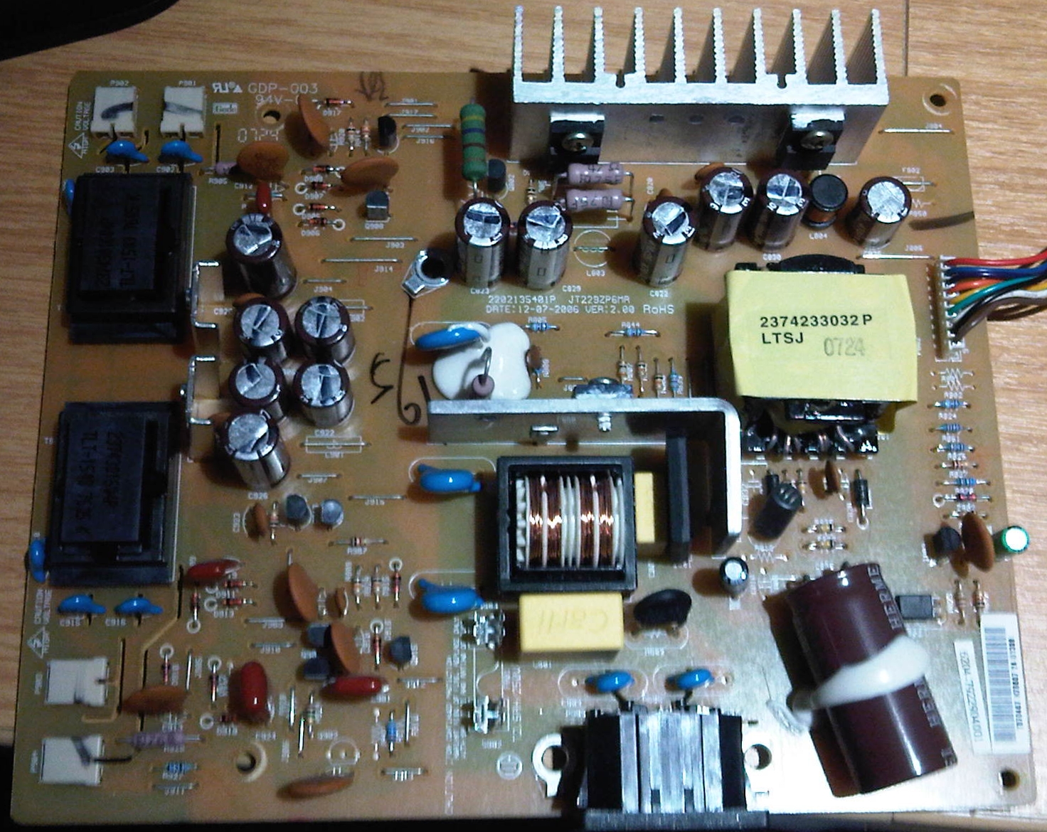

                      I have also attached some hi-res pictures of both the front and back sides of the PSU board and logic board.

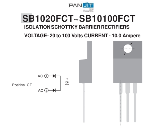

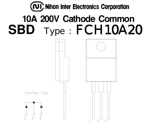

                        Check the diode "in circuit" first. If the readings are suspicious, then you will have to remove it and retest.
                        If it is a dual diode, it should have two diode symbols pointing at each other towards the middle pin (pin 2).
                        Put your multimeter on ohms scale. With power off and lcd unplugged.
                        1) put red on pin 1, black on pin 2. report ohms.
                        2) put red on pin 3, black on pin 2. report ohms.
                        3) put red on pin 1, black on pin 3. report ohms.
                        Now switch to diode mode setting on your multimeter.
                        1) put red on pin 1, black on pin 2. report volts.
                        2) put black on pin 1, red on pin 2. report volts.
                        3) put red on pin 3, black on pin 2. report volts.
                        4) put black on pin 3, red on pin 2. report volts.
                        edit1: PS. What is the part number of that IC chip right in the middle of the power board (backside)?
                        edit2: Test both dual diodes. One is for the 5V and the other is for 24V DC or 19V DC. We don't know which is which.

                            I have also managed to find what the two diodes are and the datasheets for them if that helps?
                            D821 - DIODE,SCHOTTKY FCH10A20 TO-220AB NI - datasheet
                            D822 - DIODE,SCHOTTKY SB1060FCT TO-220AB PEC - datasheet
