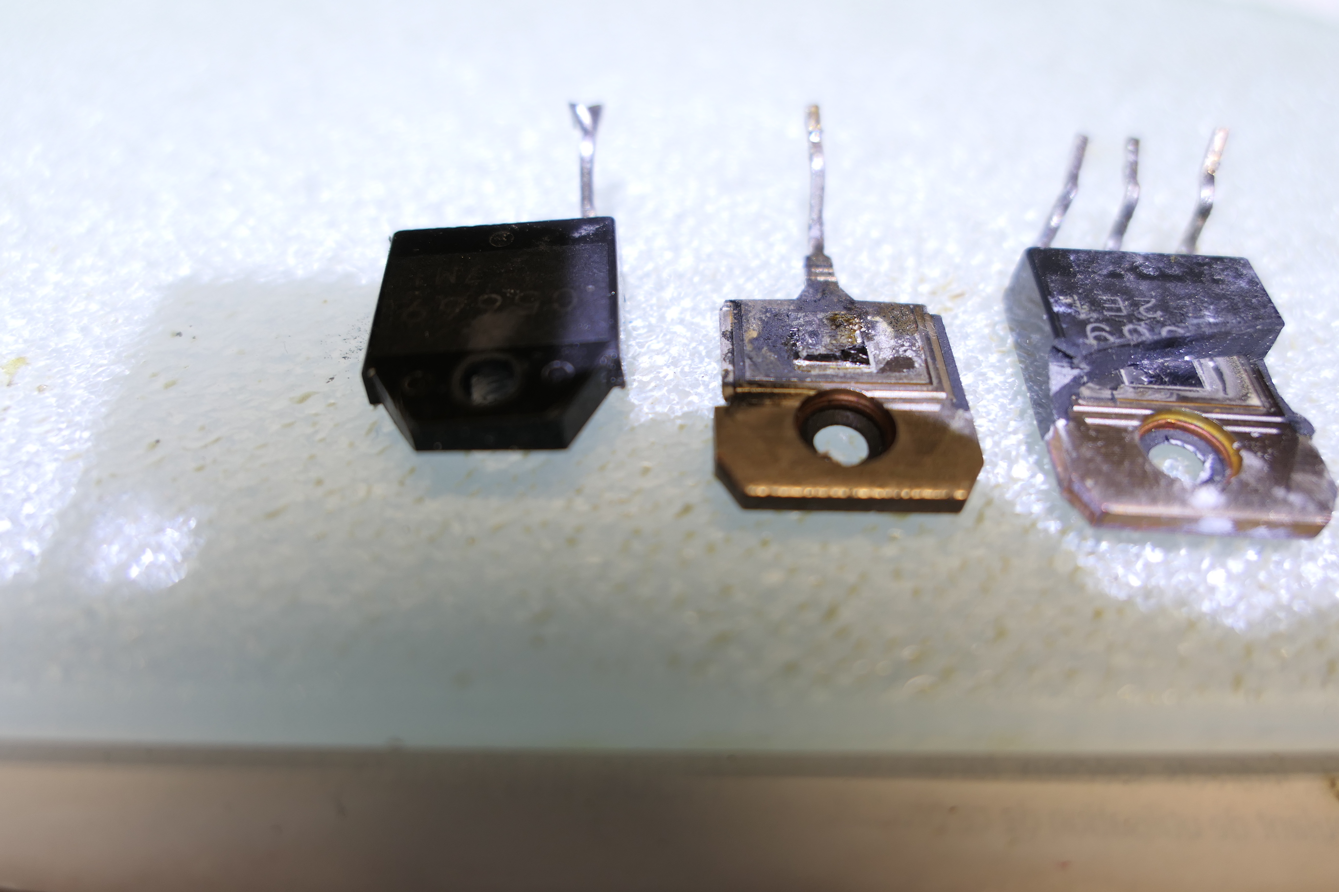

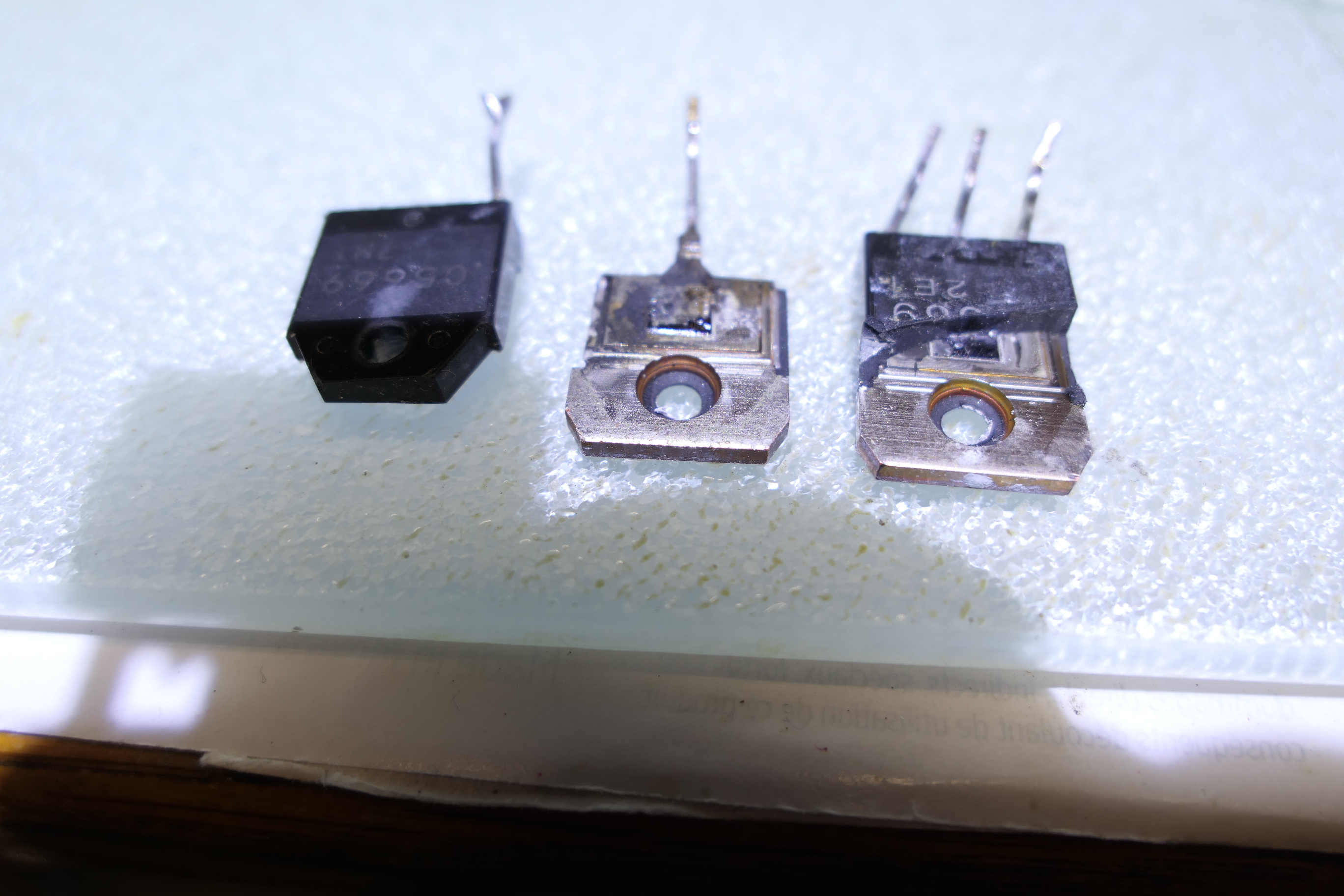

        Re: Help with blowing transistor NAD T752 receiver
        Originally posted by lotas
        Maybe the transistors are not original (remarked) and they will not match their parameters, the Chinese love to do this
        Originally posted by rddube
        Any suggestions on where I should look, what component should I test? Please, anything?

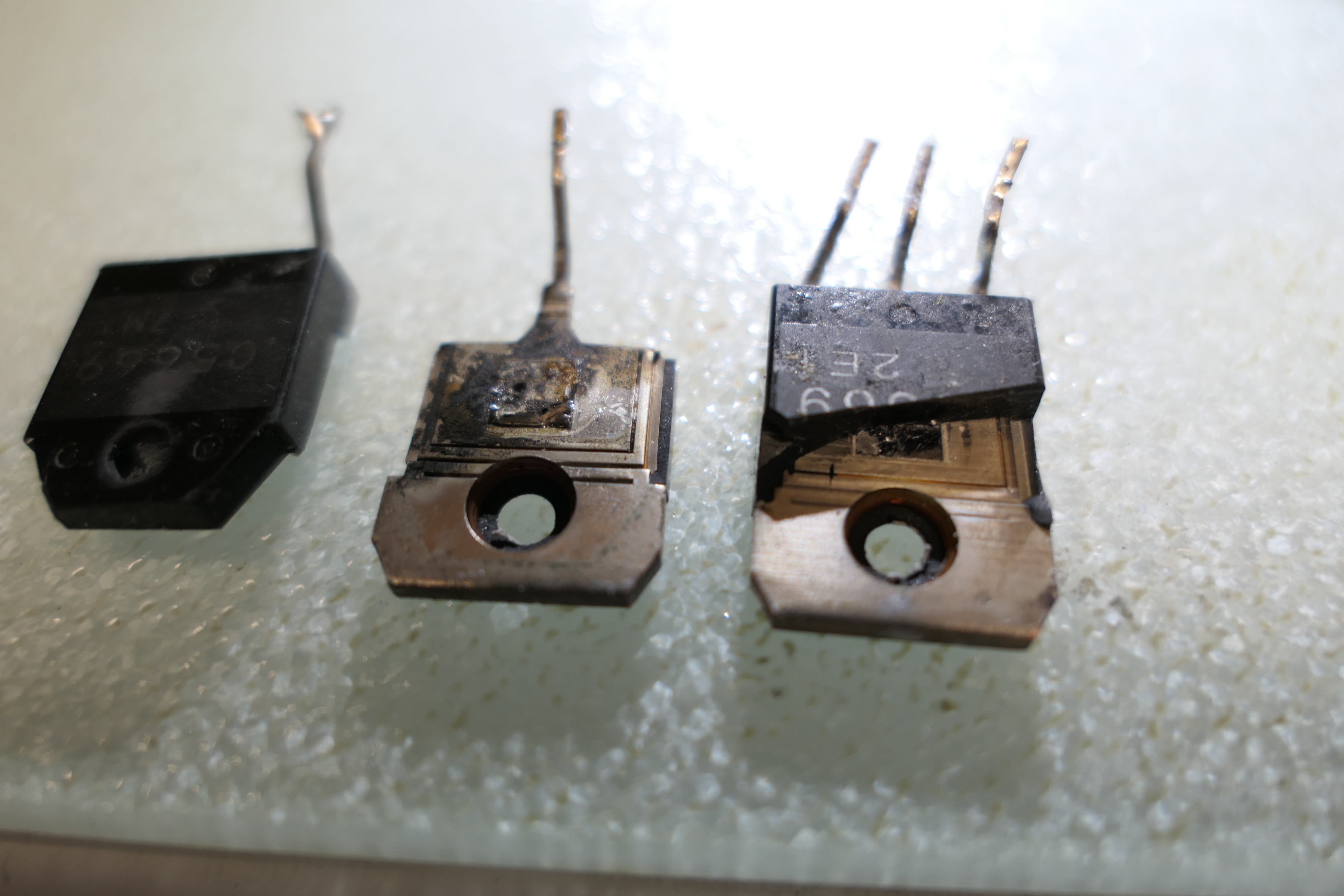

        I would take your current destroyed parts and open them up:
        You have one original from the unit and the one you bought.
        Open them both and see if the die is the same physical size.
        If it is not you have your probable cause why it failed.
        (Lots of counterfeit and relabeled chips from China!)
        Two examples below, a big old hammer or a vice might work.
        Nothing to loose since they are already dead!

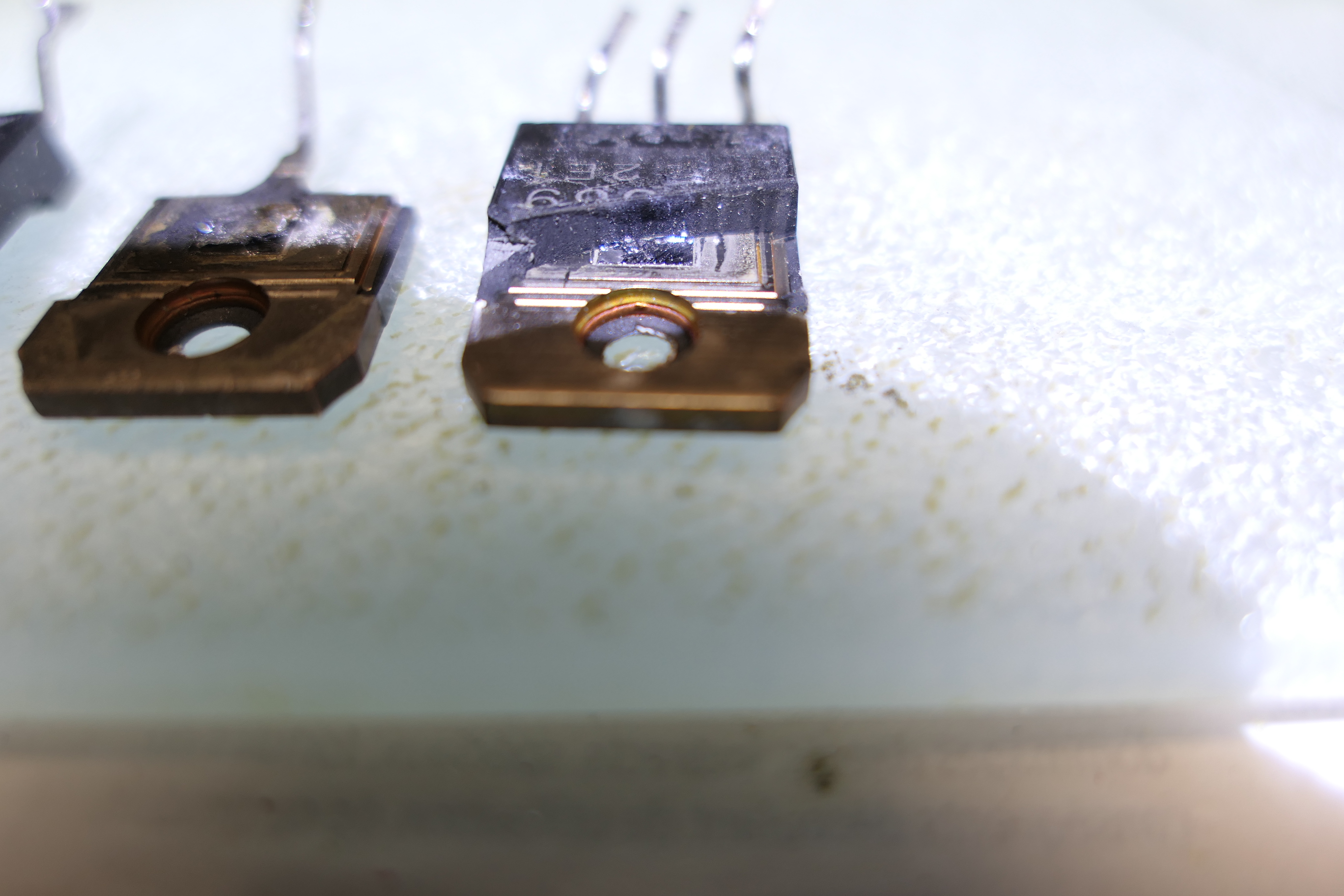

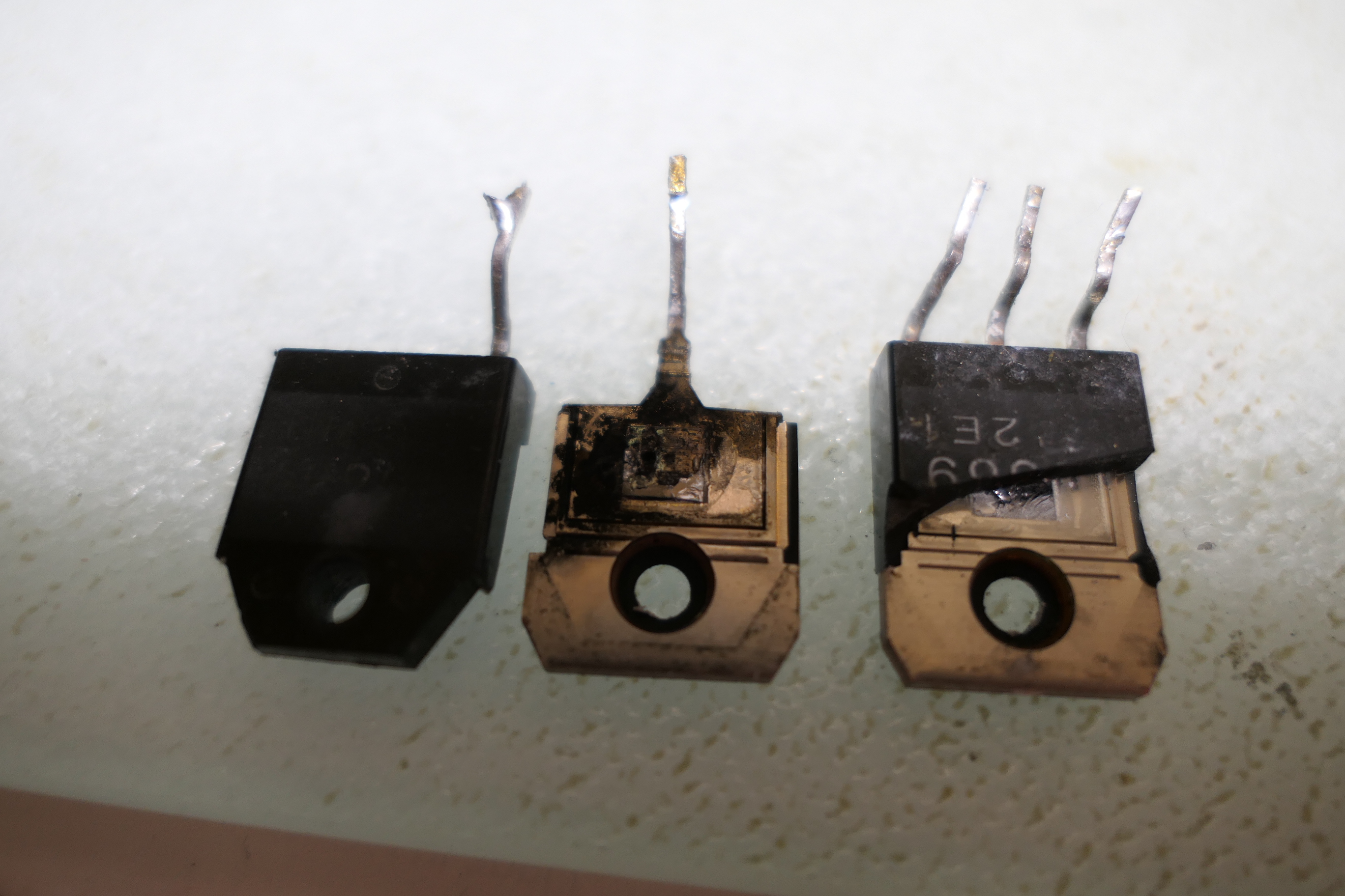

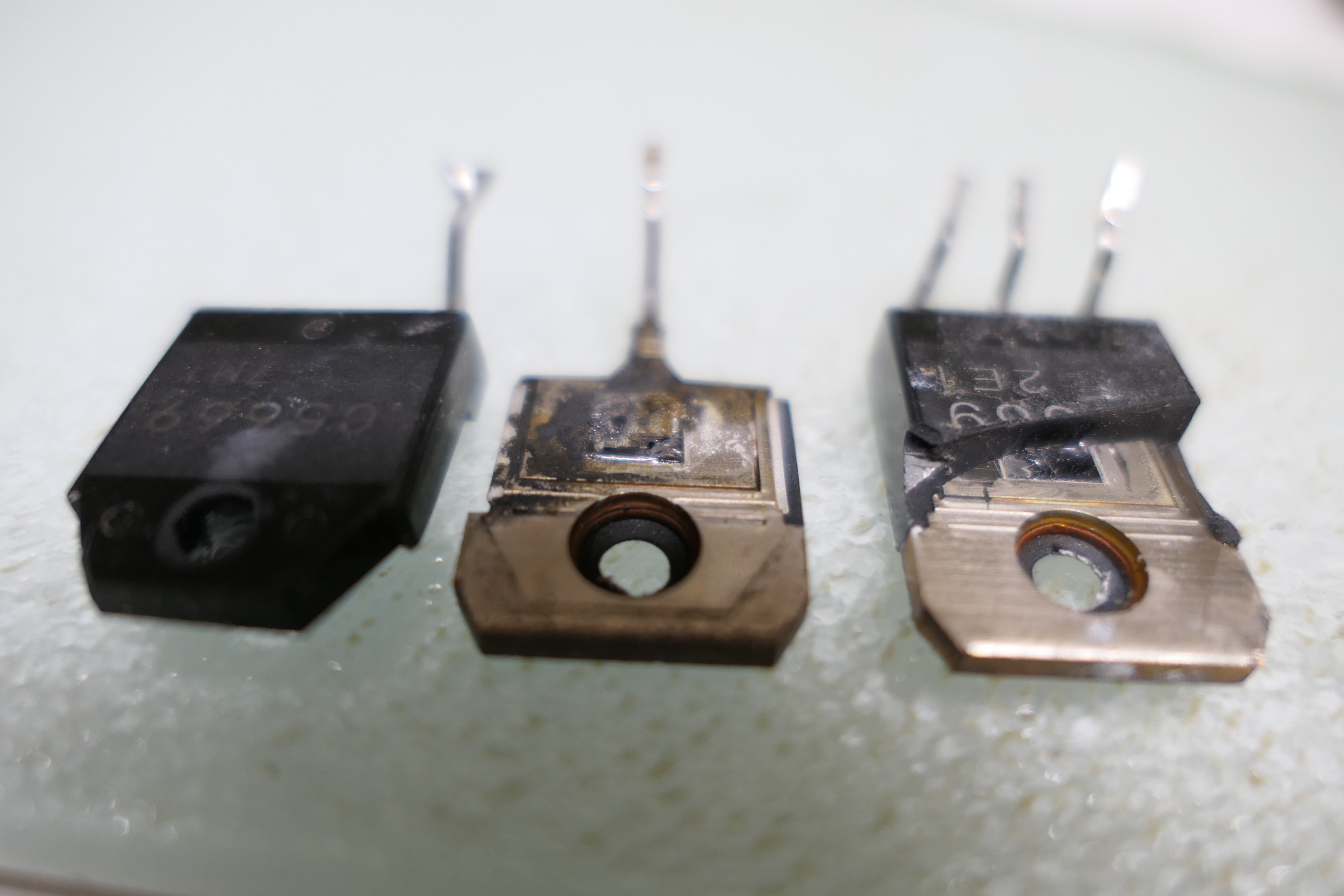

          https://twitter.com/johndmcmaster/st...10403701624833
          https://www.youtube.com/watch?v=W_hIVtcx6CA

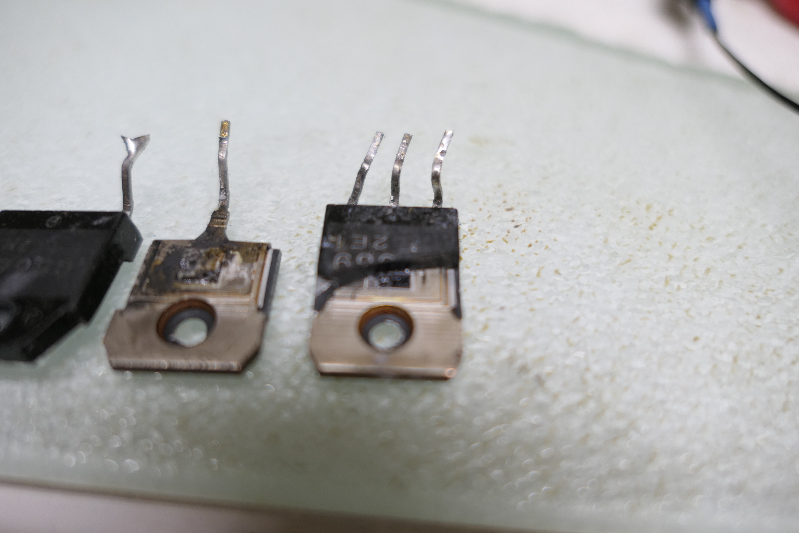

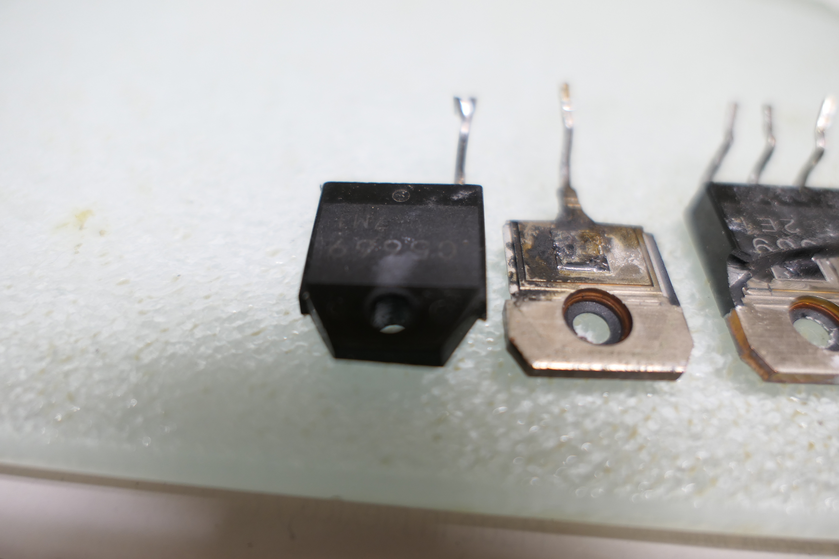

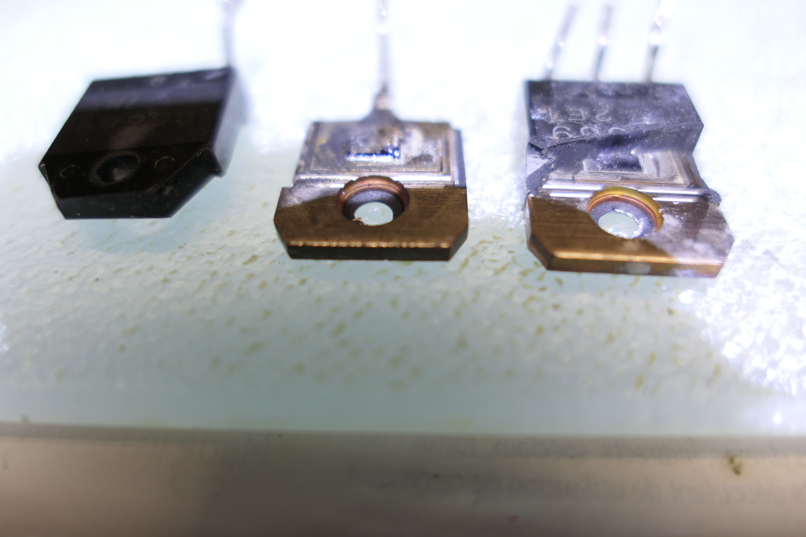

          Ok, so I opened an original (which is the one on the right and was much more difficult to open as it was quite more solid) and one I got from China (the one on the left with it's housing beside it). Do you see any difference in the die?

              • 31214
              they look the same to me.
              • Per Hansson
                • Jul 2005
                • 5895
                • Sweden
                Yup that looks to be the same size to me also, another very important factor is how well they are attached to the heatsink, some cheap crap is made very poorly but this looks soldered so I'd say they are ok from this look.

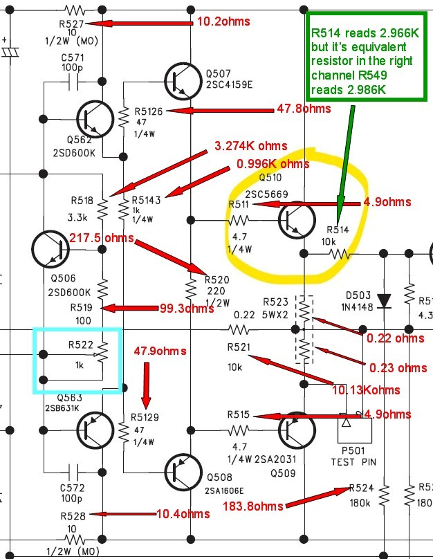

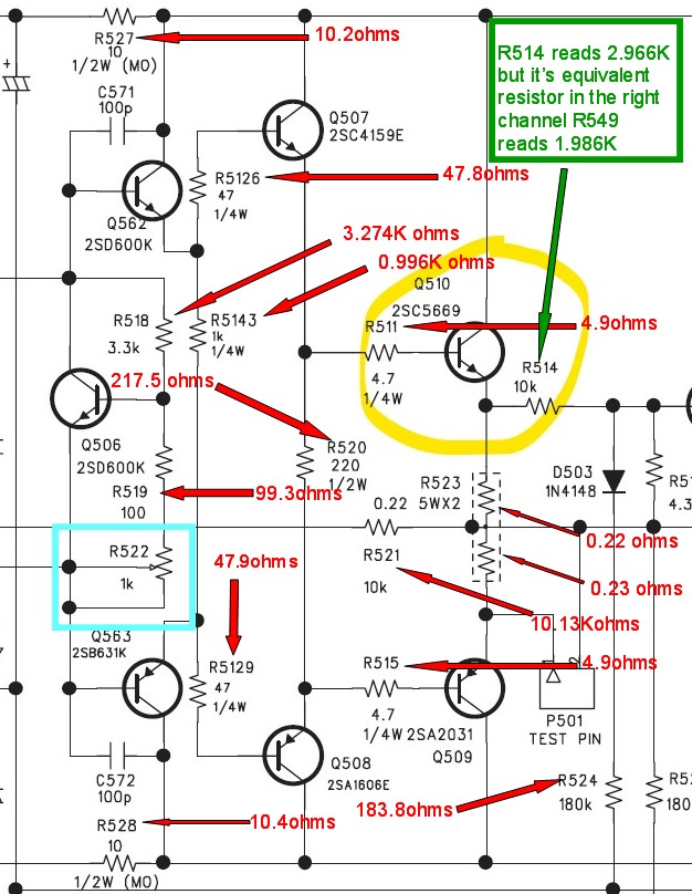

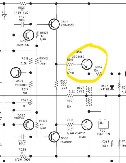

                  Ok, but if we get back to my original problem i.e. Q510 (2SC5669) popping while taking with it Q509 (2SA2031) - I've checked every component on the left channel and compared it to the right channel and they are very close.
                  Petehall453 suggested to check emitter resistors and current limiter resistors but I am unsure which are which. Can someone identify one of each on the attached schematic? Or what else should I be checking? There are 2 100uf 100V capacitors per channel, could they be the culprits? I took them out and checked them on my tester and they come up ok?

                    #29

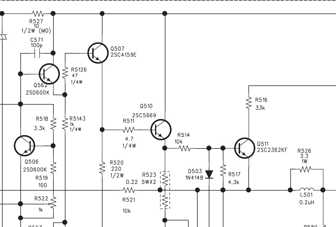

                    concentrate here including the bias trimmer r522 .

                        #31
                        OK so here are the results of every resistor - the only one not corresponding to the schematics is R514, but see my note.
                        As for r522, when turned fully clockwise I get 1.2K ohms, and fully counterclockwise I get 2.6ohms.
                        Many thanks for your input!

                          #32
                          I tested r514 out of circuit to make sure and and it tests 10.086K ..as for my note in the schematic, I made a typo as r549 reads 2.986K ohms and not 1.986K ohms. Correction attached.
                          Also, I tested D503 out of circuit and it tests good.

                            #33
                            Ensure Q562/Q507 and Q563/Q508 aren't shorted and Q506 not open...
                            Curious are you measuring the voltage across R523 when it's operating? Is this what you're getting the 1mV you were measuring earlier?
                            BTW R514 is fine the way it is, we know it's working because your amp went into protection. Maybe too late to protect the devices...
                            You might need to do some power-on voltage tests with Q510 and Q509 removed and so you don't fry anymore, though R523 voltage tests will require these two to be installed...

                              #34
                              Hello Eccerr0r! And thank you for stepping in!! Ok, I will remove Q562/Q507 and Q563/Q508 and Q506 and report back. As for your question, I am measuring R523 at the tespoint P501 for the 1mv that is stated in the manual. I have to admit however that contrary to the right channel that when turned completely clockwise gave me 0mv until I turned it counterclockwise about half way to get to 1mv, the left channel (P501) turned completely clockwise started at 1mv and when I turned it to about halfway counterclockwise is when it went from 1mv to 2mv, I therefore stepped back to 1mv and left it there. While I was turning counterclockwise, it would go from 1mv to 0mv sporadically and it is only when it hit 2mv did it become stable and going back to 1mv it stayed there for at least 5 minutes (which is what is recommended in the manual).
                              I will report back and I can do any measurement you will ask me to do..again thank you for your reply..be back in a few....

                                #35
                                Ok, so removed Q562/Q507, Q563/Q508 and Q506 and all are good, they show NPN and PNP (accordingly) on my transistor tester. So it comes down to only Q509 (2SA2031) and Q510 (2SC5669) shorted before going into protection mode.
