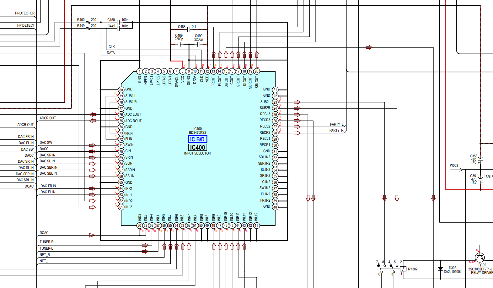

    As far as the IC, not knowing anything but what is spec'd...IF at "face value", it looks the same (all pins) and the cost is cheap and your skills are OK, then it might worth a gamble to go for it... which are probably going to do ... right. :-)
    I went for it. BD3471KS2 seems to be pin compatible and available from Aliexpress... will be a month before it gets here but i will keep you posted!
    As for heating / freezing the IC, It's on the bottom side of the main board. I cant get the system to operate out of the casing. Tried to heat up through the venting holes on the bottom of the chassis, but not sure how hot the IC got, especially that i cant see it!
    Thanks again..

            Unfortunately, IC400 has been removed off the board. The good news, it was removed successfully. Awaiting a replacent

                  BD3471KS2 seems to be pin-compatible. Rohm is not much of a help. So it's a chance.
                  I don't have a datasheet for the original part BD3470KS2, except the schematic sheet in the manual for the amplifier.

                    Ok.. Just received the IC.. Installed, all went well, almost
                    The chip works, none of the distortion is audible (no scope captures - I think I've had enough )
                    I think I may have lost a pad because I lost "Video 2" source, but other than that, everything is working well. Still haven't tested video and other sources, but at least the initial goal of repairing the "Distortion" is a success.!!!
