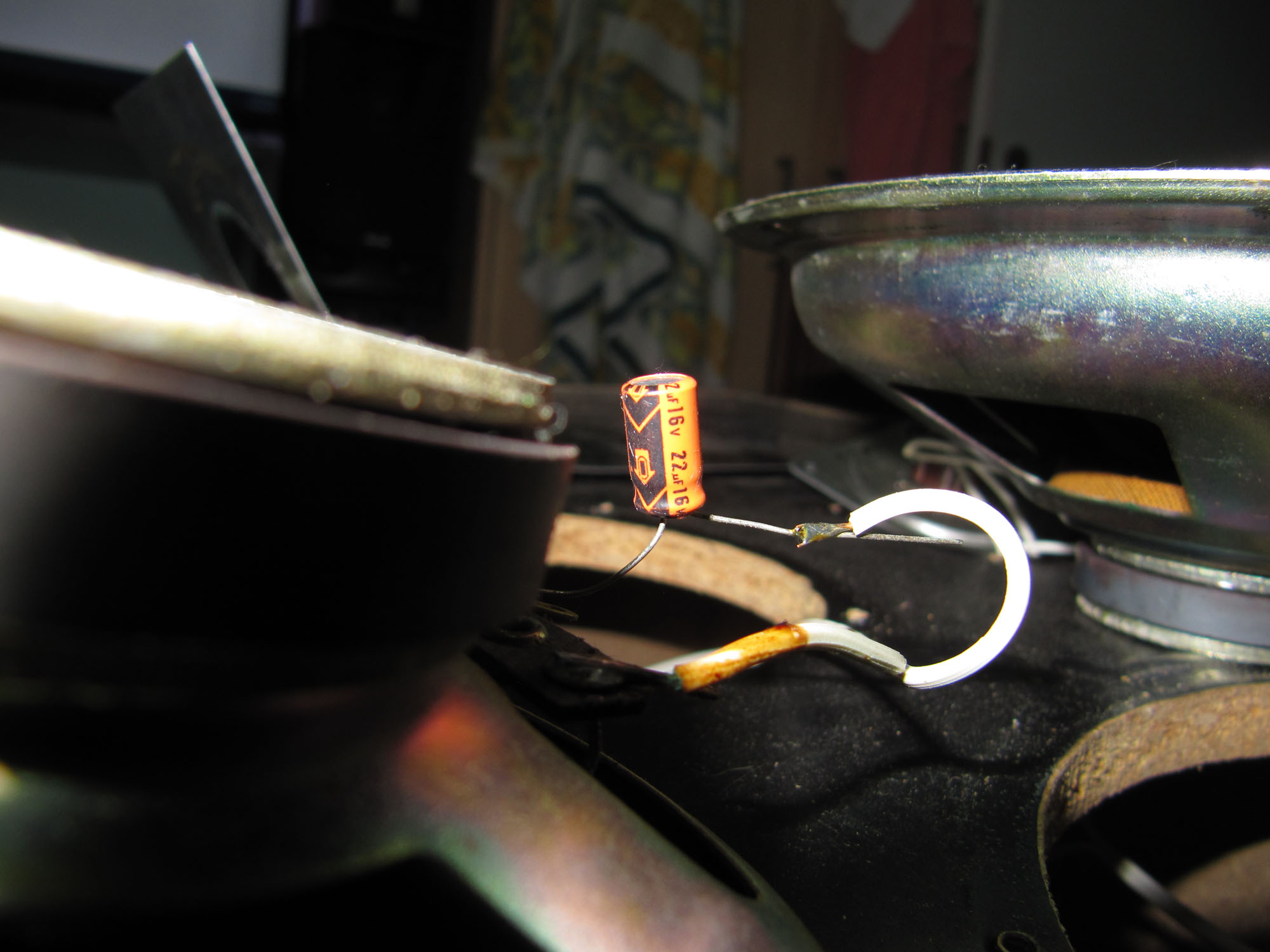

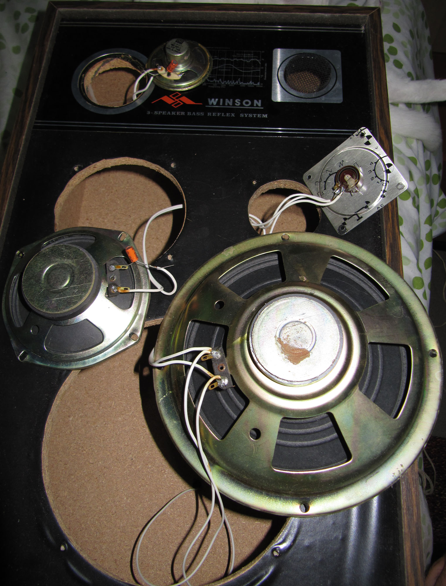

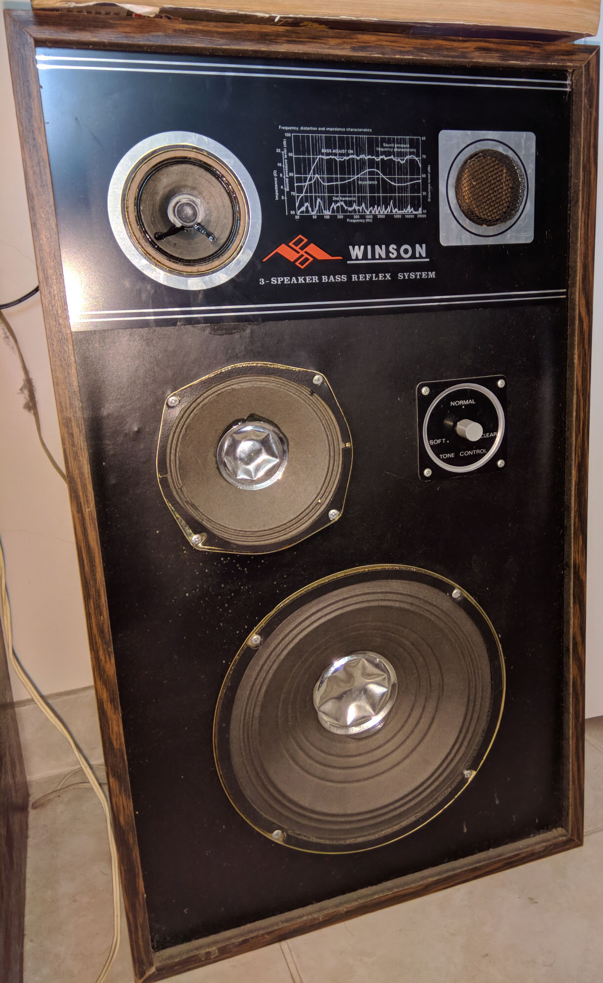

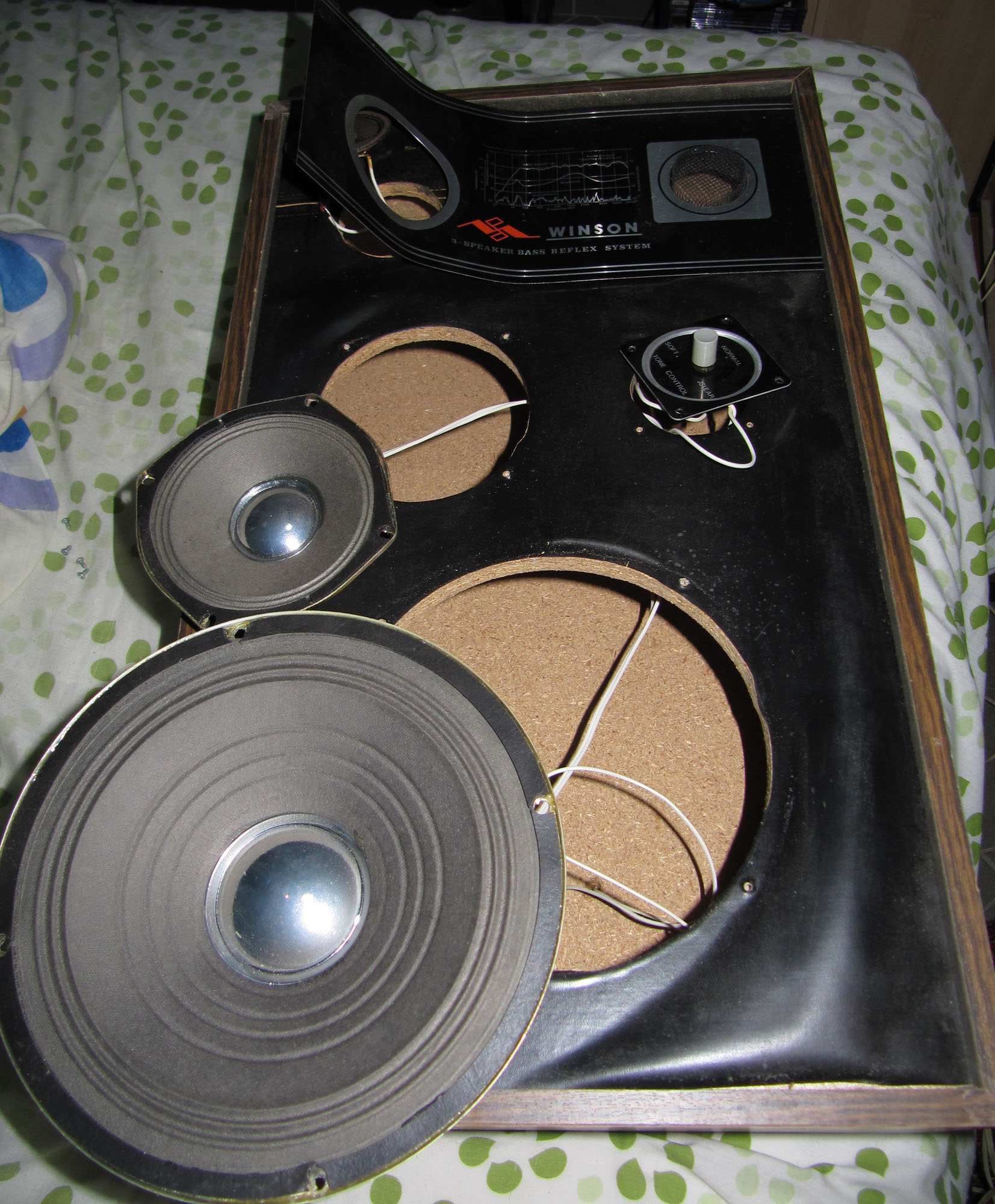

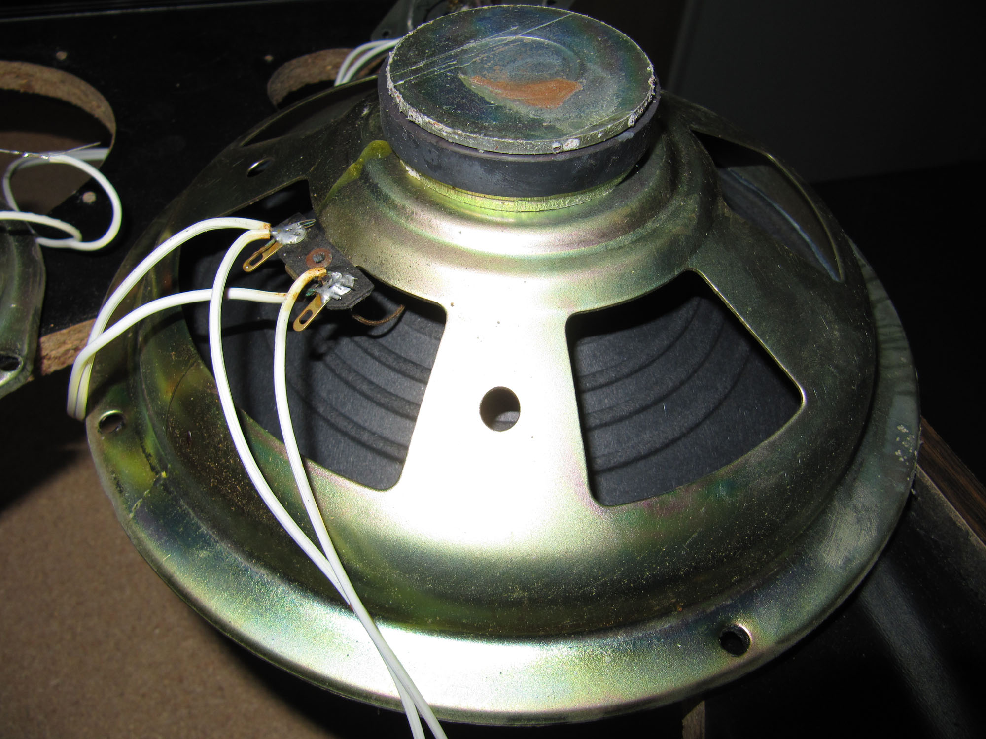

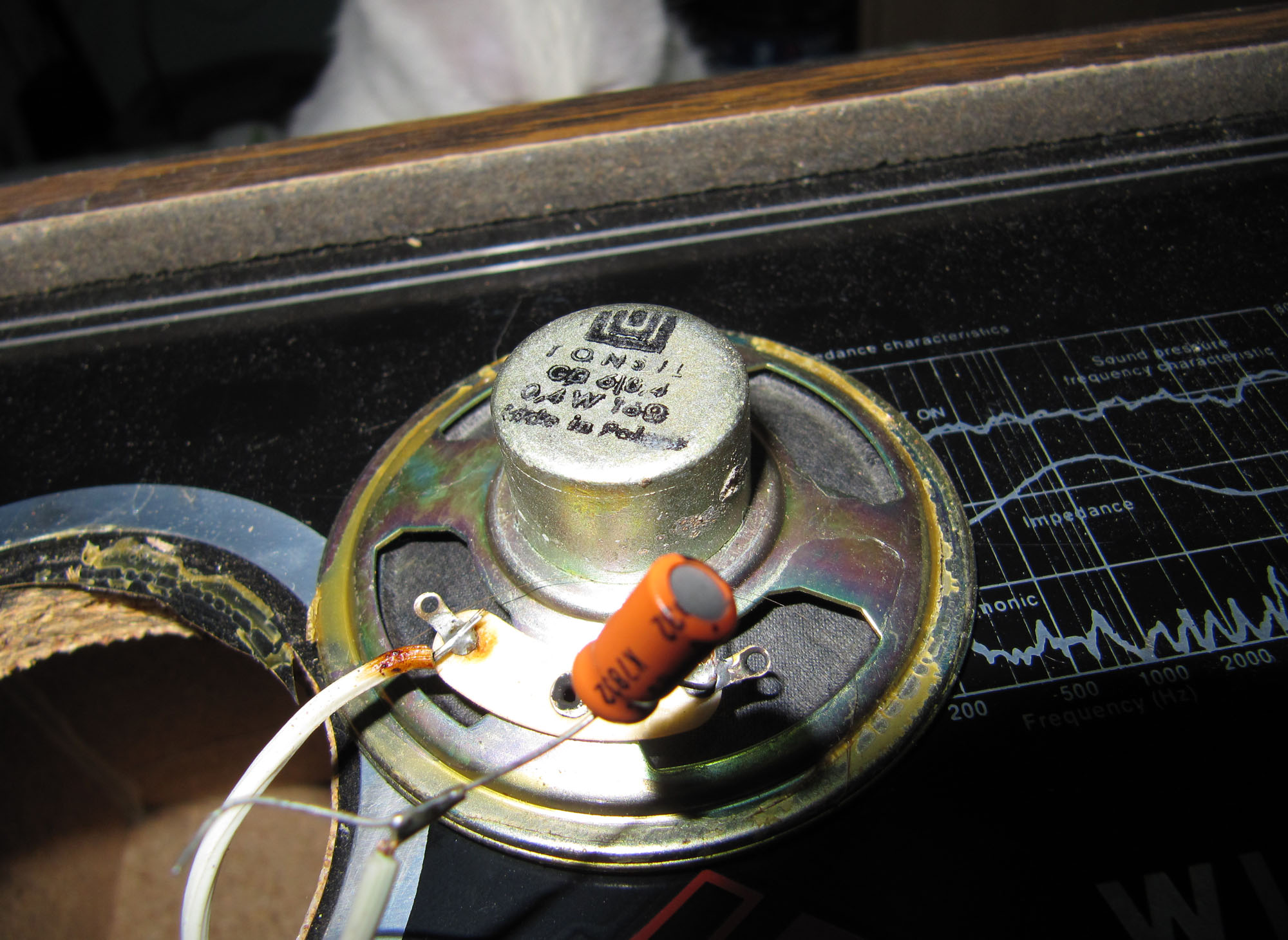

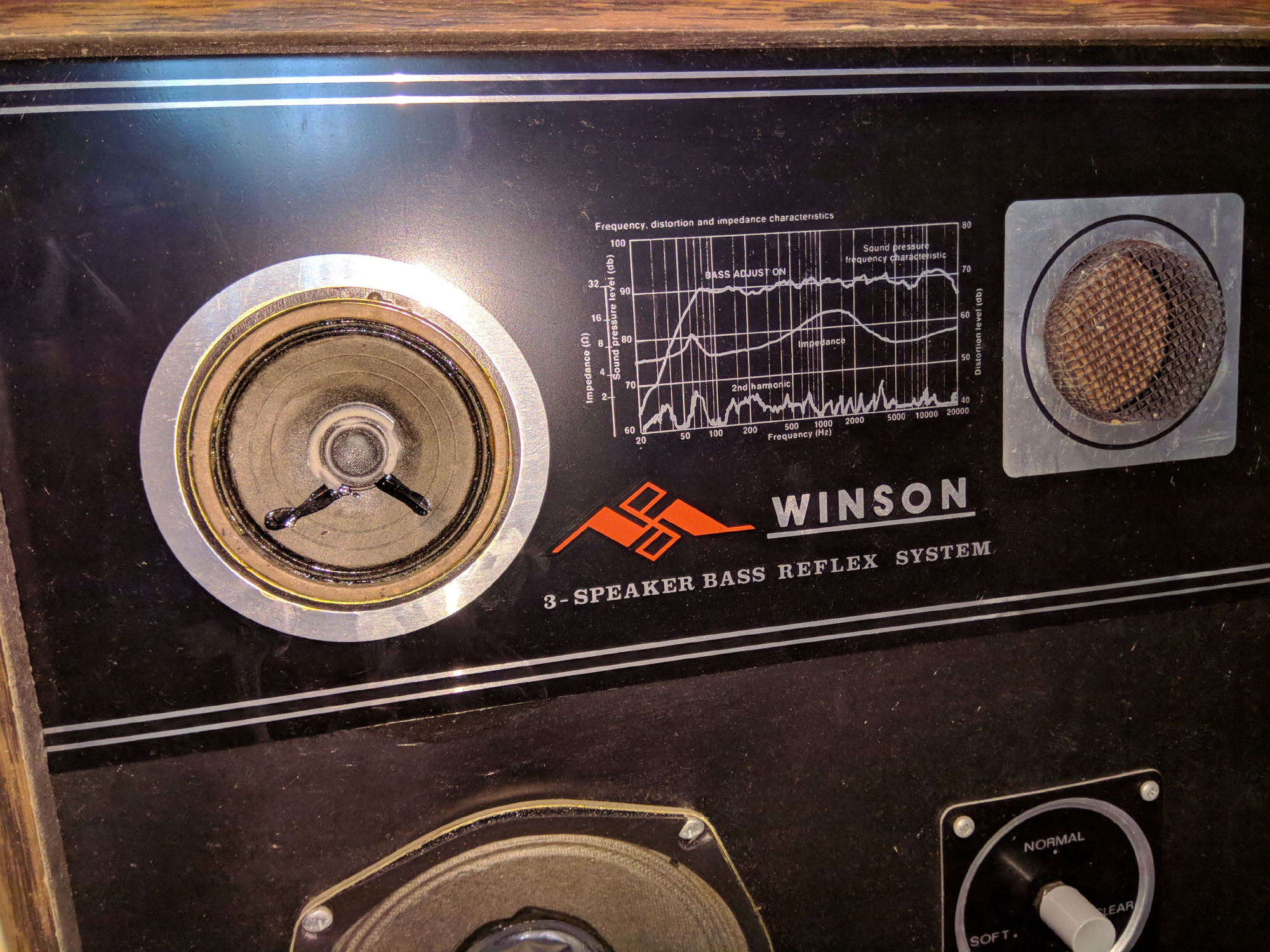

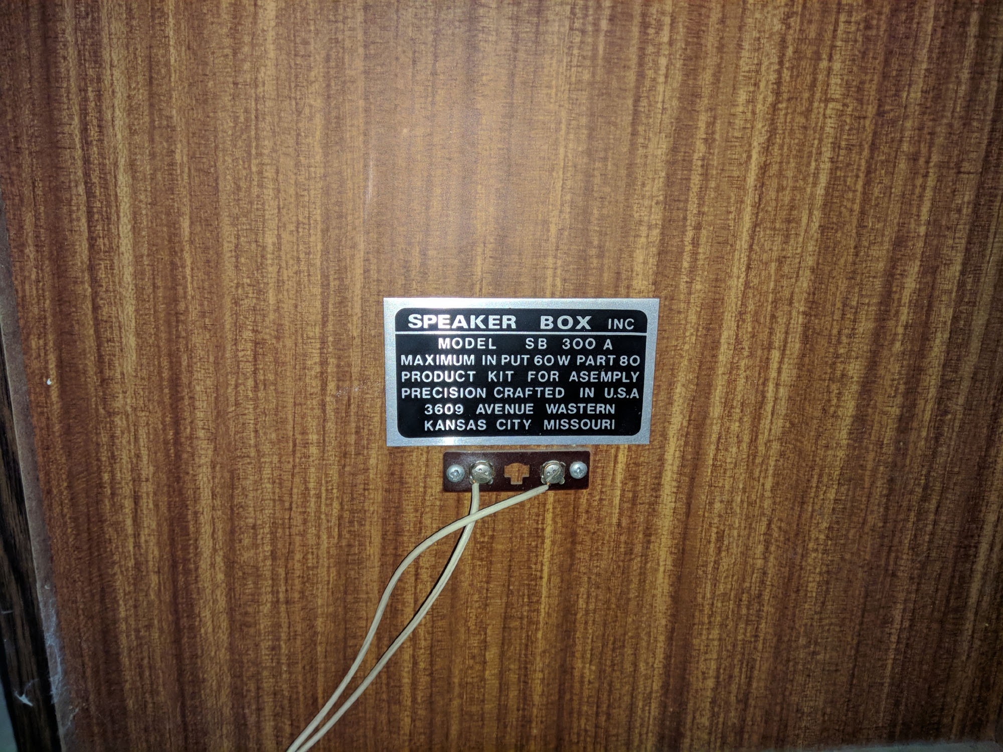

    Anyone knows anything about these?

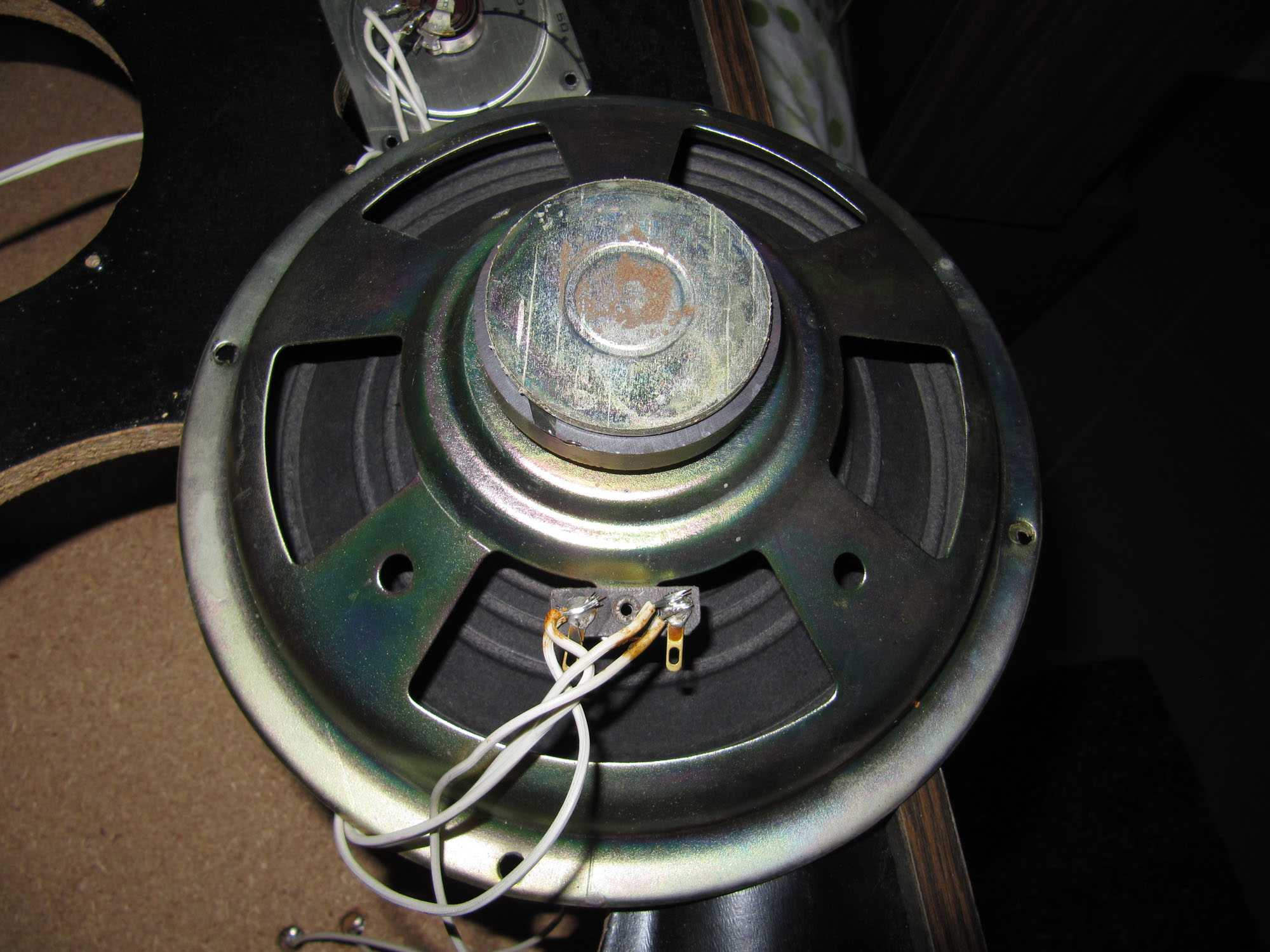

    According to the label they are rated for 60W, but when I disassembled them I was fairly disappointed with the size of the magnets of the speakers.

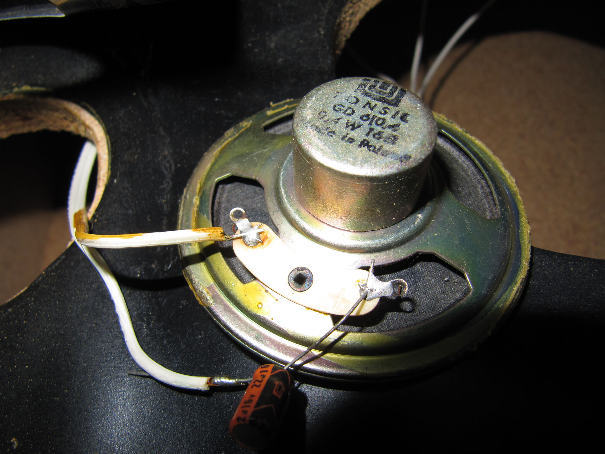

    The tweeter seems to be rated for just 0.4W (!) and made in Poland from Tonsil brand.
    The woofer and the mid-range driver have no markings on them.

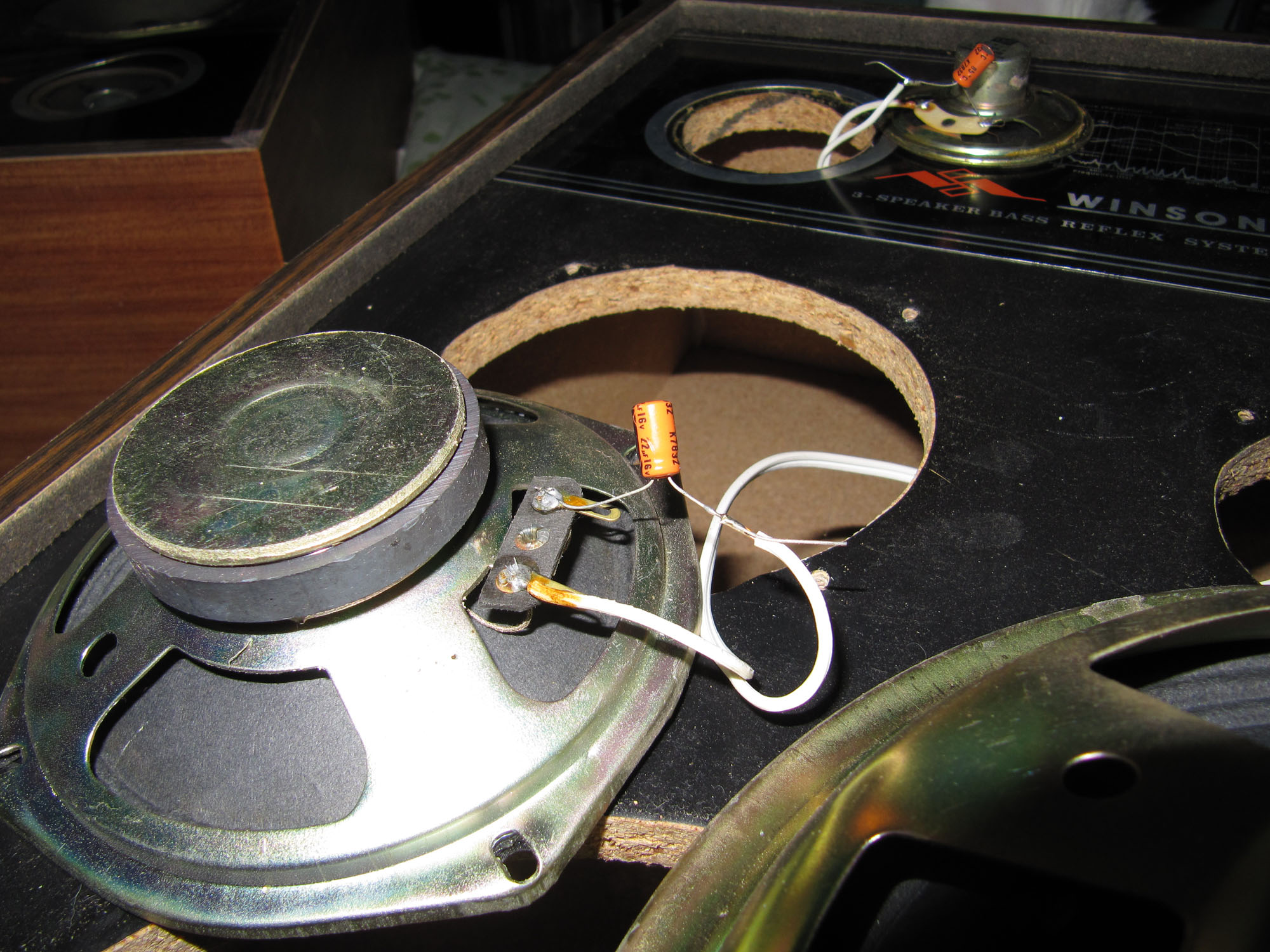

    The crossover is just 2 electrolytic caps in series with the tweeter and the midrange driver and also a potentiometer that is just a variable resistor.
    Pics attached

      The power going to the tweeter and midrange will be limited by the crossover caps. The woofer is likely rated for a maximum of 60 watts, but this could also be 60 watts peak music power, not 60 watts RMS
      They are a low cost set of speakers and were likely paired with a low power amp.
      They look similar to the Technics SB-X300A

        It looks like a low cost china or taiwan speaker. These were sold out of vans by guys in parking lots... or sometimes just fake that everyone thought was a real hifi speaker because they had the look.
        But weird to have Polish drivers, "Product kit for asemply", "Precision Crafted in USA" and a fake Kansas city address. Notice the rheostat aluminum faceplate has a signal generator front-panel exposed on the backside. As if they recycled some parts.
        The electrolytic capacitors are wrong, they should be non-polarized and without any inductors- the speaker's x-over is a rip-off and I would say anthing over 30W would damage the drivers.

          definitely not 60W RMS. I second RJ and redwire's post.

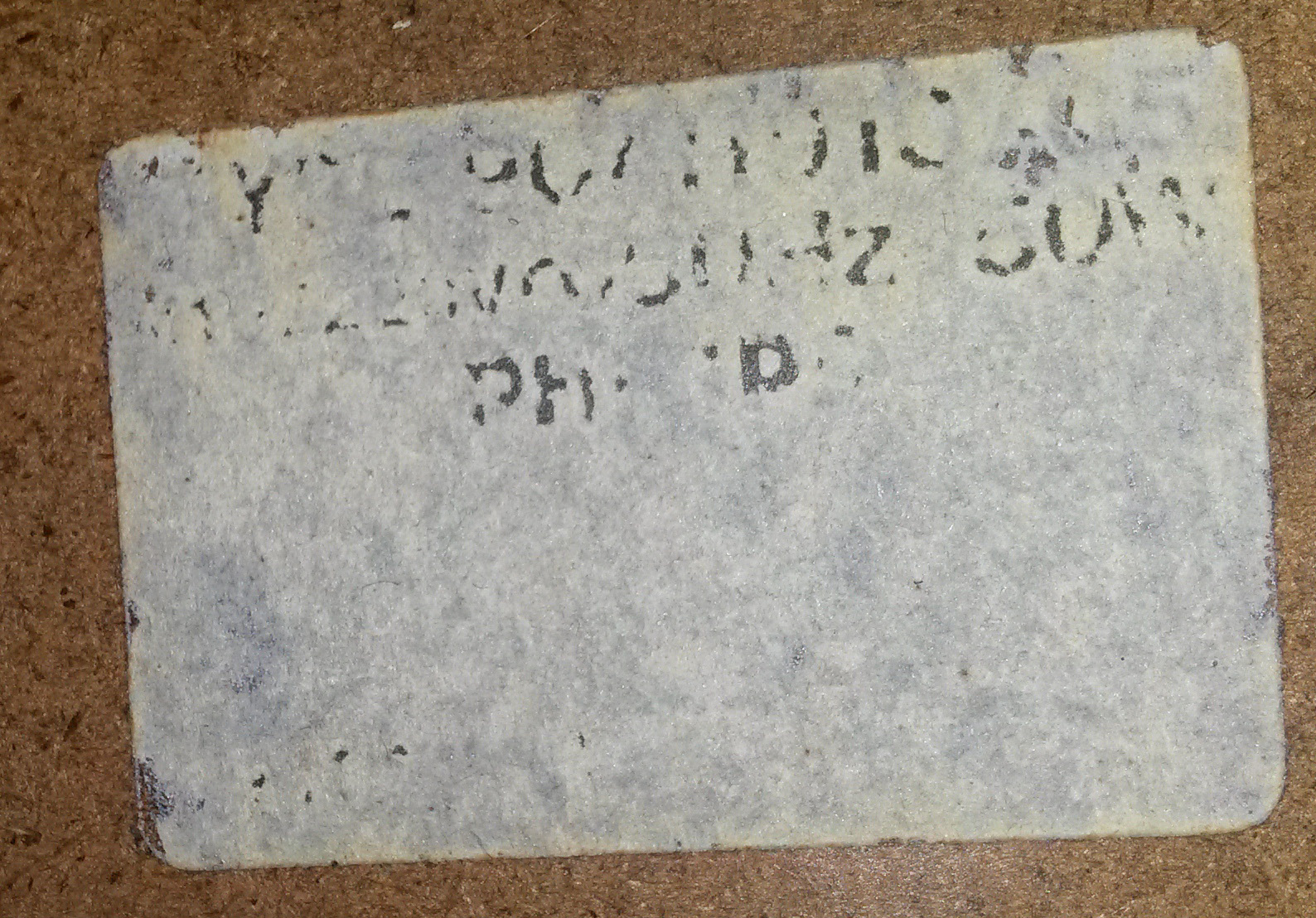

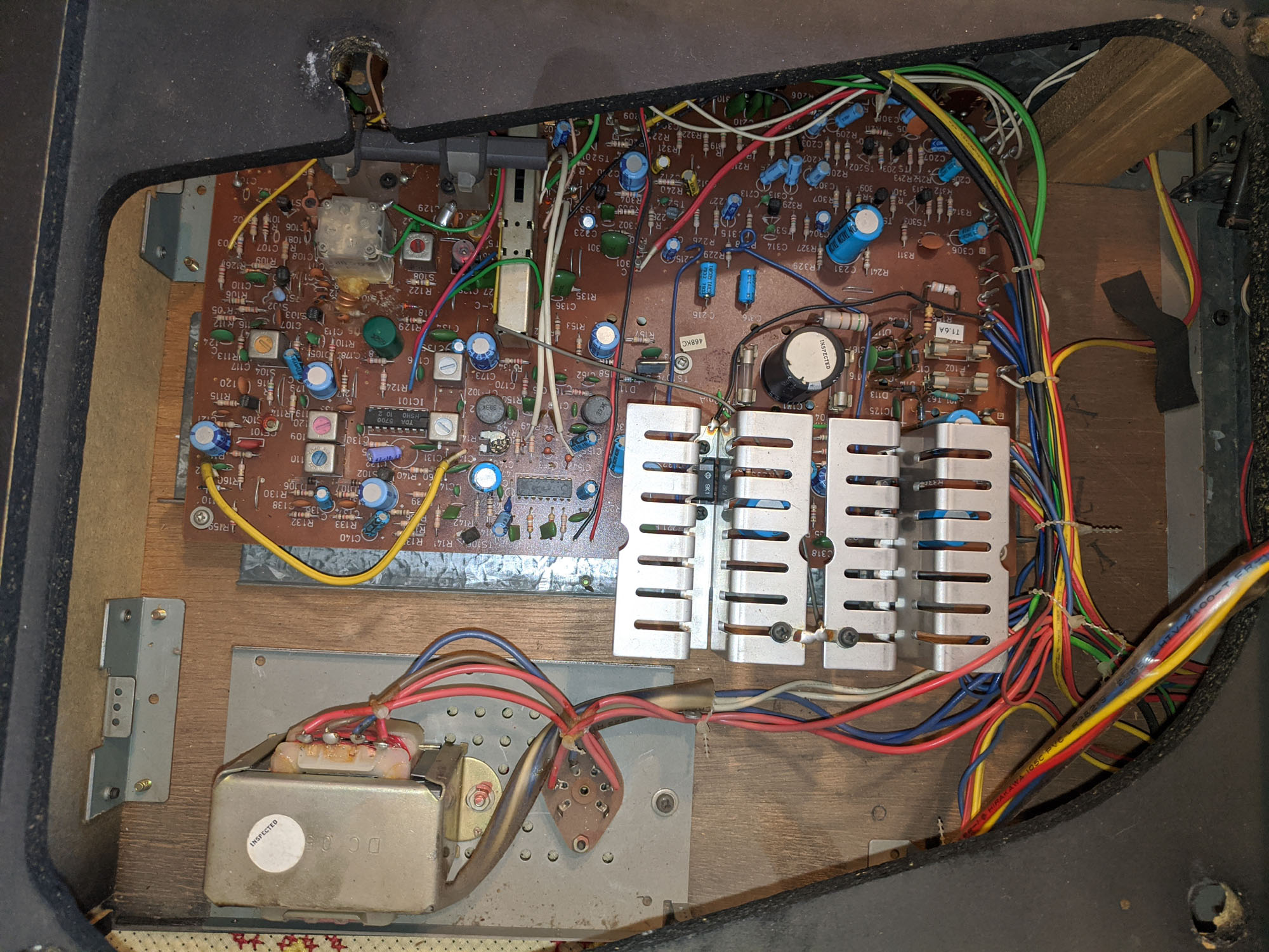

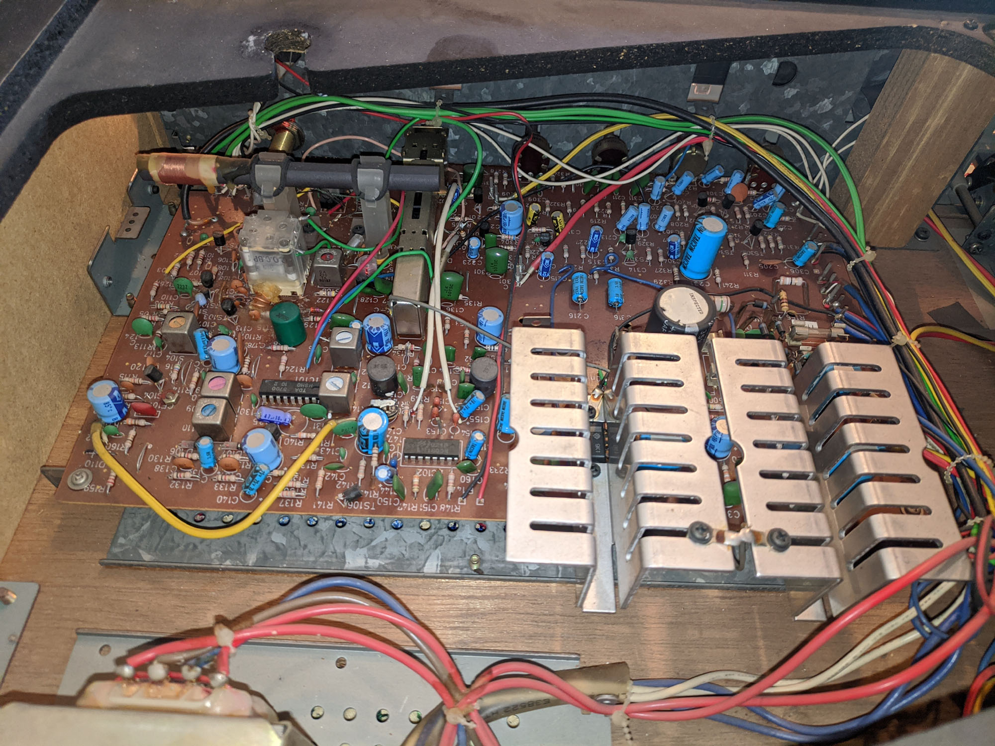

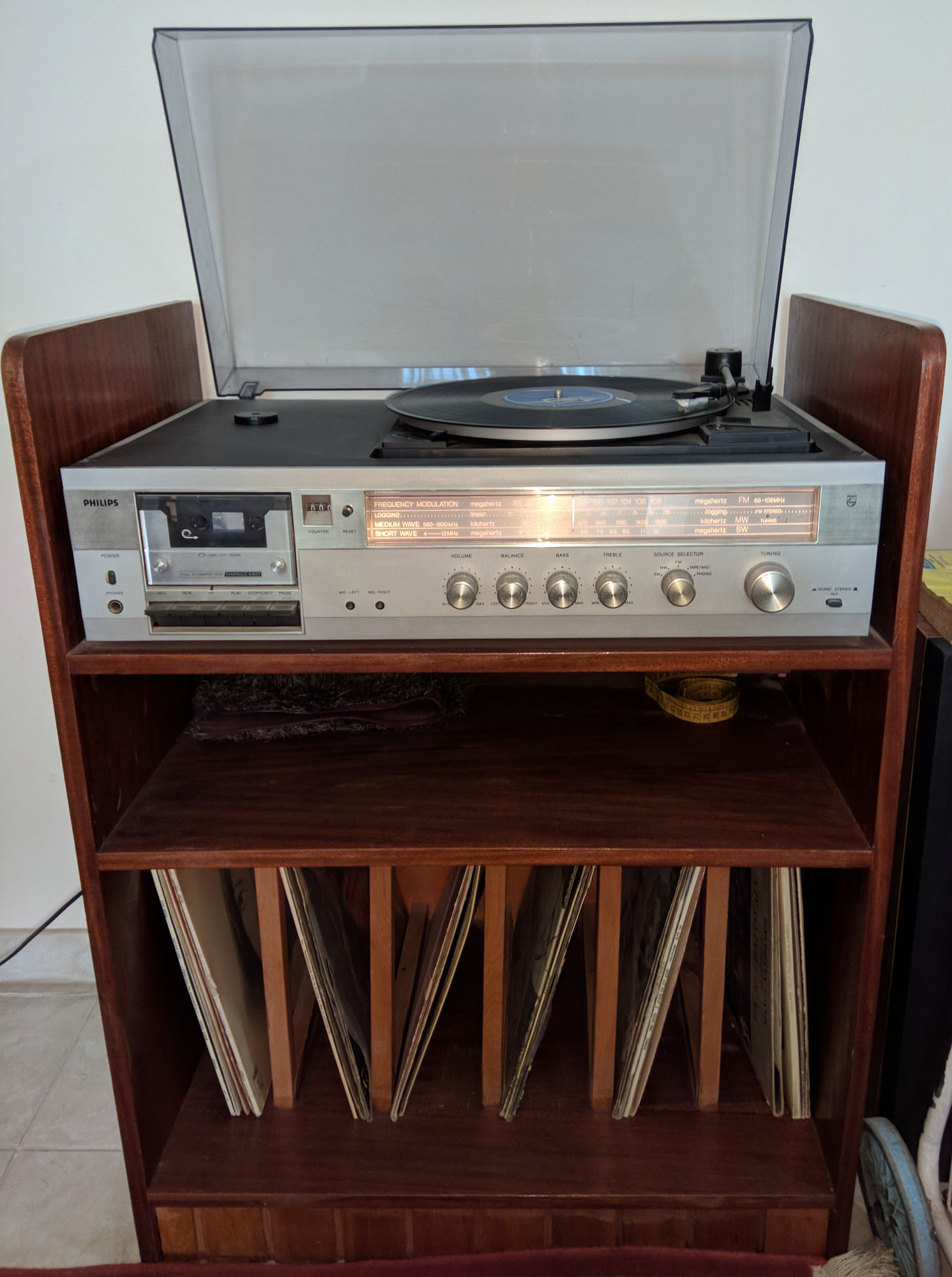

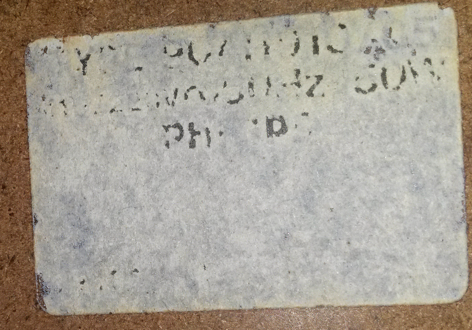

            The amplifier is a Philips stereo cassette turntable receiver.

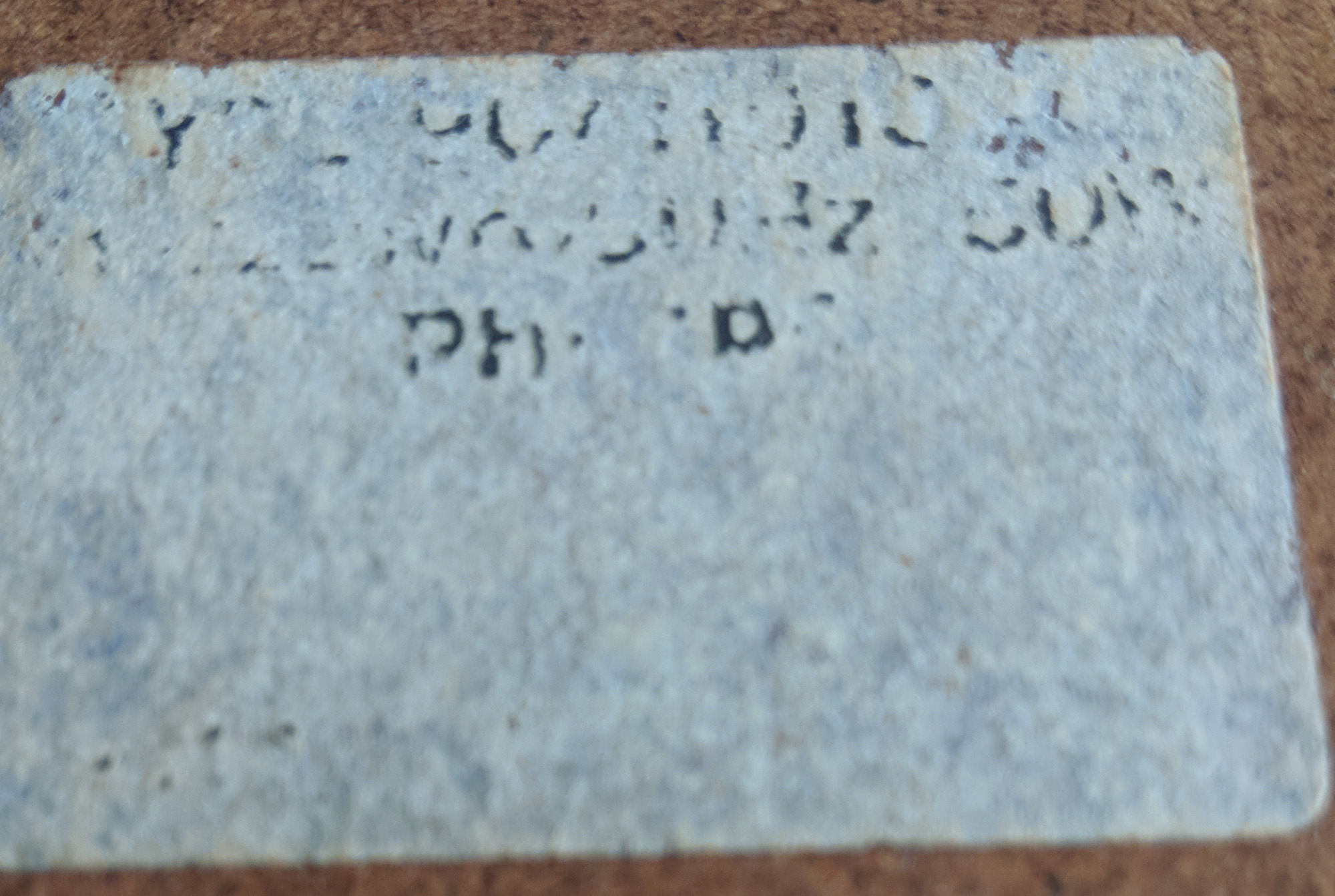

            Unfortunately I cannot find the model name, the unit is made back in 1980 and the paper label on the rear that stated model and other stuff is unreadable.
            The turntable is plastic and it uses the idler wheel type mechanism, no belts, no direct drive. Lately the rubber has totally decomposed, so it needs new rubber wheel like the other Brawnig Mony turntable I posted on the free scores thread.
            Do you think it is worth restoring? I have limited experience with vintage equipment don't want to do any harm.
            But it is really beautiful and the casing is real wood.
            FM radio seems to be working OK.
            Tape makes a loud hum on the right channel. The belts are the original ones from 1980 so probably need replacement anyway.

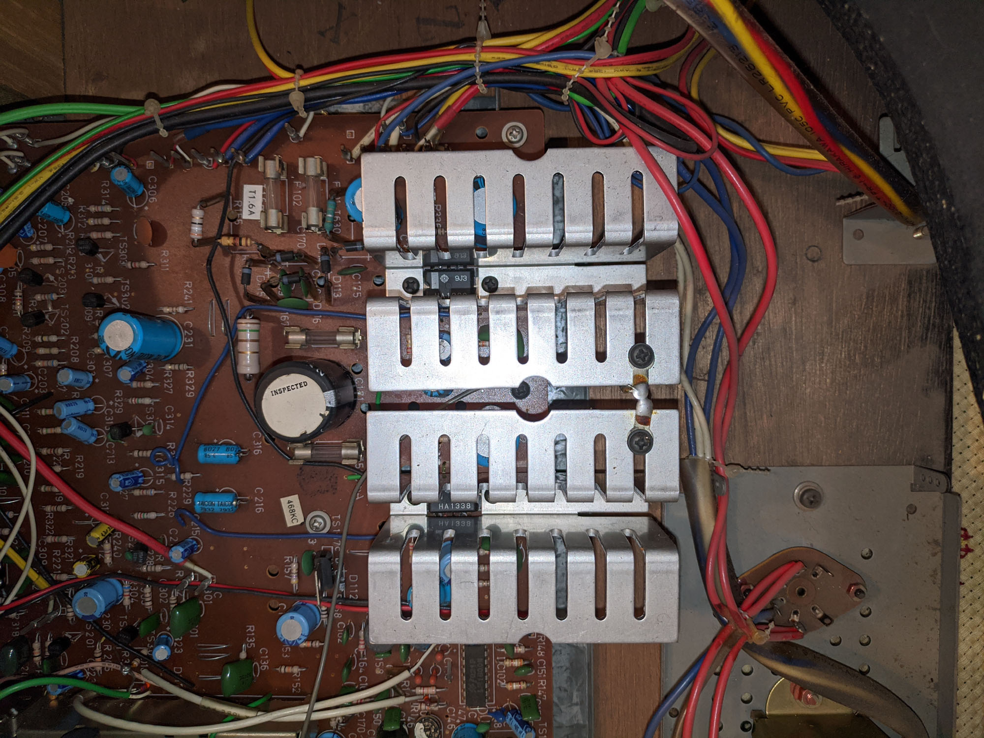

            I attach some pics of the unreadable label and pics of the stereo cassette turntable receiver mainboard/amp board

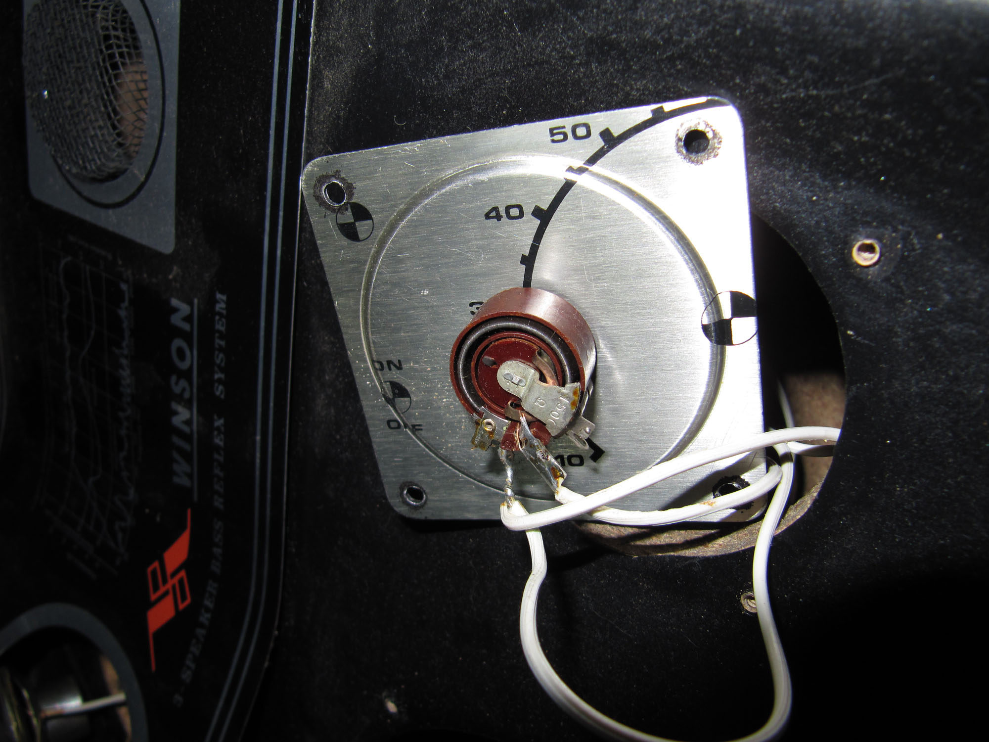

              You are totally right, it's highly possible that everything in the back label of the speakers is lies. Does it also include the impedance / distortion diagram on the front of the speakers?
              Yeap, I also noticed the weird markings on the backside of the metal of the rheostat.
              OH, how did I miss that? The caps should be bipolar/nonpolar... This is Stupid!
              I also noticed that there was no dumping material (but maybe it was not used back then) and that the bass reflex port has no tube, it's just a hole with grilles.

                They are cheap, low cost speakers, likely sold for $49.95 back then, If they had everything you think they should, they would have been $349.00.
                They are perfectly fine for the amp that is driving them. The whole system including stand was low cost, and did it's job and didn't cost $1000.00, likely under $200.00 including the stand.
                The markings on the metal were likely silkscreened for something else and the metal was just re used and there was no need to clean off the original markings, again saving cost.

                  From pics of the board, audio amplifier IC HA1338 is rated 6W at 24VDC power and 8R load. So the power level is not enough for a party Grandma need to dance
                  For modifications I would add a low cost Bluetooth module or stuff in an LM3886 amplifier board. There's lots of room under the turntable. The power transformer looks strong.

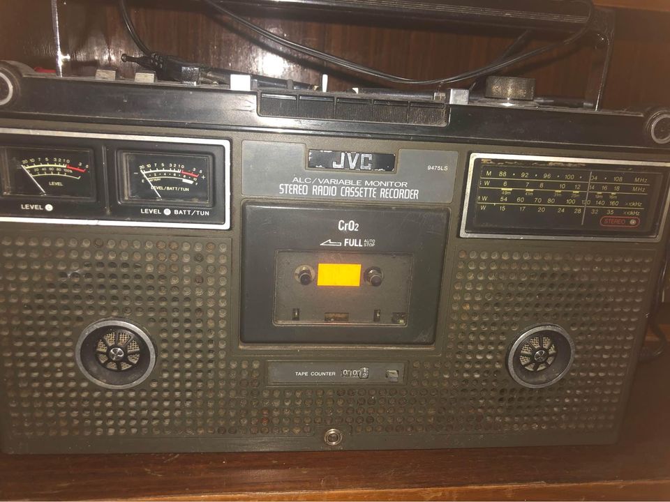

                    List of things missing from that sound system:
                    1)Most annoying : An aux input
                    2) Vu meters. I have a soft spot for VU meters, since I was a child. Too bad this thing doesn't have ones...
                    I had a boombox from my cousin that had vu meters, used to watch them move and feel so nice, his family threw it away, couldn't save it. Tried to buy used but the prices are crazy high...
                    This is it:
                    https://www.badcaps.net/forum/attach...1&d=1642362061
                    the boombox I grew up with when I visited my other grandparents on weekends
                    3) More power. Seriously, when I opened datasheet, I though I had mispelled the IC codenames. 6W per channel is too low even for those days standards.. Need to pair this with very efficient speakers to be able to output some juice.
                    4) Bigger transformer. I think the pics are deceiving, it is not very big, I have some mini hifi systems from late 90s that have much bigger transformers.
                    5) Better turntable mechanism. If my online research is correct, Philips chose to use a cheap plastic BSR mechanism, any input on this?

                      It depends on what you want to keep vintage. It's in a nice stand. For all the room it takes up, why not have it be able to play mp3 from bluetooth? Or just add a box outside if the unit has AUX or TAPE IN at the back RCA connectors.
                      The cassette problems are almost always a dirty rec/play switch. Very hard to clean them because they are so long.
                          My brother-in-law has a similar "rack" system he got back from his parents's apartment when they moved. He said they had this system since the 80's or so. Philips, as well.. and with the matching speakers. I ghetto-fixed the rotten foam on the speakers this summer, since he didn't want them, but wanted to keep the system and connect it to their TV's soundbar.
                          While these "rack" systems were kind of cheap and certainly nowhere near a marvel of Hi-Fi (or even good lo-fi for that matter), they do look really nice. So I'd say these are worth restoring just for the looks/radio, if nothing else (though I'm sure spending a bit more time with it can restore the other functions too.)

                              Oh man, that's such a shame that boombox went to waste. Those are really hard to come by anymore.
                              And yeah, I also like watching the VU meters. But I also like my dad's Sony gear (tape deck and TA-F70 amp), which had beautiful LED level bars. Watching those lite up and off as a kid is pretty much how I always listened to music.
                              They are really stupid, I try not to think about it because I feel guilty I didn't save it.

                              Give the current speakers a listen. They might have decent efficiency. By the looks of the motor, they have a really shallow magnet and probably 0.75" VC... so they should still be able to make plenty of noise.
                              Already done. Unfortunately the paper is badly torn on the mid frequency woofer and the other speaker that has no visible damage on its woofers also sounds like something went bad.
                              I wont spend any time on those fake speakers. I will revisit thread and let everyone know when I have news about the Philips system though
                                Interesting.
                                Maybe the magnets are starting to rust from the inside out, like with these Panasonic Thrusters speakers? In the case of the Thrusters (what a funny name ), I didn't waste too much time trying anything with them - just saved the magnets from the drivers, the bipolar caps, and the tweeters. The rest went to the bin/trash.
