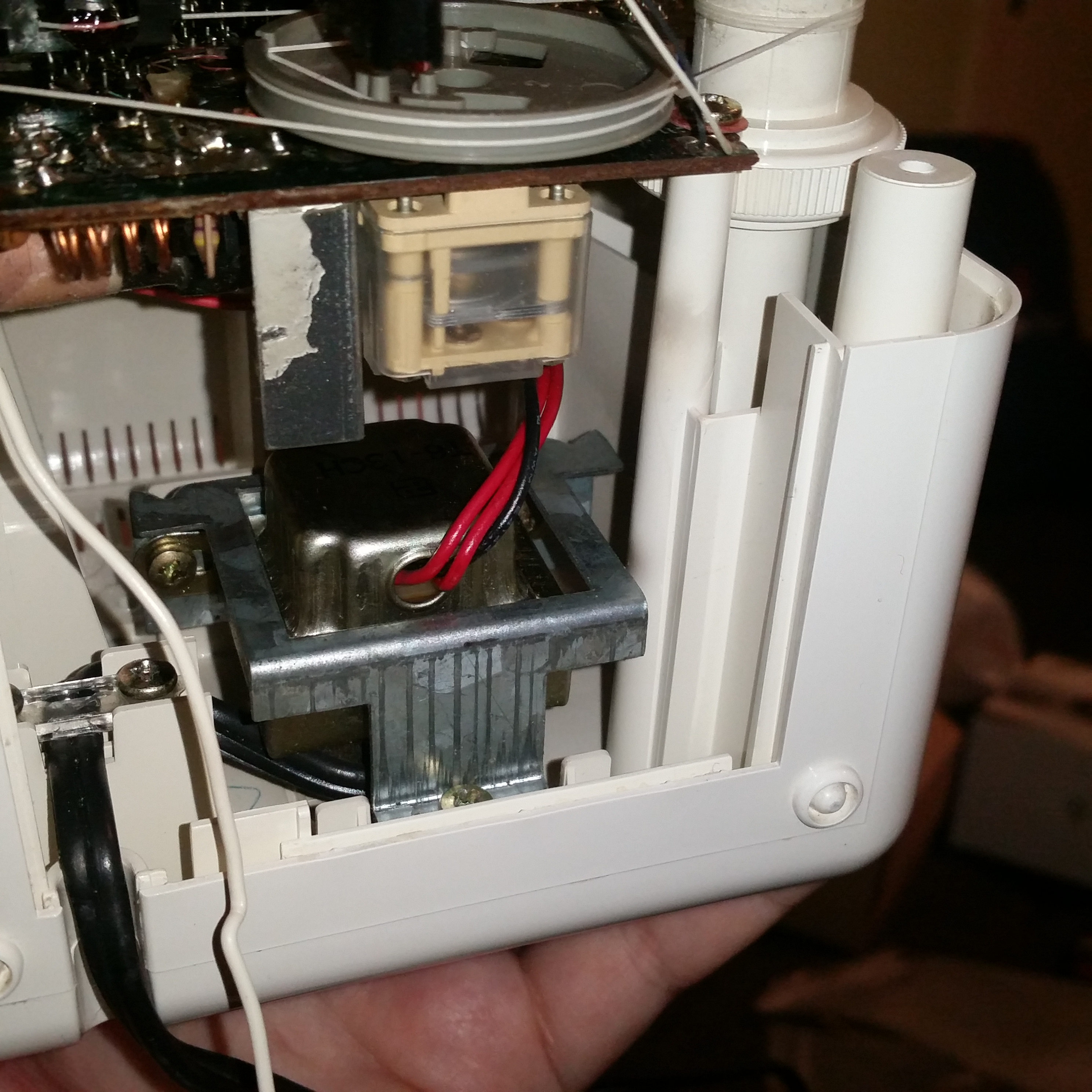

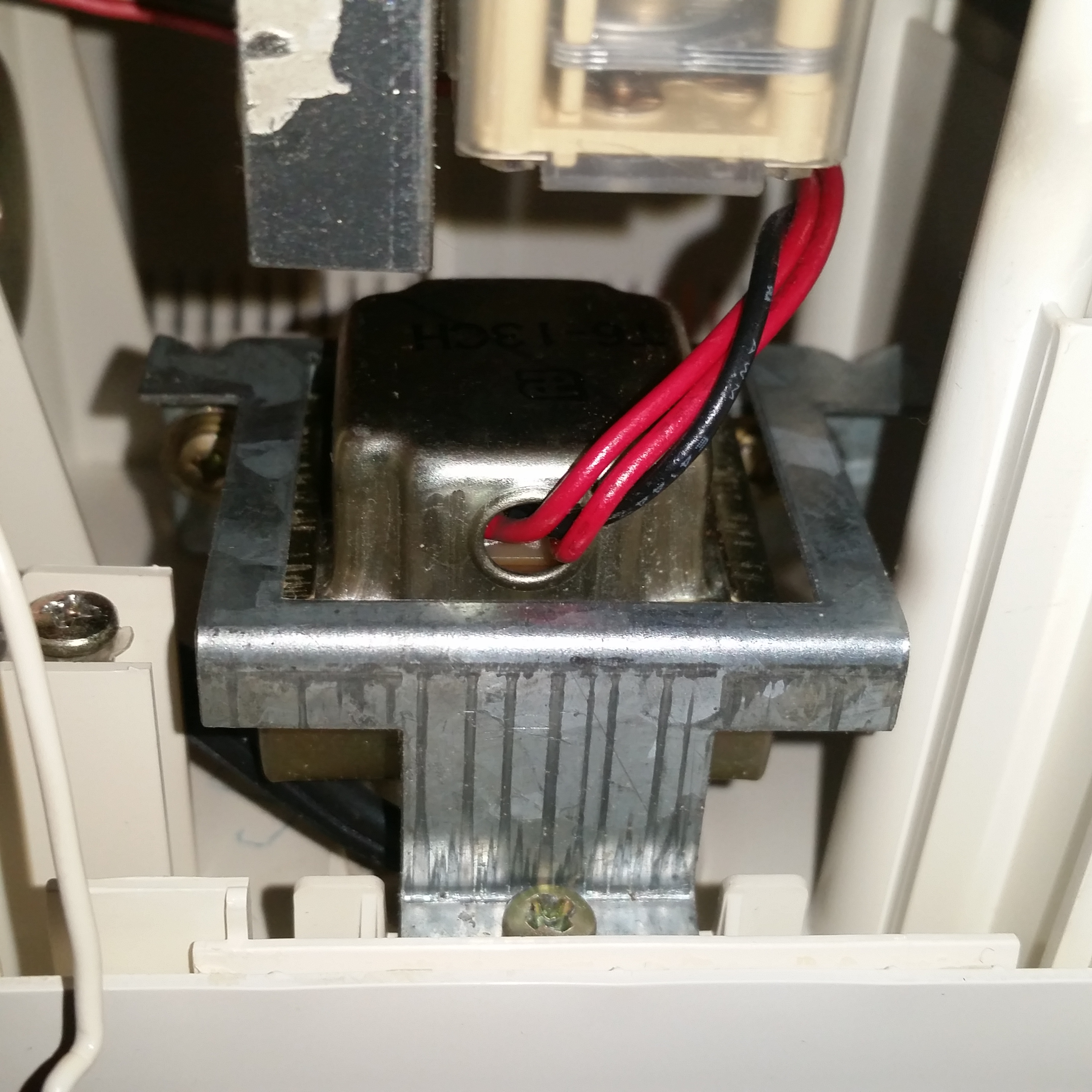

OK, that sounds great. I didn't observe any overheating or bad voltages. I checked the line that powers the OKI chip, the voltage is about the same or slightly lower than it was with the original power transformer which was run on a 220 to 110 volts power converter. The clock is operational, it shows quite an aqurate time, the radio sounds clear, no crackling, buzzing, humming or any other unwanted noise, the reception is great, so it seems it will work OK.
I also measured some of the filtering capacitors in there. The biggest filtering cap is Elna 16V1000uF, others seem to be Lelon or something like that, the letters are too tiny for me to see. But they all measure within their ratings, even after 40 years of age.
I wish I could see a modern device today lasting up to 40 years with no required service. In the past, things were built to last. Now they seem to have a planned obsolescence with a built in expiry date.
Thank you, guys, for helping me fix another piece of great equipment, this old-timer digital clock radio from Sony. Cheers!
Leave a comment:
