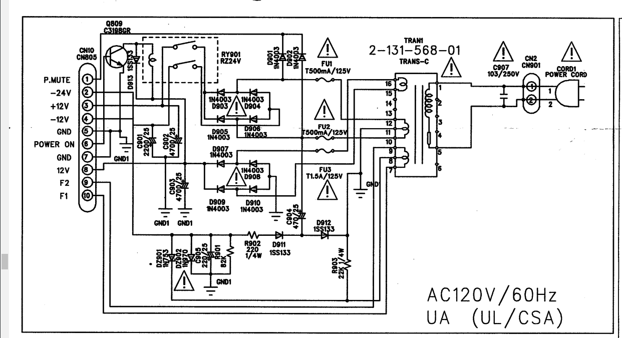

    Hi there!
    Im trying to service an old Harman&Kardon tape deck (TD470) player, which after being put away for many years, is now lacking sound randomly (first time I tried it worked, called the owner and said it wasn't working for him, tried again myself and sound was gone)
    This intermitent issue led to to go straight to the PS & Caps...I found at least one voltage missing (sorry now I can't remember which one), and one of the 3 fuses in the PS was open (this is strange as an intermitent failure wouldn't relate to a blown fuse).
    First thing I suspected was the capacitors but they all seem in very good condition. Then I found the schematic and Im having trouble to understand some parts of it, specially the -24v section (lower part of the schematic), and the p.mute in which Im totally lost on what it does and where it takes power from....
    Can you help me understand how these 2 sections work?
    Also why do f1 and f2 carry alternating current directly to the electronics?. What's their function? That transformer output puts out 5v ac.

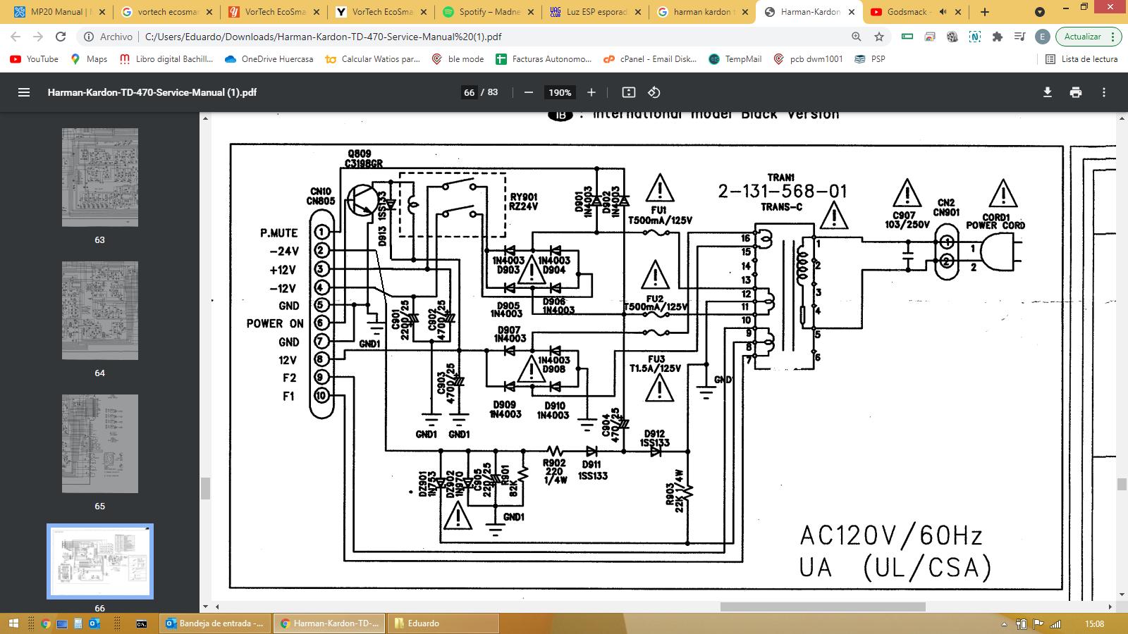

    Im attaching the original schematic and also another one modified by me which is how I believe it should be, as there are non-clear crossings/connections that lead me to error
    Thanks in advance!

    Also, this is the link to the original's full service manual. LINK

      Re: Help me understand this schematic (tape deck PS)
      F1&2 are for driving a display heater.
      P-Mute is 50Hz pulses timed to match the mains.
      it may be used to time the powering of the speakers to avoid the "POP" sound.
      if P-Mute is missing it wont turn the outputs on.
          The -24 volt circuit: C904 couples the AC from FU2 to the diodes D911,D912. D911 rectifies the ac and provides negative dc to C905 (R902 is just a dropping resistor). ZD902 clams the voltage to a negative 24v.
          ZD902 provides a small bias voltage to the filament circuit to raise them above ground ( prevents ghosting)

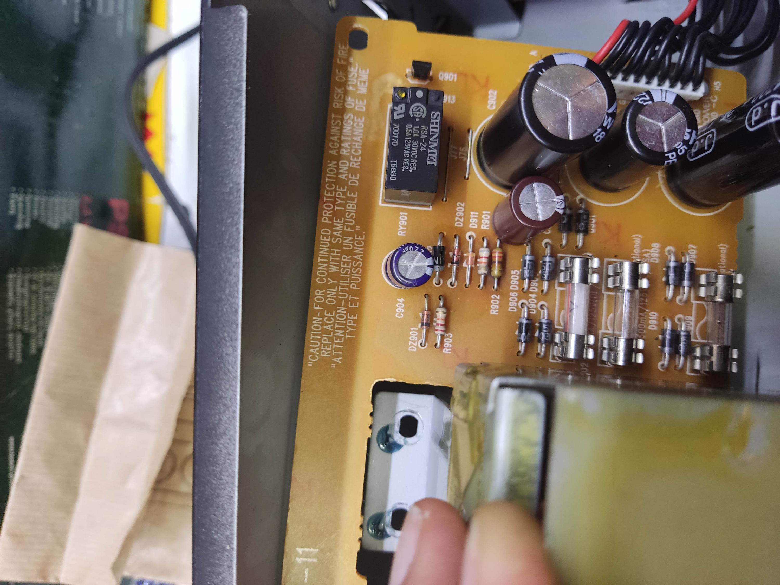

              Mmmm weird thing, I just replaced all electrolityc caps on the PS, and no good
              Voltages measured at PS outputs:
              F1 and F2 -> ...AC
              12v -> 20v (too much, right?), But there's no regulation on board...
              POWER -> 0.18v...seems to little to switch the transistor on, but the relay is ON
              -12v -> -17v
              +12v ->17v
              -24v -> -21v
              P.Mute-> 12v
              I've checked the relay contacts and they seem to be fine. Continuity always from COM to NC side when power OFF, and continuity from COM to NO as soon as power is turned on until 2 seconds after it's powered off
              -24v is a little low, while all other PS's are way high...Should I check zenners? Board was a little darkened near R902...see attached.
              Oh wait, now that I see the photo... is DZ902 broken inside? Or is that normal?
              Any help would be appreciated!!

                Since there's no regulation, these are probably expected voltages, though -24 's absolute value is a little low...
                However you have a fairly high offset across the board, what are you using as your ground point? You're right, that transistor and hence relay should NOT be on with that few volts, you should check your measurements or perhaps that transistor is burned on (or .. hah .. dummy transistor like in the caterpillar ECU thread... LOL!)
                Are these the voltages when the deck is not working since you mentioned it was intermittent? These voltages seen should be acceptable to get at least some sound out of the machine I'd think.
