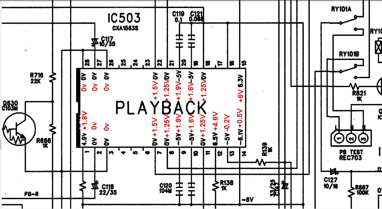

                  Ok I just tested all voltages to IC503 (playback chip) taking advantage that the schematic lists all the expected voltages, and 95% of the voltages, not only -6v, are missing or completly off.
                  Even some expected 0v are not even 0v
                  See atached file where I wrote down measured, in red, voltages on my unit while it was playing
                  Still checked that main voltages on PS board are still present and ok so I don't know what makes all secondary supply voltages (-5v, 6.5v, -5.1, etc) to be bad
                  Thanks!

                    Also I just checked the main voltage regulators, Q506 for +8.3v and Q507 for -8.5v on their emitter lead
                    Also checked lm7805 regulator IC501 and getting 5.0v
                    Then checked again Q118, which drives -8.5v into -6.1volts but this one reads 0v on both base and emitter, while his counterpart Q117 for +6.1 reads correct values.
                    This truly seems to narrow down to this stage. Either Q118 itself, the zenner diode (reading now 0v across, but expected if Q is shorted) and maybe capacitors C139&C141, right?
                    • petehall347
                      • Jan 2015
                      • 4440
                      • United Kingdom
                      #30
                      Re: Help me understand this schematic Harman&Kardon tape deck (TD470)
                      check zener first

                        With the -6v Vee ALL the other voltages on ic503 will be off, that is to be expected. Check the Zener diode in diode mode on you meter. If you have 0 volts on the base of Q118, either the zener diode is shorted or R145 is open circuit. C139 could be shorted but it is unlikely. Maybe it is just a poor connection around Q118 or it's components. (it was intermittent)

                          Ok, end of this project. I fixed it!!
                          I started by removing the zenner, tested out of the board and showing no shortcut. Shortcut still present at board. Removed the capacitor. Measured 5 ohm on each direction, shortcut not present anymore on the board. Swapped that capacitor with just one that I had handy with higher specs, zenner back to board, wires back in place and tadaaaaaa the tape is back to life.
                          I truly truly appreciate all you guys helping me on this project. I make no money with this, just helping a friend who insisted in keeping this "almost oldie" tape deck, he is an enthusiast of old school music, he still plays vynil records and tapes, so I wanted to do my best for him and his "challenge", which I did thanks to you all who provided help here.
                          THANK YOU ALL!!
