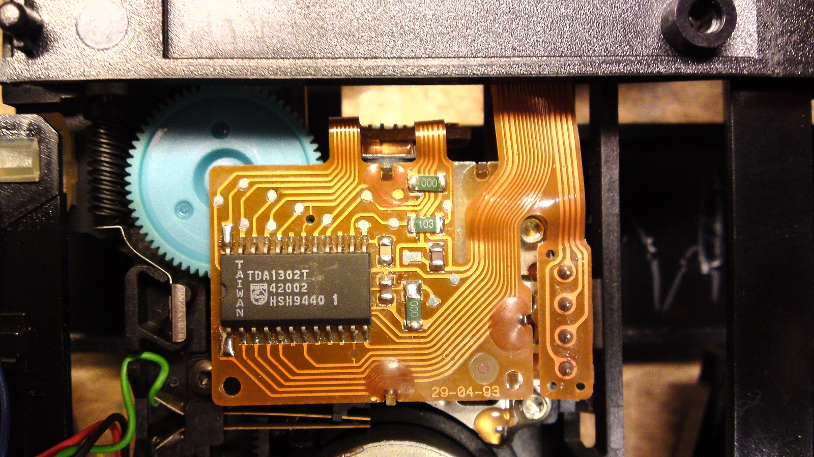

    I was doing a ordinary change of a laser unit and mechanism on a Micromega stage CD-player. The laser unit is a Philips CDM12.4.
    After laser change, player refuse to play one single cd. Here is what happens:
    Tray closes. Laser succeeds focusing. Cd starts to spin, though way too fast,
    3 seconds later display shows "ERR".
    If closing tray without having a cd in, the display show "No disc" which means the laser can focus correctly and actually works, right?
    The CDM12.4 laser has an onboard RF amp, as can be seen in the picture.
    Before the laserchange the player actually worked, but had reading problems.
    Any advice is appreciated.

    disk spinning out of control is an unreadable signal.
    you can get this if the bias or gain on the laser is wrong.
    another symptom is the disk moving in small bursts & the laser lens clicking.

      There are no adjustments for gain or bias, only laser power which is set as the old pickup.
      The cd spins up maximum speed for 3-4 seconds, drops to near zero, and repeats again.
      I wonder what I can do to make it work..

        scope the eye & look at the pot on the laser assembly.

            You mean scoping the RF amp data output, and watch for the "eye" pattern?
            What do you mean by "looking at the pot"?
            Didn't check for PSU ripple, but all +5VDC was nice and stable.

                      The laser gives a decent 1V peak-peak RF signal measured right at the RF amp output. The "eye pattern" is visible but not that clear. If memory serves me right the eye pattern should be pretty sharp and clear. So could this mean the new laser is actually bad?

                                  I tried to attach four new CDM12,4. And always result one - ERROR. The eye moves as well as it is necessary by search, and the beam is not present, where that it vanishes. Where?

                                    Could you please take a picture of the whole player ( without cover ) ?
                                    I might have an idea, but I am not sure it is the correct player I am remembering.

                                      the eye pattern must be more that visible, it must be correct - it should look like perfect equal diamonds.

                                        Check the mainboard. Close to where the laser FFC attach, is there a TDA1300T ?
                                        If yes, change it.
