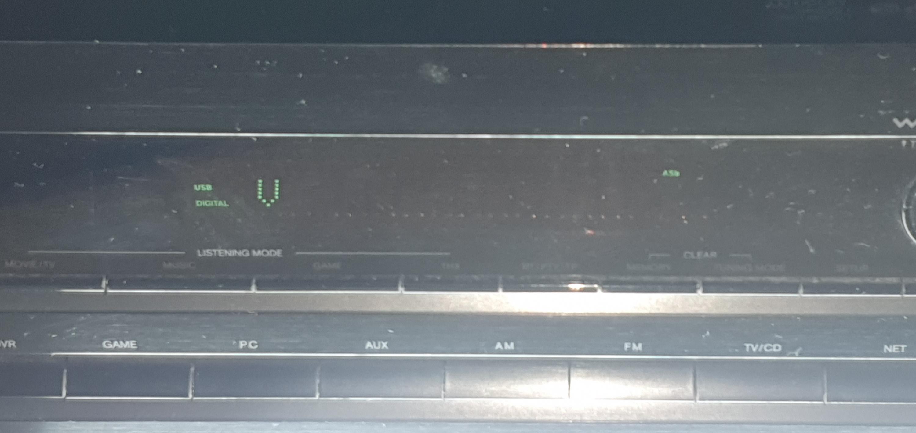

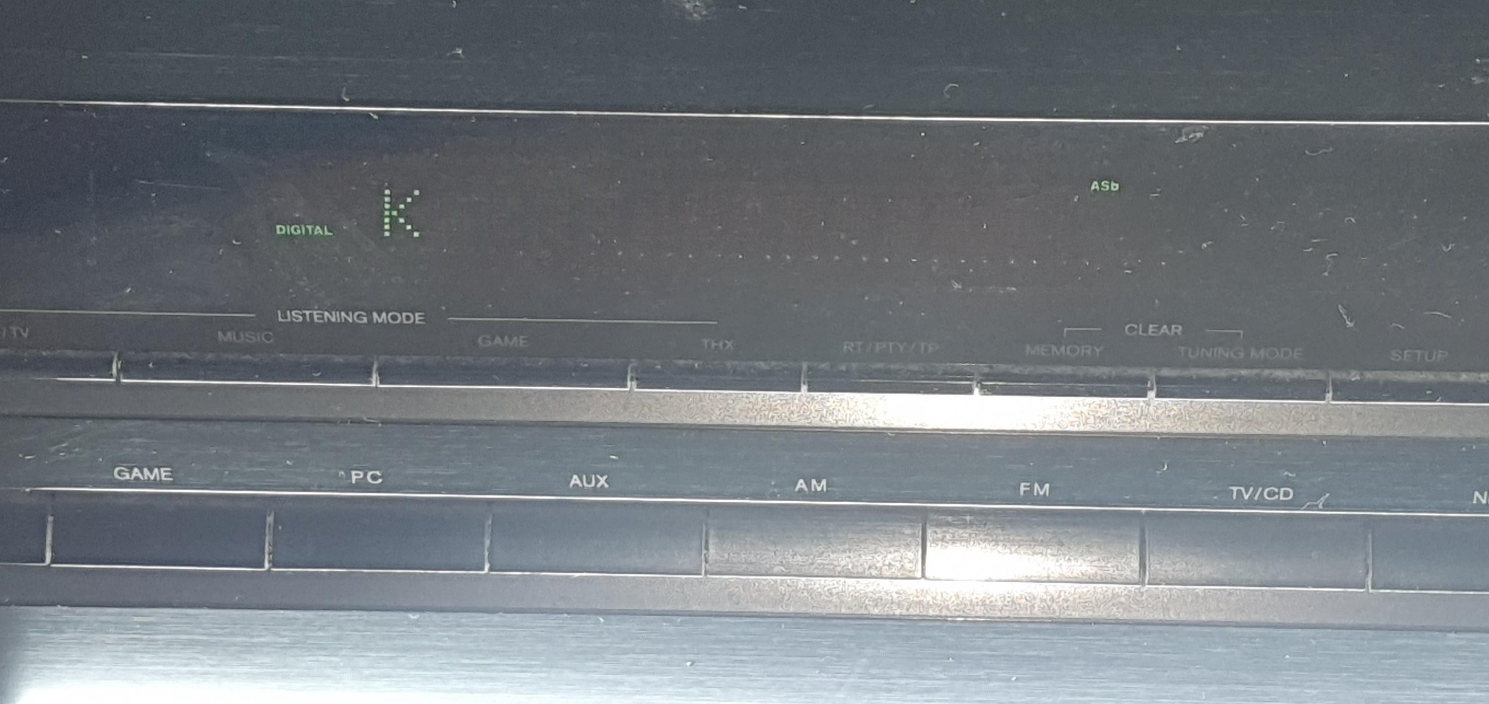

    This is what i get when i check the firmware
    any help appreciated please
    I have tried to do update by using the ethernet cable
    When i try to do them individually using the menu
    it gives the following error
    error!! 5-82
    on vsp and vmpu
    not tried by usb
    I have a a uart cable and a USB CH341A chip programmer
    Many Thanks all in advance
    Please help
