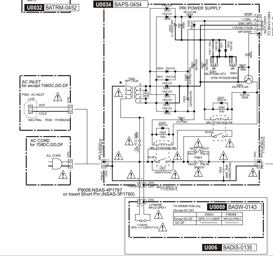

    My Onkyo TX-NR708 when plugged in the standby light turns on very briefly than goes out.
    I measured relative to GNDMPU
    1-MPOWER - 0.0002V
    2-+12VDG1+SUB - 11.7V
    3-GNDMPU
    4-+12RL - 0.318V
    5-/POFF - 10.49V
    I found that C922 was out of spec and replaced it with a used replacement but no change. I feel like +12RL should be driven by T902 always under normal operation. Is that correct?
    Re: Onkyo TX-NR708 standby light
    I've probed a bit more. There is 12.0V across C922 and 11.5V across C930, so it seems the transformer T902 and diodes are OK. I also find 12.0V on the other side of R922. I previously missed D926 that seems to block the voltage to +12RL. I'm not sure what +12RL is for but I guess it's not an output from the board.
      C930 was on the lower side of what it is rated, not much but I swapped it with one that measured closer to ideal. No change.

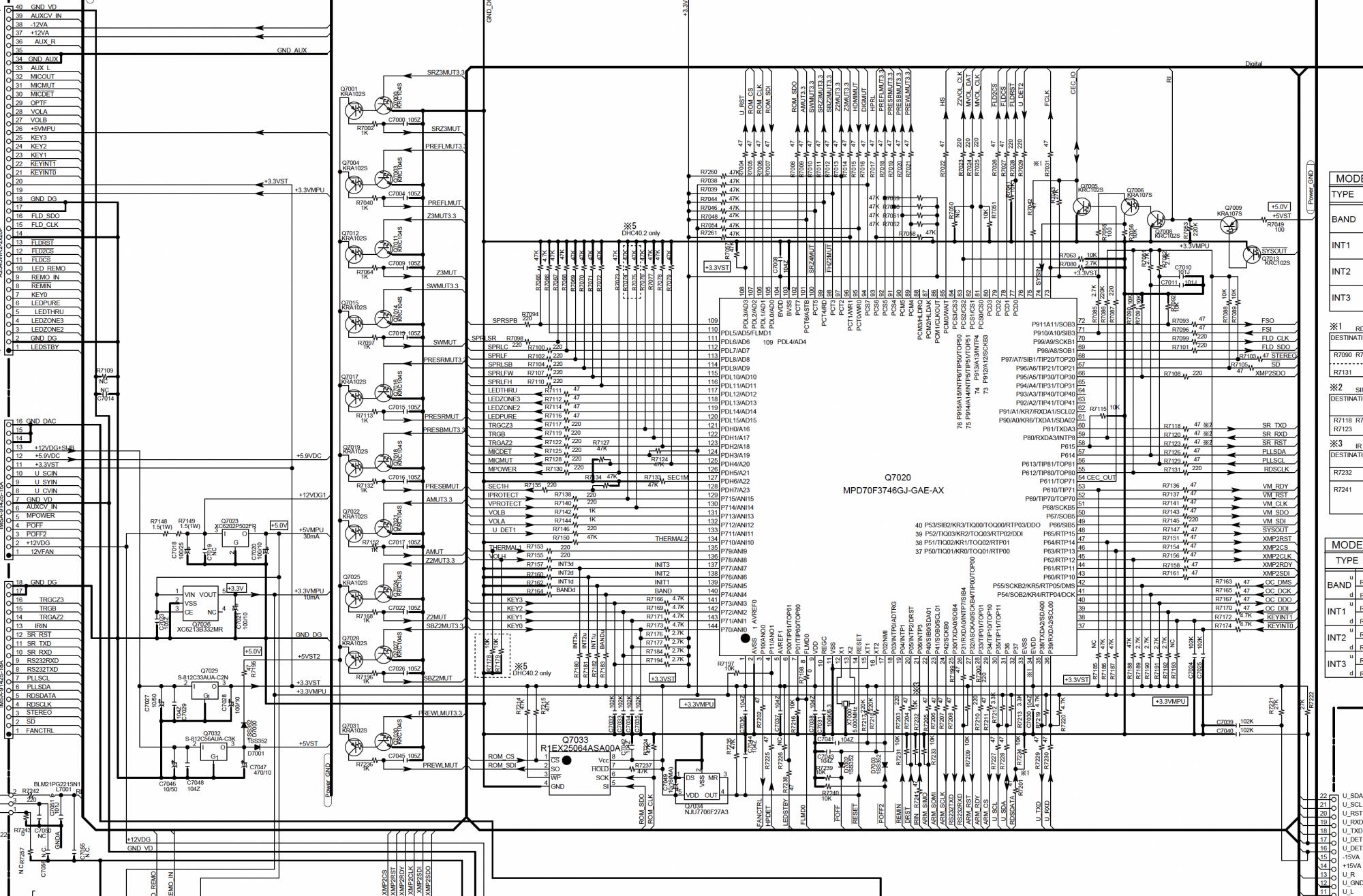

      +12VDG+SUB feeds two regulators Q7032 +5VST and Q7029 +3.3VST. I measured 5.6 across C7047 which seems high. C7028 measures 3.3 on the money.
      I'm not sure where to go from here. It would be nice to get some info from the Q7020 processor. I found 3 serial ports but they don't seem like they would have diagnostic information on them. This processor drives LEDSTBY.

          LEDSTBY is high for 18ms.

              Thanks. I can't do the reset as it requires the standby light to be on which this system does not get to. The relays are not being energized by the processor, only standby voltage is present but no standby light. I do have the service manual.
                  The service manual is here.
                  I believe I have verified the standby supply as well as the two regulators it feeds and they are good. Why do you say it's being pulled down? My thought is that the standby LED is controlled by the microprocessor and it is turning it off.
                      I have got this problem before on my TX-SR606 after I shorted something by accident. I fixed it by replacing a 3A fuse near the power transformer.
                      The +12RL should be about 12V all the time. Check fuses F2001 and F2000 to see if they are blown.

                        If it was the case that a short existed, wouldn't you expect to see Q7032 and/or Q7029 out of spec?
                        Thanks. I did check F2000 and F2001 and they are fine. Wouldn't you expect +12VRL to only be on when the main relay is on?
