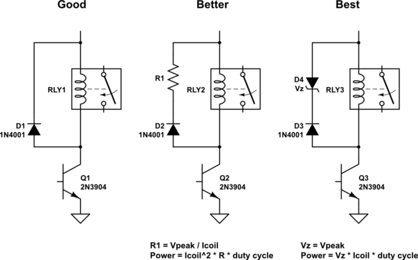

                        The zener circuit is a bit weird, I think to prevent mains sags from cutting out the relay. Nobody likes a sub cutting out when the bad guy explodes lol.
                        A diode is used to suppress a relay coil's back EMF, the -ve voltage spike due to coil inductance that will damage the driver transistor.
                        But in this circuit, the zener acts as an ordinary diode for coil back EMF, and in the reverse direction it regulates the relay coil's voltage to around 24VDC.
                        Actually a relay is not finicky about the voltage it gets, so a zener is not typically used there.
                        MTZJ24B is a 1/2W 24V zener, I would upsize to 24V 1W zener 1N4749A there, for long life. Your old zener is running over spec 0.6W and why it died.
                        Just a plain 1N4001 or better would work- assuming the relay coil gets around 22-26V. If you have high mains voltage, instead of 33V you have 35V so a bit extra the zener gets rid of. But the relay will just run a bit warmer and not be an issue.
                        A diode's peak and RMS voltage ratings - here it can see around 35V max. so a 1N4001 (50V) or better is fine. A 1N4148 is OK too because the coil current is around 25mA, the back EMF is also 25mA max.

                            The design is a 24V zener regulator for the relay coil when it is on, and a diode 0.7V for clamping the back-EMF. Not the usual circuit.
                            Zeners are used for a back-EMF clamp when you want fast relay switching. The coil's magnetic field collapses very slow with a diode at 0.7V compared to a high voltage (zener) clamp.
                              Re: DC detection circuit failure on Subwoofer
                              I do not think in this case the relay release time (speakers disconnected when error occur) is much of a factor.
                              The zener being used in this case will also clamp to 0.6V (compared to your figure 3 which is not the case), but when relay is energized, the zener will clamp the relay col Voltage to 24V, they may have done that because the 35V power supply is not regulated power supply so the if the incoming AC can go up and down.
