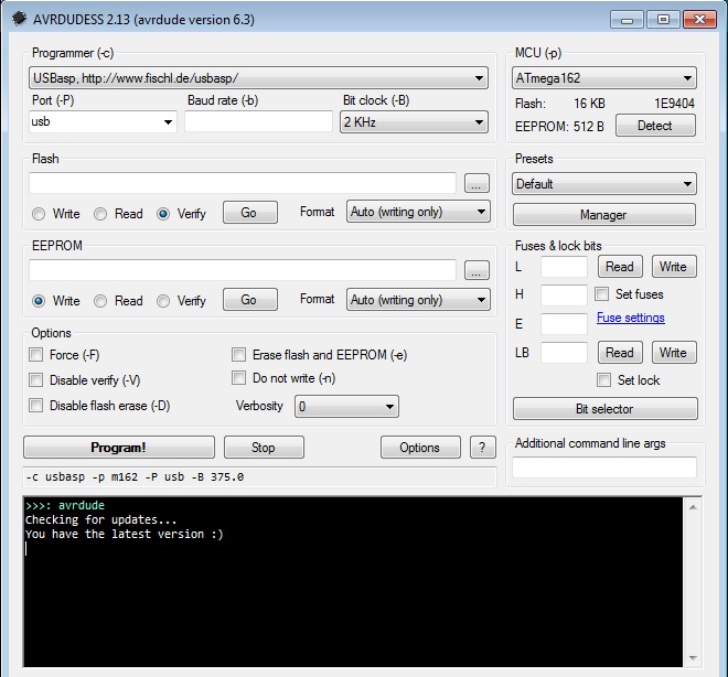

      where should i load the firmware?

          the firmware that posted Per Hansson
            • 31218
            #65
            Re: Numark NS6 Usb problem
            the chips are not the same.
            for a start your unit does not have an ST32 microcontroller or a DFU mode.
            or an XMOS chip.
            final problem, that's a 20k binary and you only have 16k flash space.

                      I finally managed to get the firmware through the Italian assistance, how should I proceed now?

                        this is the firmware
                          • 31218
                          #72
                          that is not the atmel firmware, it's for the main chip.
                          the atmel firmware will be a BIN or HEX file

                            and now how do you do it? what request should I make to numark, I think it will be a bit difficult to explain to him what I need, can you give me a precise indication?
                              • 31218
                              #74
                              if they actually know what they are doing then ask for the firmware for the atmel usb controller and include the page from the service manual with the chip reference.
                              better yet, include the page with a big red circle added around the chip!
