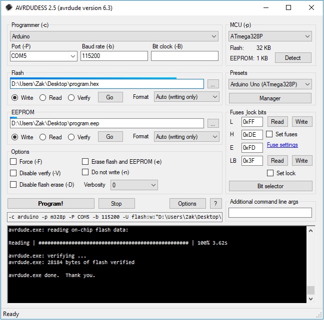

              I found this, it seems the same but without the use for the command prompt, just install it, sorry I'm looking for a shortcut but for the first time I use this programmer and I would like to make things easier
              https://blog.zakkemble.net/avrdudess-a-gui-for-avrdude/

                no, that's good.
                i'm a command-line / Linux type of person so i was hoping someone else would link dudess and the zadig driver installer

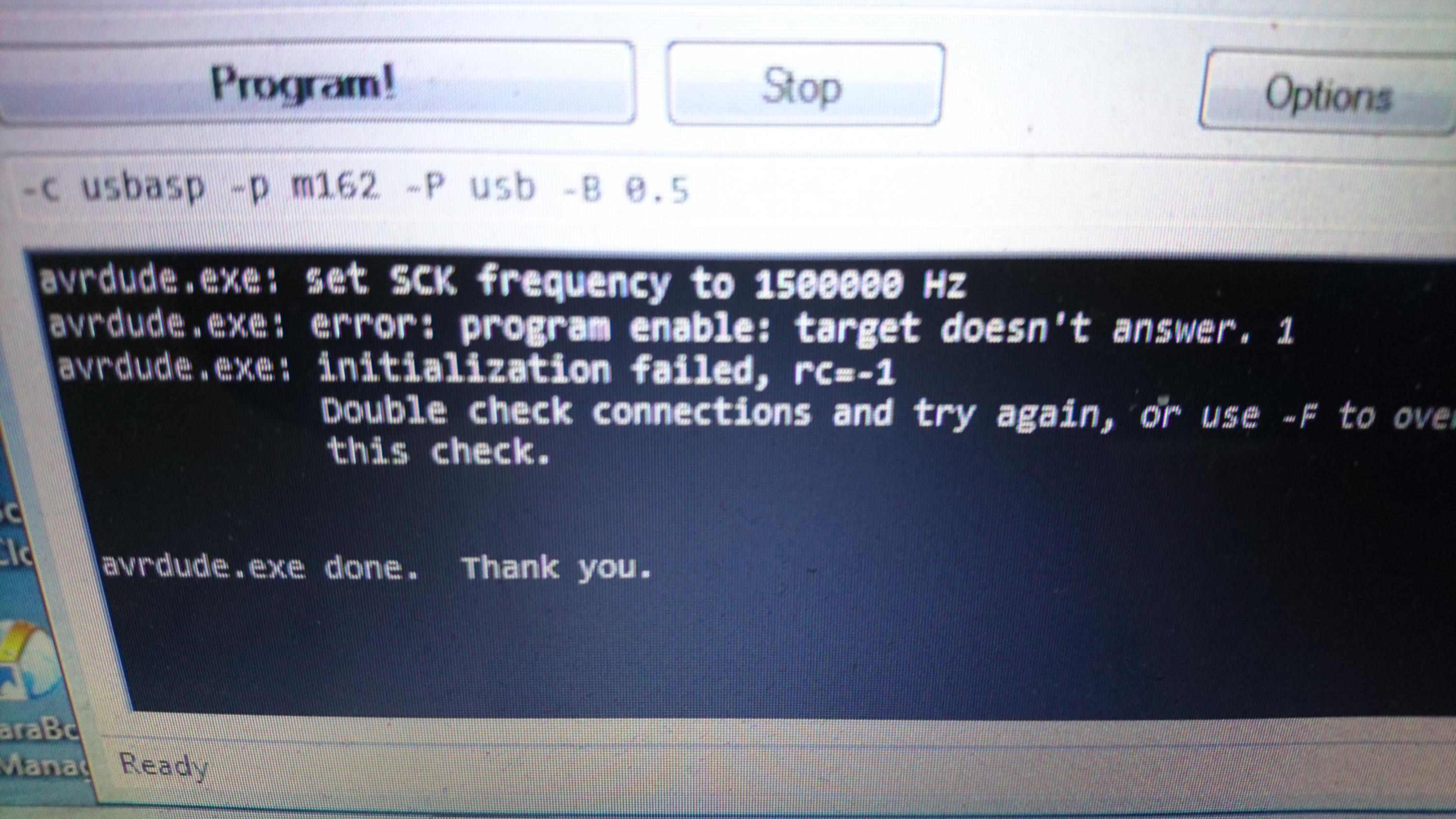

                        Based on the image, could you tell me what the settings are for doing the atmega162 function test?
                          • 31117
                          #32
                          Re: Numark NS6 Usb problem
                          you would set the "programmer" to usb-asp,
                          then select the "detect" button on the right i think.

                                This is the error message when I try to test the chip, but from the same message even without a cable connected, I tried powering the card and without power if someone could tell me where I am wrong I will be grateful to him, or simply the chip is dead and there is no response
                                  • 31117
                                  #36
                                  i think the chip is dead.
                                  i'll try it myself later without a chip to compare error messages
                                          confirmed,
                                          that message is what you get if it cant see the chip / the chip is not responding
