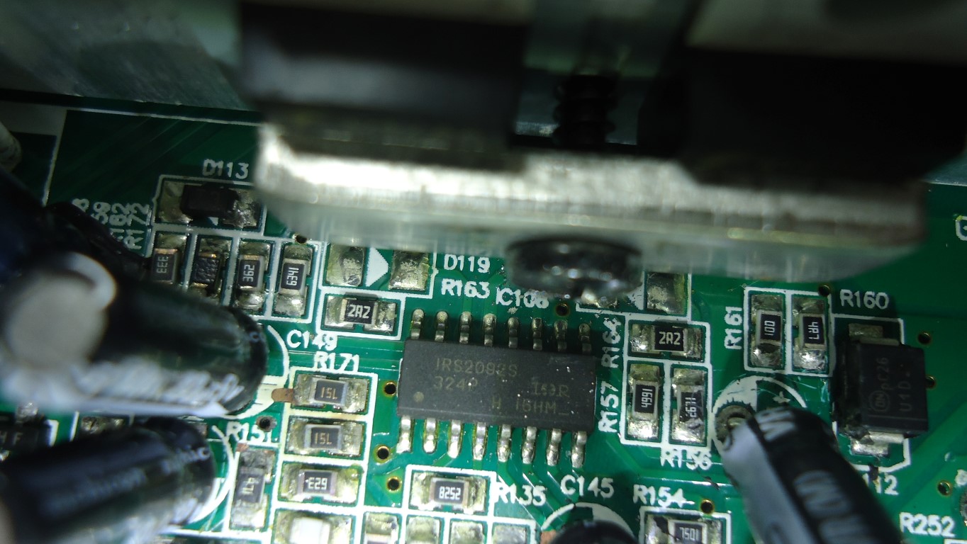

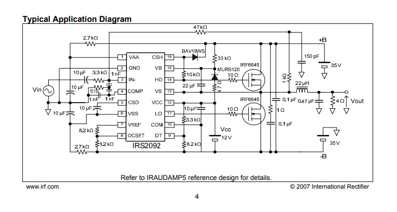

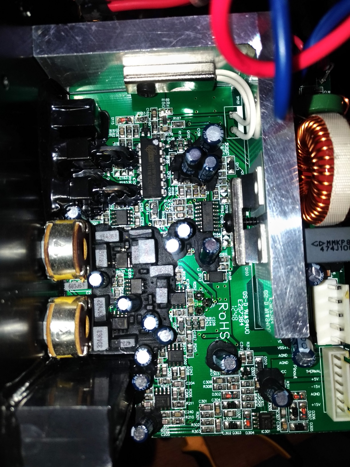

      Re: Monitor Audio BXW10
      Dear
      Also I could not locate the service manual, Monitor Audio is difficult.
      Follows output class D sub.
      It uses IRS2092 (IC108). Check that the Q102 and Q102 fets are good.
      The IC109 is a microcontroller, which makes the protect and standby
      Without the fets the circuit works and can measure the voltages. After a while comes protection.
      • amaral
        • Feb 2019
        • 2
        • Brasil
        The IRS2092S from my SUB was also damaged.
        To test the entire preamp part, remove the IRS209 and the FETs, enter a signal on the LINE INPUT and turn on the SUB. Check with the oscilloscope if the signal is present on the R150 which is the IRS input. Do not forget to increase the volume in the POT.
        After exchanging the FETs and the IRS in mine, everything was fine.

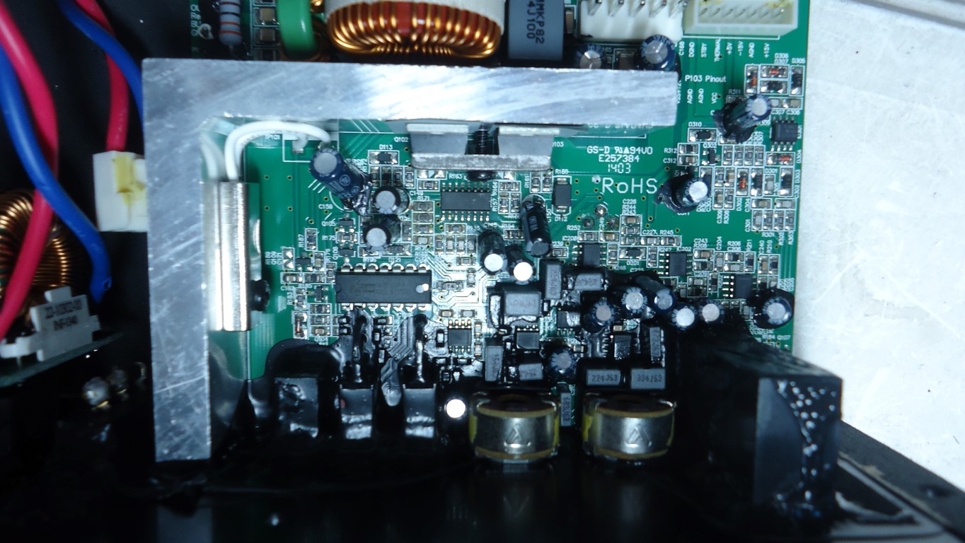

          • shoomax
            • May 2019
            • 2
            • Russia
            Originally posted by MattM
            ~ ~ = approx. 5 M ohm
            - + = 134 K ohm
            Leftmost switching transistor:
            pin 1 + pin 2 = 2.0 M ohm
            pin 2 + pin 3 = 400 k ohm
            pin 1 + pin 3 = 2.0 M ohm
            Right switching transistor:
            pin 1 + pin 2 = 02.5 ohm
            pin 2 + pin 3 = 0.005 ohm
            pin 1 + pin 3 = 02.45 ohm
            I am struggling to locate U209 please can you give me a pointer.
            Thanks once again
            U209 - the name is erased, but it looks like ISL6744A. P18n50C and 1500x80v capacitor were punched. After replacement also does not start. Service manuals in Russia is also not.

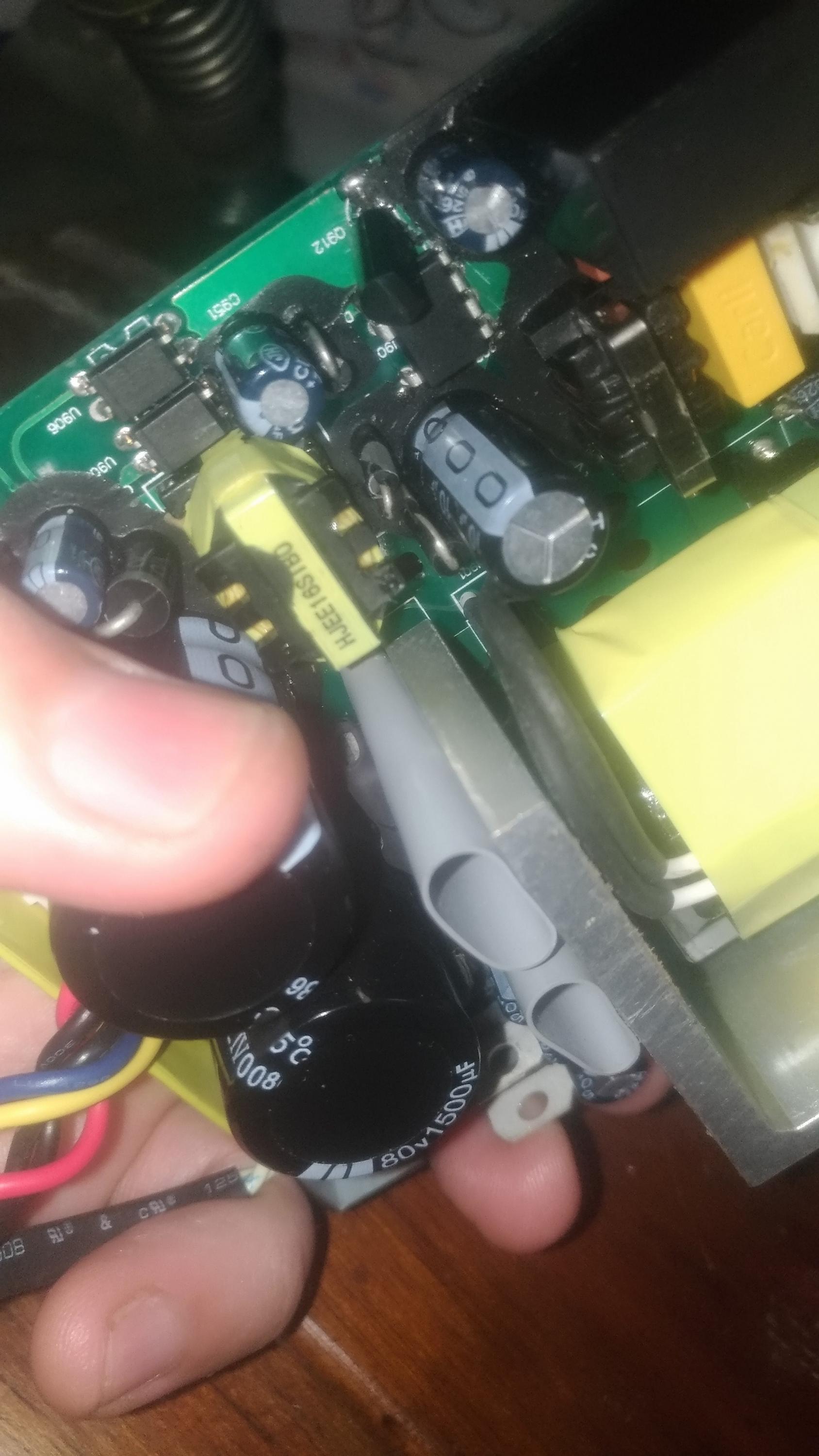

            • shoomax
              • May 2019
              • 2
              • Russia
              P18n50C I ordered for aliexpress I suspect that the Chinese have sent bad ones. The rest of the details around the P18n50C seem to be working. I tend to install an additional power supply. It is more expensive to buy an audio monitor from a monitor than to buy a new BXW-10

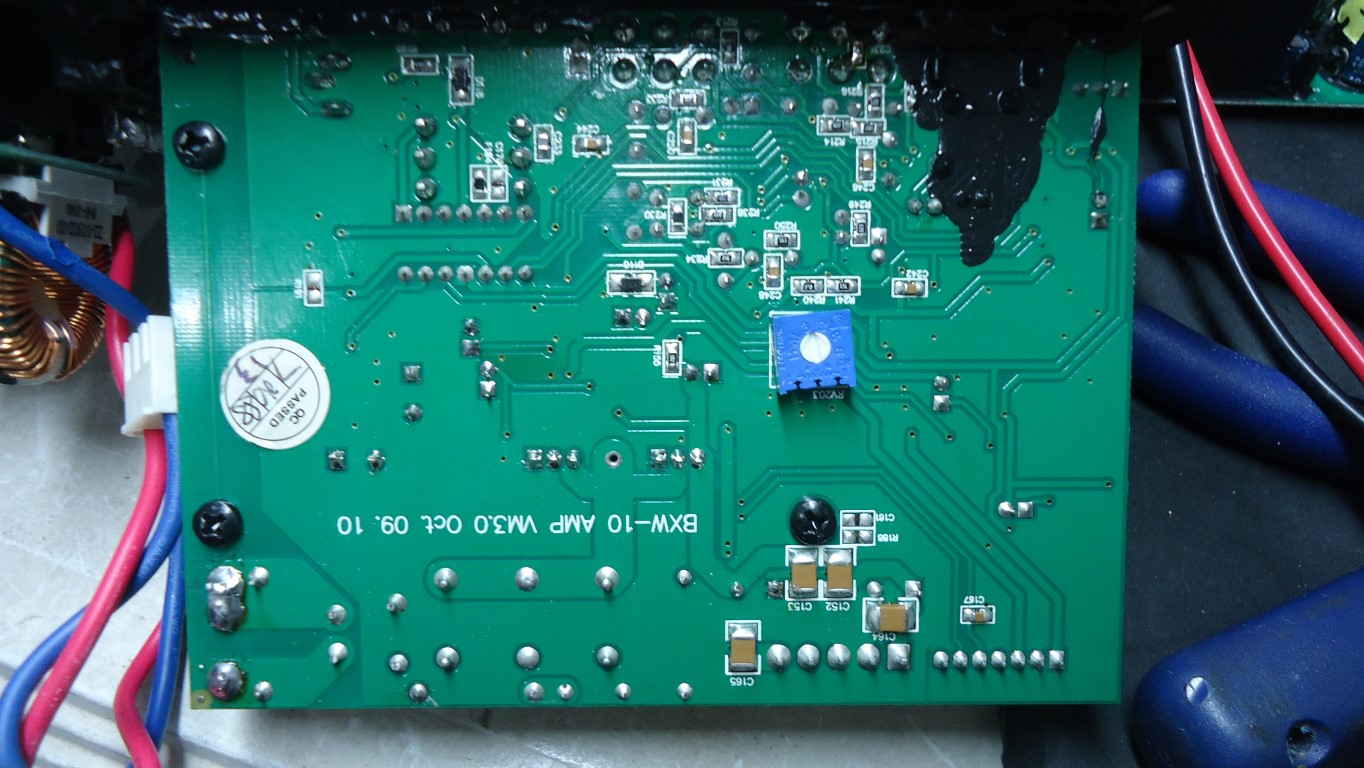

              • makidoja
                • Sep 2016
                • United Kingdom
                Hi all, I have BXW10 that powers up, red light on back but there is no operation .. I've taken the amp / psu board out and can see a small electrolytic cap with diode next to it and a small 4 pin device in front, the cap has some blackening along with the board which looks to have come from a failure of the 4 leg device .. does anyone have a circuit diagram or know what the device is? Should i replace the electrolytics, 4 leg devices diodes and the big smoothing caps and see what happens?
                Anyone know what the voltages on the cable colours sulks be?
                Mak
                  Could you post a picture of the affected area / parts. Without the part designators mentioned and no pictures, it's hard to determine which part of your circuit is faulty and what needs checking.

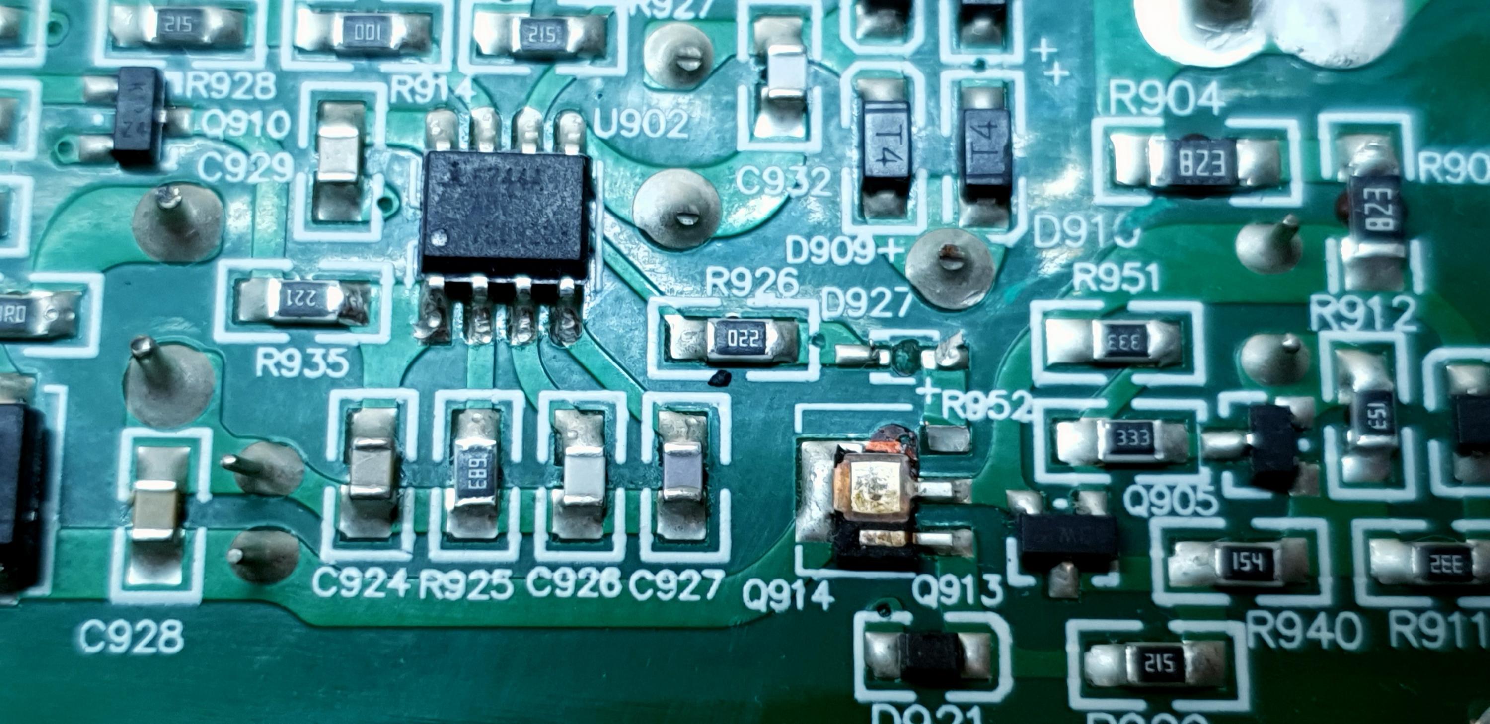

                  • Wussman
                    • May 2015
                    • 2
                    • Romania

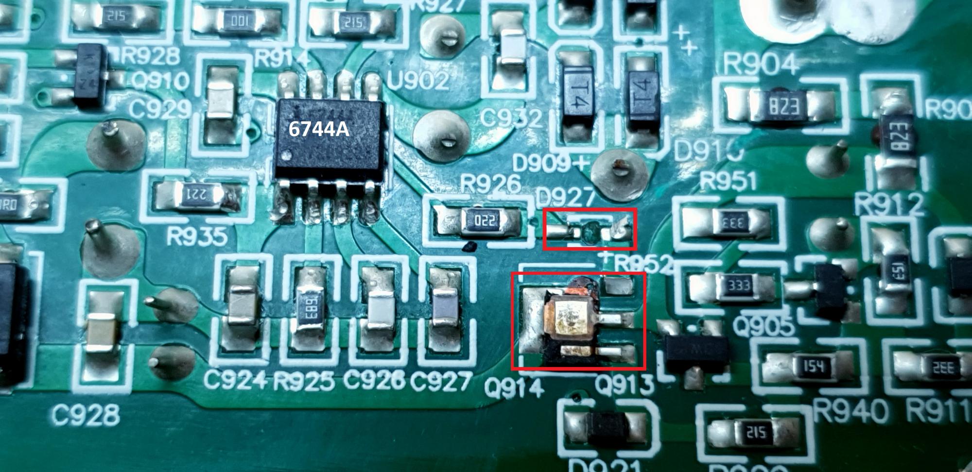

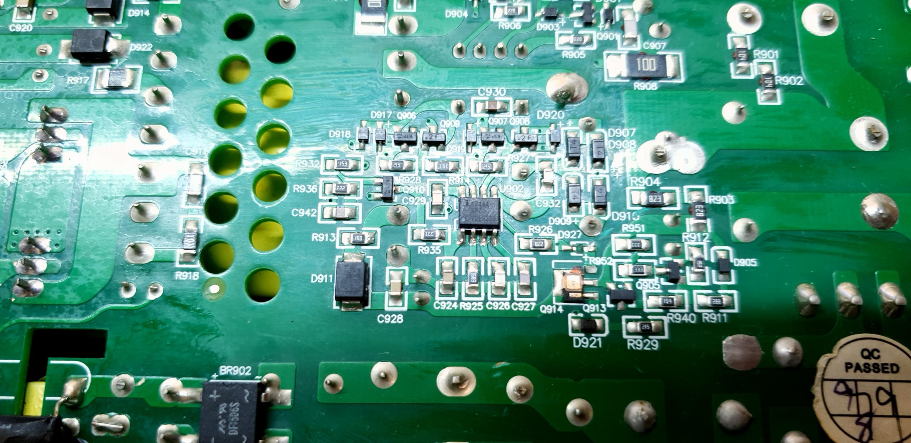

                    #29
                    Hello everyone!
                    I have a problem with my BXW-10 psu, two components on the backside of the pcb, Q914 and D927, are missing.
                    Could someone please, tell me the part number of those two components?
                    Thank you!
                    • dobrykamil
                      • Jun 2013
                      • 62
                      #30
                      Originally posted by wussman
                      hello everyone!
                      I have a problem with my bxw-10 psu, two components on the backside of the pcb, q914 and d927, are missing.
                      Thank you!
                      Q914 - bcx56-16
                      D927 - bas321
                      • Wussman
                        • May 2015
                        • 2
                        • Romania
                        #31
                        Originally posted by dobrykamil
                        Q914 - bcx56-16
                        D927 - bas321
                        Hello, thank you very much!
                        • Hemds
                          • Mar 2021
                          • Brazil
                          #32

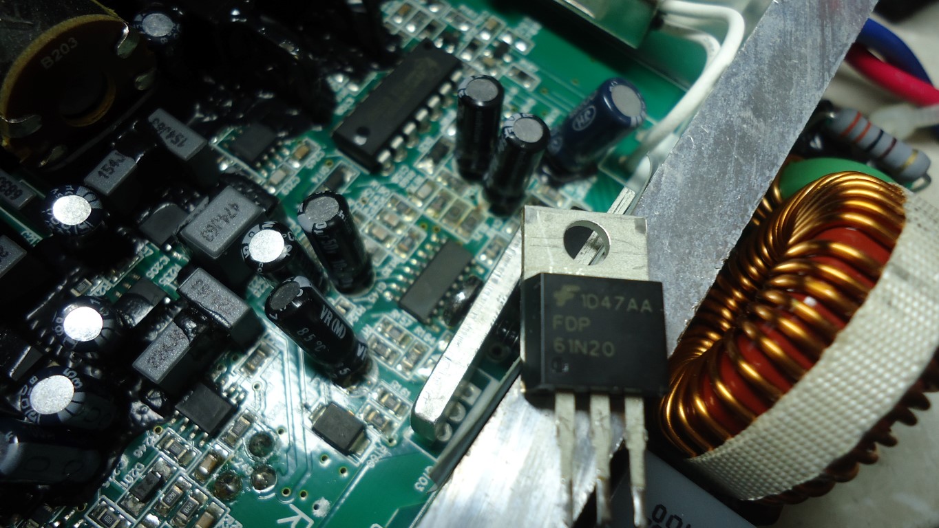

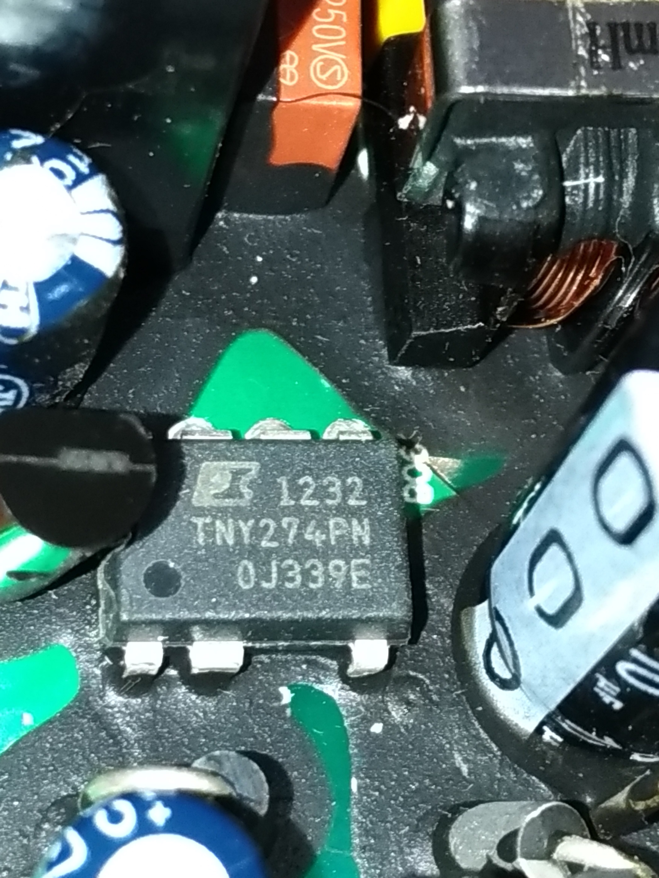

                          Hey there,
                          I also got my BXW10 damaged. As I couldn't find the schemematics, I started to look into forums in order to find out any help.
                          So, at first, the sub was completely dead. After some initial research, I decided replace a voltage supressor and the switcher to solve it
                          - 1 P6KE200A
                          - 1 TNY274PN
                          After that it, when I tried to power it on, the power led blinked sometimes and goes to red. No sound at that time. It seems like a protection prevention, or something like that.
                          Then, I replaced the output IC and its FETs
                          - 1 IRS2092 (IC108)
                          - 2 FDP61N20 (Q102 and Q103)
                          Now everything works fine.
                          I hope it can help someone.
