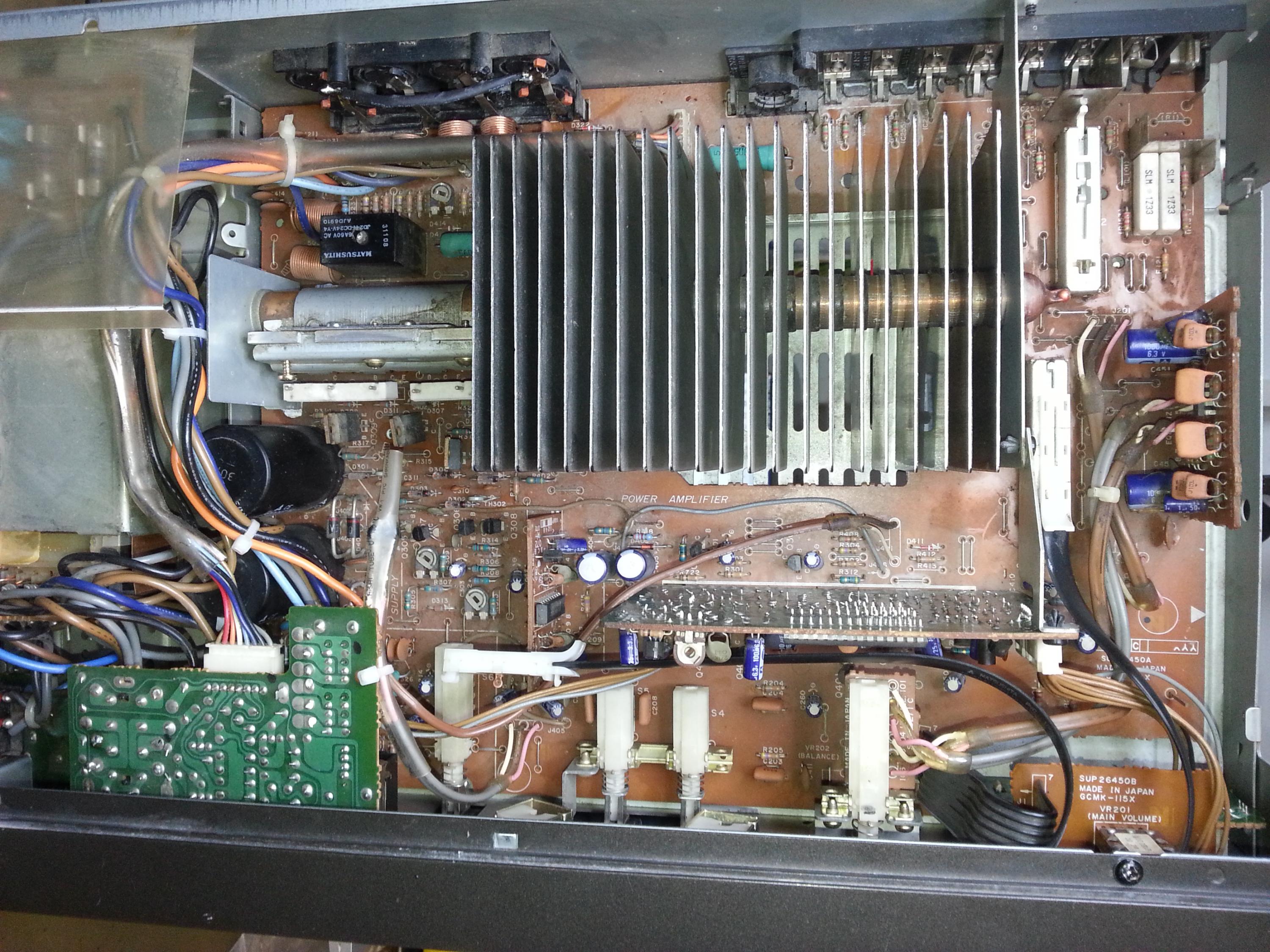

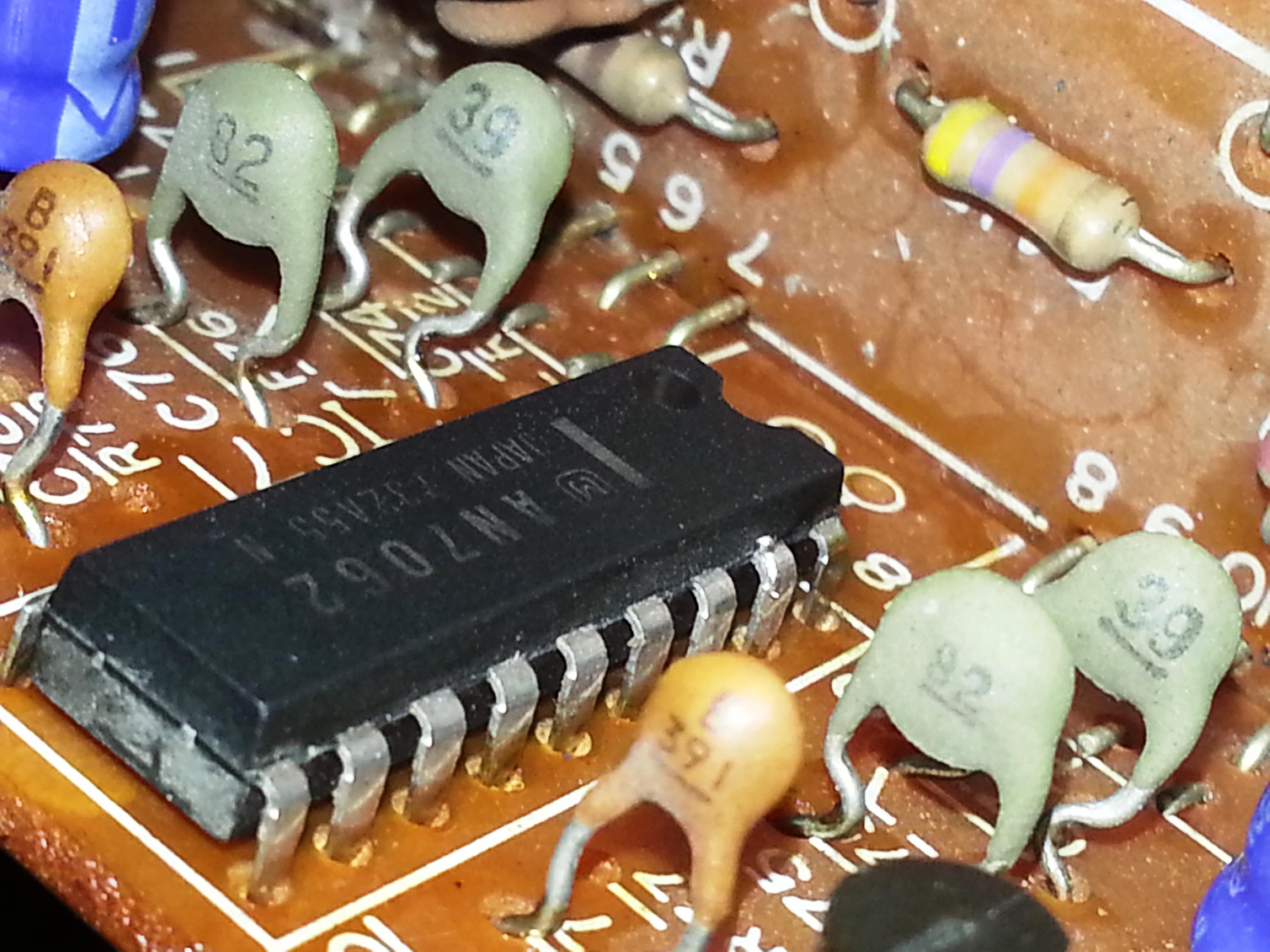

    Good day folks. A very complicated and at the same time interesting story here: I ended up with a HiFi amp which looks decent enough to keep and also has good documentation to help us troubleshoot. It's a fairly old thing, I think it's a class A amp, making it outdated now, but any amp is better than no amp at all in the shop to blast some tunes, plus this is all about learning, since I must admit I'm not very vexed in this field and all I have is some general knowledge about amps. Here goes:
    The amp works overall: you plug it in and it makes sound, but it has a quirk I'd like to sort out to make it 100%: distortion...I know there are virtually endless reasons for this and without a scope, they're hard to pinpoint, but perhaps we can come close and narrow it down to something like a cap or something that ages naturally, since there are no signs of visual damage otherwise. The problem is as follows: when the balance control is in the middle, it works relatively well, I mean there is a bit of noise, but unless you have the sharpest of ears, you can't really hear it, especially at low volumes, so that's issue no.1
    Issue no 2 is that when the balance is adjusted to the RIGHT channel, all that changes and all you get is a distorted mess in the right speaker. It's worth mentioning that the distortion is present on the headphones output as well, so it's not a problem with the amp stage, since if it receives trash it simply amplifies trash with no control over it.
    What I noticed so far: the amp has a "speaker selection" knob which toggles between 2 sets of speakers: "Remote" and "main". One interesting feature, which I absolutely adore TBH is that the headphones jack does not disable the speakers like "conventional" amps, so you can listen like a DJ to both the output and the headphones. To listen to JUST the headphones, you throw this switch to the "speakers off" position and you get the sound through just the heaphones. When set to "off" (speakers disabled), the distortion becomes significantly worse on the headphones. By contrast, when set to "all on" ("main AND remote"), the sound is nearly perfect ! My limited knowledge tells me the difference in load ("impedance" ?) causes it to spring back to life. It should normally do this by itself, but a component is dead somewhere and not doing its job.
    More to come: Page 17 of the schematic shows that the inputs eventually converge (bypassing all "enhancements" and sound effects and setting everything to "flat) at block F, governed by IC71 AN7062 which looks like an op-amp. The signal passes through two electrolytics C71 and C72, one for each channel, on its way to pins 16 and 2 respectively...I tried snapping a pic of the riser board this IC lies on. Now purely on a whim, I touched my finger onto this IC to check its temperature and while not burning hot, I did notice one thing: the cooling effect of my finger caused the right channel to drop out in volume slightly, along with the noise of course...interesting. I then remembered I encountered this exact issue when I fixed a Tascam USB sound card (some of you chaps helped me there too), which also had an op-amp which got hot and upon cooling it the sound would return to normal. I took it to the next level by spraying some alcohol on it: the right channel cut out entirely this time. As the alcohol evaporated, the sound along with the noise came back in the right channel...replacing this guy shall be at top of the list I reckon.
    The manual is VERY comprehensive so perhaps some audio guru out there who immediately recognizes the topology and overall design can point me in the right direction. Here's a photo of the interior....gotta love that heatsink The volume gets very loud with minimal movement of the volume pot, so there is some grunt behind it, but it's a shame it doesn't sound good.....I'm sure we can work it out eventually. Thanks for any thoughts and support

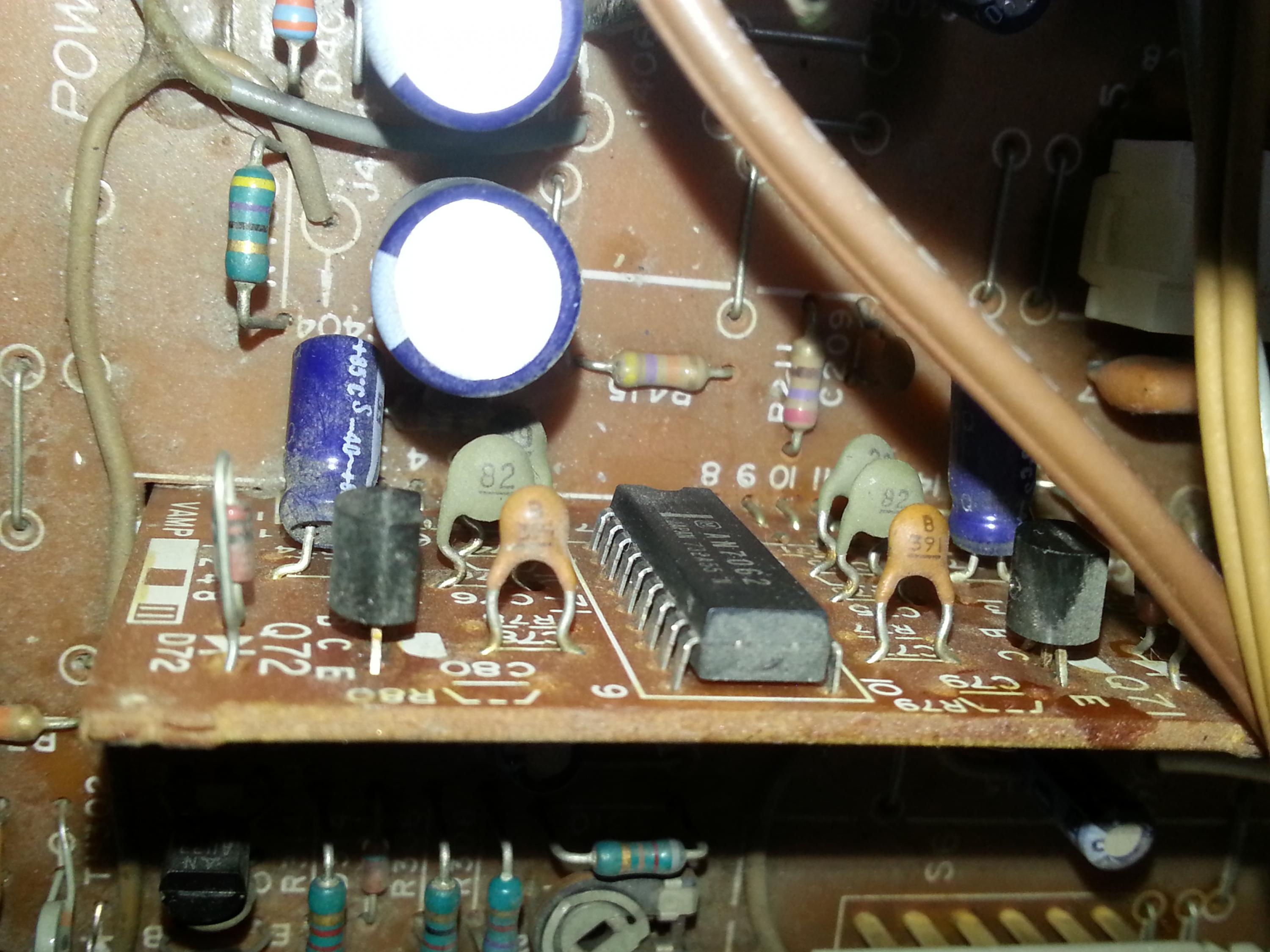

    Forgot the other pic, the one of the riser board holding IC71...

      check your pre diver and driver on the PA. Compare and see if those are one of the known noisy or prone to fail transistors. You can also check each stage with your oscilloscope. Caps could have an effect too...

              I replaced C404 and C405 (page 17, middle-top). Indeed they looked pretty bulgy at the bottom to me...plus even if they somehow were still "OK", it doesn't hurt to replace them. There aren't that many electrolyitcs in this thing anyway, so might as well replace as many as possible.
              My next two targets are C71 and C72 which feed the inputs L and R to that IC. I don't have 3.3uF caps on hand at the moment, so we wait until Monday

                The IC AN7062 outputs to the base of PNP transistors Q71, Q72. It might be helpful to replace these, taking a device with somewhat higher power rating: 2SA1124, 2SA1145, 2SA1285, 2SA1208 will all do the job. And a timely warning: be careful when adjusting the bias current, the output stage of the power amp tends to oszillate!

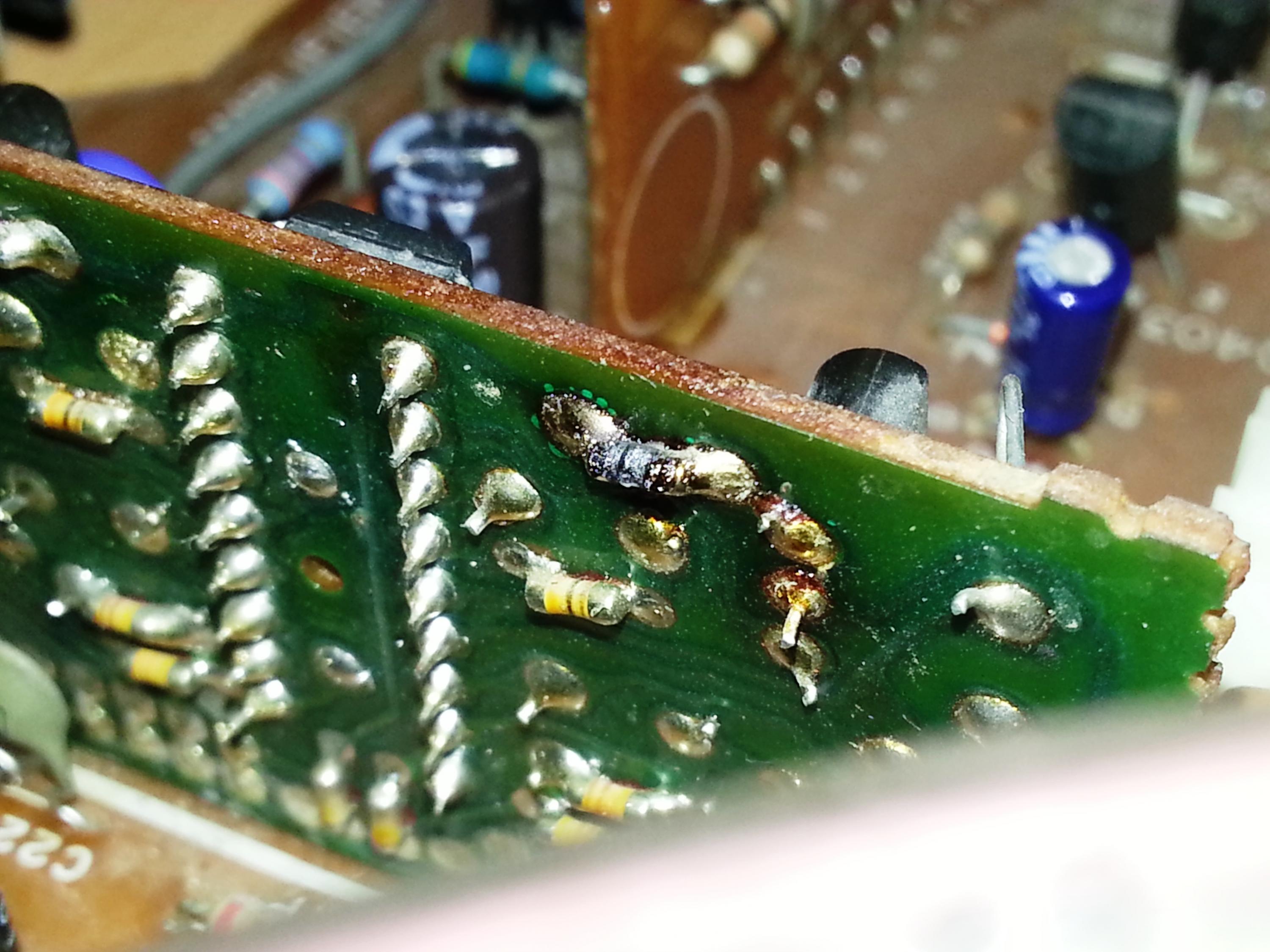

                            Ok, well this was a bad idea that went wrong on so many levels: like I said, I thought I could tap into the signal line just before it enters the amplifier stage. I soldered two RCA jacks, one to pin 14 and one to pin 2 of the riser board (page 17 of the manual) and their ground to ground (pin 7). These were supposed to plug into a working amplifier or, ideally, a set of crappy computer speakers. I didn't have the latter and didn't want to risk my home theater system, so I THOUGHT I could get away with using my headphones and gently increase the volume until I got an idea of what it sounded like...I believe this is what caused the actual failure and audio gurus may spot this from a mile away upon reading.
                            I took an RCA to jack adapter and I only hooked up one channel of the headphones to the "taps" I made - the left one. The amp started normally and upon plugging in the headphones to one of the RCA connectors I soldered, I heard a pop in the left channel - ok, normal, no big deal I though. After a few seconds though with the volume all the way down and nothing going through the amp yet mind you, I hear another pop and then see something catching fire on the amp....literally: something was glowing orange and was on fire with smoke ! After immediately pulling the plug and waiting for the smoke to clear, I assessed the damage, which is NOT minimal unfortunately and happened on all 3 devices: the PC (albeit a junky one) no longer outputs sound on its left channel, the left channel of my headphones is now dead and there's of course the damage on the amp itself :| After taking a closer look, it's R79 (page 17) that got charred. D71 and Q71 don't appear to be shorted, which are directly linked to that resistor. What I THINK happened and this is just a theory, so please correct me, is the headphones have a low enough impedance to act as a short, pulling the collector of Q71 to GND, Q71 and sending 50v into the headphones.
                            I can't quite figure out why the sound card died though. I suspect IC71 also died because to travel back into the sound source, the current must've somehow reached pin 10 of the riser and from what I can see it can only do that through IC71, though I didn't read any shorts there either. In the second picture, you can just about make out a bit of solder sputter on pin 17 of the IC which wasn't there before - must've got hot.
                            This really was a disaster and I'm very disappointed, especially since it killed the sound card... :| I'll replace the resistor, but I'm not sure whether I should go for it straight away, except this time with an amp or desktop speakers or something, or would the same thing happen again ? A little help please ?
                            EDIT: theory no.2 is that the earphone could not take the juice the preamp pumped into it and shorted out, eventually leading into the same situation: collector of Q71 shorted to GND...

                                  You should check transistors like Q305, Q307 and R313, for R79 to burn up I suspect current flowed through Q71 and through your headphones, and that maybe protected the power amp section. remember this is a Dc coupled amp and it don't take much to be upset.
                                  I don't see why the sound car was effected unless you had IT connected directly to the circuit somewhere.

                                      I also discovered R402 is also fried (page 17, midway through the thick black line indicating the 50v rail)...understandably since I basically shorted across it....
