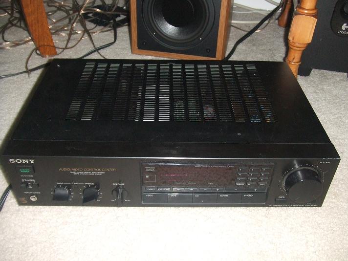

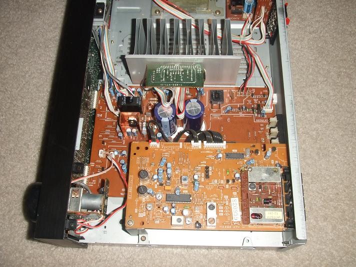

    This was my grandpa's who passed away about 4 years ago, and he bought this about 5 years ago. Its a really nice receiver, I have it hooked up to two Polk audio 5JR 60469 speakers. It sounds really nice, extremely loud, no need to take it past 1/2 volume even though its only 90w (45 per channel), and those Polk monitors hardly distort. It has a remote with volume control and a volume knob, which doesn't make sense except for that when you turn up the volume on the remote it moves the knob. I also have a JBL 200w sub, but that's fed directly from my computer and gets its power from the wall.
    The only problem I have with it is that sometimes there will be a buzzing from the speakers. I ruled out my computer, as it still does it when you unplug it, and the speakers are fine hooked up to anything else. I don't think it is the caps, as the primaries are Nichicon, and all the other caps are rubycons, I think it is some connection issue, as it sometimes goes away if you wiggle the input connections from the computer, and will always go away if you smack it lightly.
    Any Ideas?

    cold/cracked solder joint? Replug some of those pin-connectors, too.

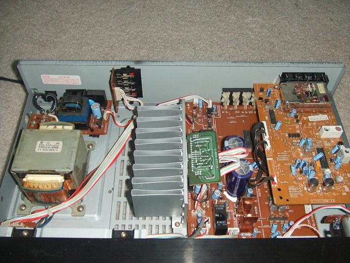

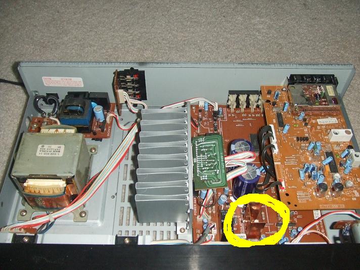

      I isolated the problem to a certain part.
      Its labeled as the regulator on the PCB.
      It has the markings as follows:
      NEC
      D1585
      1 93
      It has a small heatsink attached to it, and if you poke it with a screwdriver lightly, the buzzing starts. If you poke it some more, the sound completely goes away, and it starts to get very hot until you power down and re-power on the unit.

        Maybe something like this?
        Seriously, if resoldering it doesn't fix it, it's time to break out the scope and find out what is happening.

          You should start with checking the solder around that xsistor 1st. Be sure it's screwed tightly to it's heatsink. It may need to be replaced if all else fails.
          You mentioned the speakers hardly distort. 45W is not alot of power and high volume levels will send it into clipping (distortion). Clipping is when a sine wave gets cut off and is square which is DC in that portion of the waveform. Thats how most speakers get cooked, by being fed distortion or clipping from an underpowered or overdriven amp. That's why you are less likely to blow speakers with a higher powered amp since it is less likely to be driven into clipping. All within reason of course.
          Once the amp is driven into clipping, it heats up more, thermal runaway can take place on your outputs, clipping becomes worse, DC levels higher and before you know it the voice coils on your speakers are cooked and maybe your amp is fried.
          Bottom line....dont turn it up so loud that it distorts. Unless you dont like your equipment. If you want cleaner, louder sound, buy a larger wattage amp. Your speakers will appreciate it.

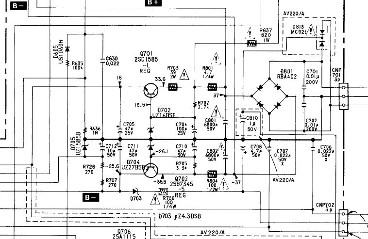

            That 2SD1585 is used as a +16V regulator from the main B+, for running analog ICs and other misc. circuitry.

              Well, I took out D1585, and when checking it with a DMM set on ohms, it does the following
              left leg (positive lead of dmm)-center leg (negative) conducts about 17.85 Mohms and slowly drops down to about 17.10.
              Right leg (positive lead of dmm)-center leg (negative) nothing
              Nothing if I reverse the leads.

                according to NEC's datasheet for it, it is a 60v, 3A (5A pulse) NPN switching trasistor. Could I replace it with thise 400V, 5A (8A pulse) NPN switcher from a deer power supply I scrapped?
                • 370forlife
                  Large Marge
                  • Aug 2008
                  • 3112
                  Re: sony STR-AV310
                  Ok, so it worked.
                  Actually turned out that deer kind of overbuilt that power supply. It was a Sanyo 12A (20A pulse) part. Works fine now. Now extreme heat built up and no cutting out sound.

                                  It is unlikely that a number of people would report a regulator transistor that has become intermittent and sensitive to pressure from a screwdriver. It is much more likely that the small bridge rectifier is the problem in all of the units. These small bridges are a common failure item.
                                  The symptom is buzzing. That symptom would be related to AC ripple on the input to the (+) regulator. A bad regulator usually opens up and does not cause ripple to be present at the output. I believe the OP was actually stressing the pcb and not just the regulator transistor. One or more of the diodes in the bridge is intermittent. I'm going to predict that the buzzing returns at some point unless the bridge is replaced.
