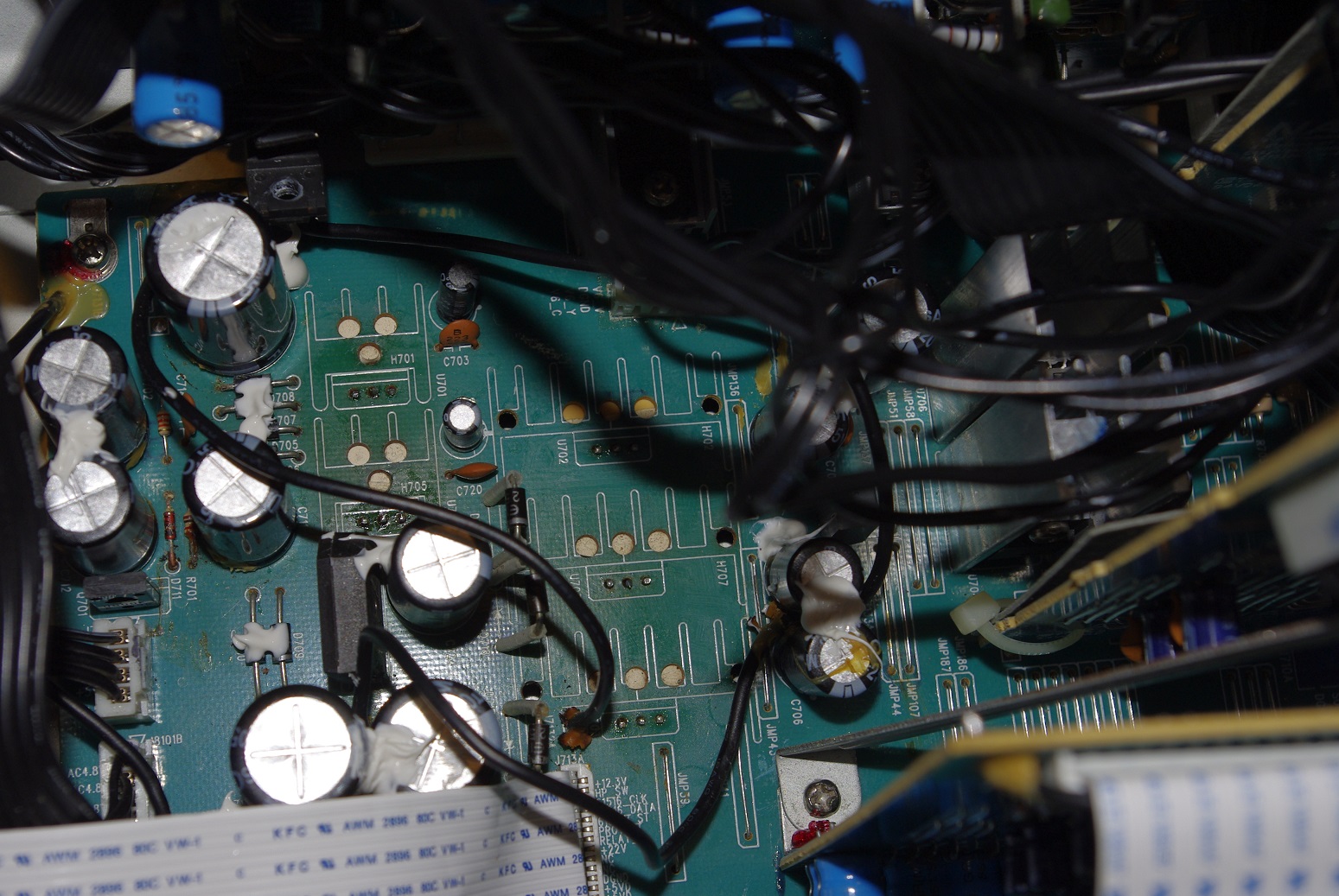

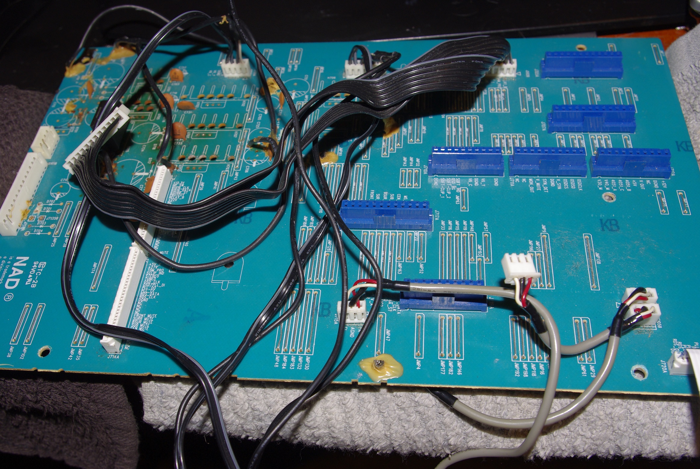

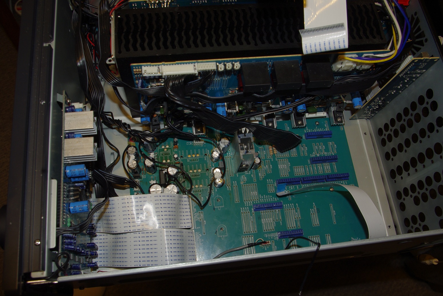

Well once i got it working i did a few changes and was thinking of improving them ( pictures be added at the end ). And was thinking of just swapping out all the capacitors on the main board, i have the service manual for the actual version which is pretty detailed and i have found specs for the caps to replace.
Reason i am planning to replace them with new is that before i made the changes most were put under a lot of heat which must of done them any good what so ever.
Anyways just trying to confirm that audio capacitors are not required or even should not be used even if the specs are about the same ?.

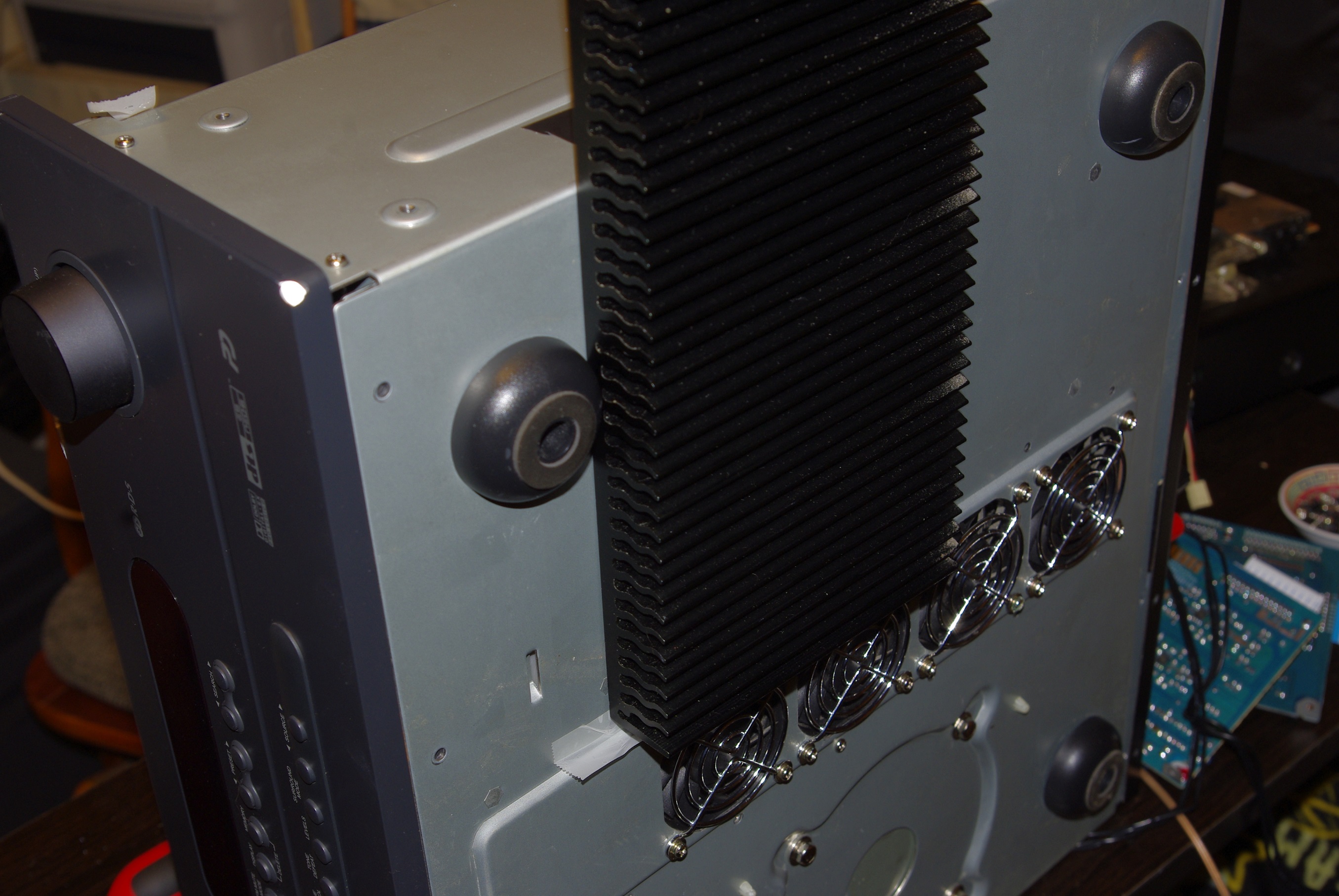

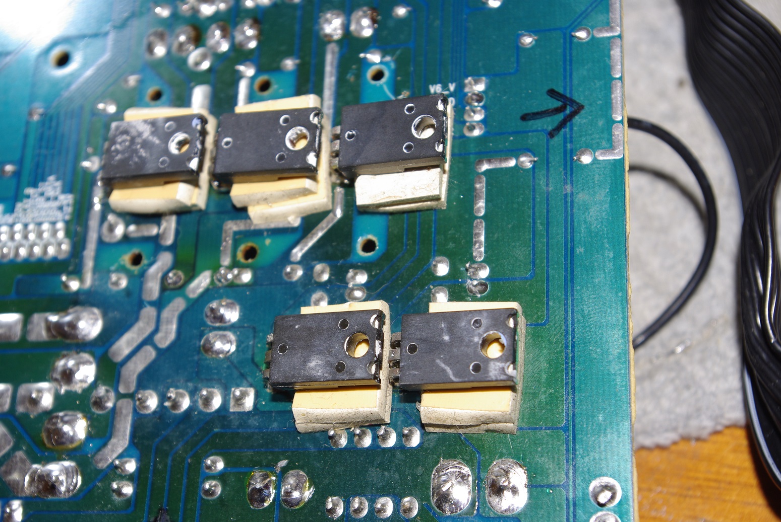

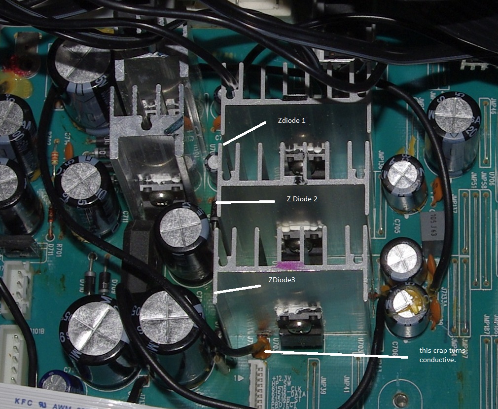

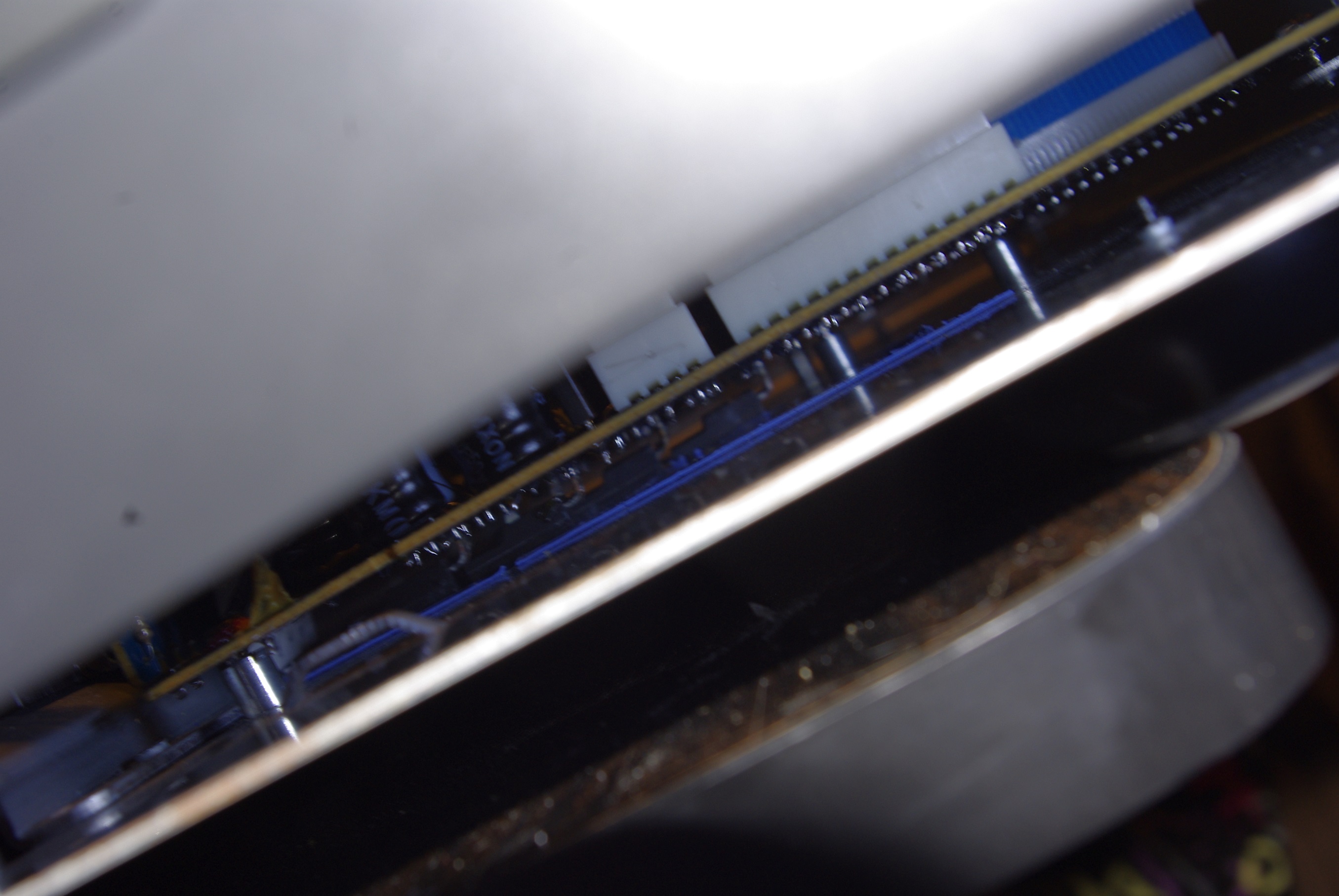

Before the changes the diodes are cramped up against a heat sink and cap, i was seeing some horrid temps around this are and no wounder they were failing all the time, i all so got some high quility diodes which have not been added as i had to wait 3 months for them and got some others that can cope with 150c.
All so added a heatsink on the underside too
