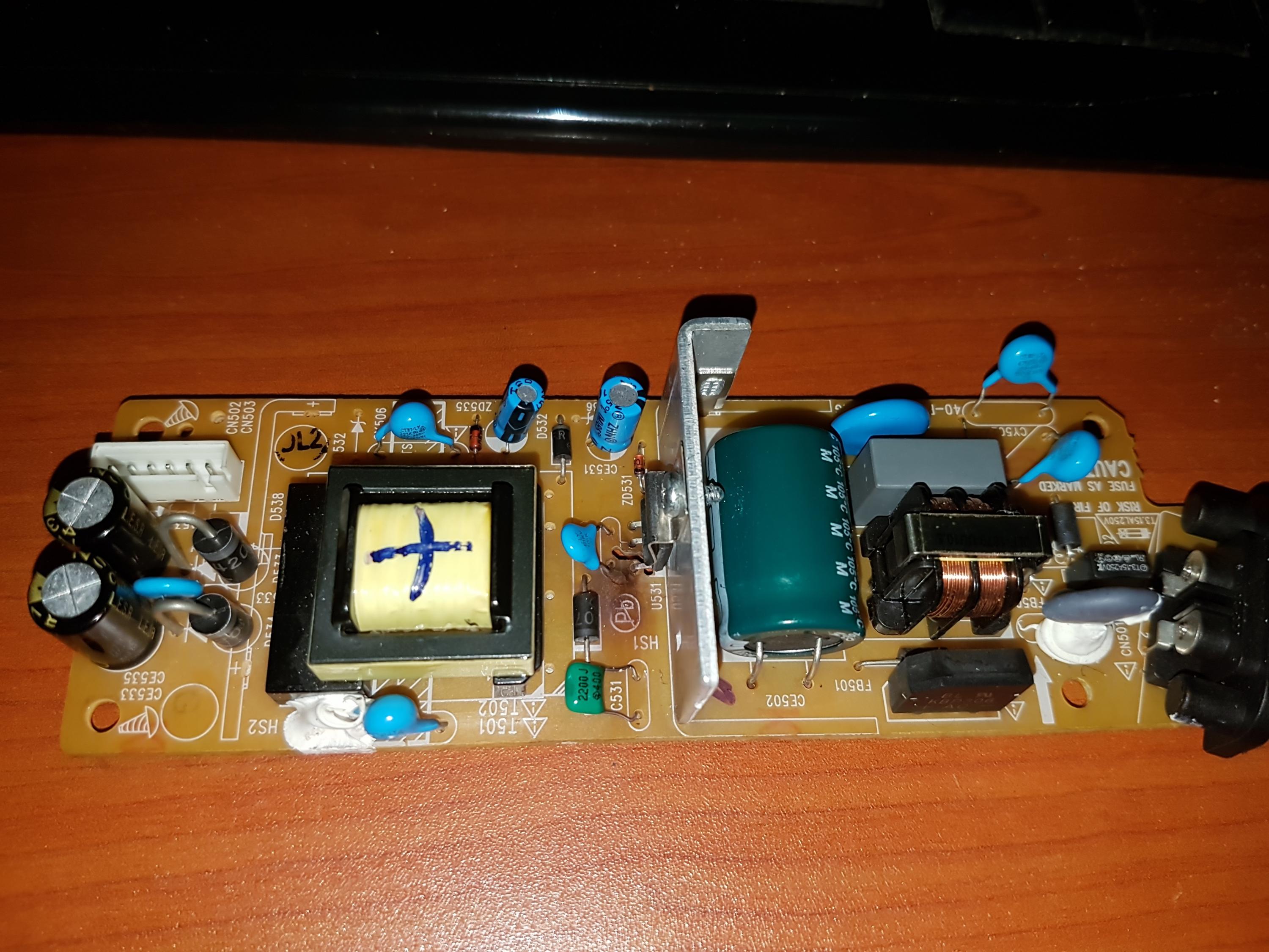

    Philips HTL2160 soundbar NO power problem
    This soundbar has a blown AC/DC Offline Switcher IC which is top257en. I replaced it, power restored, can on the unit and sound works fine. After a while, turn it off, and turn it back on again by pressing the power button, the IC blows again Replaced it again, it blows again after playing with the power button ON and OFF a few times. If the power board is not connected with the main board, its not blowing. It only blows when in operational mode. I suspect it could be the ceramic caps and possibly the electrolytic caps as well. Any suggestions? 19V present (according to service manual) on the output pin that's connection to the main board which states 18V. I believe the AC side is working fine as the fuse is not blowing. Its definitely something to do on the DC side thats blowing the IC.
    Already tested all the diodes, all in good order

    Re: Phillips soundbar NO power problem
    On both the Top and Bottom sides, test all the semi-conductors . Test the e-caps ESR and capacitance and NP caps capacitance. Test the resistors for open or high resistance ohms. Do not take for granted nothing is wrong on the ac side. Test all the components on the ac side as well. Report your findings.

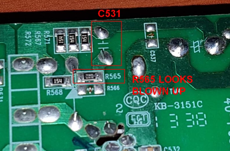

                            Originally posted by DjKrish
                            Already replaced C531 and C536. The diode is fine no short.
                            It looks like you have blown snubber resistor R565.
                            That snubber cap C531 should be rated at 1KV, you have 400V rating on that replacement cap.
                            • DjKrish
                              • Oct 2012
                              • 354
                              • SG
                              The original snubber cap is rated as 2200 J 400. What you see in the picture is actually original according to Phillips schematic diagram
                                good eyes budm

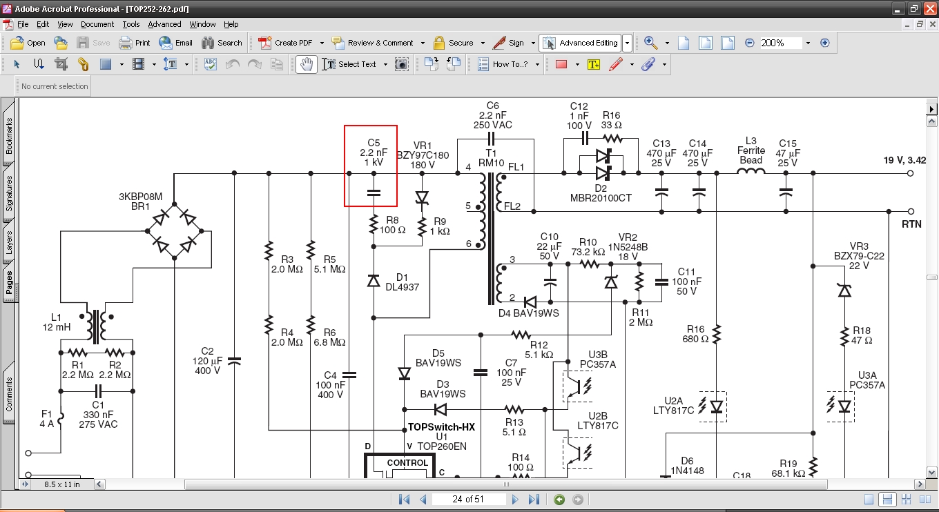

                                  Well, they are not following the IC manufacturer advice.
                                  the schematic shows two 22 Ohms resistors in parallel so one is not going to handle it, your board only has one, cutting corner to save money on parts. The snubber diode is rated at 1000V too.
                                    So i should change the Cap and add one more 22 Ohms? Should that be ok?
                                    Update: After replacing the burned resistor, the main cap is discharging pretty quick upon switching off. Before this nah, wasn't discharging at all. The voltage seems stable as well. The schematic says 19V, the board says 18V. Weird.
                                    2nd update : Fixed everything and installed the full unit. So far nothing exploded yet as its working fine, fingers crossed
                                      I would change the cap to 1000V, the 22 Ohms should be higher Wattage otherwise it will probably burn up again. That snubber circuit is design for reducing the Ringing/Overshoot based on the circuit as a whole, so the only way to find out is to use the scope and a differential probe to analyzing what is going on.
