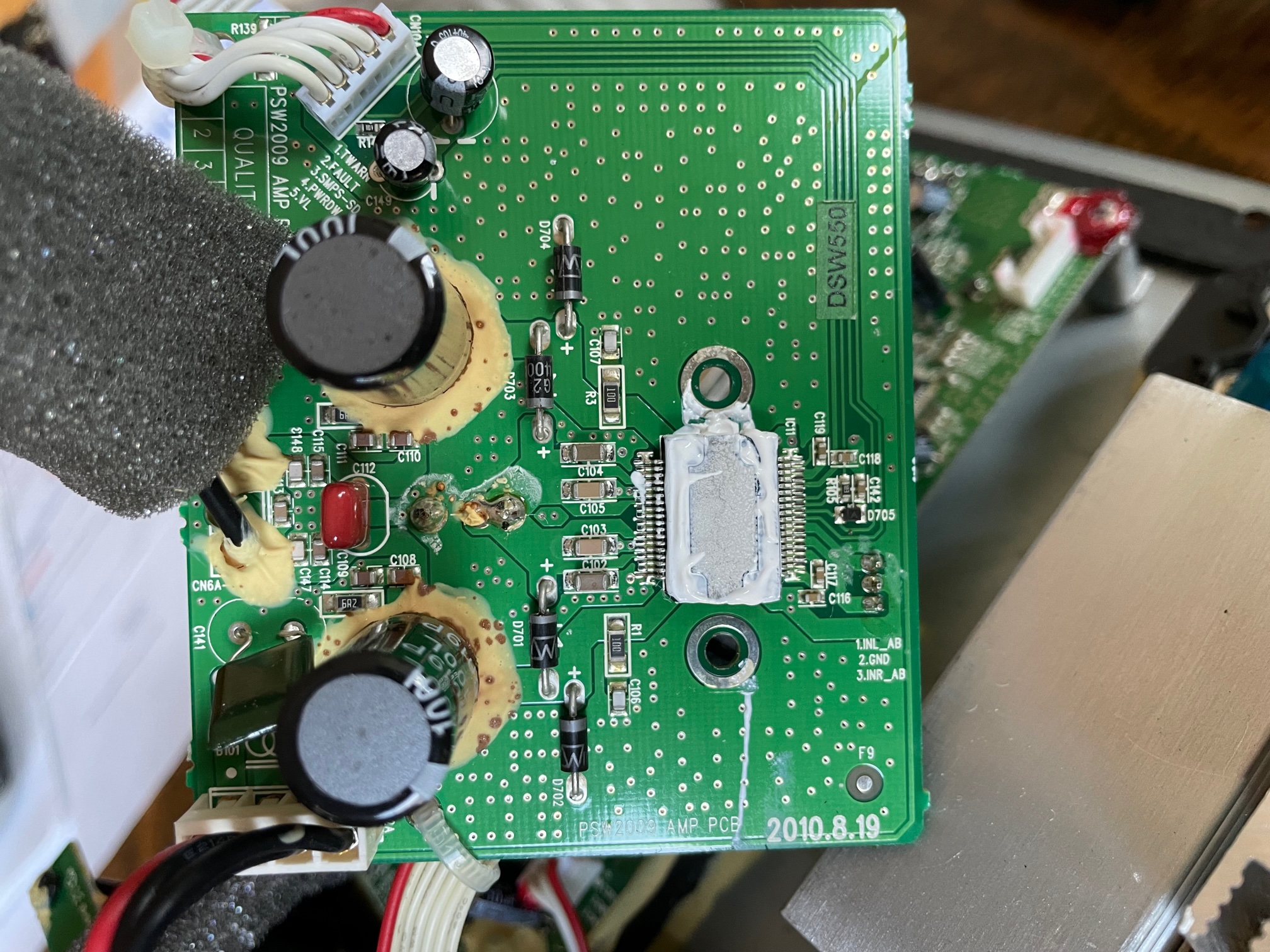

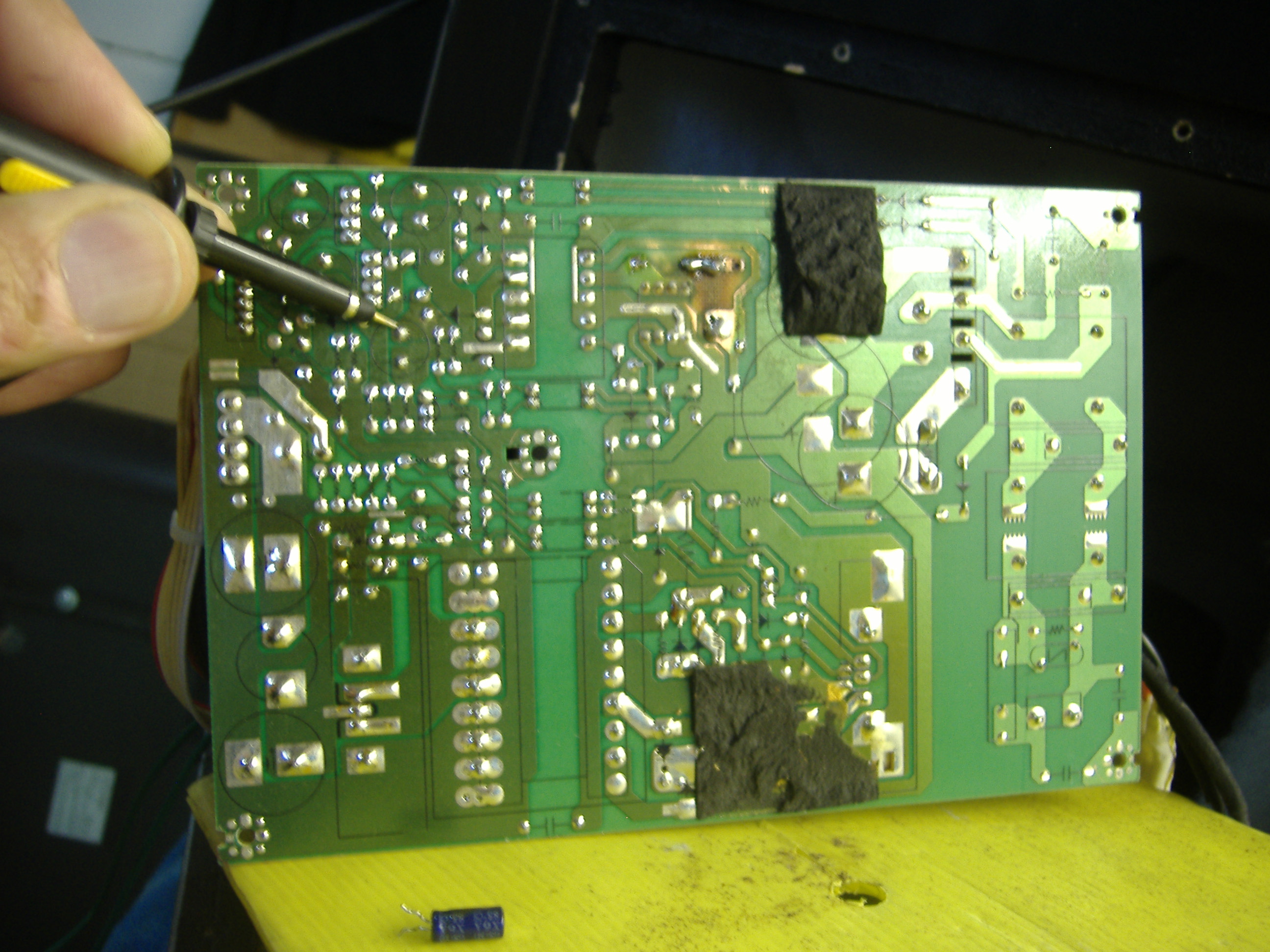

    Good afternoon, unit came in not switching on.

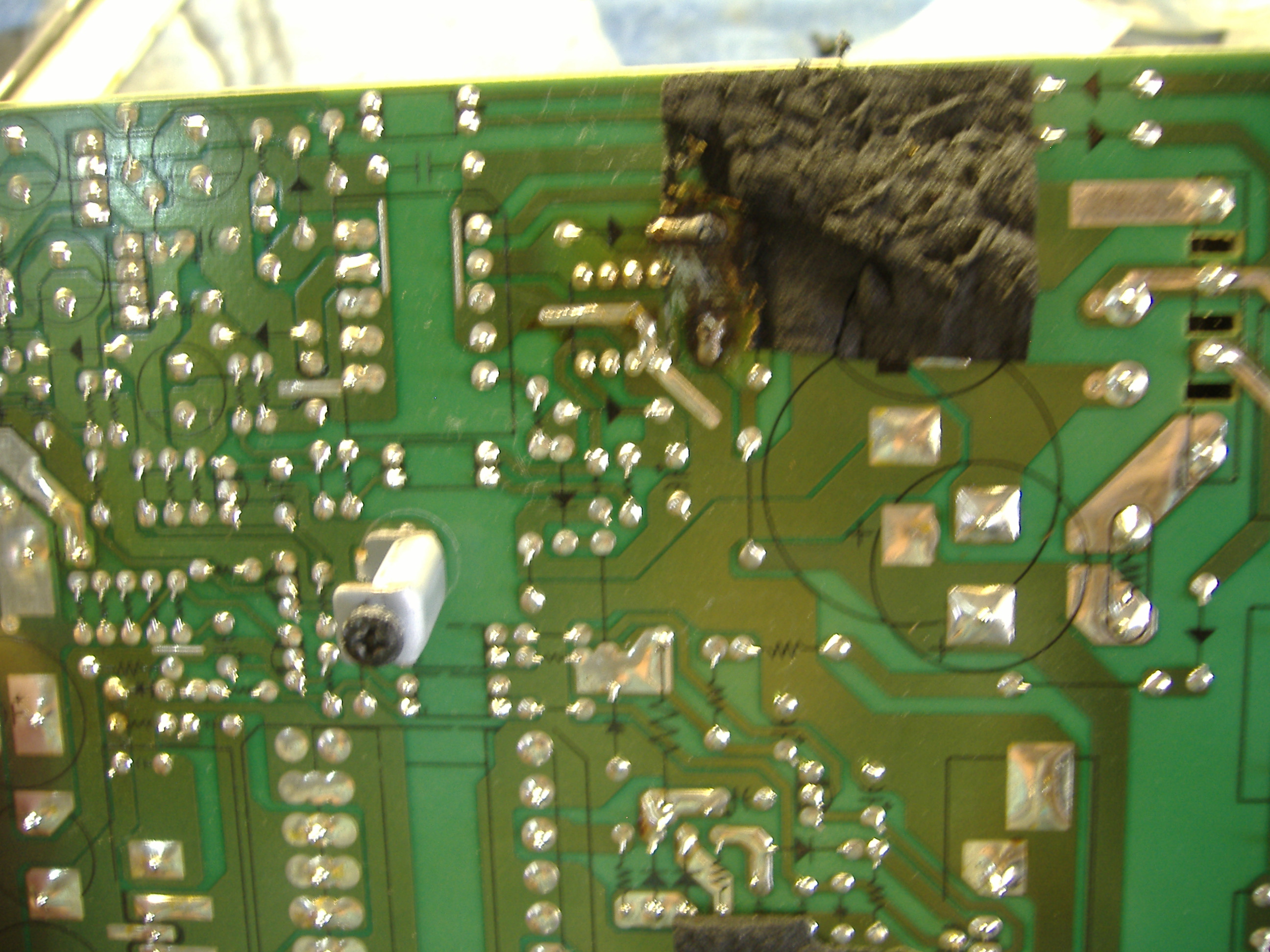

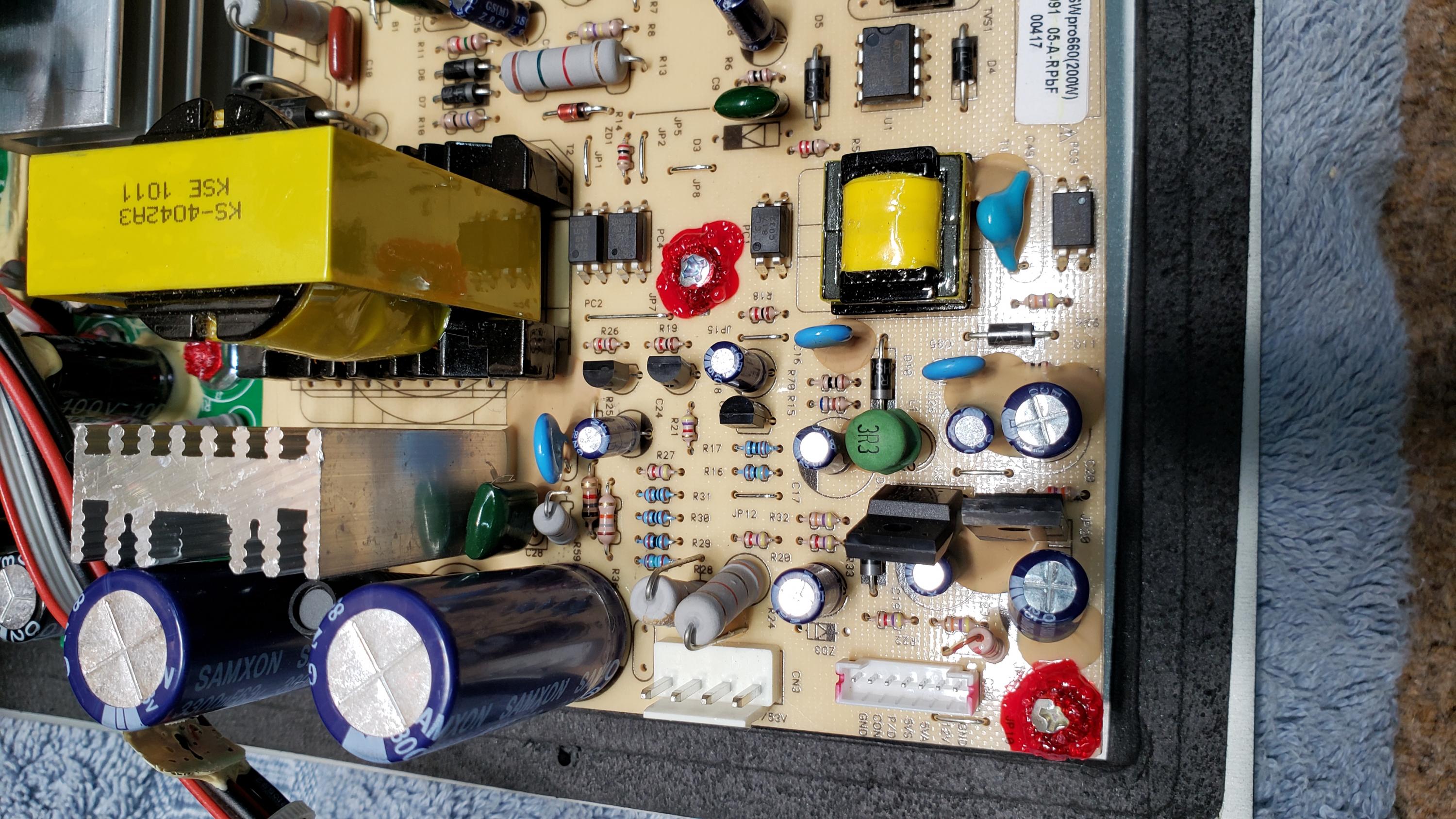

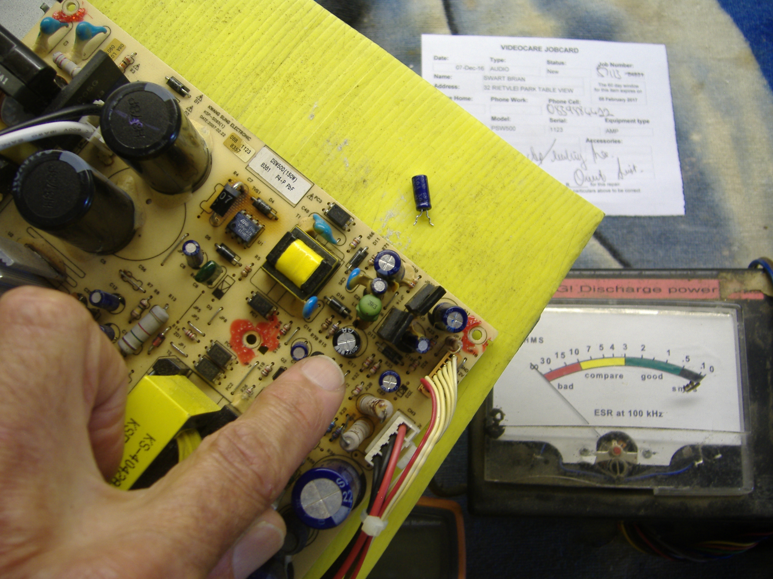

    Found burned & cracked diode.(photo.1) Replaced with FR307.(photo.3) and cleaned up the burned debris. Looks like diode has generated a lot of heat.

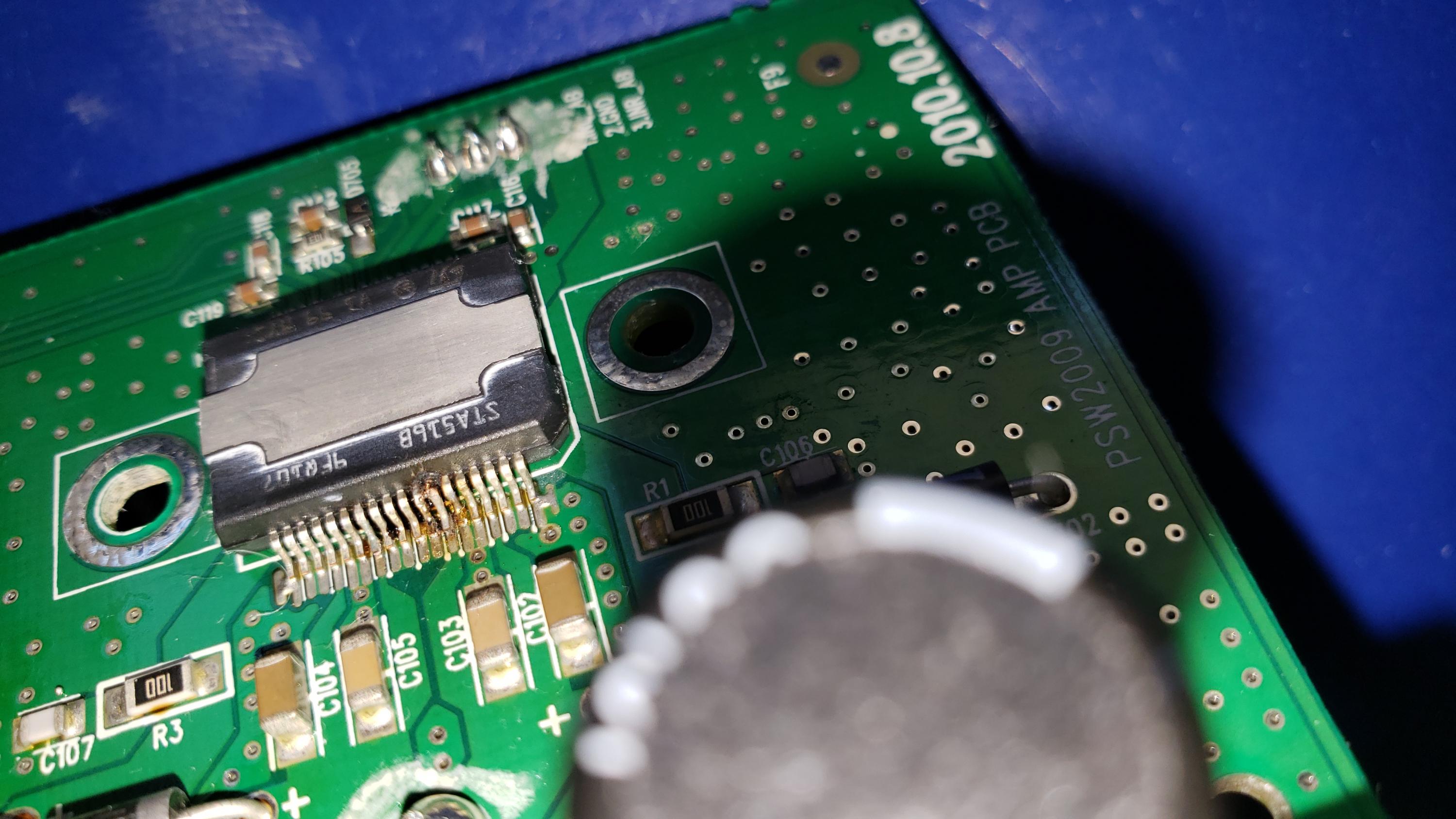

    Wonder if during assembly they could have placed the foam suspension else where. (photo.2)
    Unit would still not switch on, missing 12v & 5v supplies.

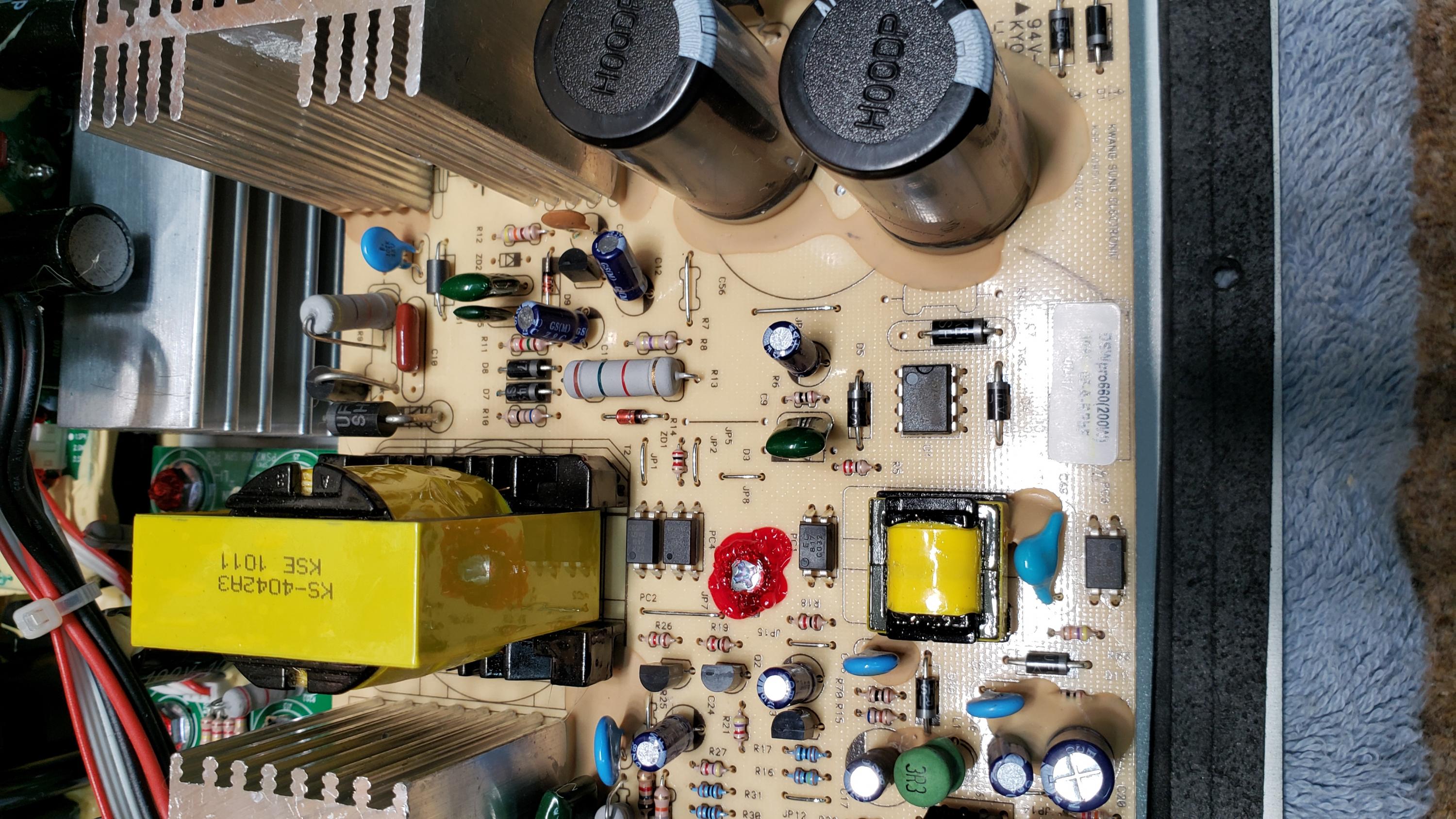

    The diode supplying the voltage to the 5v regulator when scoped had a large ripple on it. (photo 4)

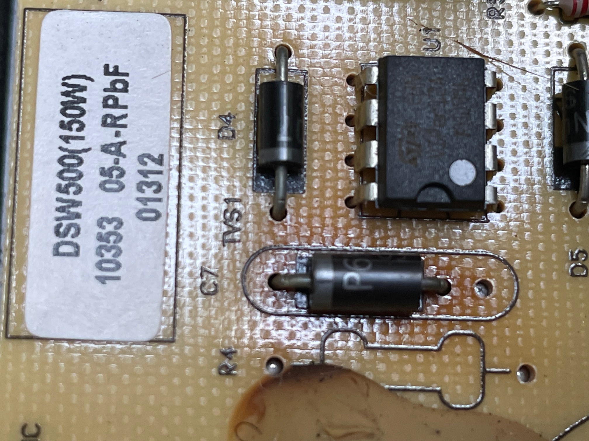

    Replaced C12 220uf/10v(photo 5),

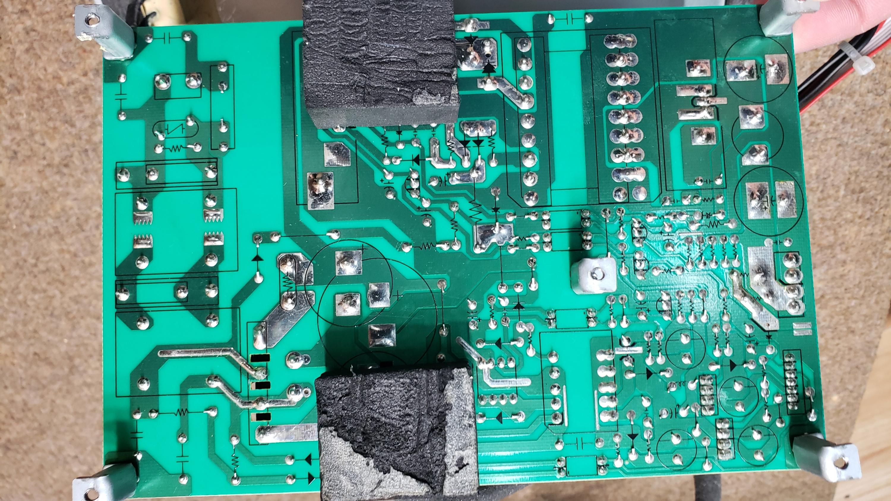

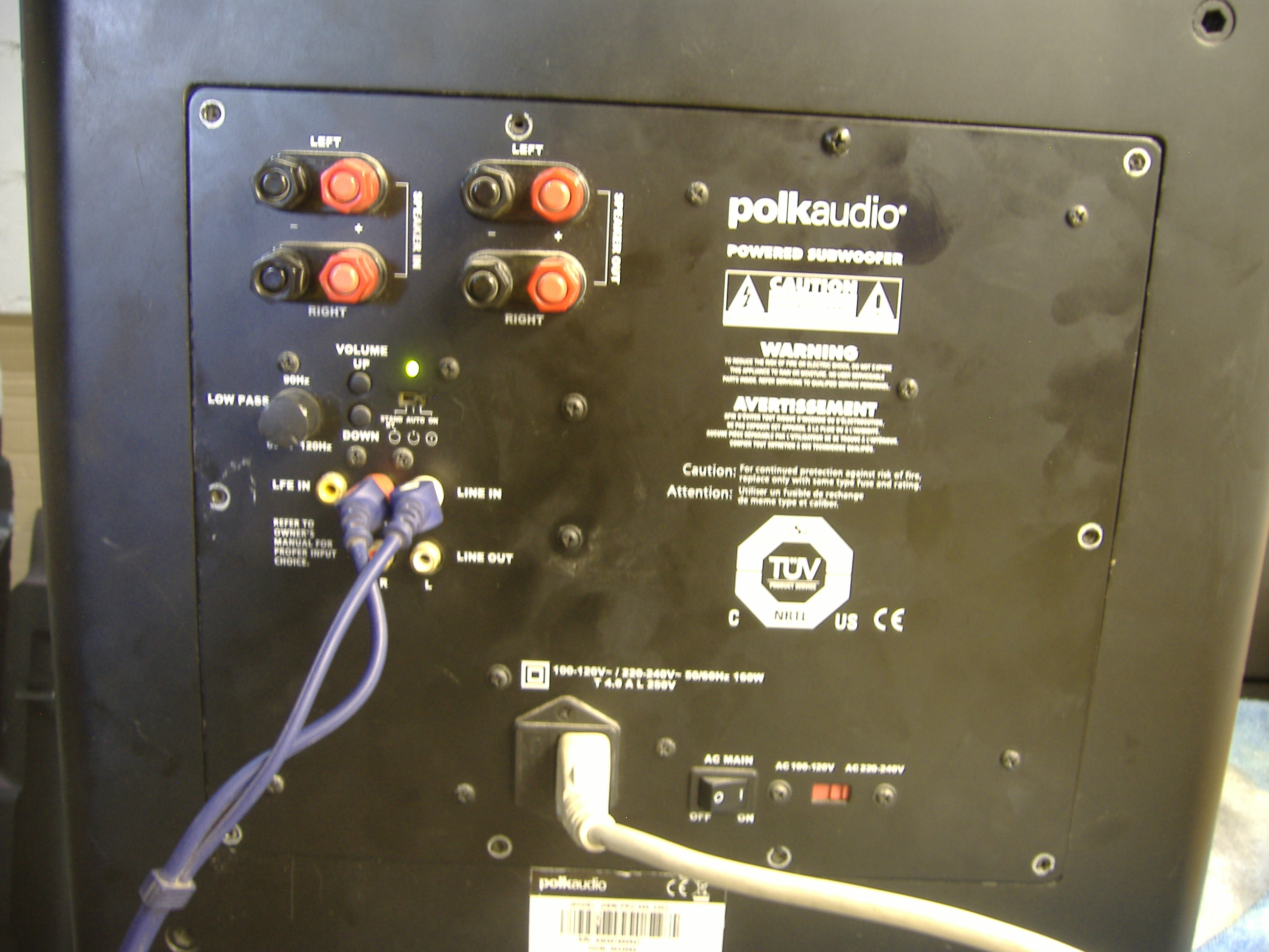

    and hey presto unit up & running! (photo 6)
    I don't know if the FR307 (CRT TV line output flyback diode) is adequate.
    The diode feels warm to the touch, and wonder if any one could comment on this.
    I googled the specs' of diodes I had in stock, and this one seemed to fit the bill. Thanks.

    What is the P/N or the broken diode? That looks to be the snubber diode.
    • Grunder
      • Jan 2016
      • 323
      • south africa
      Re: Polkaudio DSW PRO 500 not switching on solved
      Hi Budm, looking at one of the photos it looks like it could have been incorrectly marked as C7 instead of D7.
      The diode was broken, but it looked like a S3V76.
      I couldn't find a data sheet for S3V76, but found one for a S3V60 which said the diode was Vrm 600v & Io 3.5 amp.
      So I guessed the specs of the S3V76 is a Vrm 760v & Io 3.5 amp.
      The anode connected to the 300v mains rectified supply, and the cathode to the drain of the pwm ic P6KE18. (pins 5,6,7 & 8).
      The drain of the pwm ic then connected via a reversed diode to the transformer supplying the voltages to the 12v & 5v regulators.

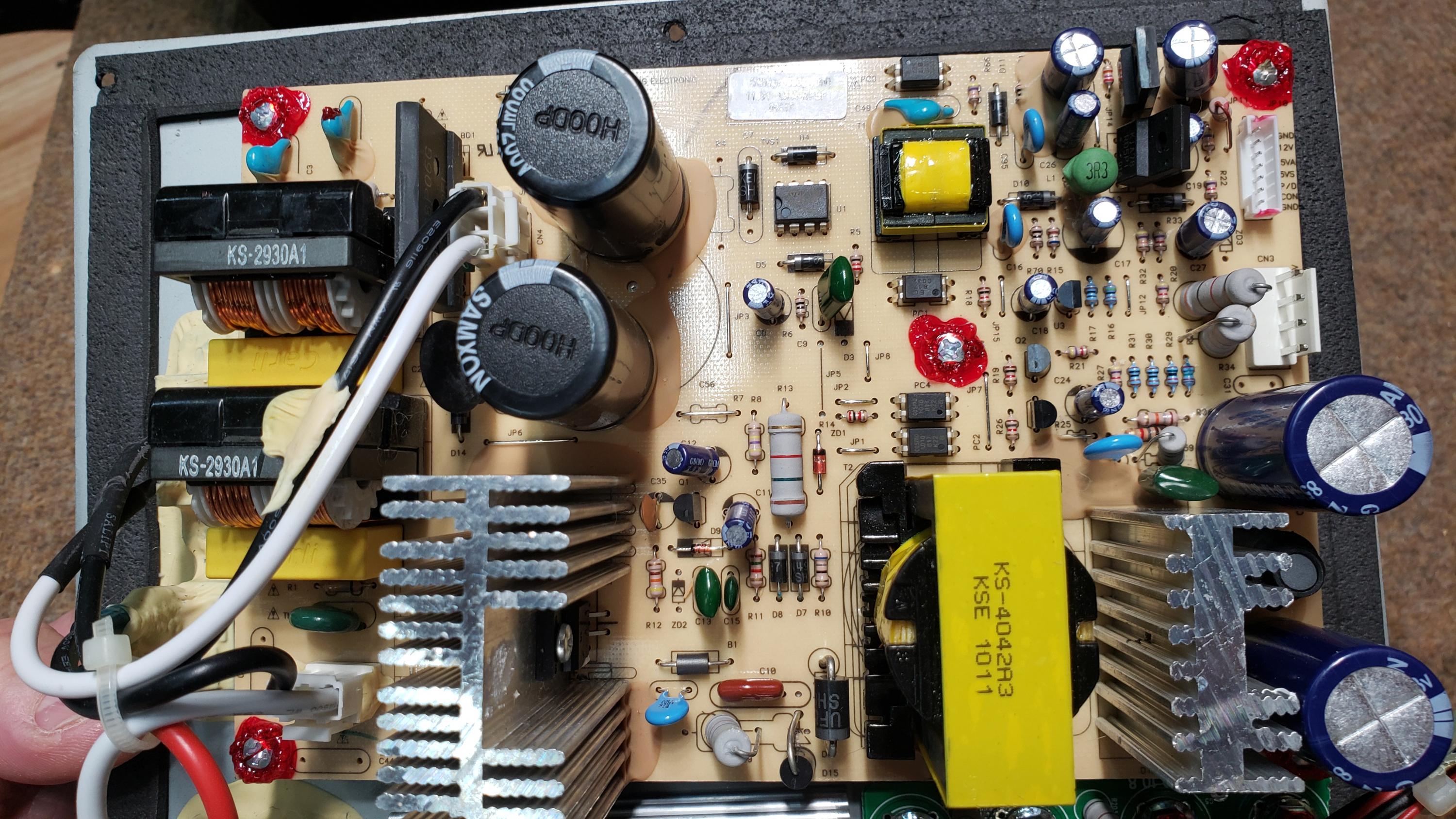

          Would anyone please be able to identify the value of C14. It's a ceramic cap and mine is burnt to the point I can't identify it. Thanks for any help.
          • rader
            • Sep 2013
            • 2
            Here's a pic of mine form a DSW Pro 660 board. Should be close if not exact.
              https://www.badcaps.net/forum/attach...0&d=1578353273
              .001uf +/-10% 1KV, I would update it to 2KV rating, it is snubber cap.
              BTW, the brown glue must be removed, it is conductive and also corrosive as it ages, you can see the leg of the C14 cap is eaten away by the glue.

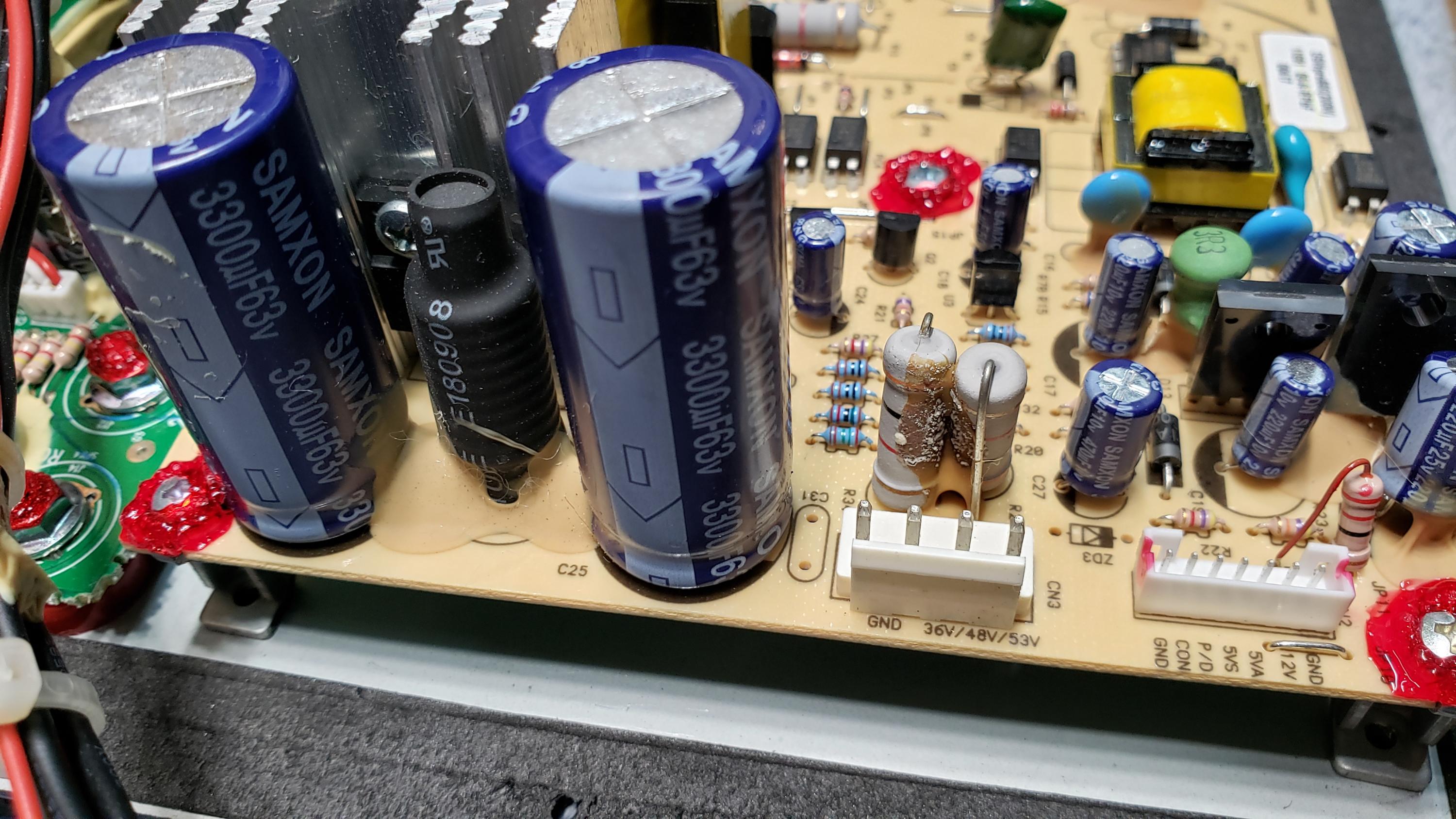

                      Can you provide good clear straight shots pictures of the whole top side and bottom side of the boards so I can give you the test points to test?
                      • Polk660
                        • Nov 2020
                        • 5
                        Thank you for getting back to me. Here are the two best pics I could get. There are two large foam pieces attached to the bottom of the board that I will try to remove if I have too - I just didn't want to take a chance of making my issue worse unless I had to take that chance.

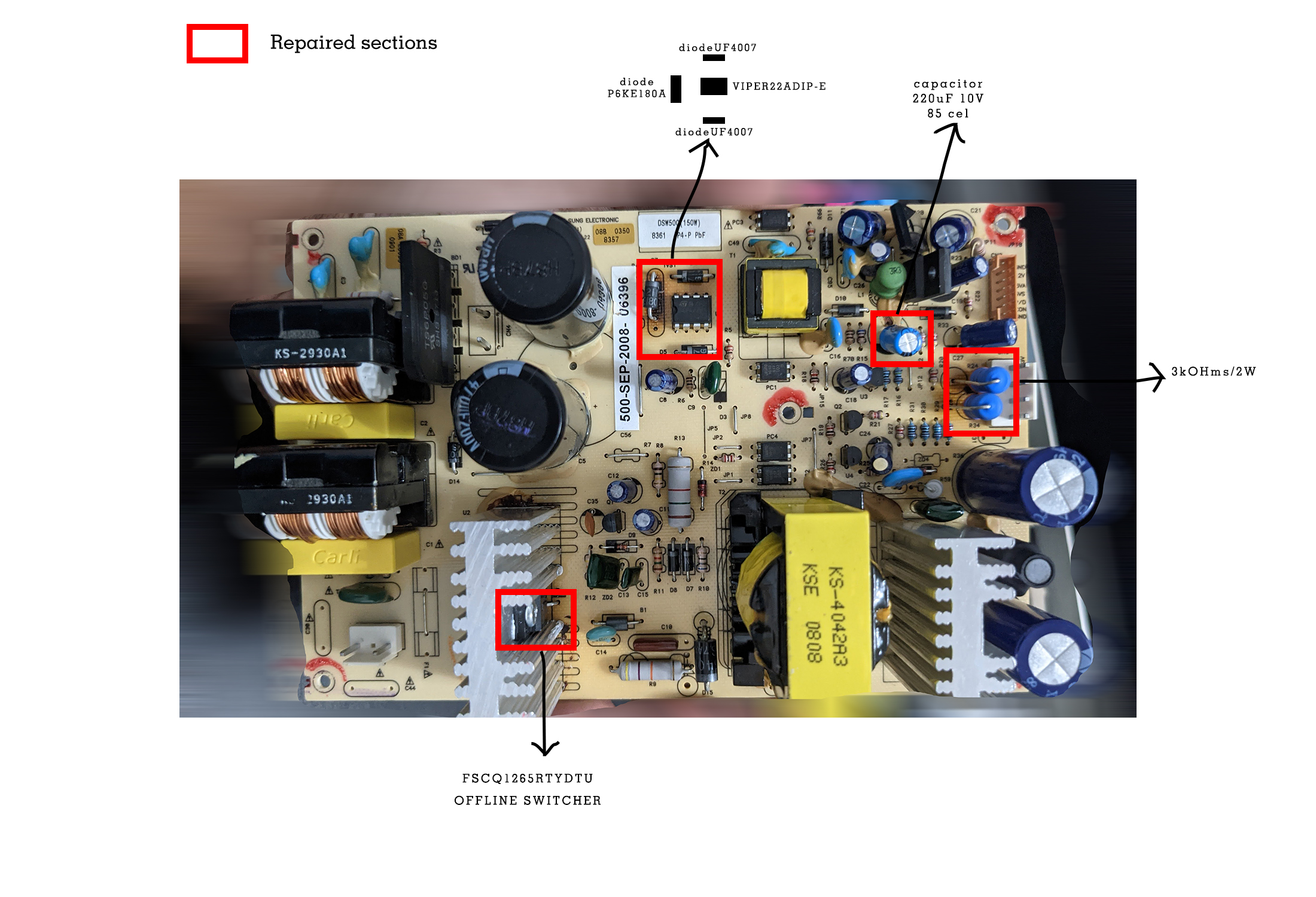

                                Hi Everyone,
                                I am new to the forum. This was a pretty informative post for me. I am trying to fix a DSW 500 pro with a similar problem. Its did not turn on at all, so I opened it up and found three sections heated or burnt.
                                I changed some diodes, capacitors, ICs and resistors.
                                Now the amp powers ON, led is green. But the two resistors next to output plug heat up a lot and i am afraid there is some underlying issue and they will blow up again.
                                I did not play the sub much, but it does play but it feels not with full power.
                                Can someone give me some insight into how to proceed?
                                Also, can someone give me the value of these 2 resistors? I am using 300ohms 5W. I could not get them from the above wiring diagram posted above.

                                  Its working.
                                  I finally got it working.
                                  Originally, it did not power ON at all.
                                  I replaced all the components in the burnt sections as shown in the attached pics.
                                  The only components I could not get were the two resistors right next to the output connector. I first used a 300ohms 5 w (the blue once in pic) but they were heating up too bad (the amp was working, but I was afraid they will blow up). The schematic diagram shared by a member above shows these to be a 3kohm/2w resistor (I miss read the colours on the resistors i pulled out). So I checked the ones I had pulled out, they were 2.9k both. They were a little brown but they seemed ok, so I soldered them back and amps working now and resistors are also not heating up.
                                  In total all components costed 10$ but a lot went into research and finding components online.
                                  This blog was extremely helpful.
                                  I hope this will help someone fix a similar problem.

                                    Issue may be the TVS1 (P6E...) since it is the only brown on the power board, see pic 1.
                                    The amp board doesn't have any issues evident to me. See 2nd and 3rd pics. Are the brown spots on the adhesive reasonable?
                                    For troubleshooting, i should check for 5 and 15 at the connector leaving the power board? If it there, it's likely the amp?
