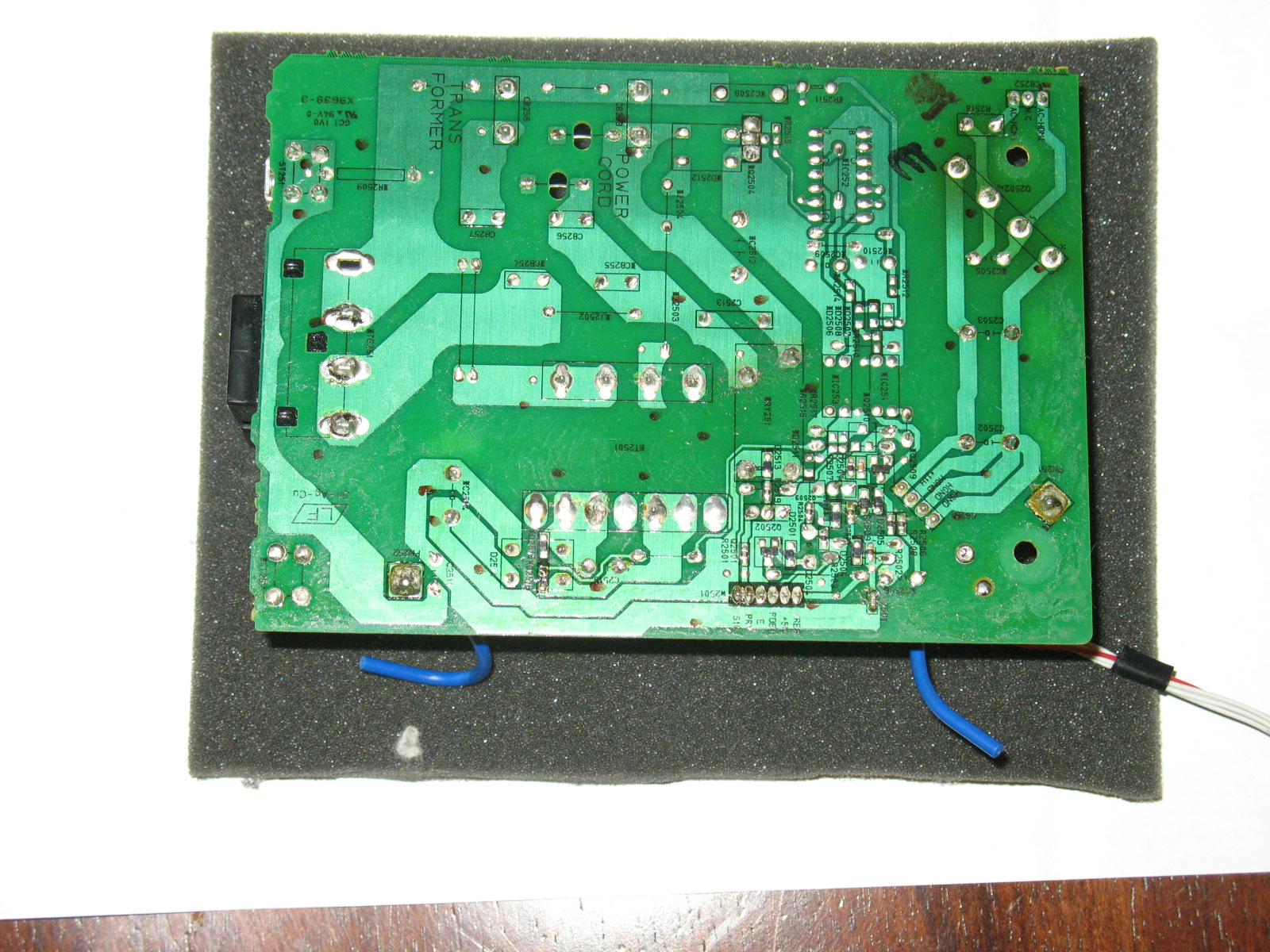

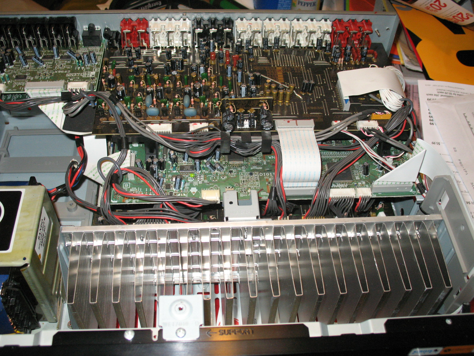

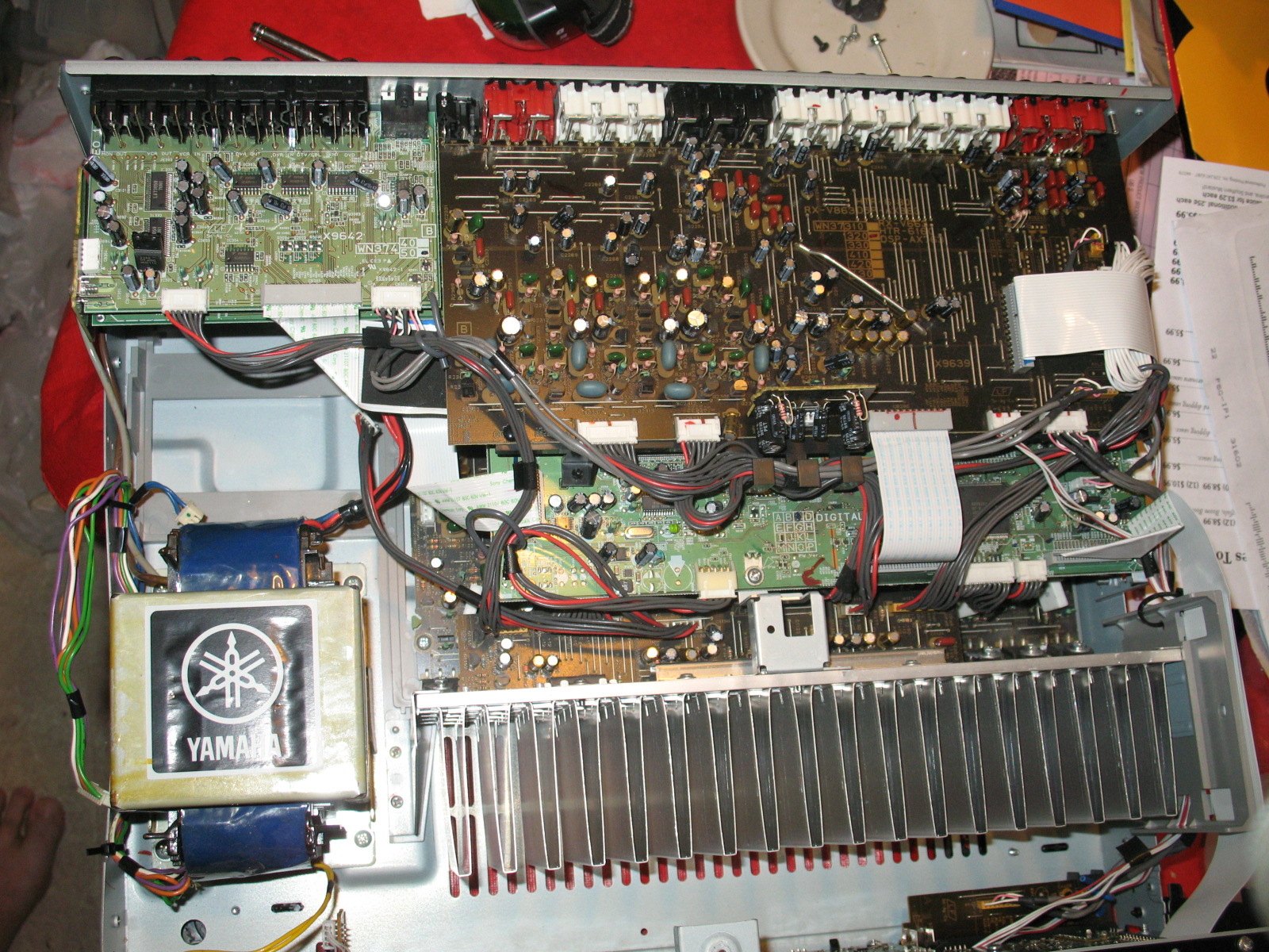

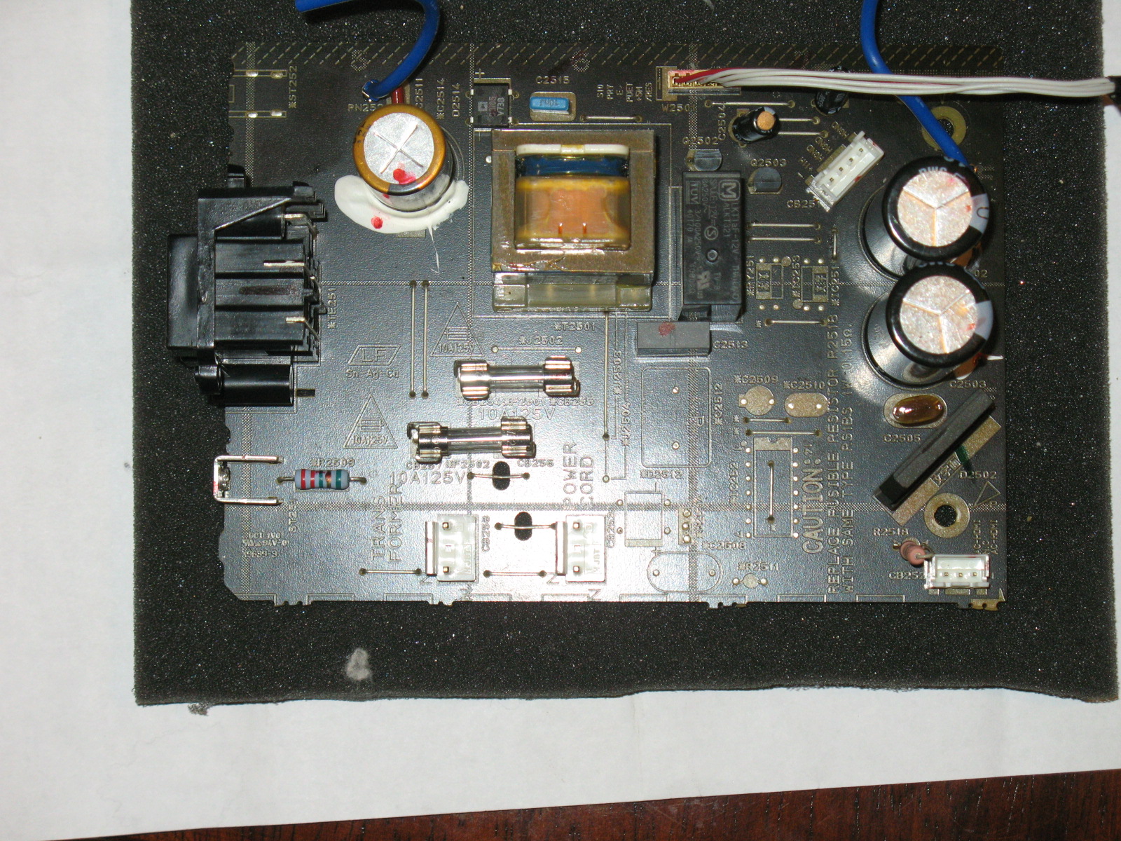

                              Bud, I became bored so here are a few pics to look over. let me know if you need different angles or other boards removed for clarity.
                              Pete
                                Re: Yamaha RX-V863
                                OK, I look at the diagram for the FUNCTION-3 board, as you can see in the schematic, the is a relay contact snubber cap C2513 (0.01uf 250V) across the relay contact, so when the relay contact is not close you will see 120VAC at the transformer connector but the Xc of the cap is very high which will not allow much of the current to flow through the transformer winding or the load connected to the switched OUTLET, that is why you see the ACV drop to almost nothing when the transformer is connected or the lamp.
                                So basically the relay is not being turned by the processor I assumed if you did not hear the relay kicks in when power switch is activated.
                                Or the relay may be bad if you do hear it clicks, so did you hear the relay on that small click on or not?
                                  Re: Yamaha RX-V863
                                  Hmm, your board is not using lots of parts as shown in the diagram. I need to study the service manual more in deep details to see what are actually being used on your board.
                                  It does have C2513 so that section is correct.
                                    Re: Yamaha RX-V863

                                        Re: Yamaha RX-V863
                                        I believe its a Rx-v863U as you had mentioned. the rear lists 120v and the front panel controls seem to match up with the front panel in the manual. The rear of the unit only lists RX-V863, no "U" or any other suffix.
                                        There is NO audible click from the relay and as you noticed there are many components listed on the schematic that aren't present on the board.
                                        So the question is why isn't the relay being commanded to close? As I mentioned before I did replace the relay on the original board because on vehicles I've heard relays click but that didn't necessarily mean voltage was transferred through the contacts.
