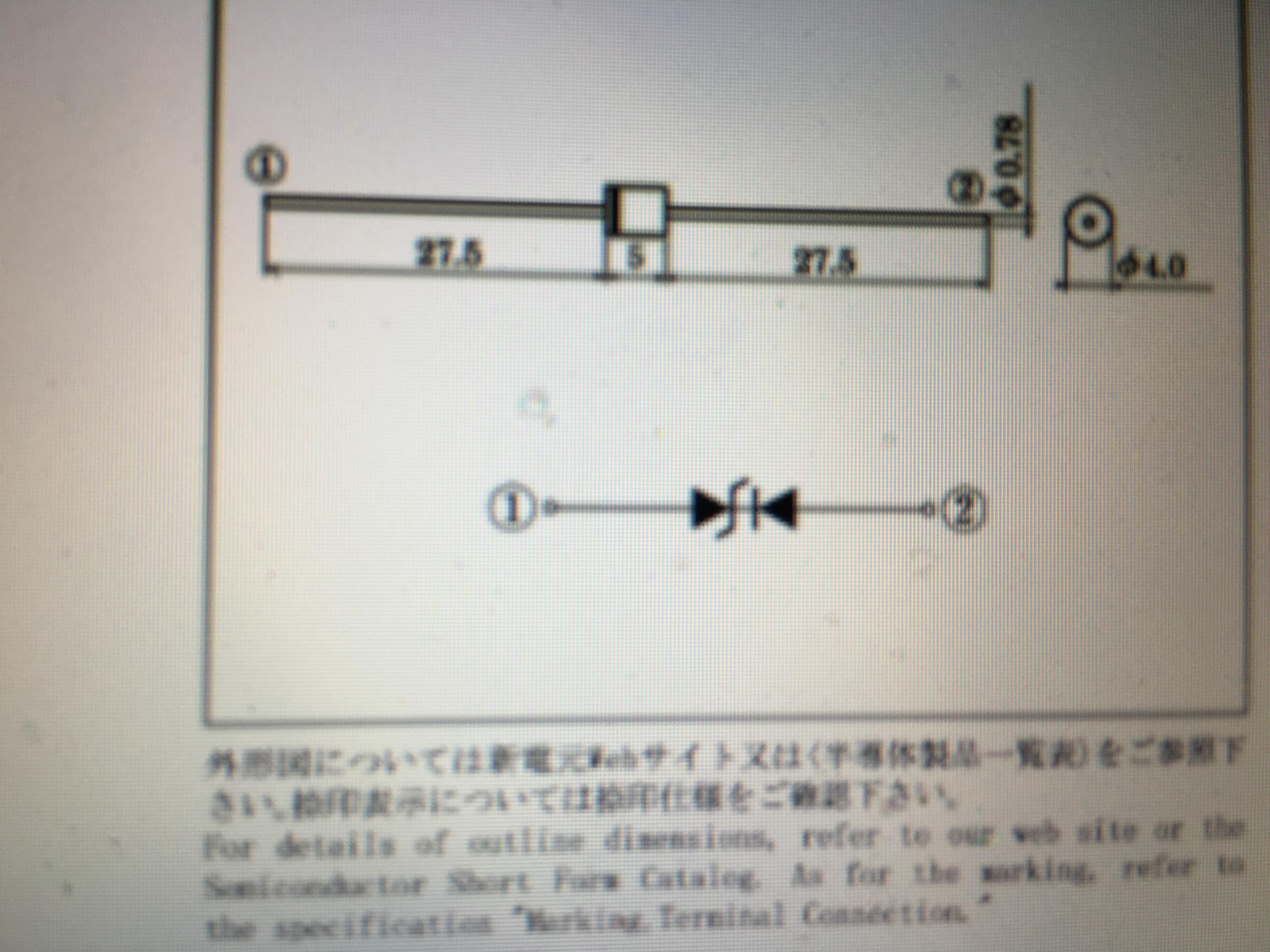

    Sony Diode St02d-140
    It has the marking T2D98. It is open circuit. Does anyone know where I can find this part or is there a replacement I can use.

      I found the data sheet for it. I don't think its open circuit going by the symbol/pinout from the data sheet. Measuring across it measures from anode to anode.

          It's a clamping diode, it's going to check open, it conducts when the voltage accross it exceeds the breakdown voltage of:
          Min. 130
          typ. 145
          Max. 160
          when its in circuit working it probably has around 130 -145 volts accros it.
          Clamping at a maximum of 200 volts . at that point it probably fully conducts acting like a short
          https://cdn.badcaps-static.com/pdfs/...cf2b63802a.pdf

            It looks like a 145V 200W unidirectional TVS with a 600V series reverse diode. I haven't seen that combination offered by other companies. Used for snubber clamps.
            I would put a P4KE150A or 1.5KE150A and a UF4005 in series to make it out of two parts.
            It should check out, start conducting at 145V but no 0.7V (open) in the reverse direction. These probably fail short.

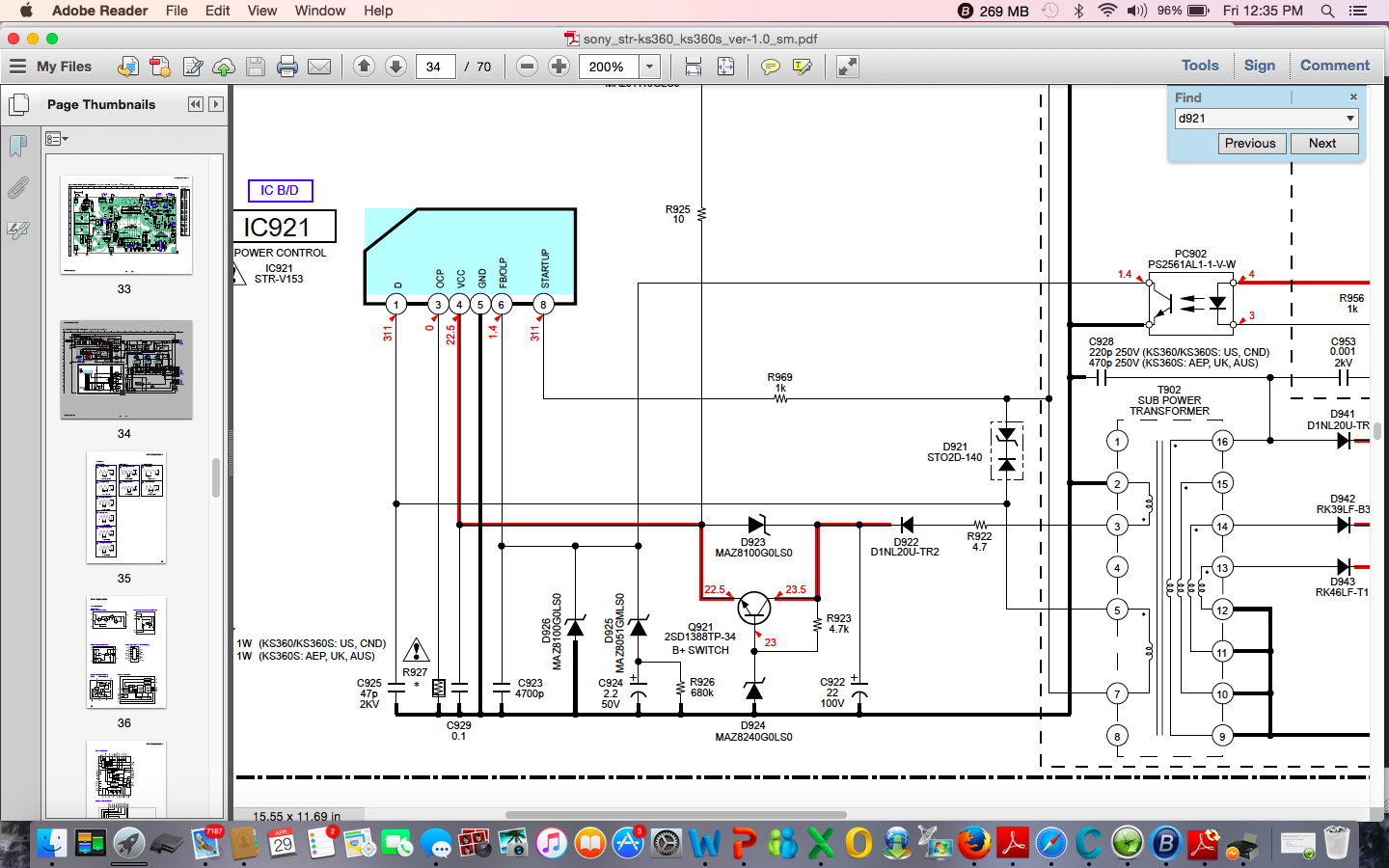

              Can you tell us what kind of unit you are working on and the location where this Snubber/Clamping diode being used?

                It for a Sony STR-KS360 a/v receiver. The fault is when you try and power it on, the unit shuts down. I get all my voltages for a few seconds then they drop back. Checked all voltage regulators and all are good. I get no voltage coming out of IC921(see screenshot). I decided to remove the diodes to test and D921 looked open, but now I know its fine.
                  Re: Sony Diode St02d-140
                  So what DCV do you on all of the pins of that SMPS IC921? All 0 Volt?
                  What GND are you using when test the Voltage on that IC?

                      You are working in the primary side so you cannot use chassis GND as the GND ref. for your meter, you can use chassis GND as the GND ref for cold side of the circuit.
                      Look at the circuit and see how the GND point of that circuit is connected to, does the GND point of that circuit show 0 Ohm to the chassis?
                      You should know that by now since you have been fixing many TVs.

                        You are right. Not used to working on audio equipment with SMPS, usually they have a linear power supply. I will take a look at the schematic.

                            It is snubber/clamping diode. 1N4148 and 5.6V Zener is not going to handle high Voltage spike and current from the primary winding fed by 300V power source.

                              The voltage for ic921 is supplied from the main bridge through jumper wires jw981/982 through r929 2.2 ohm, if its open I suspect the ic921 is bad, also check R927 .82 ohmif its ok The first voltage I would check is the +31 on CN904, that feeds the output ic's if its not there, disconect the plug and see if it comes up. I can't say for sure but my moneys on one of those output ic's being shorted, I did see that problemon earlier models
