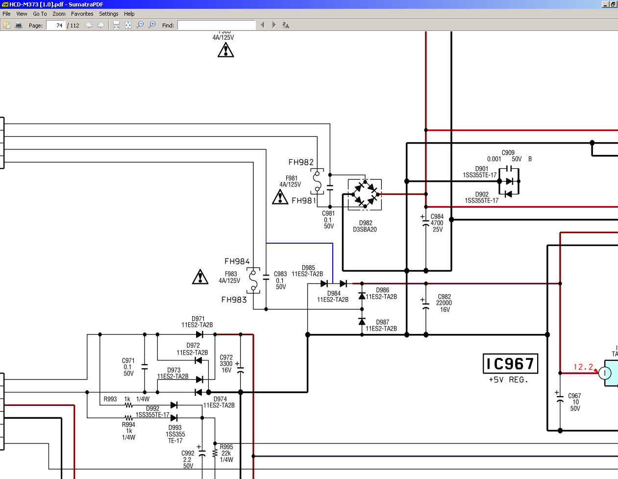

          Found an error in the schematic.
          One side of the 10.8V winding from the main transformer was unconnected. I have added this line in blue. Image attached.
