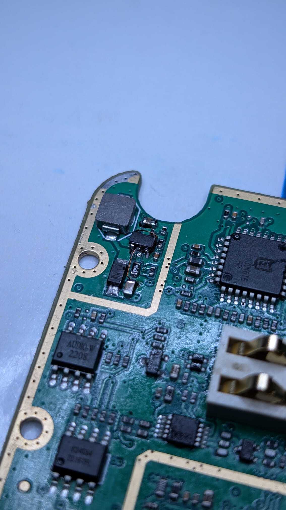

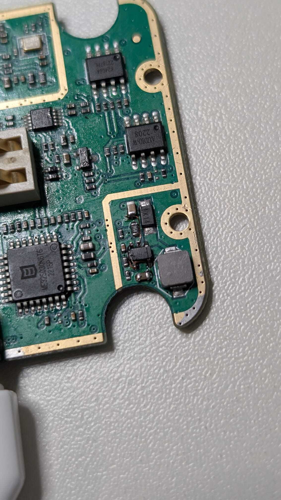

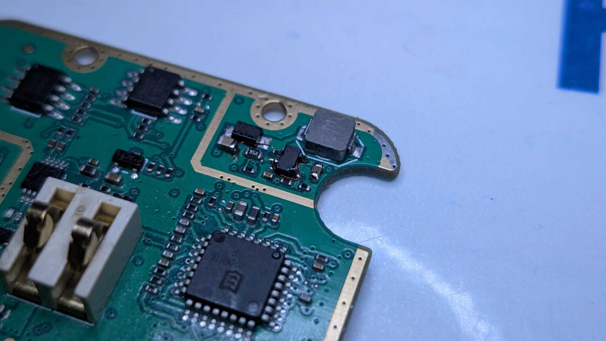

Baofeng walkie talkie UV-16 PRO Mate not charging via usb type c.

            Did you ask for the full schematics or just the IC details?
            Is there any space in the unit to insert a generic 2S li-ion charging board?
            • thesame
              • Mar 2018
              • 140
              • Romania
              I asked for a full schematic or a service manual, its a tight space, i was thinking that maybe if i can find an SOP23-5 capsule that its doing the same thing but not with the pins in the right order i can manage to wire it but for a charging board i will have to do some space measurements.

                  Back after some reading and debating with AI , i found an SOT23-5 TPS61041DBVR , and i managed to wire it in the circuit, i have 8.7 V at the battery connector but i think its charging verry slow , my battery if it has 6.5v it takes 0.13 - 0.05 - 0.23 - 0.38 A variating, but if connect a charged battery that has 8V it goes up to 0.80 A .
                    • 31246
                    #29
                    because it's rated at 250mA
                    dont trust AI.
                    now if you looked at Ti's page you could have seen the line "400-mA (TPS61040) and 250-mA (TPS61041) Internal Switch Current"
                    so if the pinout is the same then the 61040 would have been better
                    https://www.ti.com/product/TPS61041/...s/TPS61041DBVR
