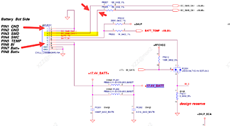

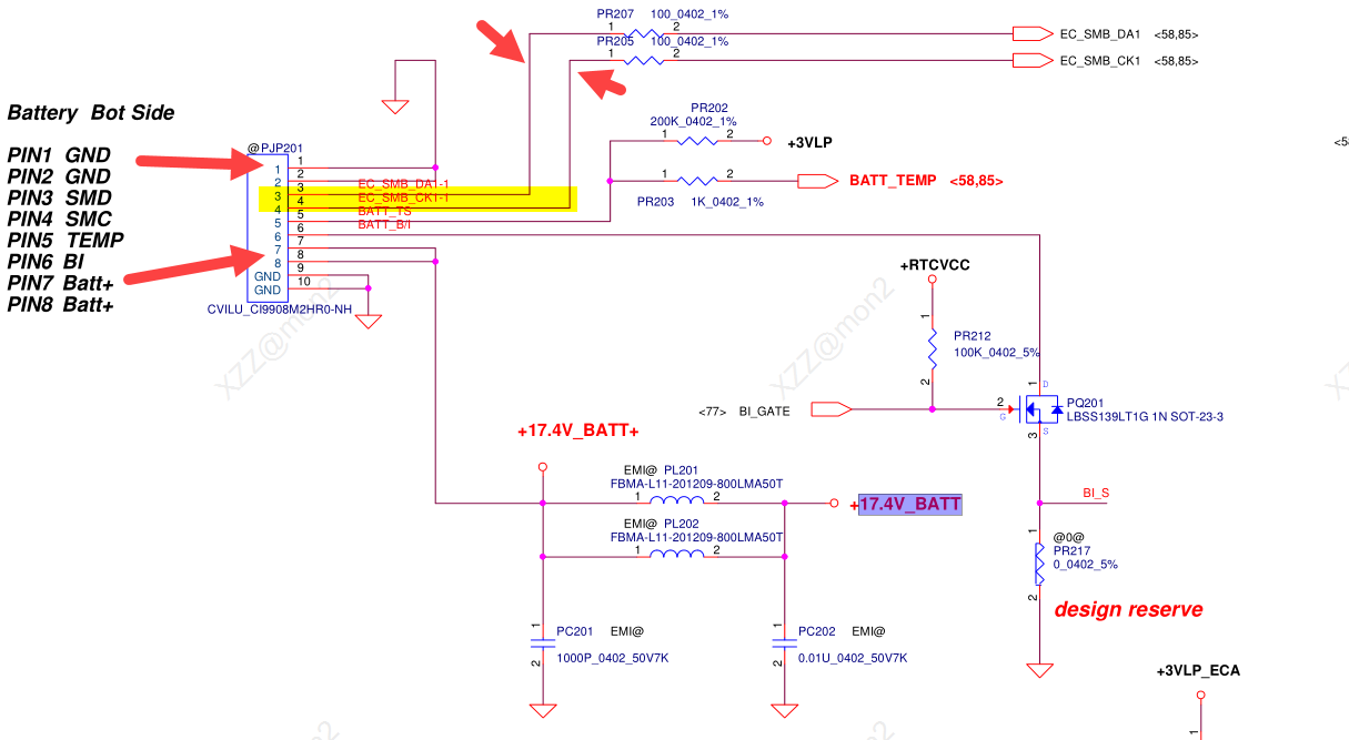

                        What are the voltages to ground on the battery connector with the power adapter connected?
                        Interested in the battery charge voltage and also if the SMBUS SCL / SDA lines are working or not.

                          Everything works. The computer detects the battery, turns on the orange light, and Windows detects it. It tells me that the battery is 24% charged. The battery voltage is 14.8 V. Everything works except charging.

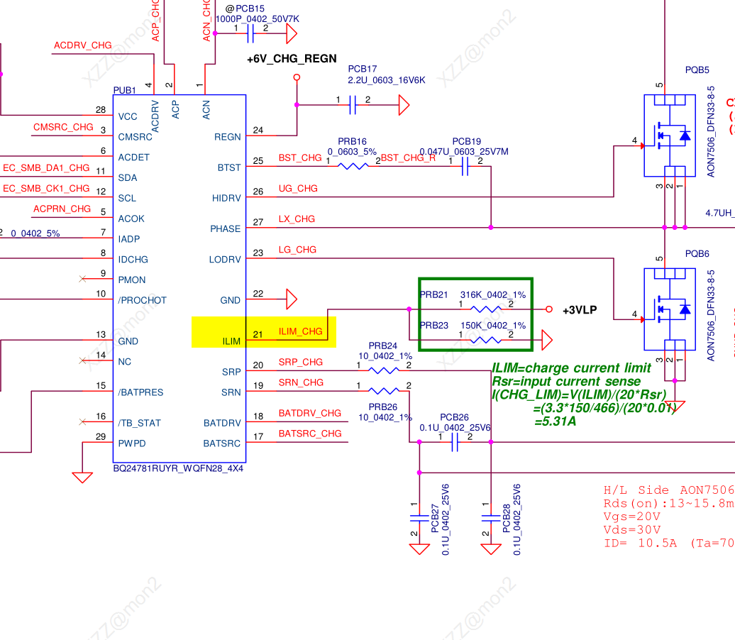

                            What is the voltage to ground of the ILIM pin on the charger IC?
                            Test with another known good battery. Amazon is good for such trials.

                              On the motherboard connector, I have 19.92V.

                                Click image for larger version  Name:	ilim.png Views:	0 Size:	175.5 KB ID:	3730689
                                ILIM pin 21 should never be @ 19v.

                                  Sorry, I misunderstood, at pin 21 of PUB1 I have 1.047v with battery and charger connected
                                    Does this voltage remain the same if BOTH the adapter & the battery are attached? The same when the adapter is disconnected?
                                    If yes, this is only the battery voltage and the high side mosfet on the charger circuit is not working.
                                    Remove all power. Review the high side and low side mosfets @ PQB5 & PQB6 as per post # 8 (above). Use the same method of testing.
                                    Post each measurement. During the charging operation, the battery voltage must be higher than the markings on the battery pack.
                                    Post #13 is missing the requested SMBUS (SCL / SDA) measurements.

                                      at pin 21 of PUB1 I have 1.047v with battery and charger connected, there is 0v when only the battery is connected or only the charger connected (battery disconnected)
                                      Battery pin connected to the motherboard
                                      SMD 3.250v
                                      SMC 3.250v

                                        For information on pin 21 of PUB1, I have 1.047v up to resistor PRB21 on one side (pin 1) there is 1.047v and on the other side (pin 2) there is 3v3
