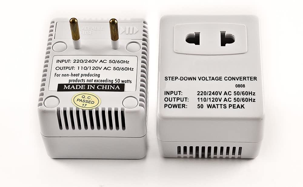

    Hello, good people. Hope you are all doing fine.
    As the title says, I have a question about this Sony Dream Machine clock radio model ICF-C12W from the 80s. I,ve recently come into possession of it, but it is intended for 110-120V input, not 220-240V power rating which is used where I live.
    I have this idea of replacing its inner transformer with the one that operates on 220-240V mains. I have opened the housing, there are no ratings on the current transformer. On its output side there are three wires coming out and going to the PCB. One is black, the other two are red. I guess it is a dual voltage output, but I don't know the output voltages.
    Does any of you have schematics for this specific model or knows what voltages this transformer outputs (if there are any of you who did repairs on this particular model)?
    I don't own a power step down transformer to try the device as it is. If I did, I would be able to easily measure the output voltage on those wires, but that is not possible at the moment. Any help from you would be grat. Thanks in advance.

    If you only want the radio to operate, changing the voltage would be ok but for the clock to operate, the input voltage is not the only problem, the frequency will be wrong and the clock usually uses the zero cross of the a/c sign wave to keep time.
    Are you sure it does not have selectable voltage/frequency input? I see some specs on the internet that suggest it might. https://www.radiomuseum.org/r/sony_d...o_icf_c_2.html

      if it has a backup battery then it probably wont use the mains for timing,
      but looking at this schematic, it probably has a special transformer to drive the vfd heaters

        Despite having a PP3 to backup the clock, I'd be surprised if it doesn't require line power for clock operation.
        But it might actually autodetect 50/60Hz...

          well the transformer in the schem is 5-0-5 so maybe a 4.5-0-4.5 bell transformer would fit.

            Thank you all for this info.
            Yes, I would like both the clock and the radio to operate. A full feature device.
            No, I can't see anything inside that resembles a backup battery on the PCB. There is also no battery compartment.
            No, this one does not have a voltage selector switch, although I saw a version with a round hole and a switch to set the input voltage. On the back of the case it says Input: 120V, 60Hz. But I guess all USA designated devices have this voltage rating.
            The power cable goes directly into the transformer. It is rather a small one and completely encased in metal shielding of some kind (I will provide images if that would help). On the other side of the transformer there are those three wires coming out directly to the main PCB. There is also a small daughter PCB housing a LED display, a big chip and buttons for the settings and actions.
            Do you think a socket power converter would be enough to start up the device? I came across this clock radio and took it because of nostalgia. It looks nice, isn't scratched and would make a great prop from the 80s. If we manage to bring it back to life, it would be icing on the cake.

              The battery is a 6F22/PP3 and is likely offboard on the bottom of the unit if past experience with Sony "dream machines" goes.
              It might just work with a step down 220V to 120V, else you'll need to replace the transformer as stj suggests. The worst case scenario is that the autodetect of 50/60Hz doesn't work and your clock will run slow. Looks like you will need around 10V RMS with CT on the secondary, so you can get 13+V P-P as the radio section appears to want 12VDC after the ripple filter.

                Thanks, the step down is an option, although I will need to buy one. I didn't want do it initially because I was afraid it might make the radio clock malfunction or break down.
                No, there is no openable battery compartment anywhere on the housing. Even if it used a 2032 3V button cell or alike inside, it is not the case. There simply aren't any battery contacts. It looks like it is powered through the transformer alone. There is one large capacitor near where the output wires are connected.

                    If you can find a replacement it should work, It looks like the micro can detect 50/60hz so I suspect the clock won't be an issue.
                    I would think a 220v primary and 11v secondary with a center tap would work

                          Check where the wires on this transformer go. usually when you have one black wire and two red wires, the black is the center tap. I suspect in this case one of the red wires goes to ground and the black goes to the 5.2vac. Look at page 7 of your service manual
                          The secondary of the replacement transformer will likely be listed as 11vac center taped.
                          I would get one of the voltage converters that plug in the wall outlet and the radio plugs into it, even the small ones seem to be rated 50watts (radio is 5w)
                          Here is one I found so you get the idea of what I am talking about "Simran SM-250R Step Down Voltage Converter 50W"

                              I posted a picture of one of the convertors, there are others, less wattage and cheaper

                                I found something similar to the ones you included, 45W max power. I don't think this clock radio needs more than 10W, if that much. I certainly need to find a means to power the unit up to see if it even works.

                                  Hello, people. Sorry for this late reply.
                                  Unfortunately for me, you and R_J seem to be right.
                                  I found a 220V to 110V adapter with stated 100W power as per your suggestion, the converter did the trick to power on this digital clock radio. But, because the AC line here is 50Hz, the clock seems to go slow. I synchronized it with my phone, and the clock slowly starts to be late minute by minute compared to the correct time. I hoped that since this is s digital device, it would use the crystal to count time.
                                  I guess finding a replacement transformer with the 220VAC input wouldn't help much, except removing the need for the mains voltage step down device.

                                    I suppose there isn't a simple part to replace inside to make the clock work normally at 50Hz mains. Unless there is something else broken causing it to lag. What do you think?

                                      Yeah that's unfortunate. Autodetect is possible but kind of difficult, would need to make a internal oscillator to compare to, but if it's stable enough, why not use it to run the clock...
                                      ... then again there must be a reason for that RC network... What are the resistor/capacitor values for R104 R105 C102 provided they are the same designators on the unit you have?

                                        Your model should be setup for 60Hz and the schematic is for 50Hz, can you see what is different? maybe the circuit around pins 15~17 As you can see from the schematic, pin18 switches between 12/24h, maybe there is a separate pin that switches between 50/60Hz
